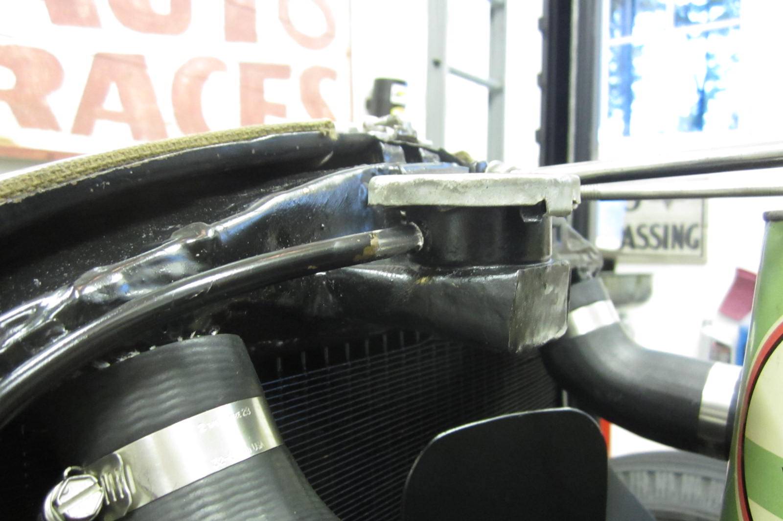

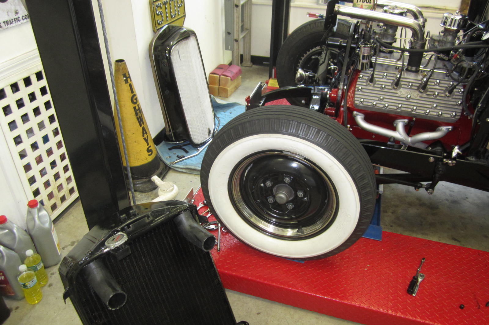

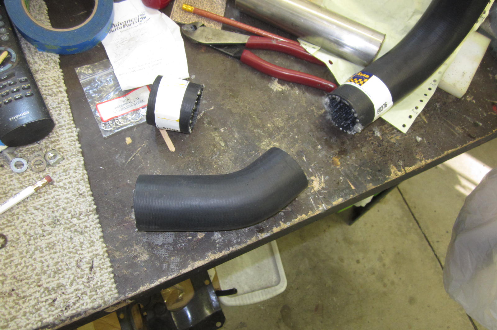

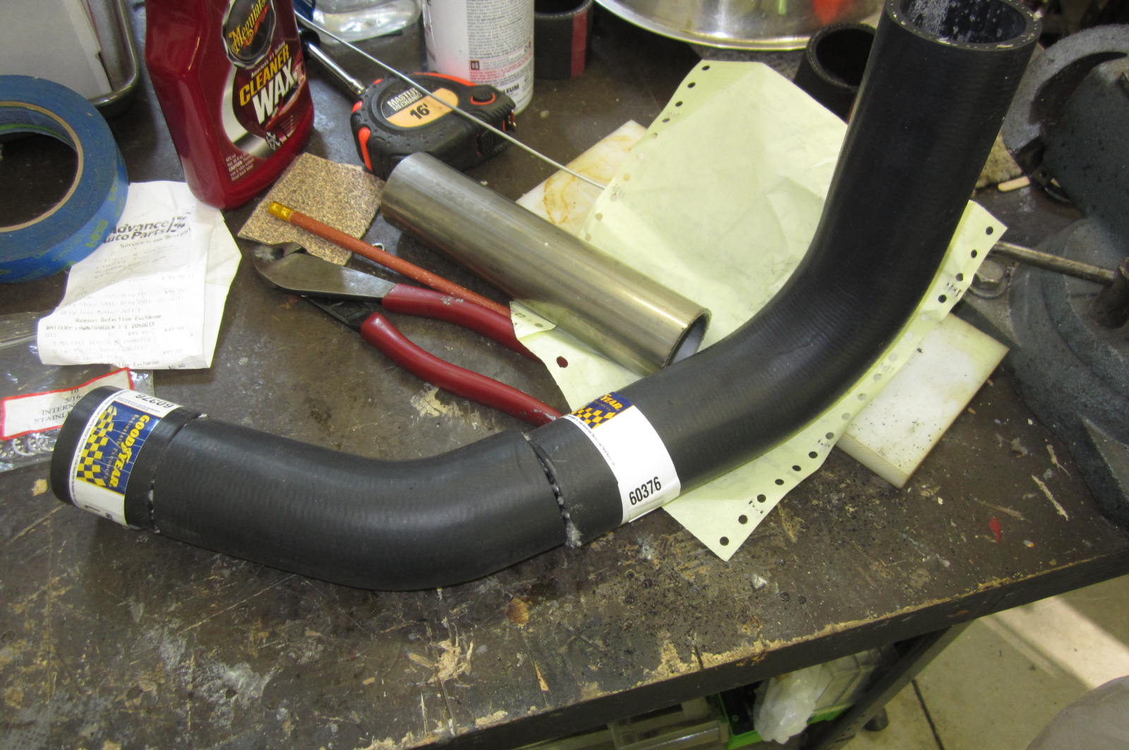

    I have been fooling around with old cars since I was 14 years old.:cool: I am now 67 years old and I still today get a mouthful of gas, siphoning gas up the fuel line in the coupe.:eek: I must have done this a dozen times over the years and still continue to do stupid things.:rolleyes: Anyway I did get the coupe running today!:cool: Finished up upper radiator hoses by using a Goodyear hose #60376 for another car to get the top hoses to the radiator. Not having much room to clear fan etc. it was a challenge that a local parts house helped me out by bringing in several hoses that looked like they would have the 45 tight bend I needed.:) Found one that worked and the rest is history. I made up the top stainless pipes and it looks pretty good. Next sort out the engine "Some Fine Tuning". Ronnie Roadster is coming by with his doctor kit in the next day or two. After that put the hood back on and go for some crusin.:cool: Going to wash my mouth out again for the fifth time today!:confused:

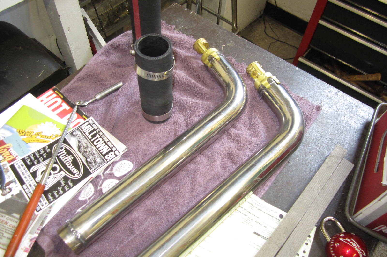

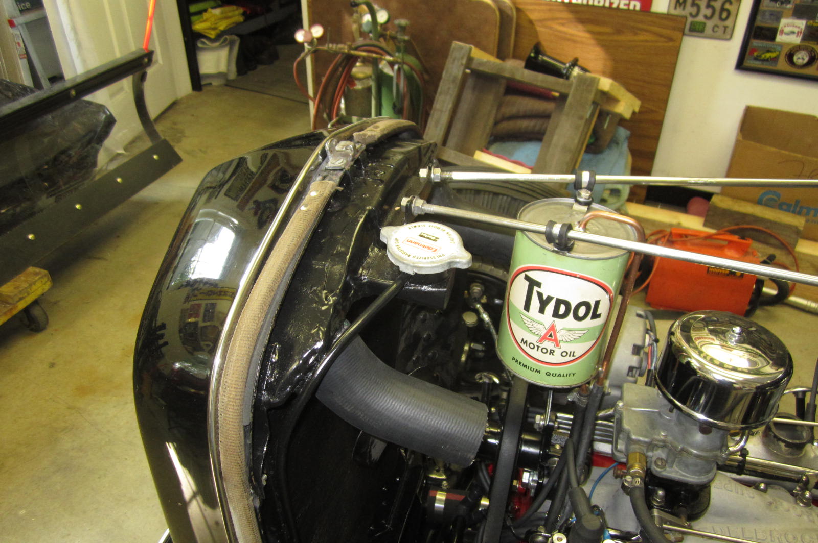

    What are the br*** colored items on the end of the short legs on the rad pipes?
  6. ct1932ford
    Joined: Dec 3, 2010
    Posts: 13,260
    ct1932ford
    Those are original early thermostats! Normally they go right on the radiator under the top hose, but because of the tight bend I put them down stream a bit. Good catch.

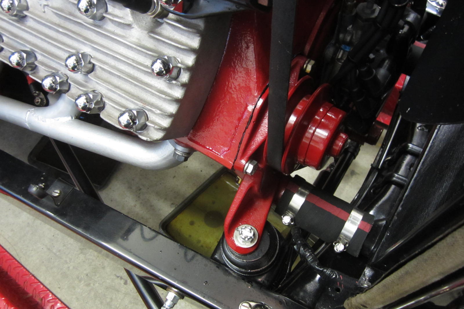

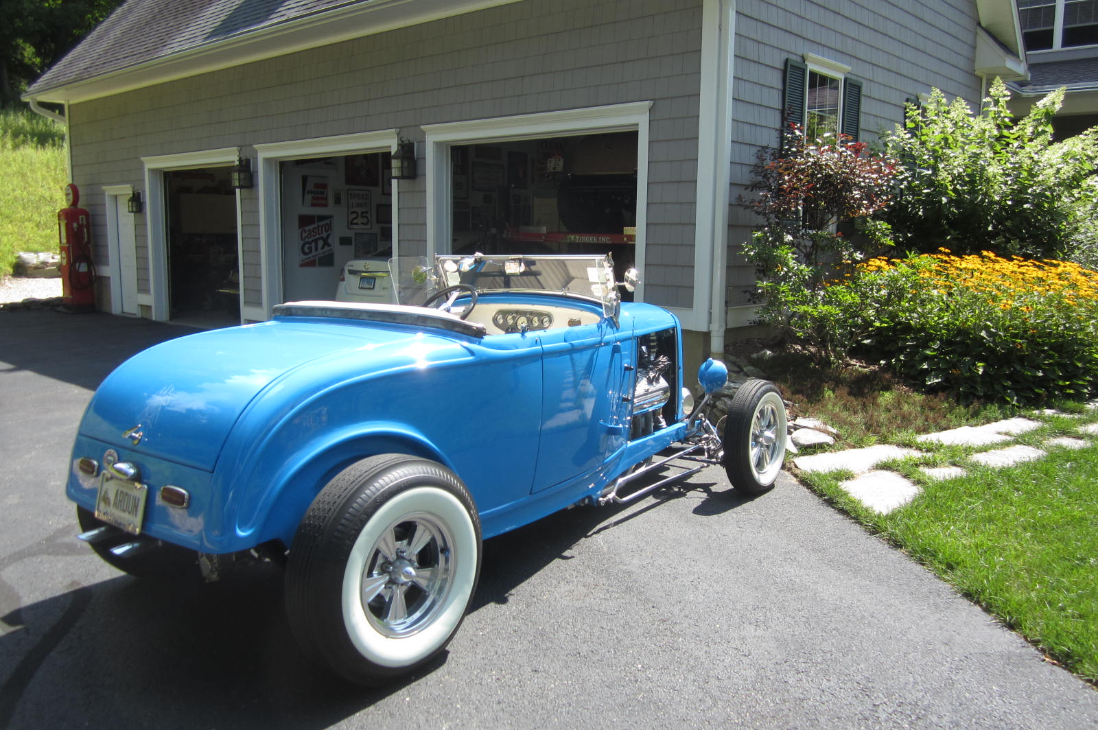

    This morning I hear something very nice coming up my driveway!;) I look out from my garage and it is the service man in his work vehicle.:rolleyes: Ronnie Roadster shows up to help set up my carbs etc.:D That was the good news. The bad news is I had a couple of coolant leaks.:mad: One was just the overflow tube on the radiator that I fixed already. The other is my driver side water pump leaking bad:( Ron did the carbs and dist. I drove the car up the road and that ****er is not holding back anymore.:cool: So I now get to take the car apart again to do the water pumps. Going to do both while it is apart. Should I send mine to Ship Haney or just go with Speedway's? Don't want to do this twice. This motor feels like it has some power now! Much better than before.:cool: That blue roadster is a nice service vehicle for sure.:cool: Thanks Ron, sorry for getting you wet. ;)

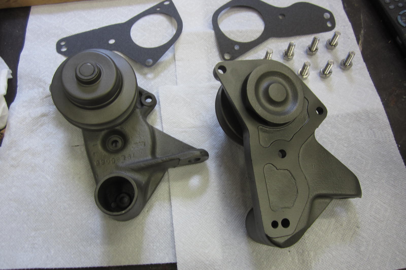

    Started taking the car apart yesterday to get the pumps off. Talked with Skip Haney and that is where I will send my pumps for rebuild.

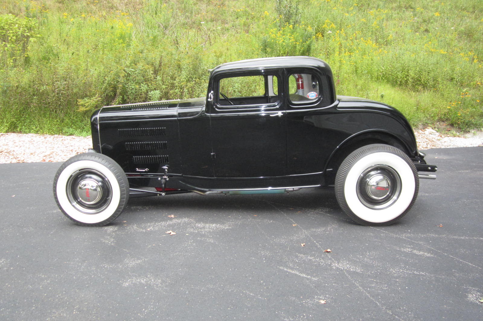

    Had the car out today! Still some bugs, but getting there. Did a little more fooling with the timing and carbs and I think it is about where it needs to be. Motor sounds and feels good. I will be back at it again tomorrow. Starter needs to come out for a spring, front right brakes need to be a looked at. Here are a couple of shots. It has not been cleaned in a long time but it still looks like the Coleman Coupe. Mission accomplished.:cool:

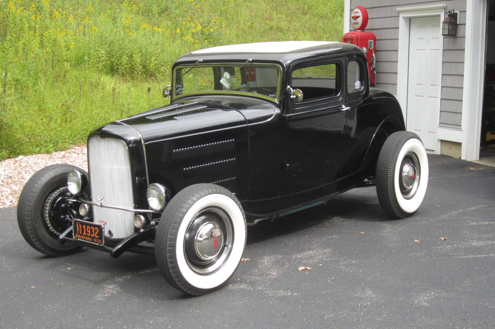

    Finished it up today!:) Man that flathead sounds good.:cool: Thanks to everyone for the kind words and inspiration.
