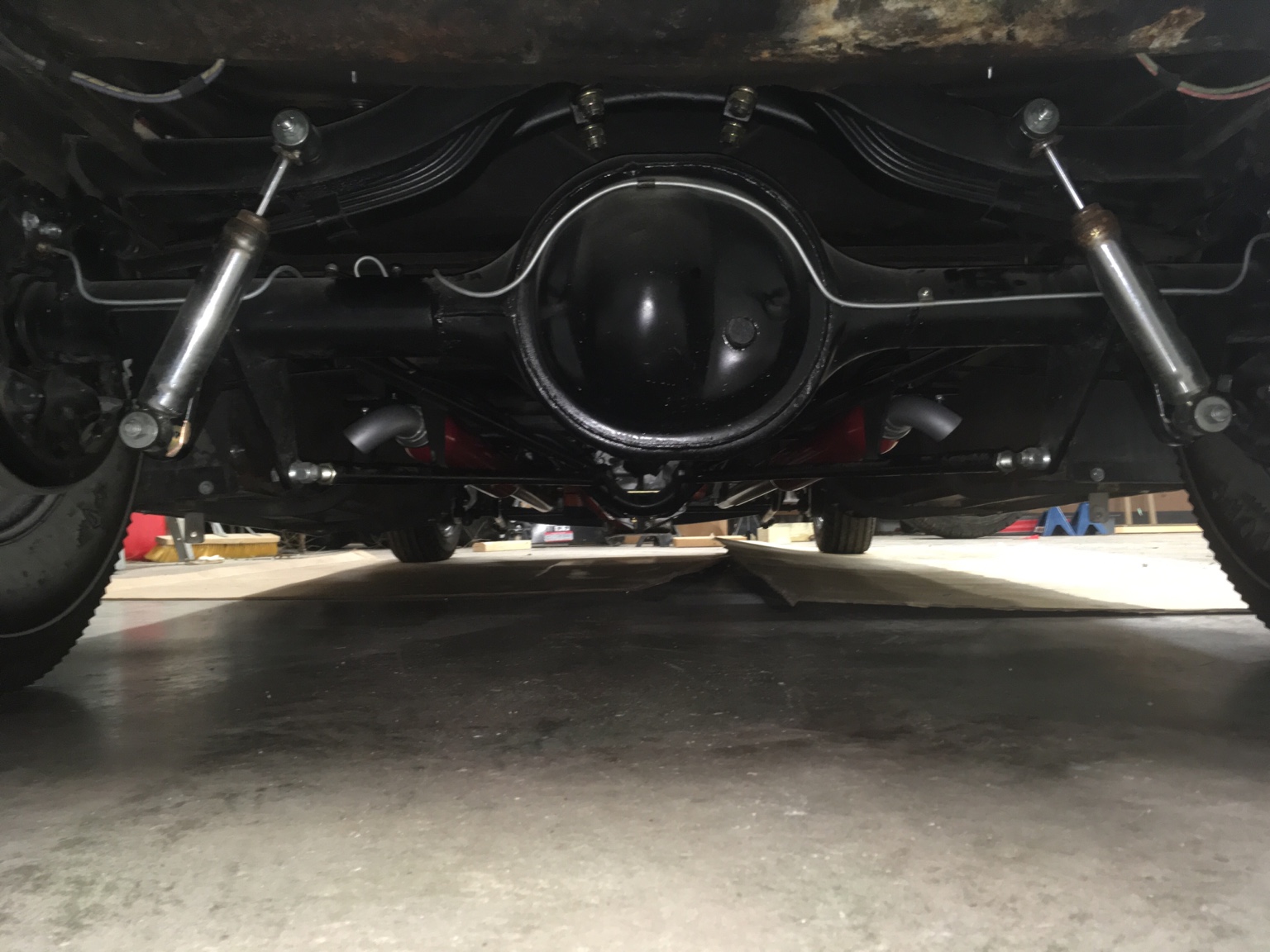

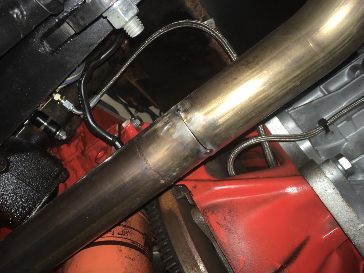

    My son Kyle is a really good fabricator. He cut the stainless steel pipes and welded-in two per side. They are shown backwards in the photo, but please ignore that.
    [​IMG] [​IMG]
