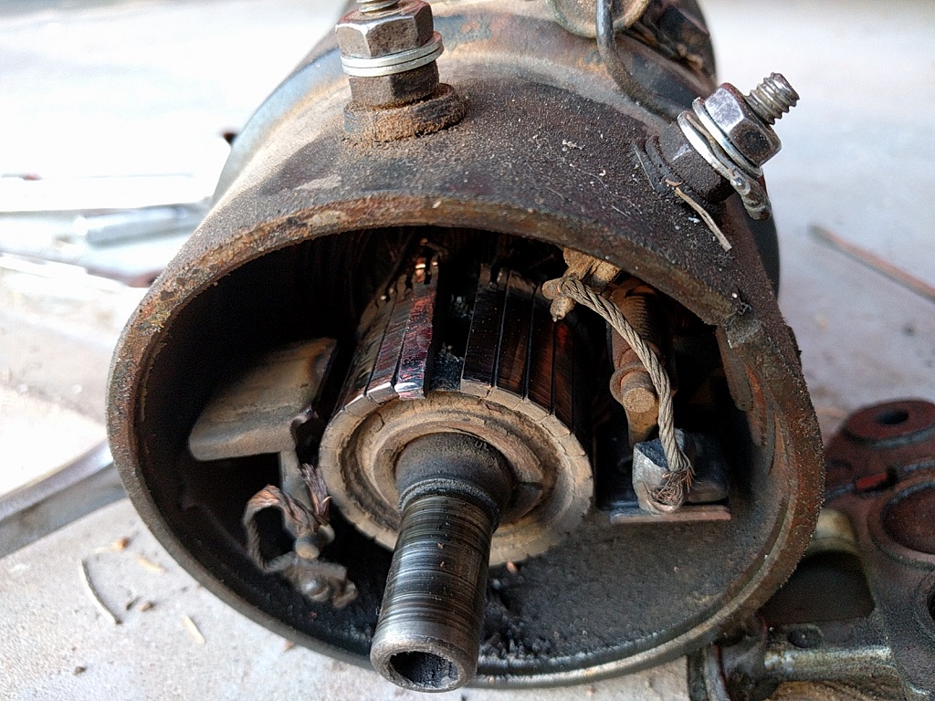

    Anyways...more fun today. Half way from Flagstaff to Phoenix, I smelled a little burning something, and then the GEN light went on. I stopped, because I thought maybe the fan bearing had locked up or something. Looked at it, all looks well, belt was still on. I removed the belt to see if something was seized, everything spun nicely. But the back of the generator looked funny inside, like a brush came out of it's holder.
    I thought a minute, then disconnected the wires to the voltage regulator, and taped them up. I put the belt back on. Started it up, it seemed like all was well back there, but the gen light was still on of course. I have a little cigarette lighter plug voltmeter, it showed that the solar panel was keeping the battery above 13v (it was around 3 pm). I decided to see if I could make it to my son's house, before dark. Google maps said traffic was about 15 minutes slow, which is not too bad, I had 83 miles to go.
    I made it! I'll tinker with the generator tonight, and probably just leave it as is if I can't fix it. And drive to Tucson in the morning after traffic clears up, and the sun is up in the sky.

    I don't think I'm fixing this generator...

    that last pic "generates" memories of failing generators - your brother will have time to source a replacement - on eBay and others

    OUCH! :eek: Either your stereo system put too much of a load on it or your solar panel was back-feeding it. :p
    Or maybe it was THE TOTAL ECLIPSE OF THE SUN! :rolleyes:

    That generator looks original....lousy junk generator, only lasted 53 years! Your lucky you got as far as you did since it looks like you left home with worn out brushes that started arcing and burned up the commutator.

    That sounds like an accurate ***essment.
    Except it is stamped rebuilt.

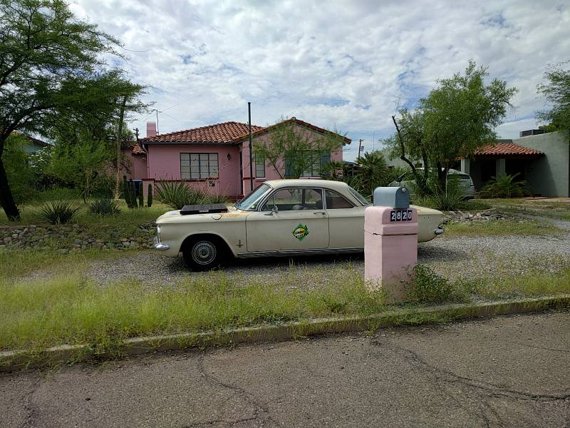

    I made it to Tucson, and dropped the car off at my brother's house. My wife picked me up and is taking me the last 75 miles home. With ac.
    The solar panel will keep the car running OK for local driving. It's already paid for. Generators can get expensive, but David can probably score one for free if he asks enough people.
