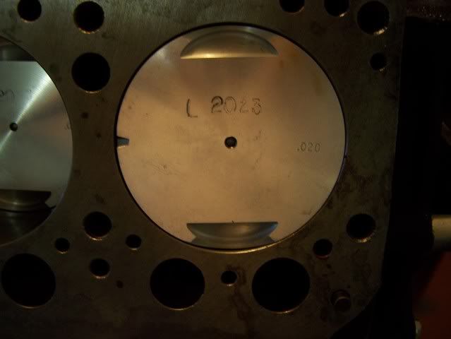

    i finally got started on the motor. 020 egge pistons,arp rod bolts iskycam hydraulic/and a **** load of hot heads parts. [​IMG] [​IMG] [​IMG] [​IMG]

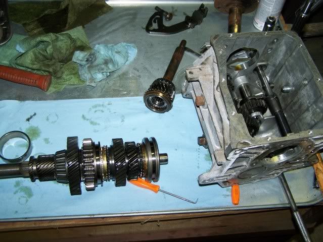

    tore down the trans and installed new syncros, bearings and two new gears [​IMG] [​IMG] [​IMG] [​IMG] [​IMG] [​IMG] [​IMG]

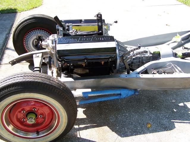

    its been a long time coming but the engine made it in the ch***is [​IMG] [​IMG] [​IMG] [​IMG] [​IMG] [​IMG]
