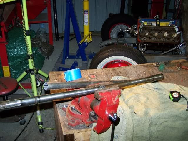

    well its been two steps forward then take one back for me lately.i shortend the torque tube and drive shaft this weekend. [​IMG] [​IMG] i used a ring compressor to get a straight line all the way around then made my marks and cut [​IMG] then made a jig to hold it straight and welded her up. [​IMG]

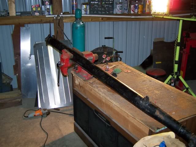

    then the drive shaft [​IMG] [​IMG] [​IMG] then i cut a piece of steele and drilled a big hole in one side so i could keep it straight and weld it. then after i welded it i made a sleeve to go over that spot and welded the sleeve [​IMG] [​IMG] [​IMG] [​IMG] [​IMG] [​IMG]

    after all the work on the rear end i realized one critical thing i did not take into account. that is that the drive shaft i shortened come out of a 46 rear end and i have a 36. yep you guessed it!!! its has different splines. so i will be shortening another shaft. what the heck i guess i just needed the practice!!!!!
