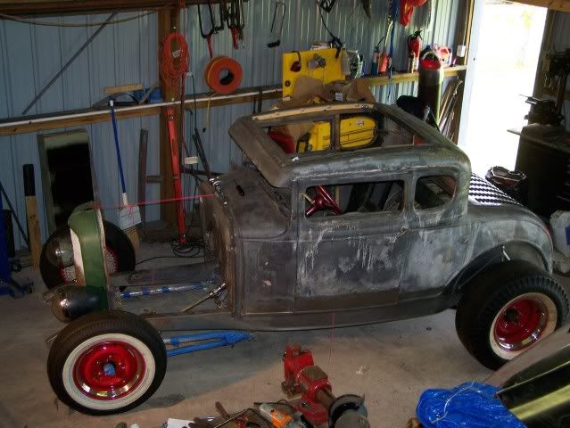

    i got the front shock mounts on and headlights!!! i picked up the head lights at the auto fair in charllote last year.i wanted 32s but i got a deal on these for now they will do. [​IMG] [​IMG] [​IMG] [​IMG]

    always loved 50 Buick taillights lookin good!

    It looks super. I like the taillights and the 36 headlights.

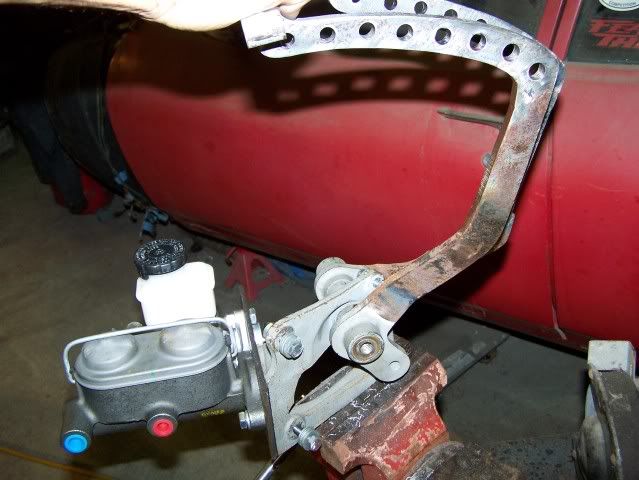

    Great build! Did you go with a mechanical set up for the clutch, or did you use hydraulic?

    i had to go with hydraulic throw out. thanks for the compliments guys

    What type, size, width (front and back) are those red wheels and tires with the beauty rings?...I like.
  14. I SMELL SMOKE
    Joined: Mar 6, 2008
    Posts: 1,527
    I SMELL SMOKE
    front rims are 15x5 and the rears are 15x8.5 they have ford stamped on them. i don't know about the year. the tires are firestone 6.40 x15 on the front and 10.00x15 on the rear

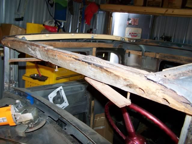

    i was having problems getting my windshield to mount then i figured out the header was junk! with a little help from the hamb. [​IMG] [​IMG] [​IMG] [​IMG] [​IMG]

    i also drilled some hole in my pedals and made a bracket for the clutch m/c. [​IMG] [​IMG] [​IMG] [​IMG] [​IMG] [​IMG] [​IMG] [​IMG]

    comming along great. New header looks perfect.
    I didnt realise that the visor has a backing plate...one more thing I need to buy, damnit :rolleyes:
