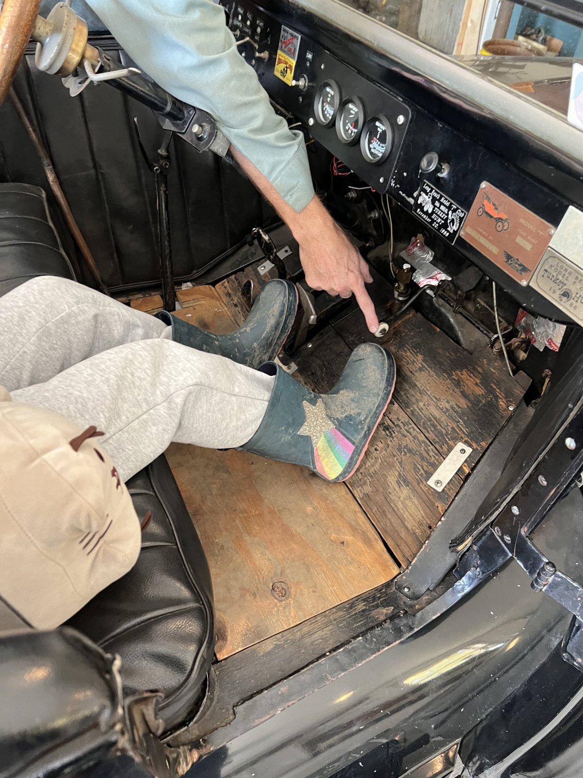

    Spencer has plenty of leg room in Gabby’s Gow.
