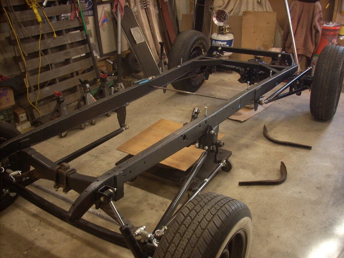

  25. mike bowling
    Joined: Jan 1, 2013
    Posts: 3,559
    mike bowling
    Hockey puck motor mounts, bolted to a Hurst style front engine mount;
    ****** mount from the New England Dragway Swap (20 bucks, new, love it!)
    Angle iron rear X-member to figure out coil overs- decided to take off stock x-member and fabricate a new one and redo the torsion bars to ladder bars. More better. DSCN3043.JPG DSCN3063.JPG DSCN2964.JPG

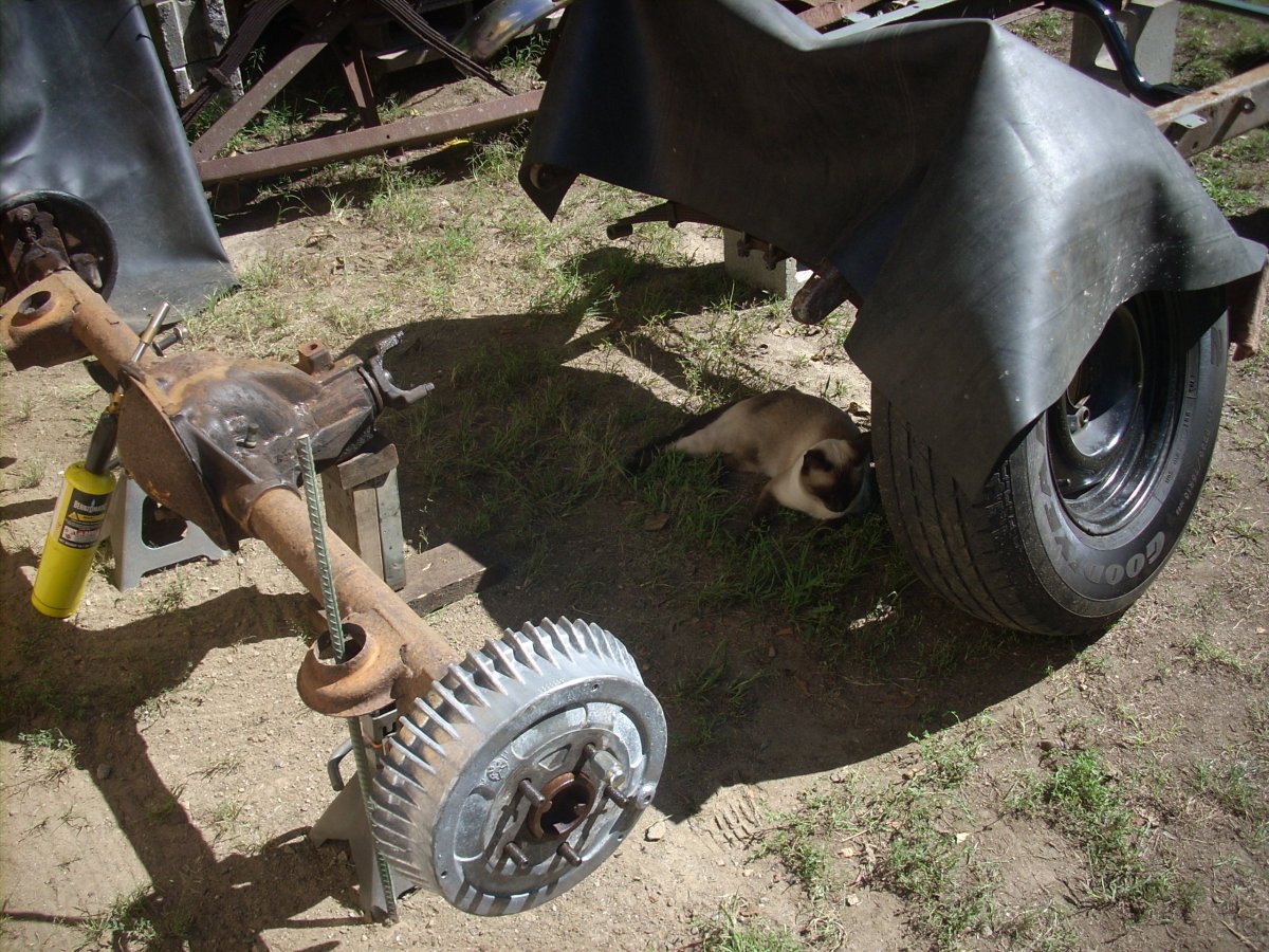

    Going ***- backwards as promised, but thought I should fill in a few areas.
    '82 Camaro 10 b0lt posi rear with finned aluminum drums- woo whoo
    And the garage Attack Kat waiting for a victim.................... DSCN2897.JPG
