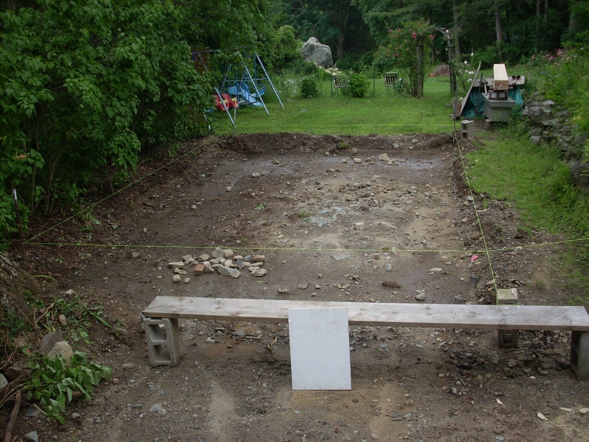

    my old lady had reserved this spot for ( another) garden- as soon as she relented, I had my neighbors backhoe and started digging!
    (I'm talkin' maybe 15 minutes later) Kind of off topic, but still part of the story......................
    3 weeks and DONE ( easy compared to some projects !!) 12-29-11 050.jpg 12-29-11 069.jpg 12-29-11 083.jpg 12-29-11 121.jpg

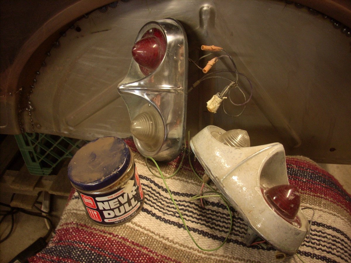

    X2 on the 39 teardrops

    Chevvy, itsa wace kar
    Not a street car
  23. Stogy
    Joined: Feb 10, 2007
    Posts: 27,523
    Stogy
    58's Chevie's bigger and more light so when you p***em they'll see you disappearing off in the wild blue yonder for longer...:D. Use one of the two for backup lights...More 60s ish.

    That's the problem- on a boat like the Chevy they look fine but on a "little" Model A they're kind of big. I'll probably wait till I've got the rear fenders on- that adds another 20" to the width and might visually make them look smaller? Plenty to do in the meantime.

    This A is gonna rule. I vote for the 58's or something on par... I have an old A drag coupe that still has 58 impala lights on it- plan to keep them. I love the way they look- I think too many times people get hung up on the same old recipe when part of why I love the sixties so much is because they did quirky stuff like that-

    Like I told my buddy "Stogy", The lights will be at the end of a LONG list-- I think the Chevy lights won't look so huge once the rear fenders are on ( we'll see).
