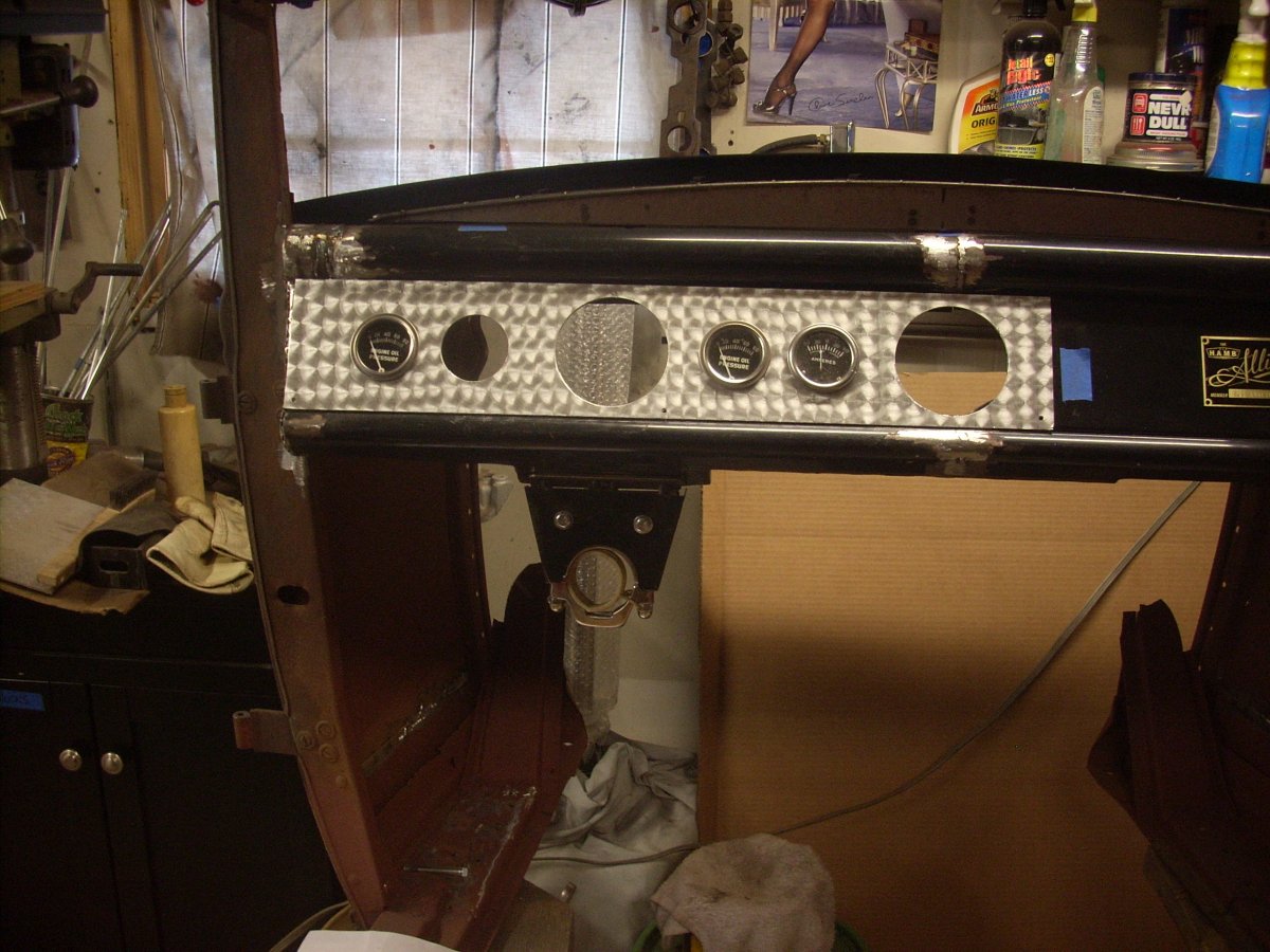

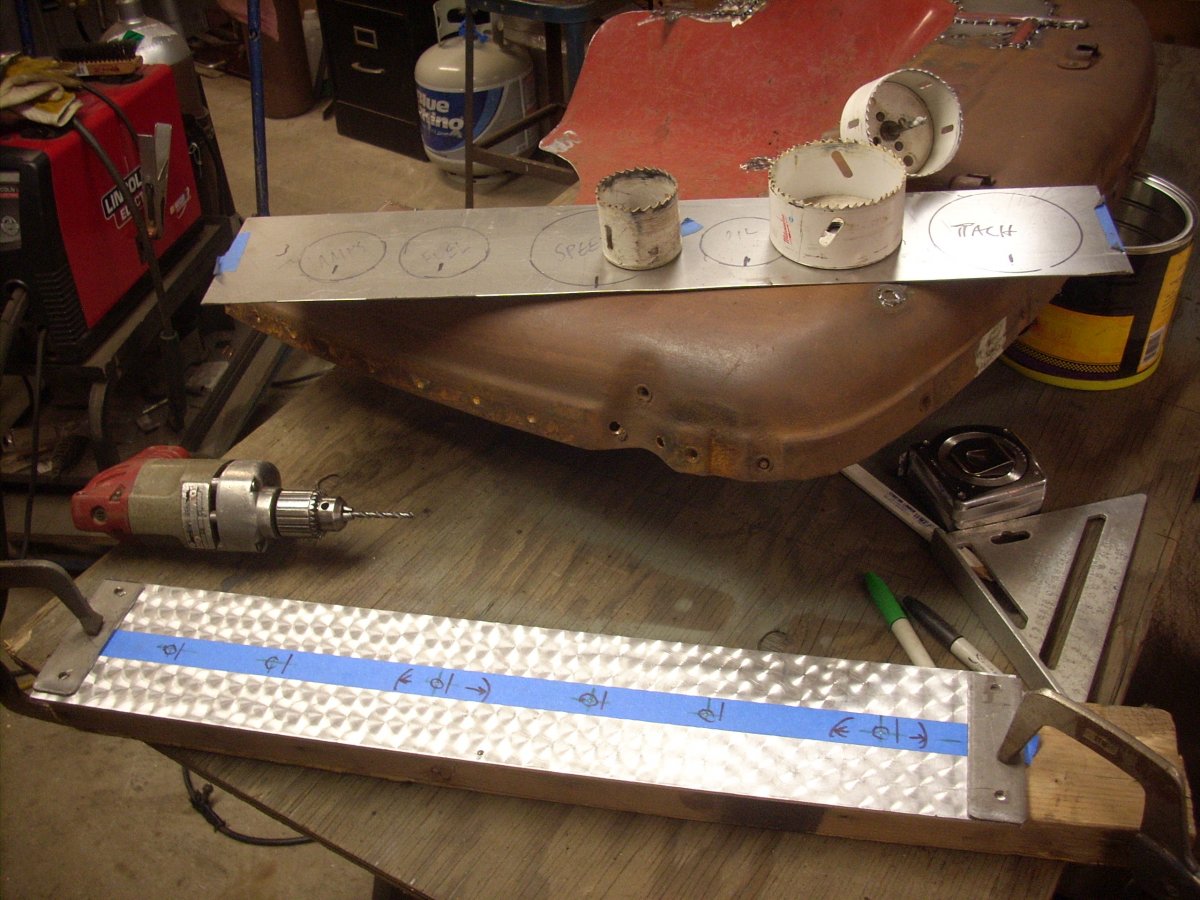

    S**** aluminum from the salvage yard, turned with a small drill press and a 3/4" diameter wire brush. I rough cut the piece on my table saw, then fine tune with a bench grinder. I drew a 1" x 1" grid on with pencil to TRY and keep it straight.
    You can buy it, but it's pretty expensive ( and I like making stuff). DSCN3122.JPG

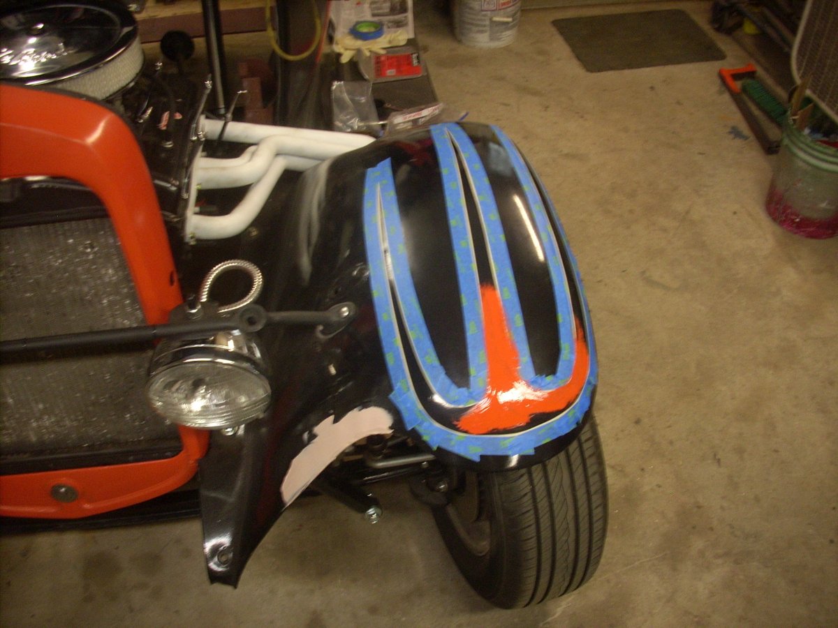

    DSCN3520.JPG DSCN3523.JPG DSCN3524.JPG DSCN3525.JPG Then for some fun- break out the 1/8" tape and let it rip
