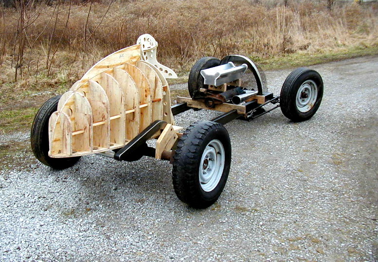

    IMG_1716 - Copy (2).JPG IMG_1717 - Copy - Copy.JPG IMG_1718.JPG Thought it was about time to do***ent the build up of my '34 Austin Ruby project. Labeled it "dead end" because at some point in time it will veer off the track and not be Hamb compliant and will leave everyone hanging. Enthusiasm for working on the T coupe has vanished for now and in an attempt to not just twiddle my thumbs all winter, I dragged the Austin back into the garage. This is a car that has many attempts to try to come up with a workable (something that fits) drivetrain and suspension. Seemed safe enough to try doing some bodywork instead. Been avoiding that due to the stress cracks in the fenders. There is that rolled bead along the edge wrapped around a stiffening wire; something I have never tried before. Upon reviewing the situation, it isn't that bad. The right front fender has a bad crack, but whoever fixed it welded it; not some ugly brazed affair. The right rear fender has a real ugly repaired tear and the back edge looks like the bead was worn out due to dragging on the pavement. Learning time.
    As far as the drivetrain blues, my last attempt was putting in a Geo Metro 3 cylinder hooked to a Suzuki Samarai transmission which was going to go to a much narrowed Ford 9" with 4.56:1 gears. With the current situation of high gas prices along with the Canadian government's carbon tax, I'm rethinking this. Not so much as to how much gas this puddle jumper will consume but rather the cost involved with rebuilding all those pieces and locating the ones still needed. China has all sorts of low speed mini electric cars and the driveline parts can be purchased cheap. When i get to that point, this hits a dead end.

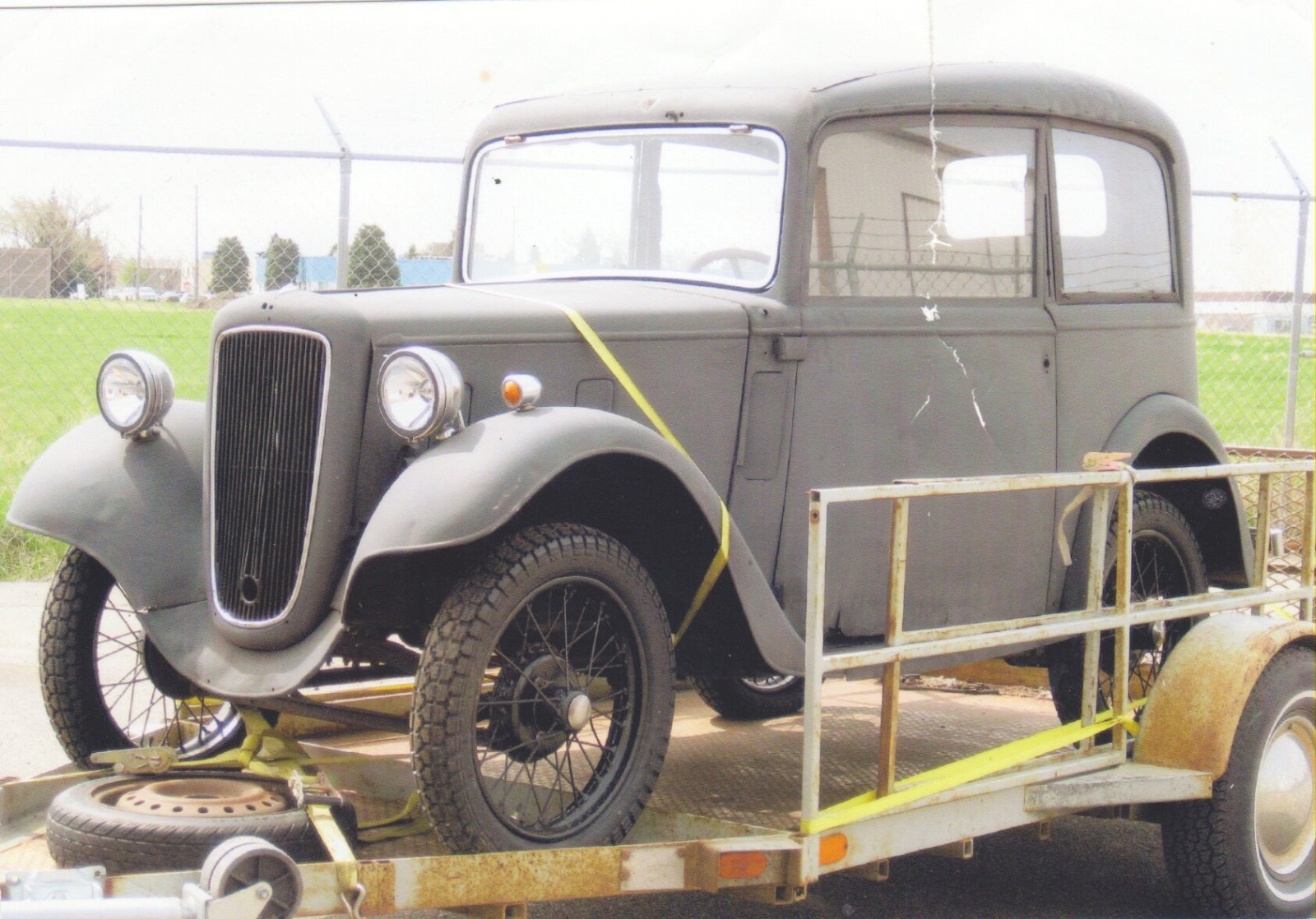

    I bought this car back in May 2011 when I spotted it at the Red Deer swap meet. I knew right away what it was because i remembered a feature on one in Rod & Custom No.11 in 1980 when it was no longer a magazine but just an occasional publication. Always was intrigued by small cars. Showed it to my wife who said "buy it". Can we say impulse buy?
    The article said the car had a narrowed Datsun 510 front suspension. Those cars have McPherson struts so I knew that the technical details were wrong and I was on my own as to how to proceed. Next, I bought a crunched Miata since I figured, small car, rear wheel drive; should be a good drivetrain. Took out the tape measure and discovered that the engine was way too long and the track width was way too wide. To fit the engine, I would have to recess the firewall; something I didn't want. To keep the cartoon small car character, I wanted the car to be able to seat 4 people - like when you see 6 clowns climb out of a VW bug. Ended up fixing up the Miata; great car.
    The original front suspension is beam axle, transverse spring, and wishbone; like an old Ford but different enough to deal with. Since we are hot rodders, it must be lower than stock and the Austin axle's front spring goes almost all the way to the spindles so it doesn't "drop" in the conventional way. The way the Brits do it is to drop the center into a smile and get the drop via a flatter spring. I didn't want the h***le of sending the axle over to the UK to get that done. I had high hopes when Accurate Mike had his Anglia axle dropped and hoped that when dropped would be narrow enough for an Austin. Nope. This car is way smaller than an Anglia!
    Next engine attempt has been a Geo Metro 3 cylinder. This one fits if I recess the distributor through the strange box on the firewall. To convert it to rear wheel drive, I bolted the engine to a transmission from a Suzuki Samurai. The current idea is for a drivetrain that is even less Hamb friendly so I might not ever get there.
    This brings me to where I currently am; trying to figure out where to go. I started with a car that didn't have engine and transmission. Someone obviously tried working on this car and gave up before me. All the nuts and bolts are hopelessly frozen and are weird. Sae sockets don't fit nor do metric ones. Either its a loose fit or I hammer them on. When a bolt snaps off; I consider that a victory. All the bolts have a fine thread. I'm pounding out dents until I figure out what to do. Scan-180702-0001.jpg

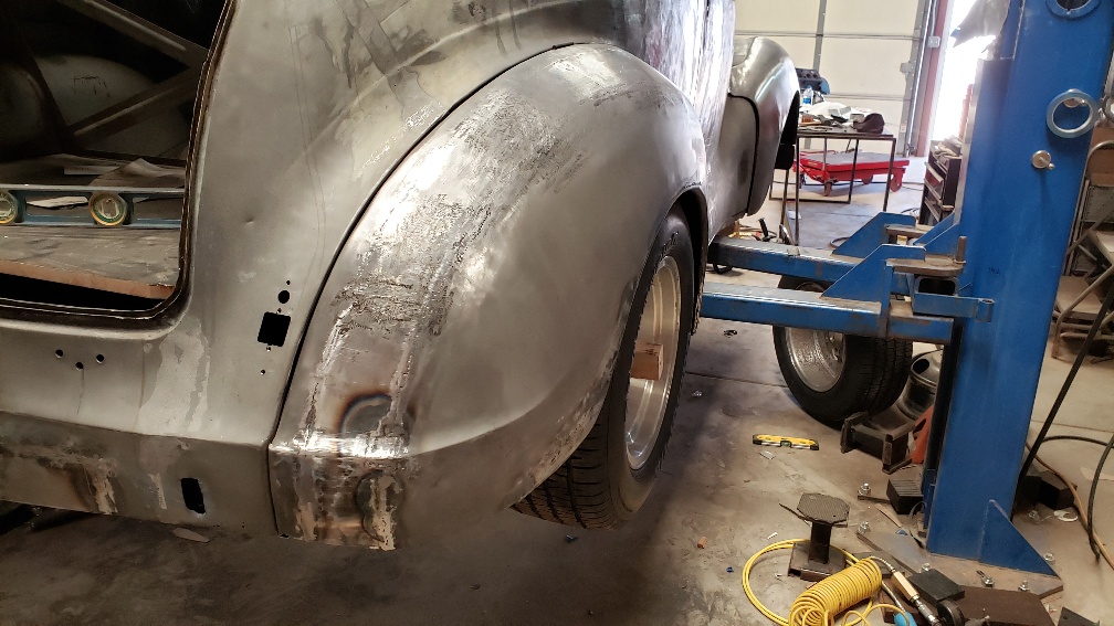

    IMG_1749.JPG IMG_1750.JPG IMG_1751.JPG After looking at your work, I reconsidered gas welding. Actually, my gas welding skills haven't deminished; I was looking at my poor mig tack welding job. Zapped the fender and kept blowing holes due to the metal not being that clean. This is on the front of the rear fender that had fatigue cracks. Couldn't clean it good since it was a bit spindly. Clamped the pieces together with vice grips and it tacked together way better with the torch. Still haven't done much with the tig. It is like Maxwell Smart using the "dome of silence". It never works but I keep on trying. It is a cheap welder made in China that I keep modifying. The latest problem is in the patch cord from the foot pedal. There are 5 wires in that and they are such a small gauge that they keep breaking where they are soldered to the 7 pin connector plugs at the ends. Now I have ordered new connector plugs and I will try bigger wire next time.

  26. indyjps
    Joined: Feb 21, 2007
    Posts: 5,397
    indyjps
    Stick with gas welding, much easier to hammer and dolly.
