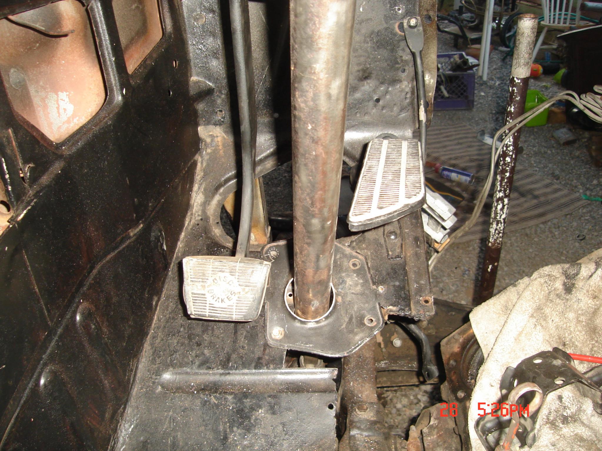

  16. iwanaflattie
    Joined: May 14, 2011
    Posts: 4,187
    iwanaflattie
    I been messing around with my pedals and I started adding more itemsto the engine.
    I need to Bleed the brakes,
    finish installing the E-brake
    ,Getting a Dodge Truck radiator,mock it
    and make the Rad mounts,
    engine oil cooler mounts and a shroud,
    Buy brake lines for the Transmission-cooler lines
    Buy a fuel pump
    Clean the Gas tank
    Run fuel lines,
    Make a temp wiring job
    so I can take it for a spin.
    Before and after pics on the pedals.:
