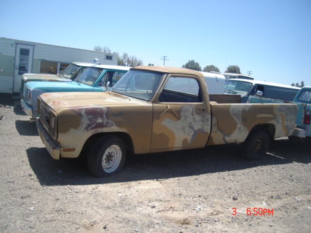

    Hey G's
    Progress has been slow.
    I mostly stare at the coe,its too hot to fart around it.
    I mostly daydream or plan.
    Planning is fun and cheap.
    I been thinking about the c20 rear end.
    Originally the c20 had a 4 speed with a low 1st gear I think,So I ***ume the Rear end is not very highway friendly.
    I was thinking if a mid 70s Dodge truck rear end has better gear ration than the chevy.
    I hope someone chimes in so I can save a Dodge rear end before they s**** the trucks.
    Thanks.
  24. BuiltFerComfort
    Joined: Jan 24, 2007
    Posts: 1,619
    BuiltFerComfort
    Gear ratios are all over the place in trucks, you need to measure it (not hard to do if the rear is off the ground). What would your lug nut pattern be with a Dodge rear end - could you match the fronts?
  25. iwanaflattie
    Joined: May 14, 2011
    Posts: 4,263
    iwanaflattie
    I could Jack the rear of the Dodge.
    The dodge trucks have the 8 lug patterns,Same as chevies I was told.
  26. You're back!
    Find out your ratio first, like BuiltFerComfort said, they can be all
    over the place. My '69 Dana is a 3:42, I had a mid '80's corporate
    that was a 3:73.

  27. BuiltFerComfort
    Posts: 1,619
    BuiltFerComfort
    I had a 3.08 and I've heard of ones with 4.56 gears too. 3.73 & 4.11 are good with OD trans and 30 inch tall tires.
  28. phat rat
    Joined: Mar 18, 2001
    Posts: 5,087
    phat rat
    The older 8 lug were the same pattern just different size center hole. I don't remember for sure but I think Chev was the smallest

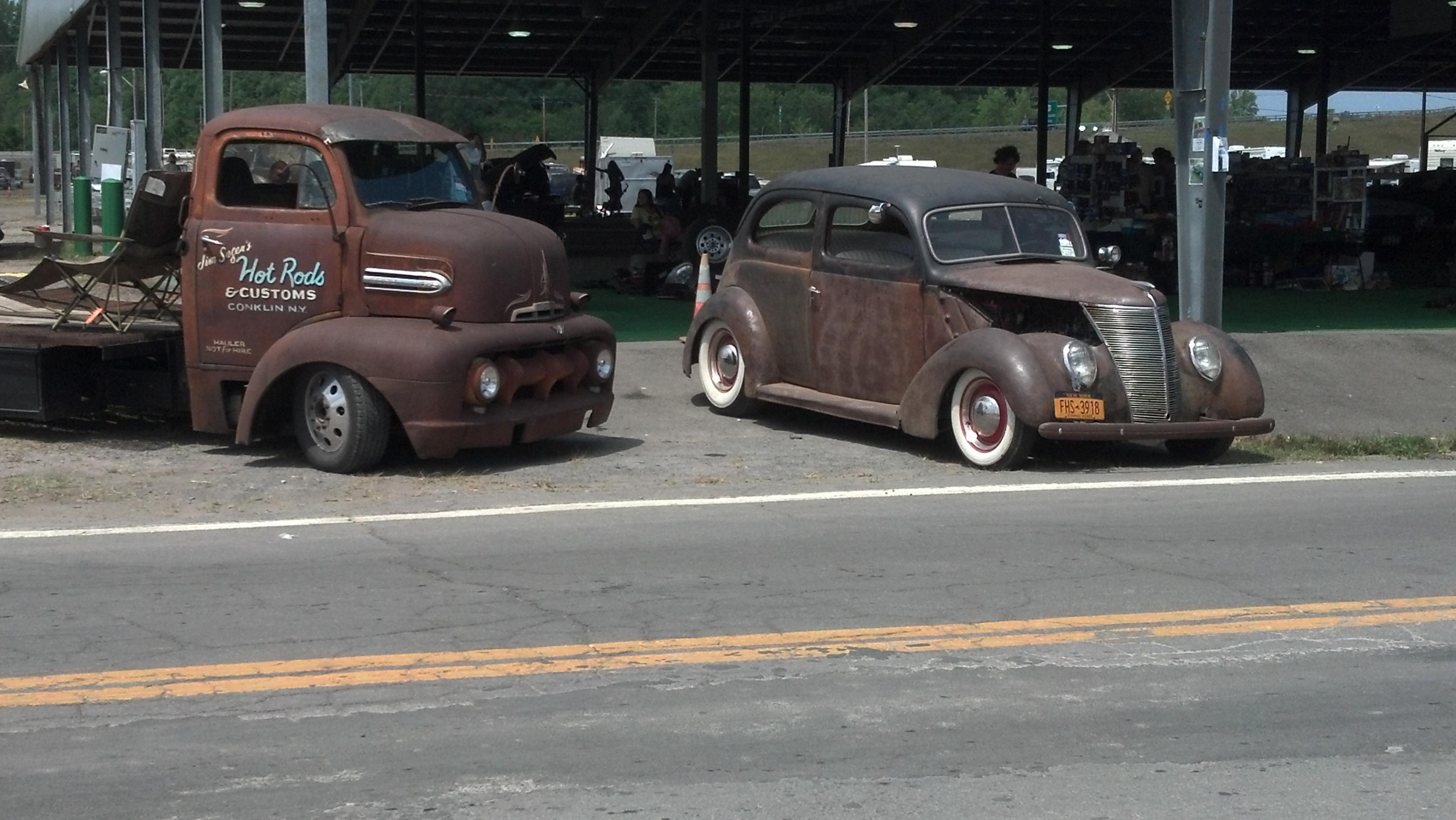

    Love the look..
    Im on my 7th COE...I too am building a Coe pickup but mine is a 50 F5 and have it mocked up on a mid 80's chevy millitary 1 ton 4x4 single wheel pickup ch***is, I'm not really a lifted truck kinda guy so I;m not feeling it...here is a pic of my daily driver....built it 3 years ago..80's chevy 1ton on air ride.
