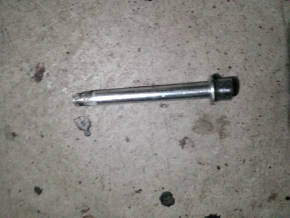

    One day you're king of the hill the next day you get overcharged a $3 dollar flapping attached for $ 20.00 and can't make a return because of the virus,your truck won't start and you have to use the comealong to back it into the garage.
    Also the started bolt brakes and it might be the reason the starter was making grinding noises.
