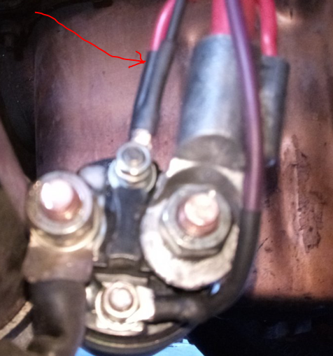

    The purple is hooked to the ignition I believe...I gotta dig my notes..
  2. Bandit Billy
    Joined: Sep 16, 2014
    Posts: 16,137
    Bandit Billy
    Purple is kind of the universal GM color for the wire that runs from the ignition, through the neutral safety switch and on to the starter solenoid to energize it. I plumb all my cars alike so I always know where that wire is headed. I have a friend that is color blind, man I hate working on his cars. :cool:

    If I go with the 3 post starter...can I just "add" the smaller red and black to the red "battery" wire going to the fourth post?
    They are connected anyways right?

    If I'm not mistaken the other small terminal by p***es the resister wire for the ignition so it is only hot when the starter is energized to give the coil 12 volts on start up.

    Not knowing where everything is headed I'd be shooting blind. On a 4 post GM starter the two small posts are labeled R and S. I cant tell from the pictures the labeling on the solenoid. The purple wire (ignition switch) should go to the S post. The R post is used on early GM vehicles to supply voltage to the coil during cranking I believe.

    I have seen a lot of wiring diagrams that run the one wire output on the alt to the starter like the above. I prefer to run it through a kill switch but that is just me. On your photo, where are the red and black leads on the other small solenoid post headed? Are they the + coil leads? Why 2 of them and why is one black?

    They are only connected when the starter solenoid is energized to start the engine.

    So I just peeled the "black" wire you just asked about, It is the soleniod wire (red) with a "fusible link"(black) it goes to the "Battery" side of the ignition switch
    the RED wire is attached to the BIG RED BATTERY cable ,I honestly dont remember why I connected it like that it didnt come with the kit...it can be cut off..
    Thats easier to understand,the way I had it with the smaller wire coming out of the POSITIVE side of the battery Cable,,the solenoid was energizing the solenoid and coil at all times..

    That explains why it is black and on + post. Always scares me to see black wires on positively charged posts. Makes me think of fire extinguishers and sirens.
    I could go scan your post but it's late, what are you running for a distributor and coil? Where is that fusible link headed?

    The fusible link heads to the battery terminal on the ignition switch...the ignition switch has the purple wire u see on the starter post that energizes the starter to spin...
    The ignition switch also has the coil wire that supplies 12v for starting and running...
    I believe I can hook the battery and solenoid wire together and leave the purple(S) Switch wire on the other terminal... I will try tomorrow

    But in the end I swapped solenoids and everything is good to go
