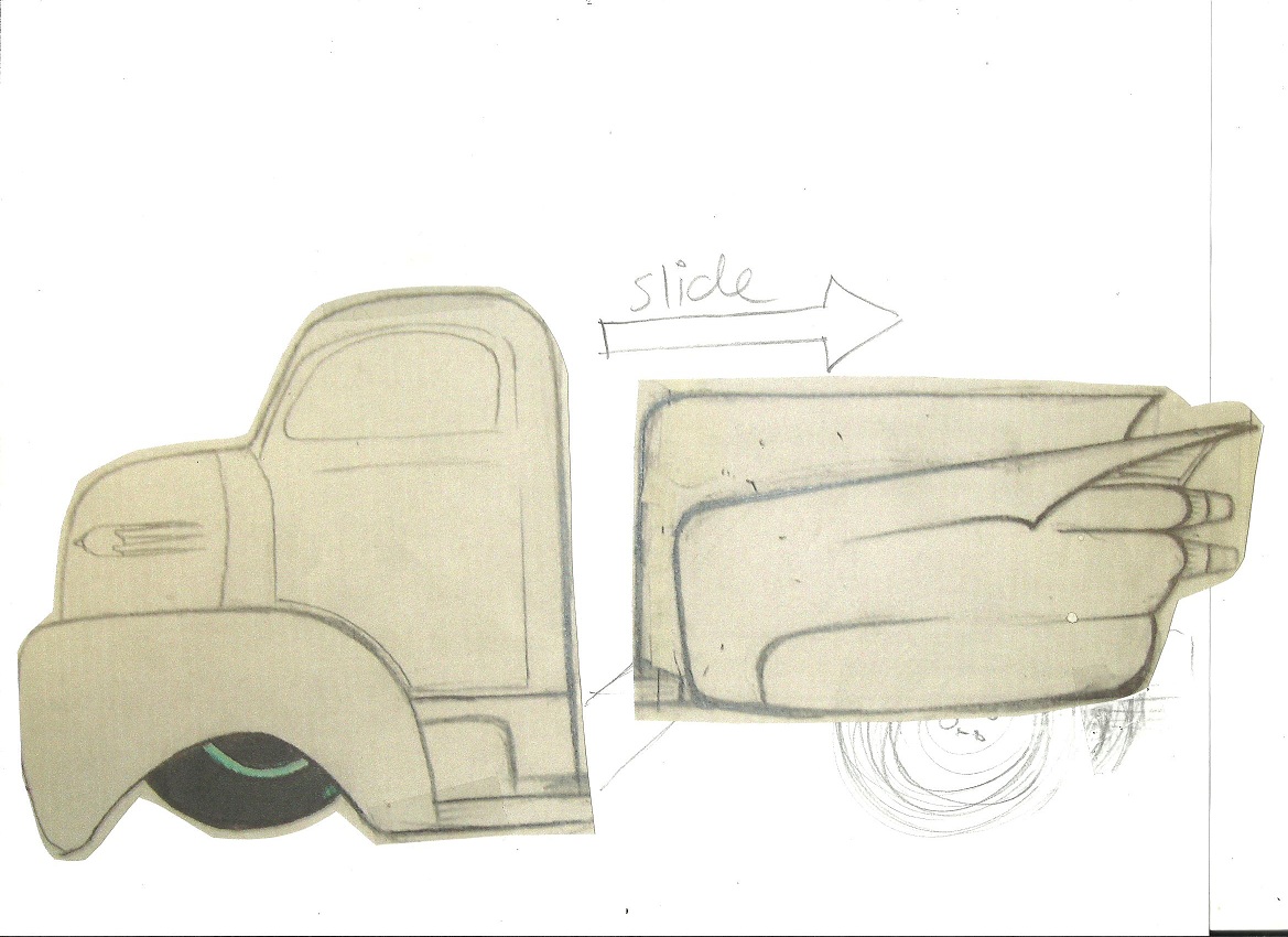

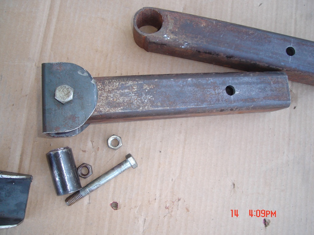

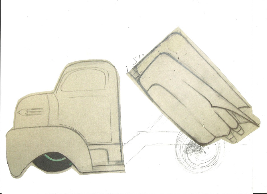

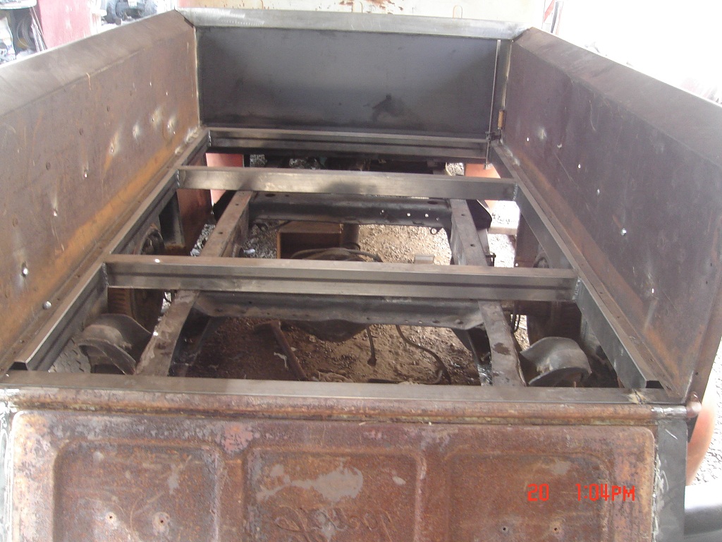

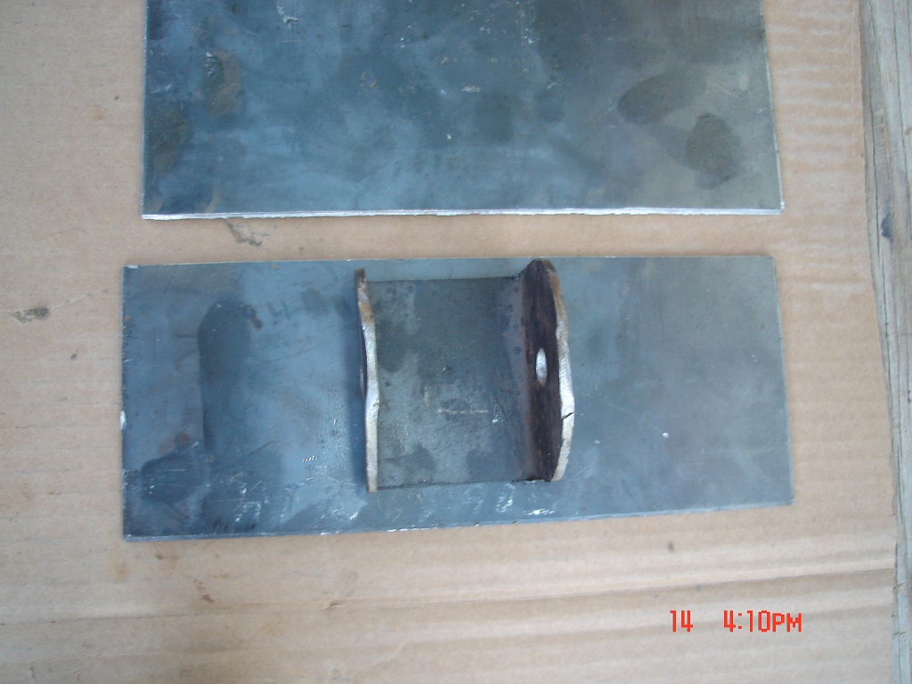

    MANUAL TILT BED BRACKETS:
    Well I wanted to make a tilt bed.
    Mainly because when I was working on my f1 I had to take the fenders off every time I wanted to bleed the brakes or replace shocks,change tires etc...
    Its a pain....
    Well I plan to make the cab tilt forward also for regular maintenance.etc.
    If I leave the bed stationary,I cant tilt the bed or the cab because the bed header panel hits the back of the cab.
    SOLUTION:
    Make the bed slide backwards about 10" and then lock it somehow to tilt it.
    I been looking at the sliding trailer hitch set up and I thought:"Why not"
    NOTE:This will only be a once a month deal just for maintenance,I don't plan to use the dump everyday.

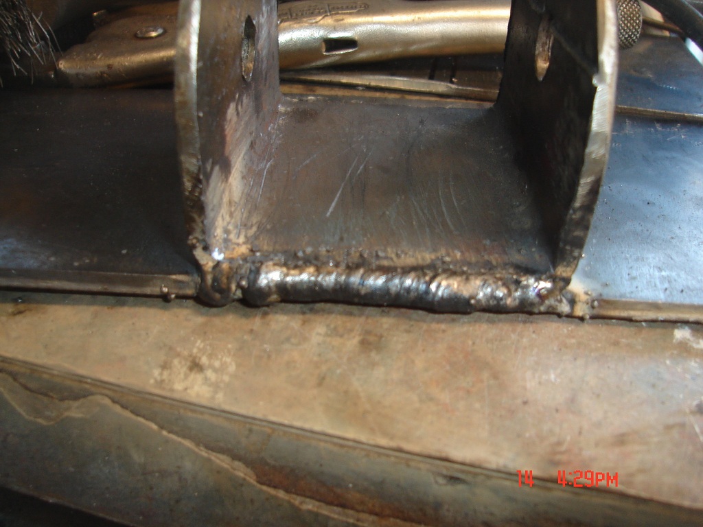

    Tomorrow I will try to finish with the front bed sub frame mounts and wheels..I will use 2 jack wheels and a channel to keep the bed nice and straight while I back it up.
    Eet will be too many nice!
    tb33anda3rd likes this.

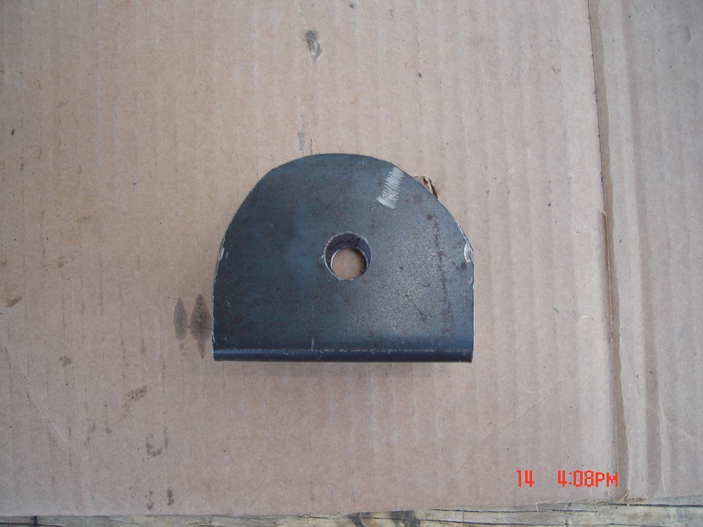

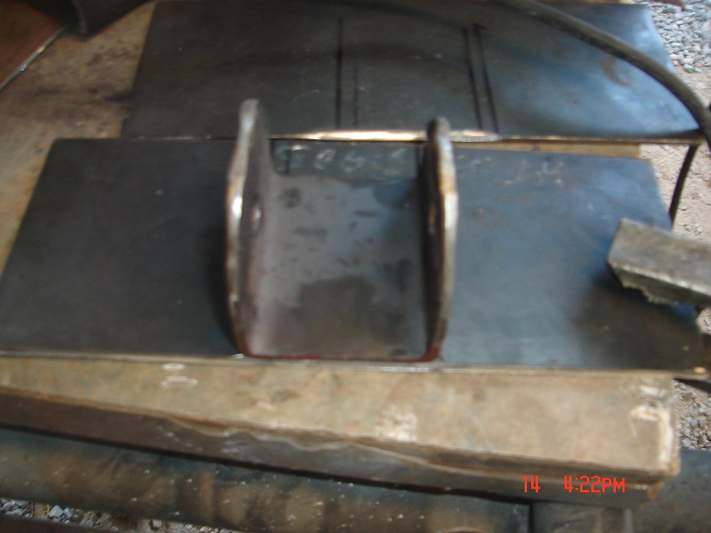

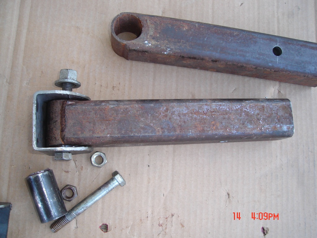

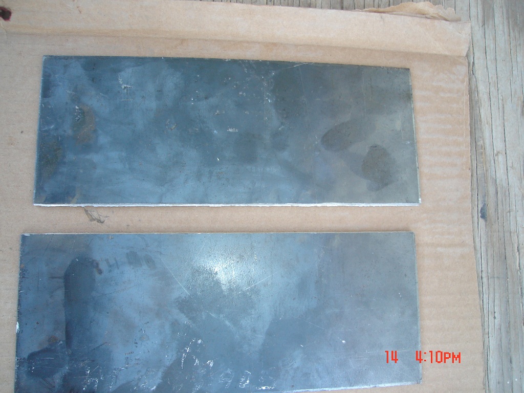

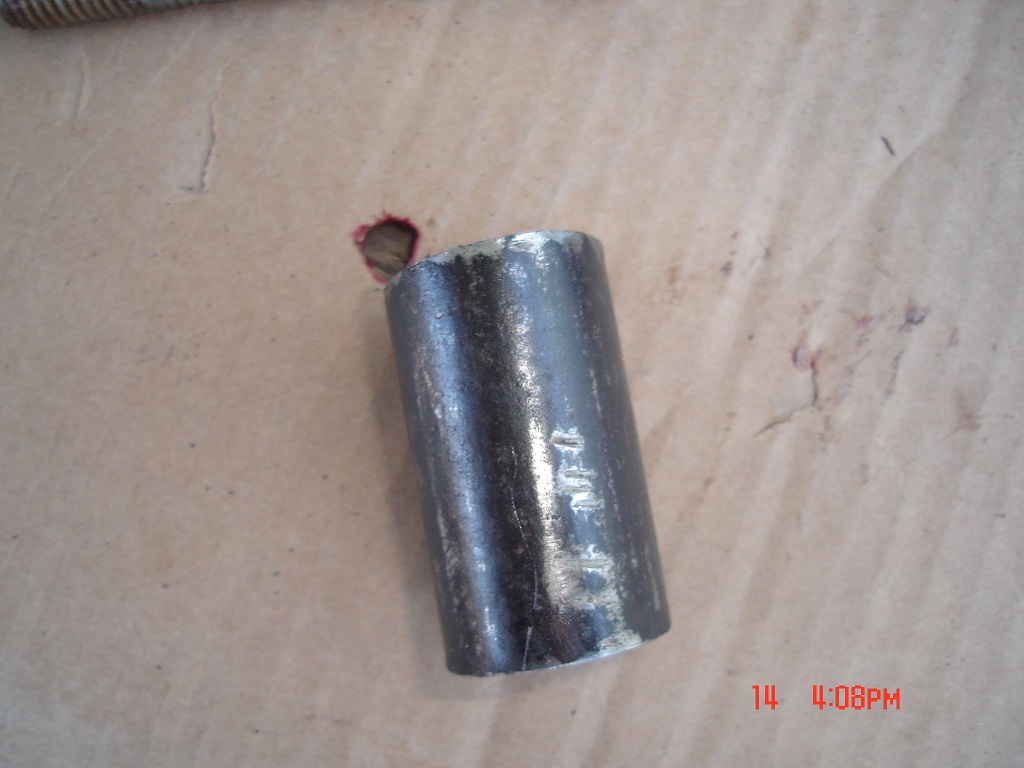

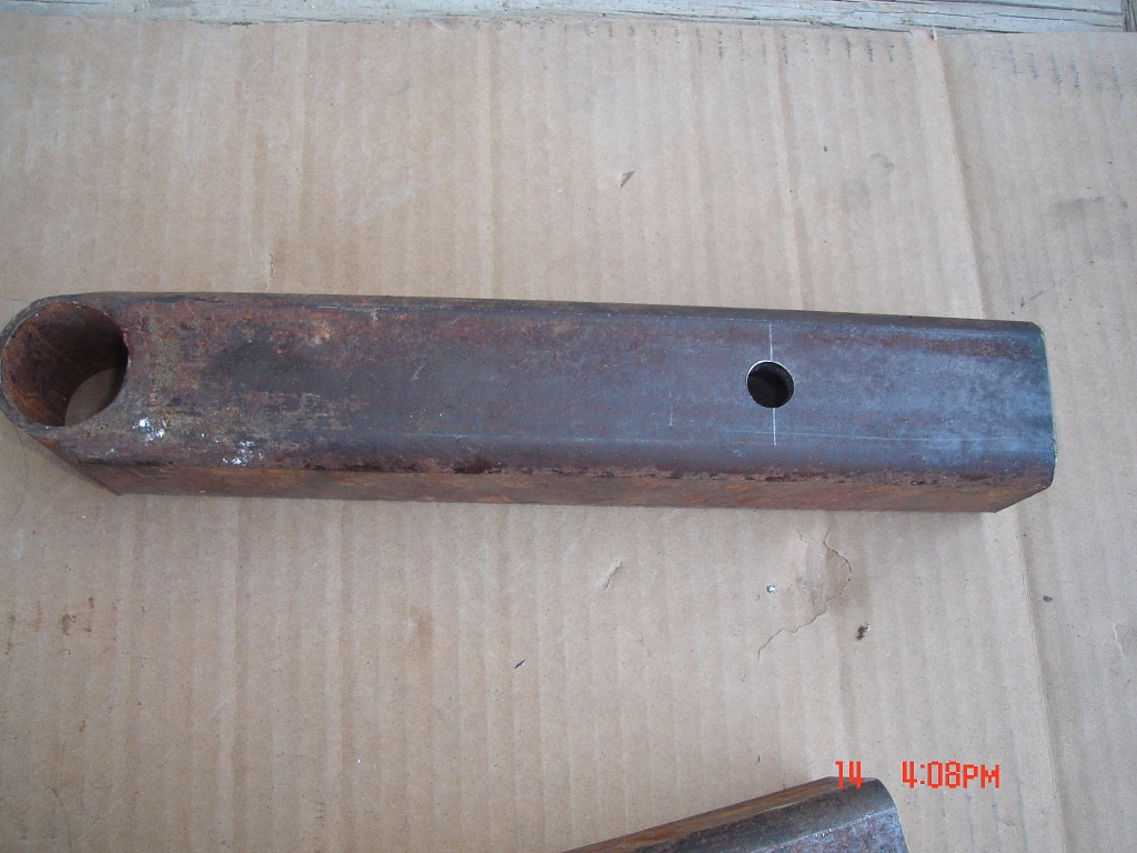

    So the bigger square tubing (NOT PICTURED) will be welded to the top of the frame rails on each side.
    There will be 2 holes on each tube,1 will be in the normal position with the header panel behind the cab and 2 will be slid "backwards" to clear the back of the cab.
    A removable pin will be need to take off and slide in position as needed and a lock ring trough the pin.
    (think of it as your hitch deal)
    The bed subframe mounts with the wheels will also have a pin with a lock ring.
    The wood floor will be a 1 piece floor that slides back to remove such pins.
