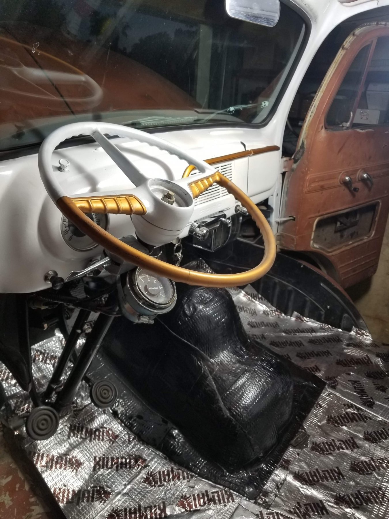

  8. iwanaflattie
    Joined: May 14, 2011
    Posts: 4,263
    iwanaflattie

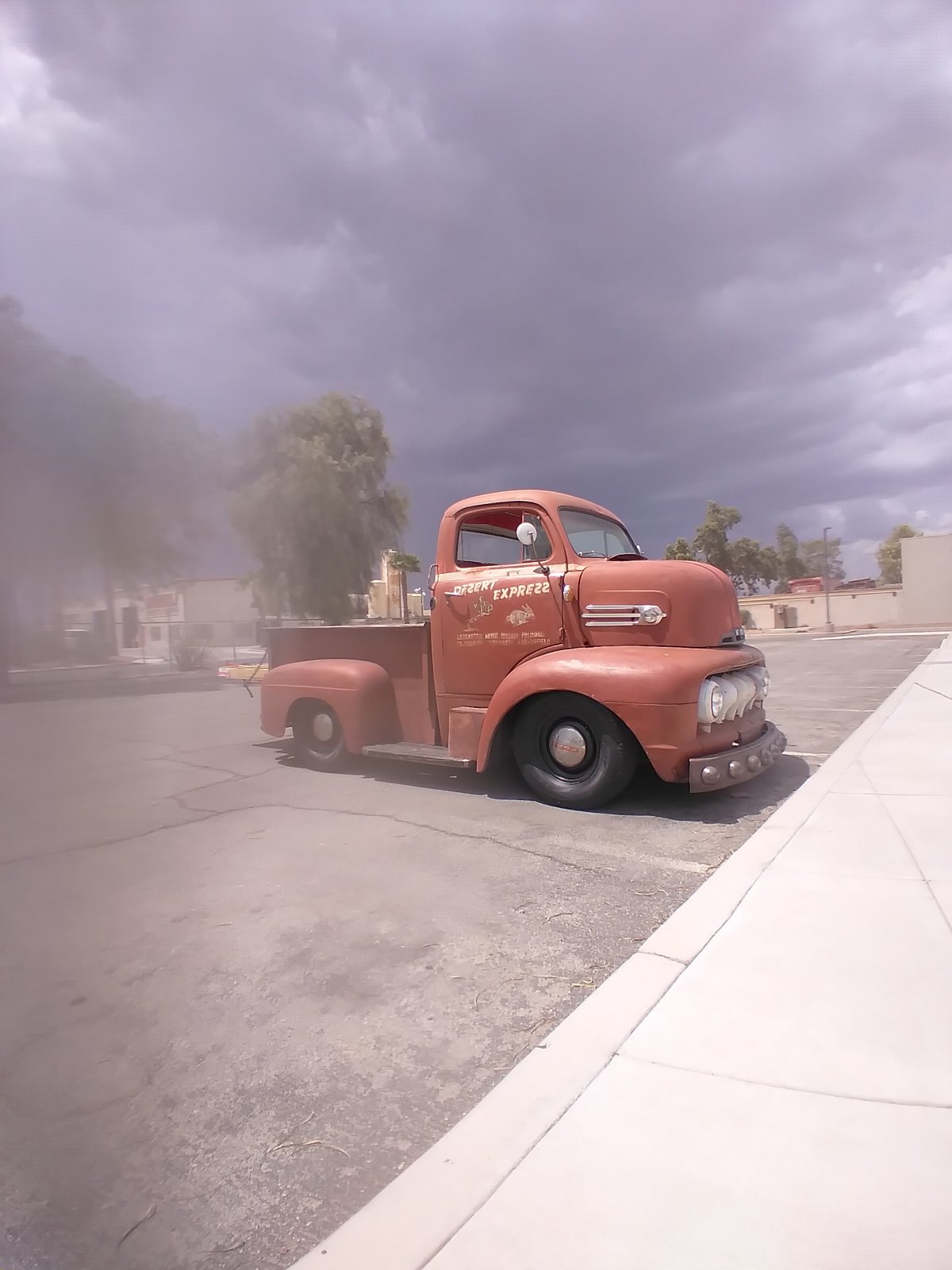

    Hello Hambers.
    Im happy to report that the truck is running great after a carb swap..im going to let it sit for a week and start it next weekend.
    I installed the aftermarket fuel tank in the rear and ran a new line..
    I still have a flat spot in the transmission shifting.
    It wont kick into 3rd when im going 1k to 2k..only when i rev to 3kto 4k it kicks in and it starts going through the gears.
    It drove around town where i found it and it went to get its own fuel..
    Swapped the alternator and added some power steering fluid that im losing somewhere..
    It drove great..
    20210110_091402.jpg 20210110_091402.jpg 20210110_091441.jpg 20210110_091410.jpg 20210110_091459.jpg 20210110_091507.jpg 20210109_125147.jpg 20210103_150628.jpg 20210103_150639.jpg 20210103_150546.jpg
    Outback, JOYFLEA, Lepus and 12 others like this.

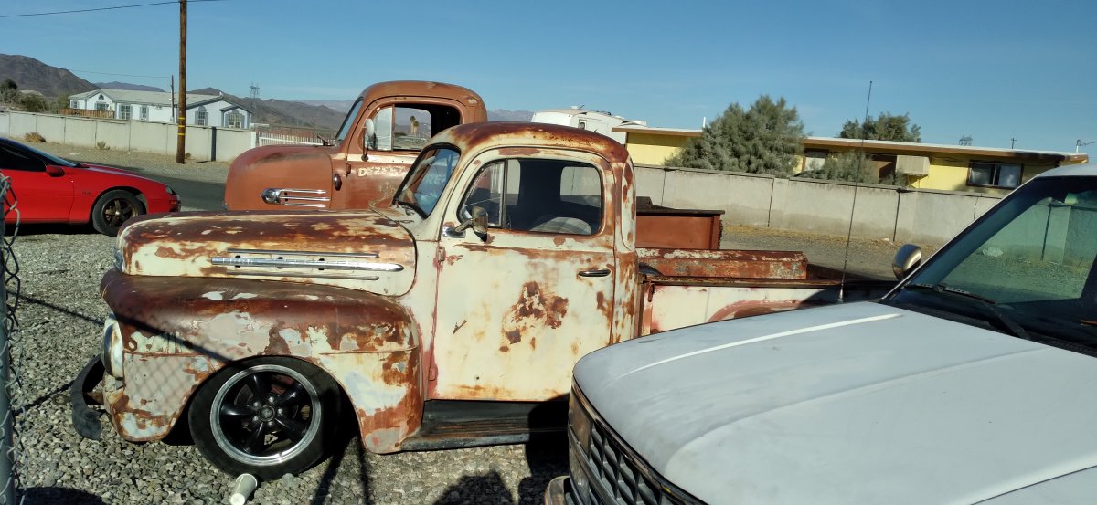

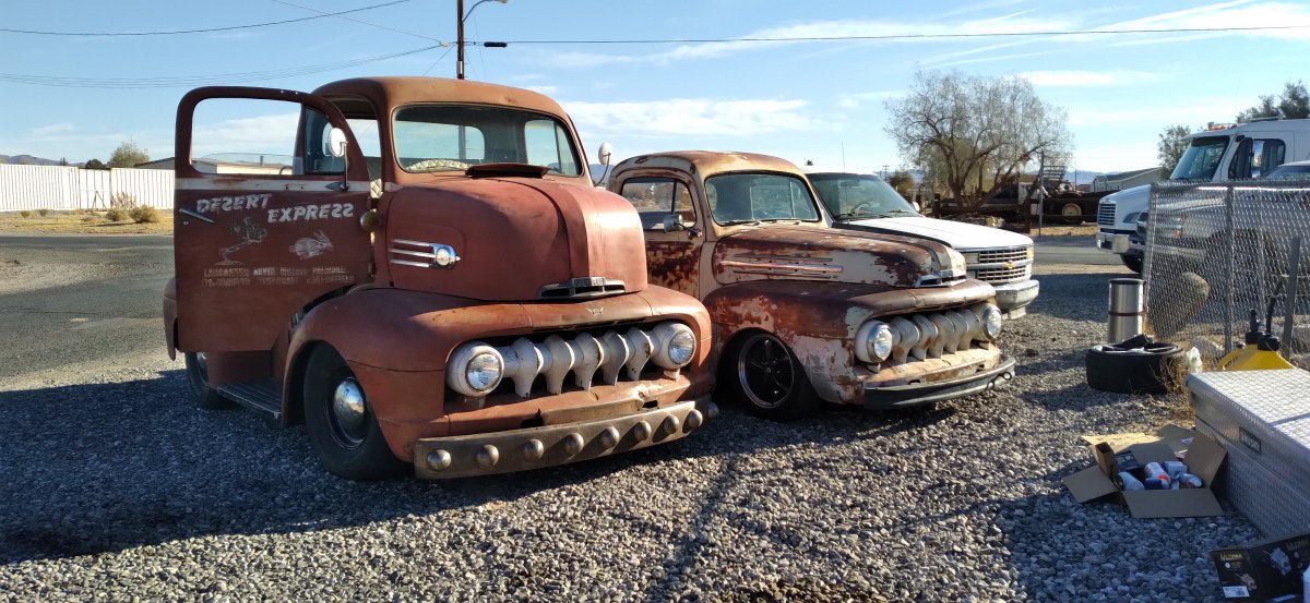

  9. warhorseracing
    Joined: Dec 26, 2006
    Posts: 2,834
    warhorseracing
    from cameron wv

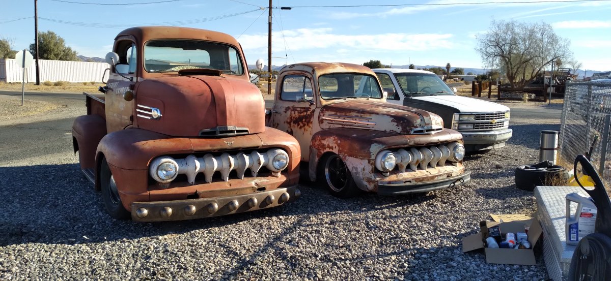

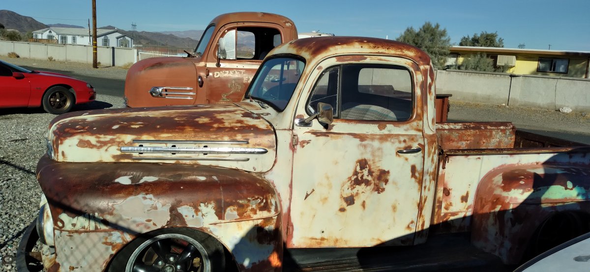

    What's the story of the pick up parked beside the COE? Please enlighten us.
  10. iwanaflattie
    Posts: 4,263
    iwanaflattie
    That was my first truck.
    I bought it in Perris Ca,in 09.
    It was complete and running but the guy was in the middle of a step notch and homemade 4 link and quit.
    I bought it with the unattached rear axle unattached bed and fenders,called a tow truck and I took it 180 miles home..
    I reworked the rear and got it running..
    My friend bugged me to sell it so much that i gave in.
    It needs a lot of work
    warhorseracing likes this.

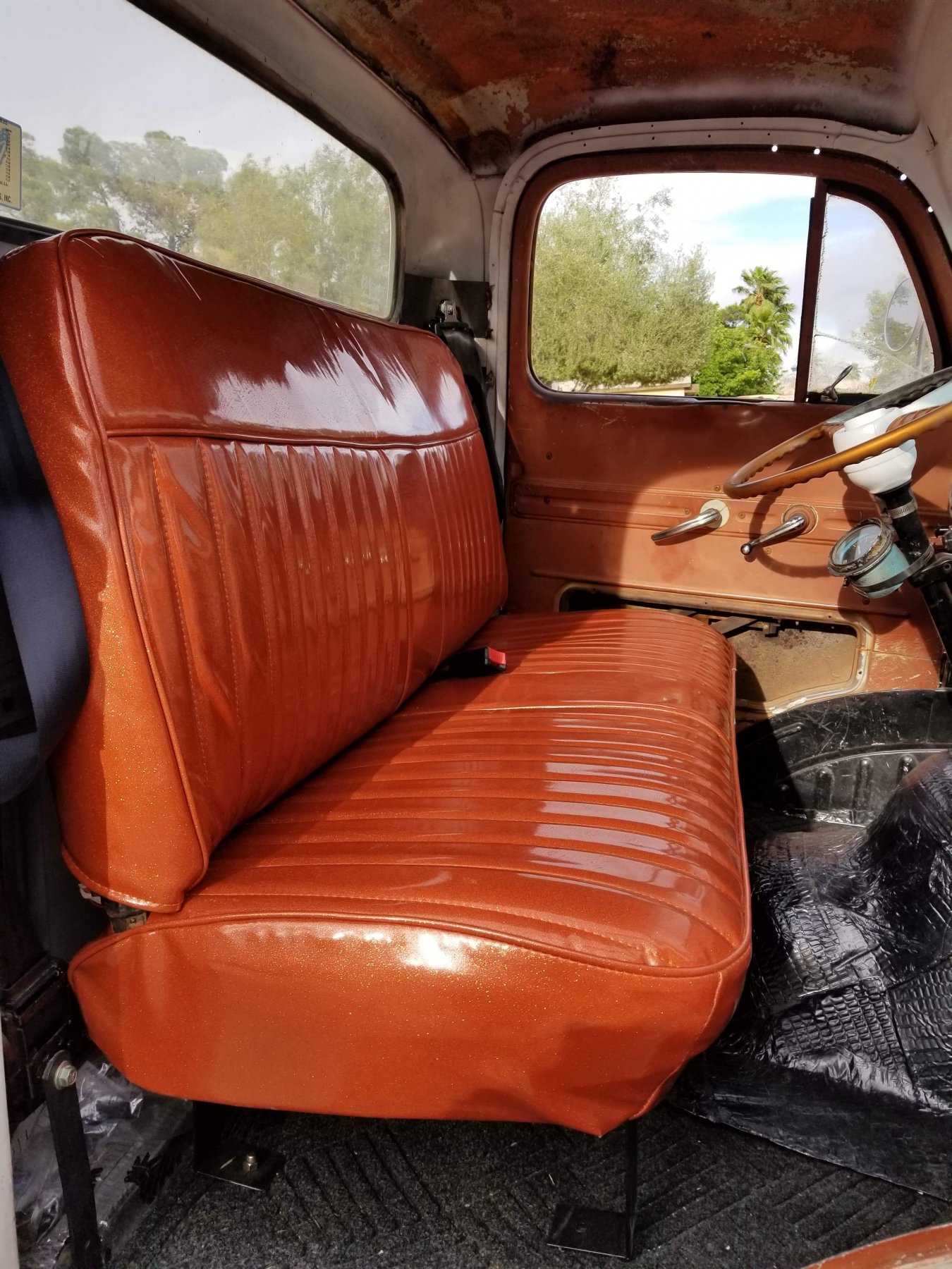

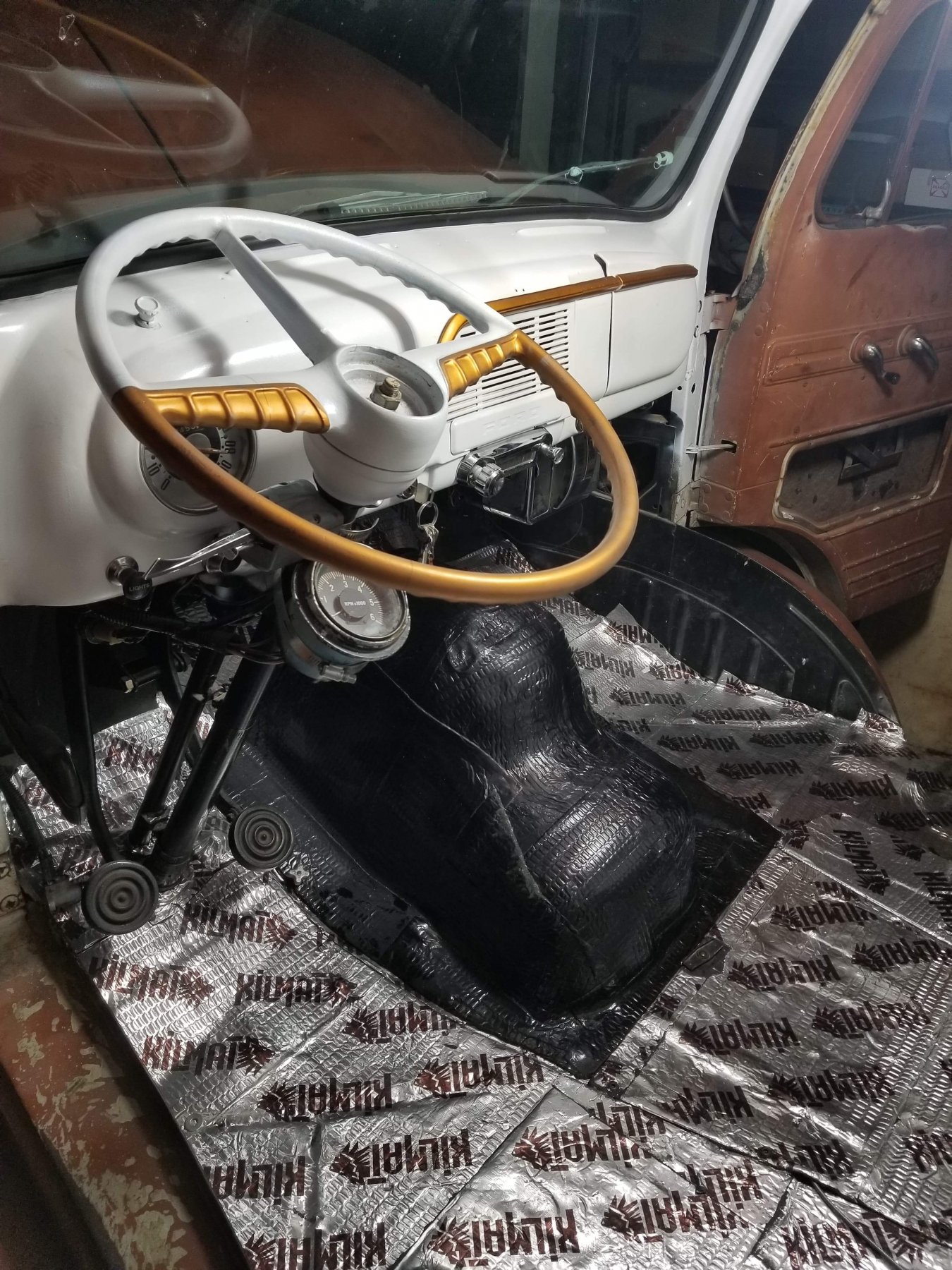

    Got a bit more work done and got to drive my coe

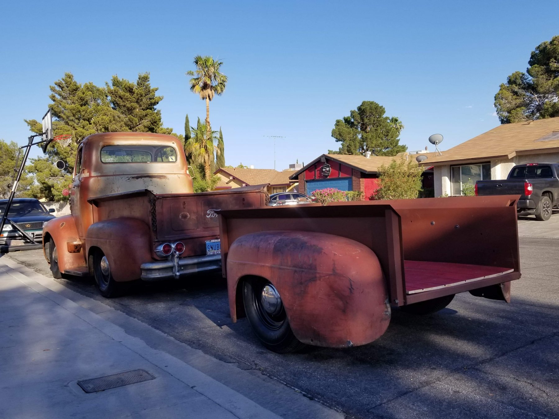

    Are you going to rebuild that camper? It looks like a late 40's model. Are there any manufacturers names on it or is it home made?
  24. iwanaflattie
    Posts: 4,263
    iwanaflattie
    It says 'Taylor" on the sides..
    I dont think its home made.
    The leaf springs are covered in leather and the inside is very well made with kitchen,bedroom etc..
    It has to be 1930s,1940s..theres stainless steel hardware and appliances.
    The plan is to restore it after im done with a couple of projects.

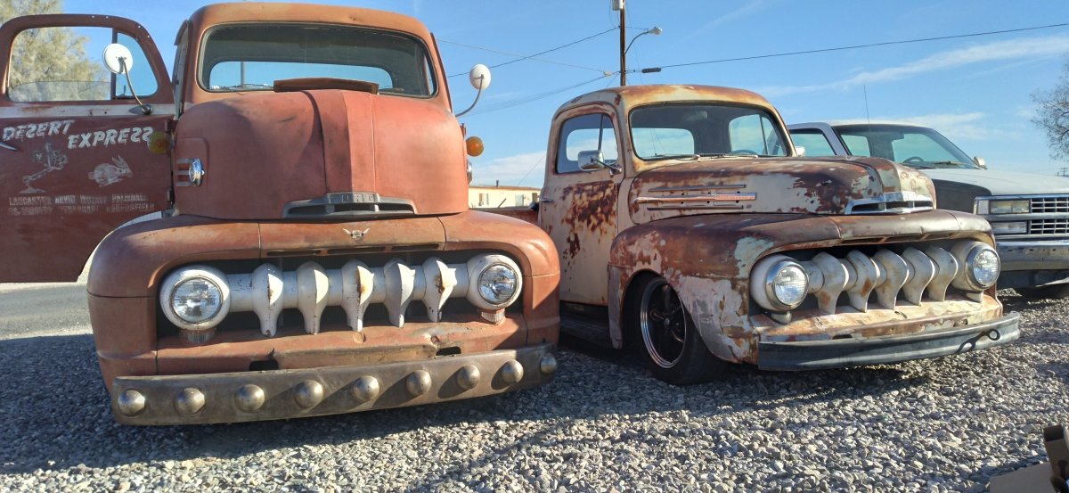

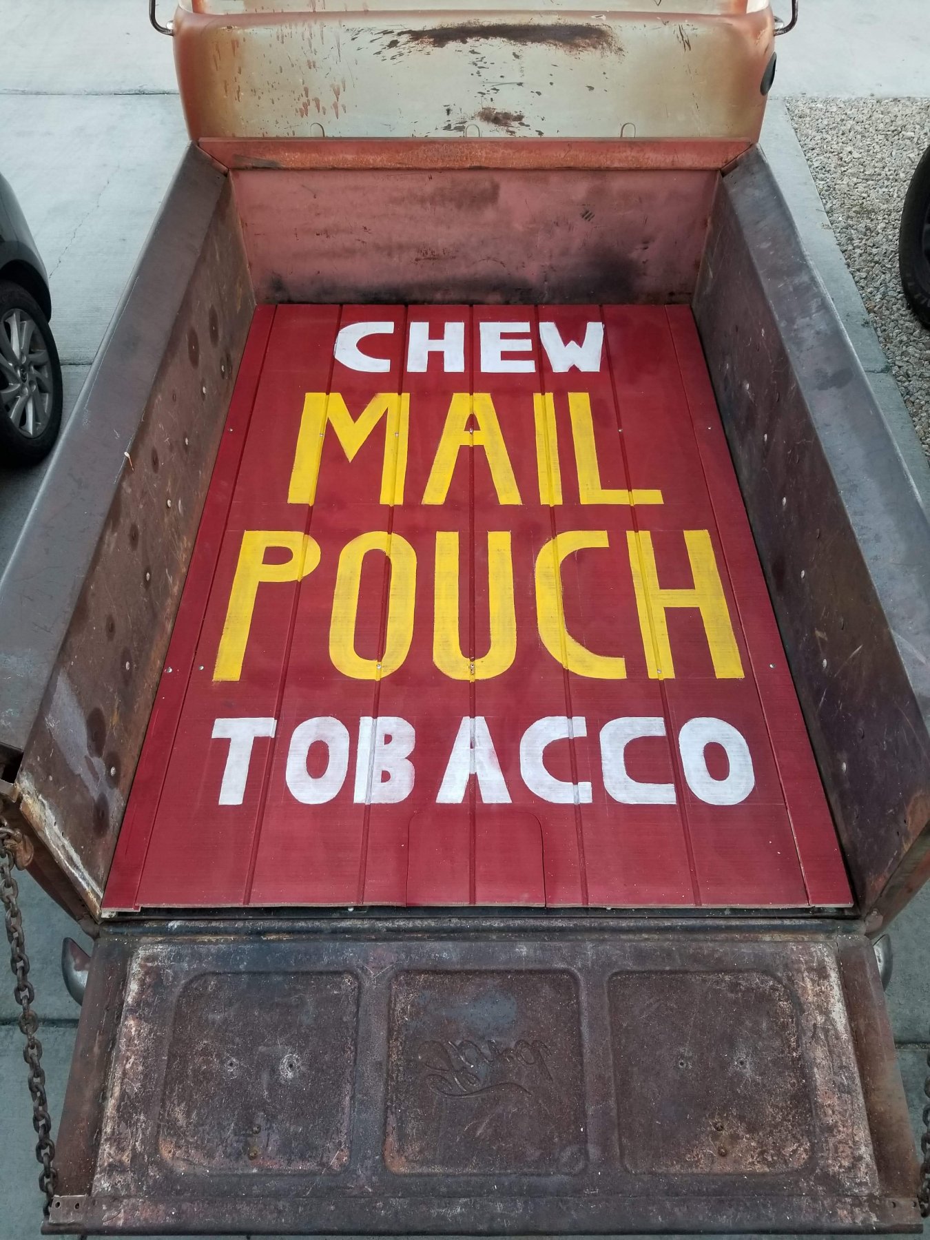

    HEllo hamb world. I've been driving the COE around Vegas and I gotta say,its running very well.
    I even took it on the freeway last Thursday.
    It did pretty nicely 65mph@ 2k rpms..
    I have to raise it or put stiffer springs because
    It'll bottom out in bumps and such..
    The coe is residing in its new house where hopefully more projects will come out rumbling out.
    I did run out of gas on Thursday so a gas gauge is in the plans and I replaced a very leaky power steering pump.
    Well till next time.
    Here's out side school playing with the big boys

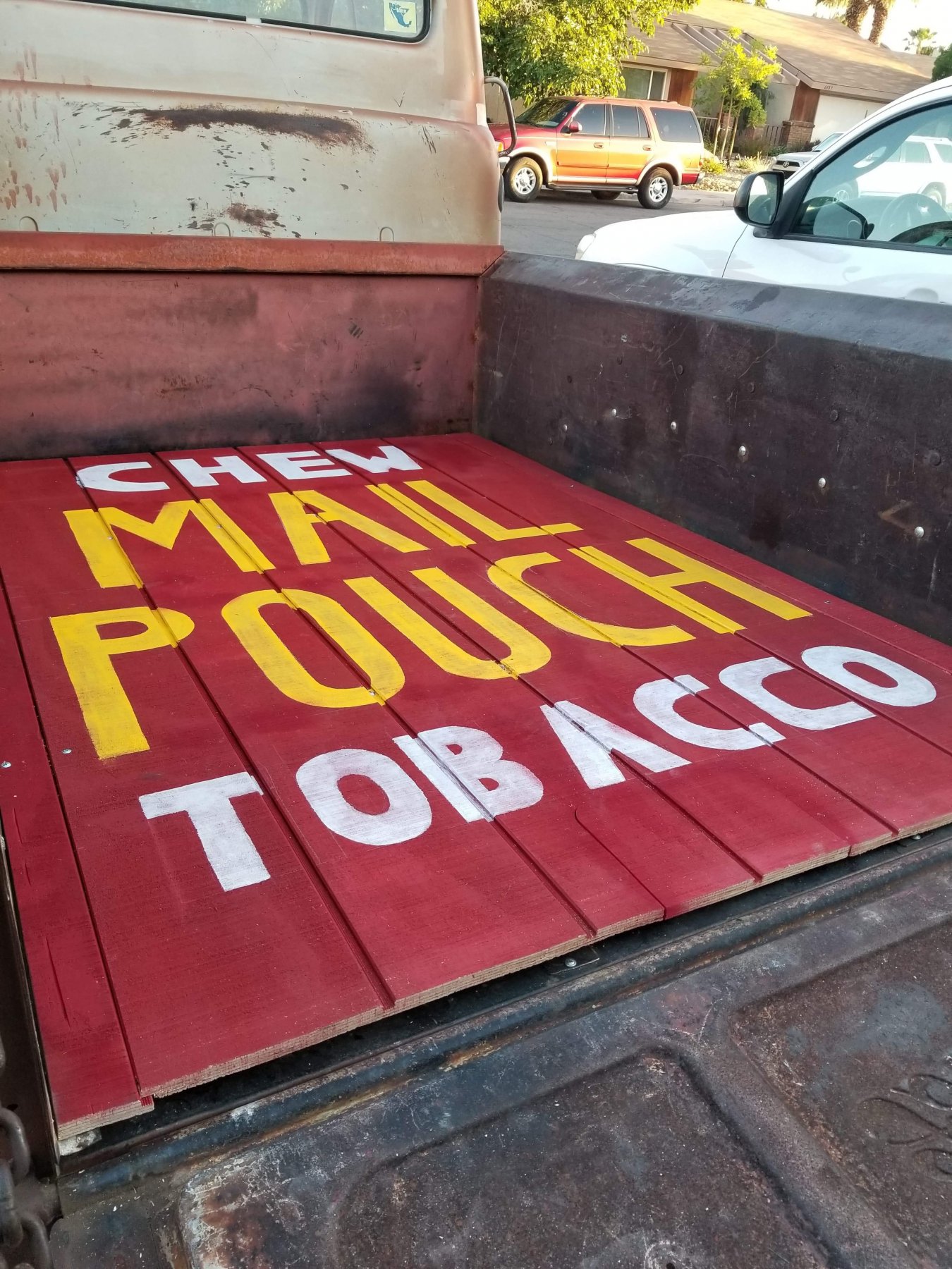

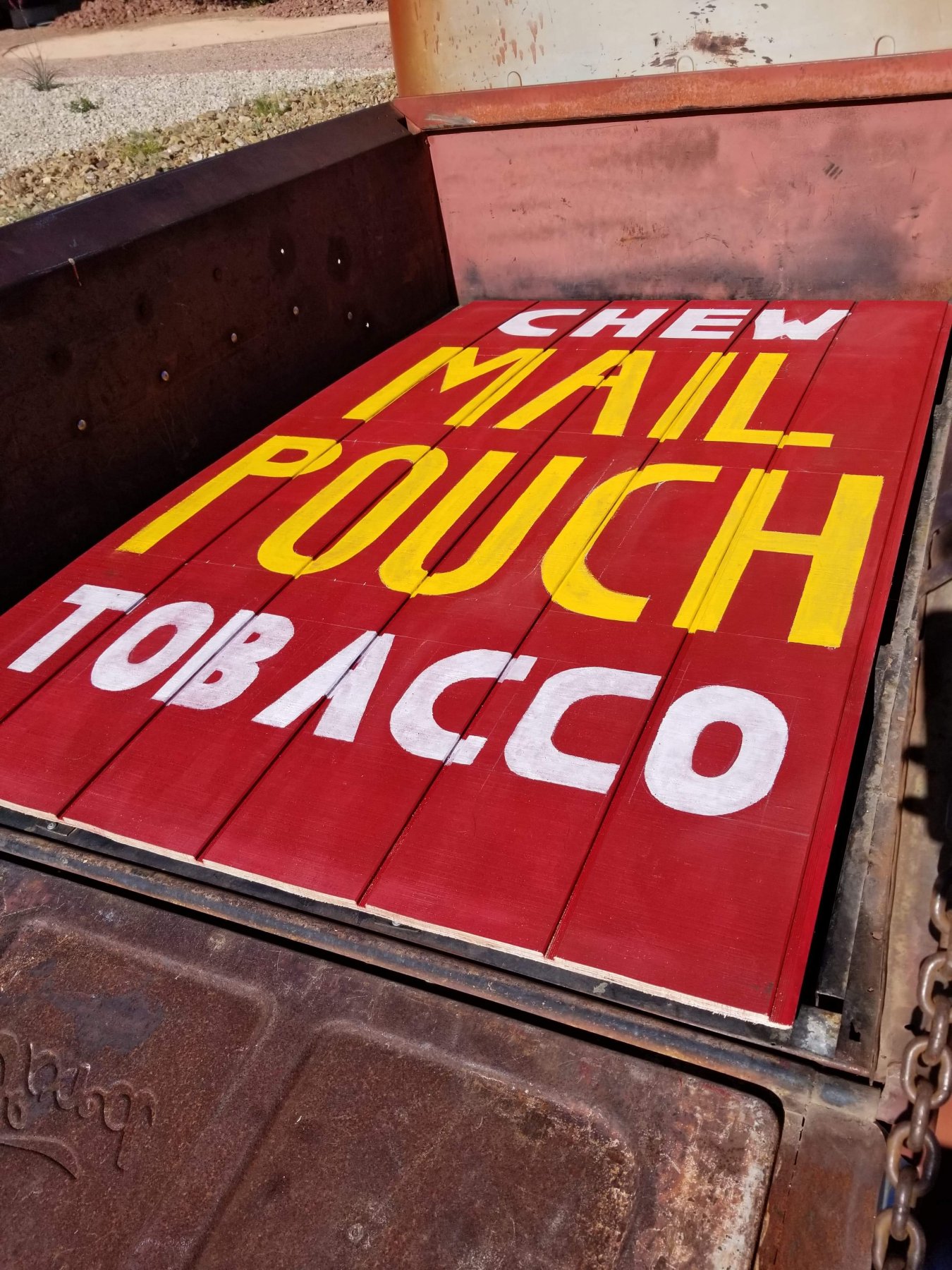

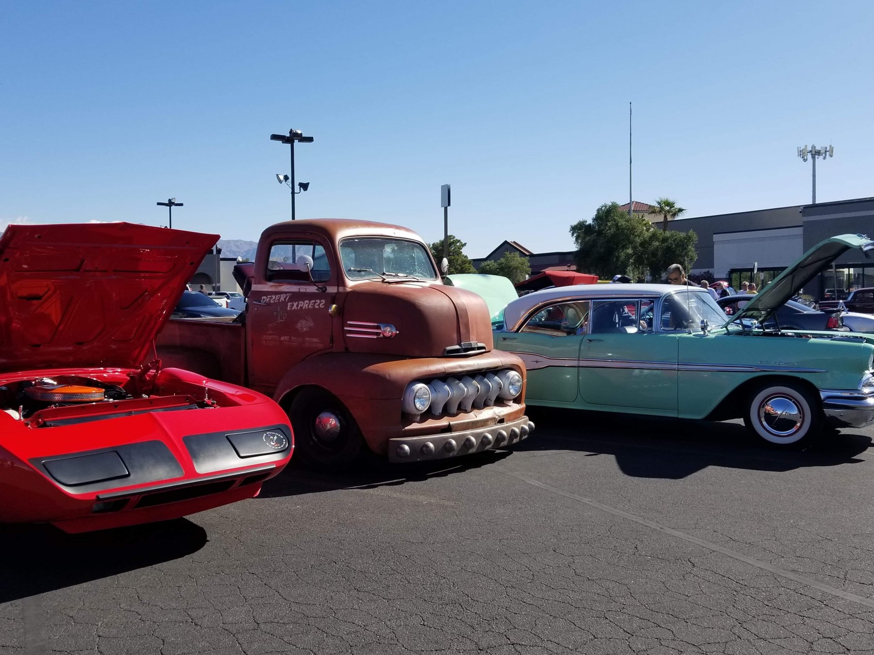

    I've been busy between shows,work,building a matching trailer etc.
    received_1380740252305592.jpeg received_1380740252305592.jpeg received_815776452402729.jpeg received_523559028992069.jpeg received_321811796209982.jpeg received_1377194515980763.jpeg received_873769650227677.jpeg received_1202794400162307.jpeg received_969910060487448.jpeg received_314014133566030.jpeg received_168177801922454.jpeg received_529597344880980.jpeg received_795631101357718.jpeg received_455877622141351.jpeg received_171704614817465.jpeg received_448227479807680.jpeg received_3975463015870714.jpeg received_387315418982383.jpeg received_206586887681743.jpeg
