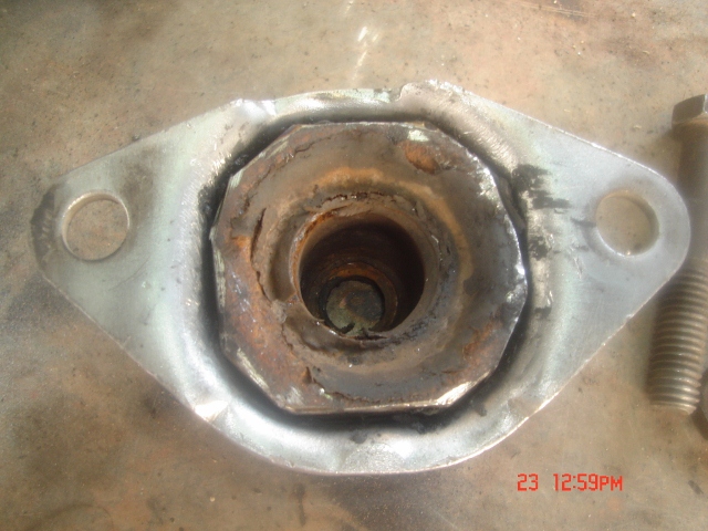

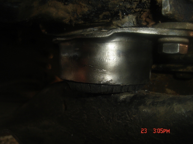

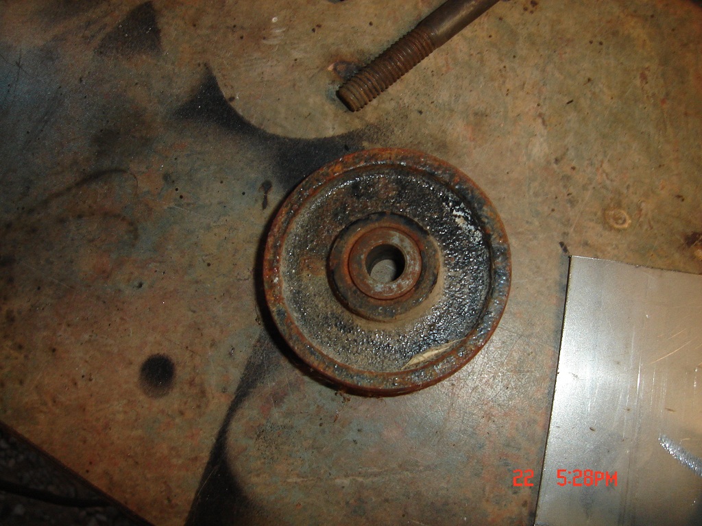

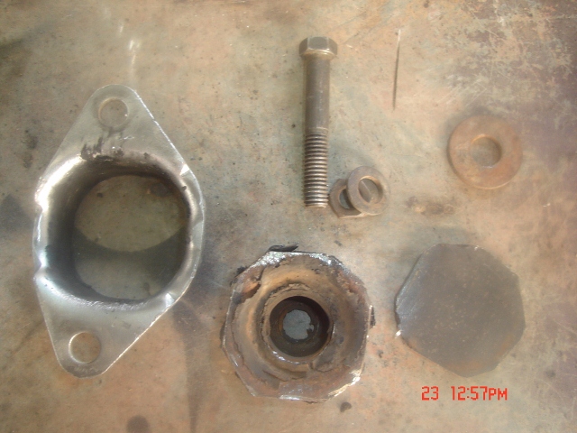

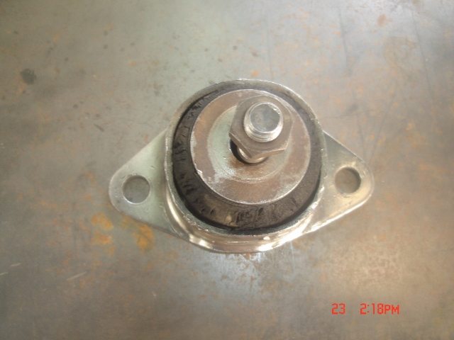

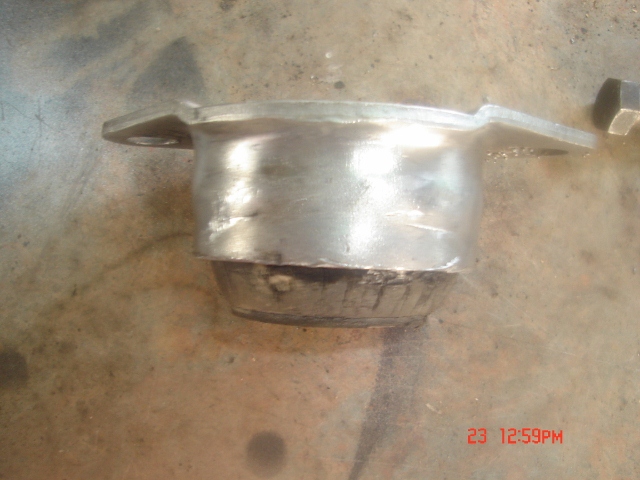

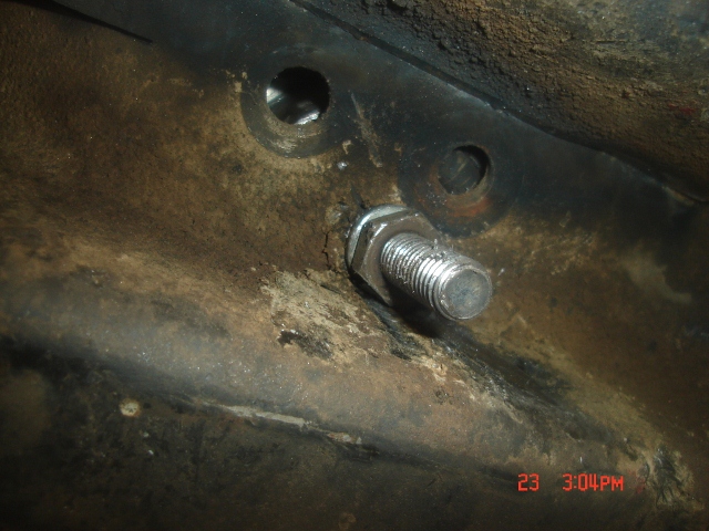

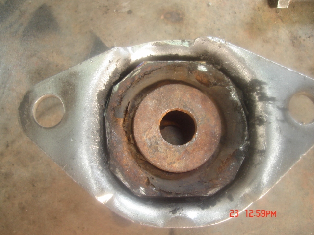

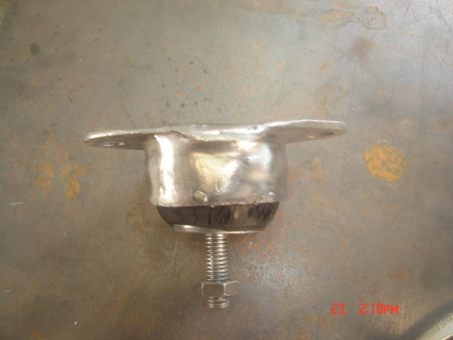

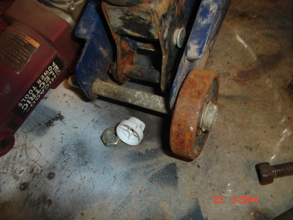

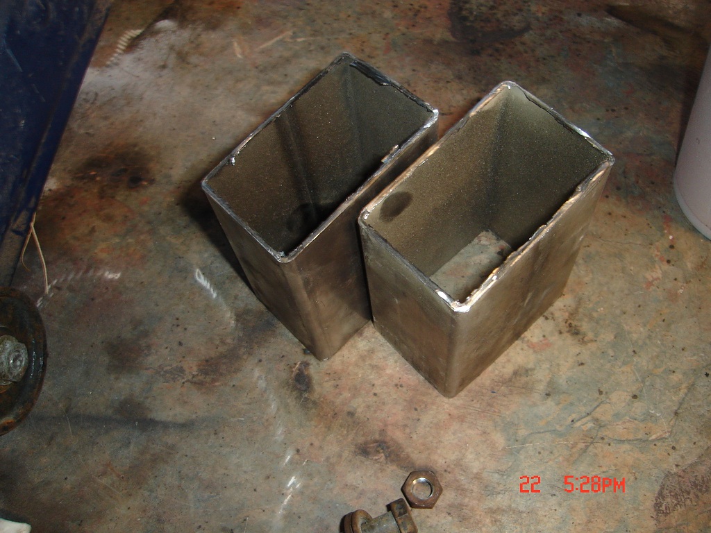

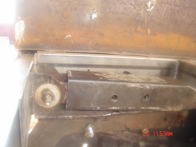

    ****** MOUNT:
    No I'm not going to tell you the correct way to properly mount that hot Brazilian waiter/waitress on Sunday nights when your wife is out playing bingo but...... ,that's another forum...
    Unless you want to? Well you gotta move stuff around like the ball sack,,,What???
    SLAP!!!
    BACK ON TRACK.

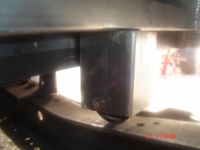

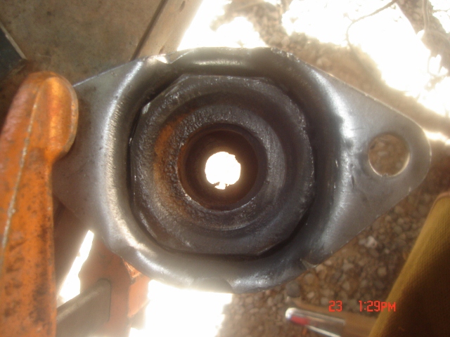

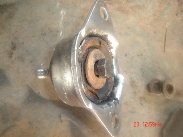

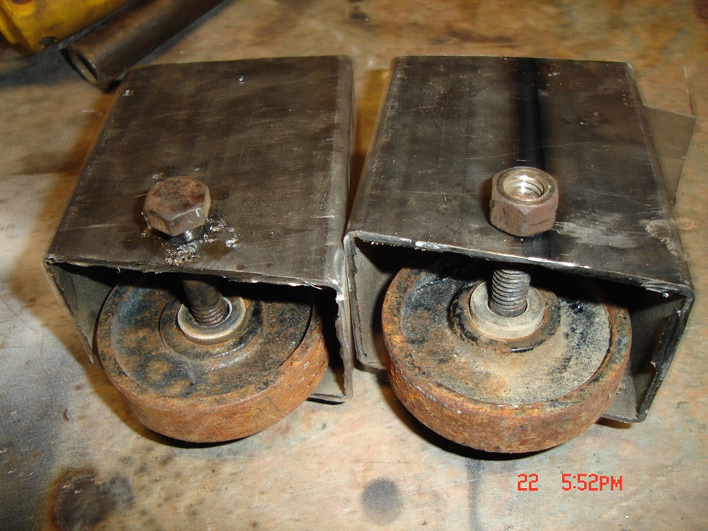

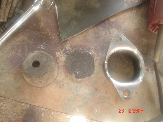

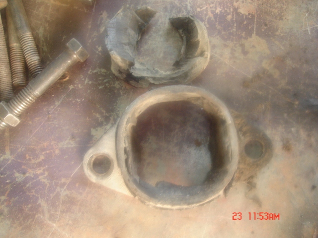

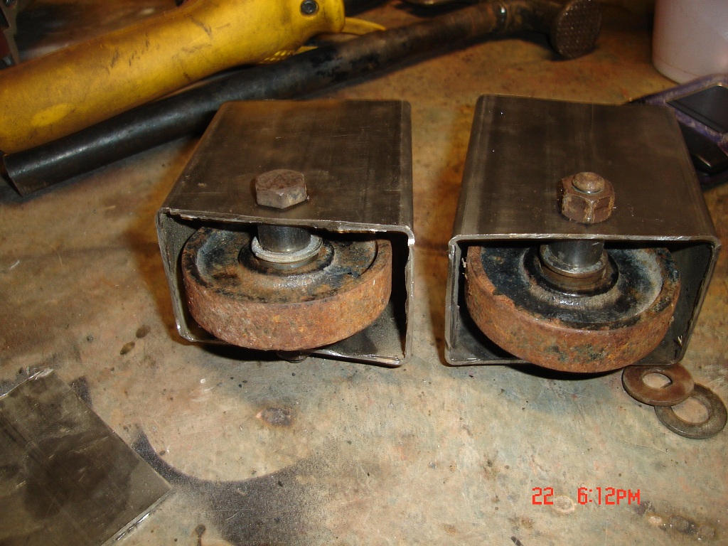

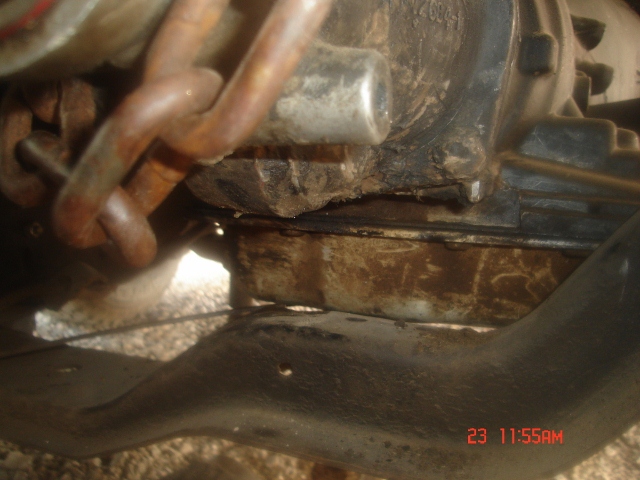

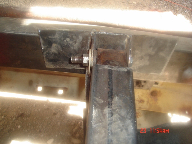

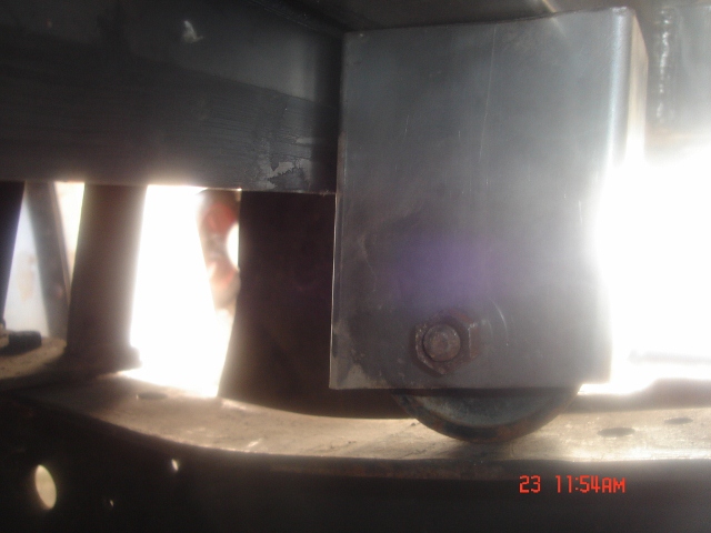

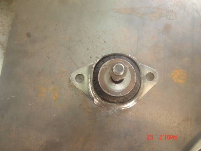

    I have a TH400 and I have a stock 4 speed cross member..
    I notched the cross member to accommodate the 400 on it but I didnt have the proper 400 mount.
    All I had was the metal part that hold the rubber on the 400,So I had 1/2 a mount.
    My brother is coming over tomorrow to finish welding the pads and tilt bed brackets etc...
    Its 60 miles to the next auto parts and Im gonna spend 40 bucks on gas...what to do????
    Fabricate(try to put together) a transmission mount from **** I have laying around...O.k. lets let the pics tell the story
    tb33anda3rd likes this.

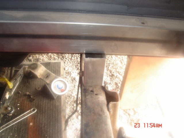

  22. iwanaflattie
    Joined: May 14, 2011
    Posts: 4,187
    iwanaflattie
    more

    TILT BED ****:
    This is the rest of that post

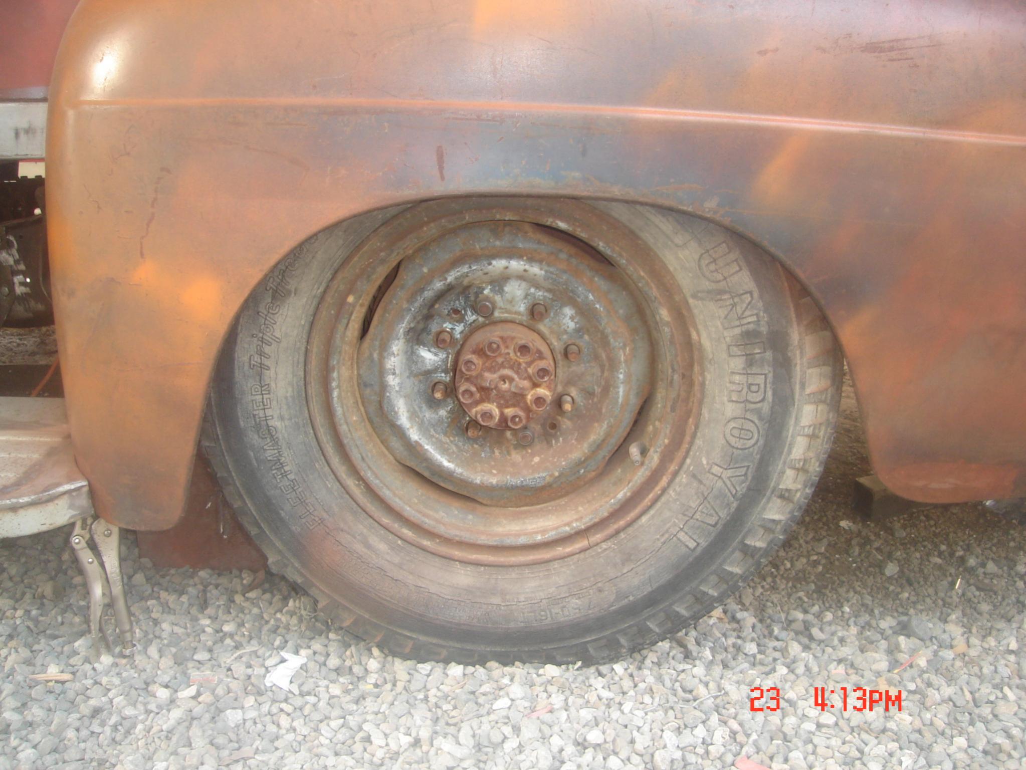

    I didnt have the bed ontop of the frame the right way so I looked like the fender was too far back so I dont need to move anything...
    As to enlarging the wheel opening....It would be cool but too much work...Ya know how im lazy?
    This should be the final product and I can still go forward one inch more...
    THOUGHTS?

    The wheels are centered, looking Good! Now that I see it the pic.Never mind about enlarging the wheel openings. Maybe move em' forward 0.4375...;)
