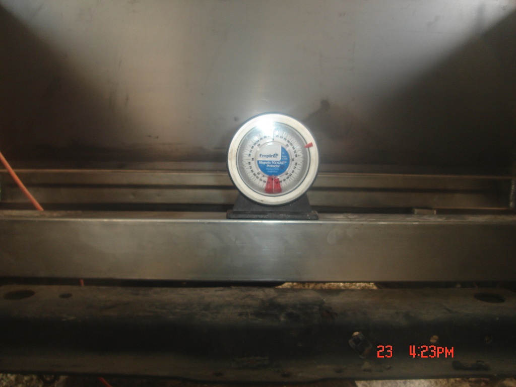

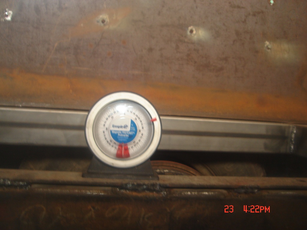

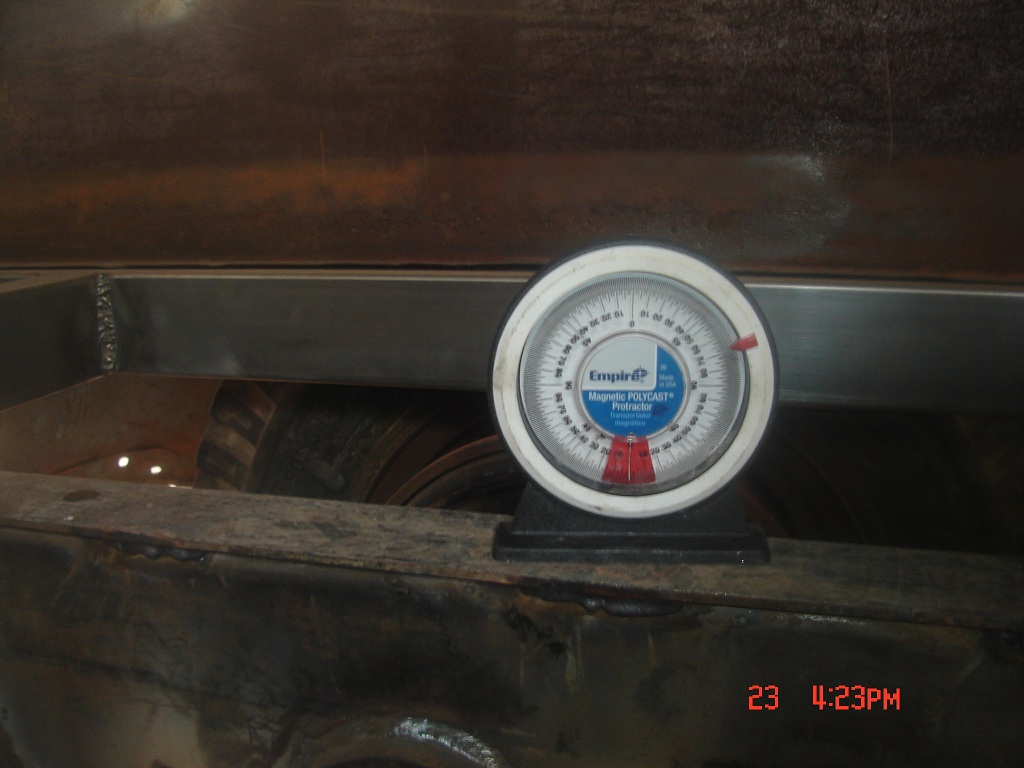

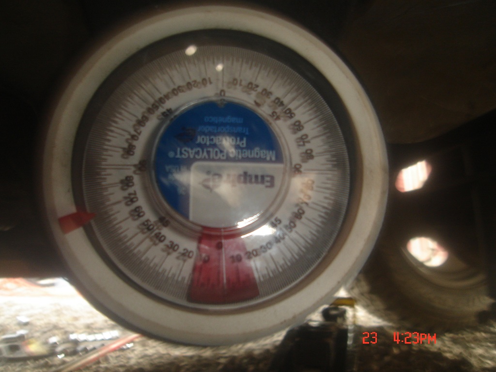

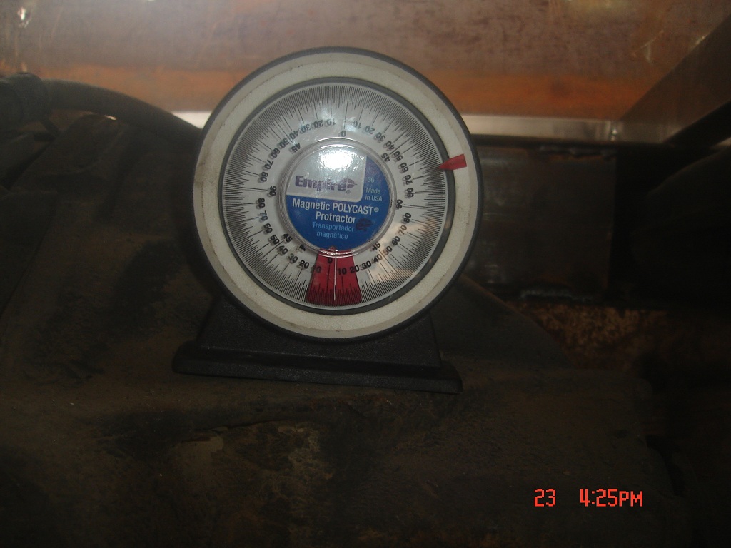

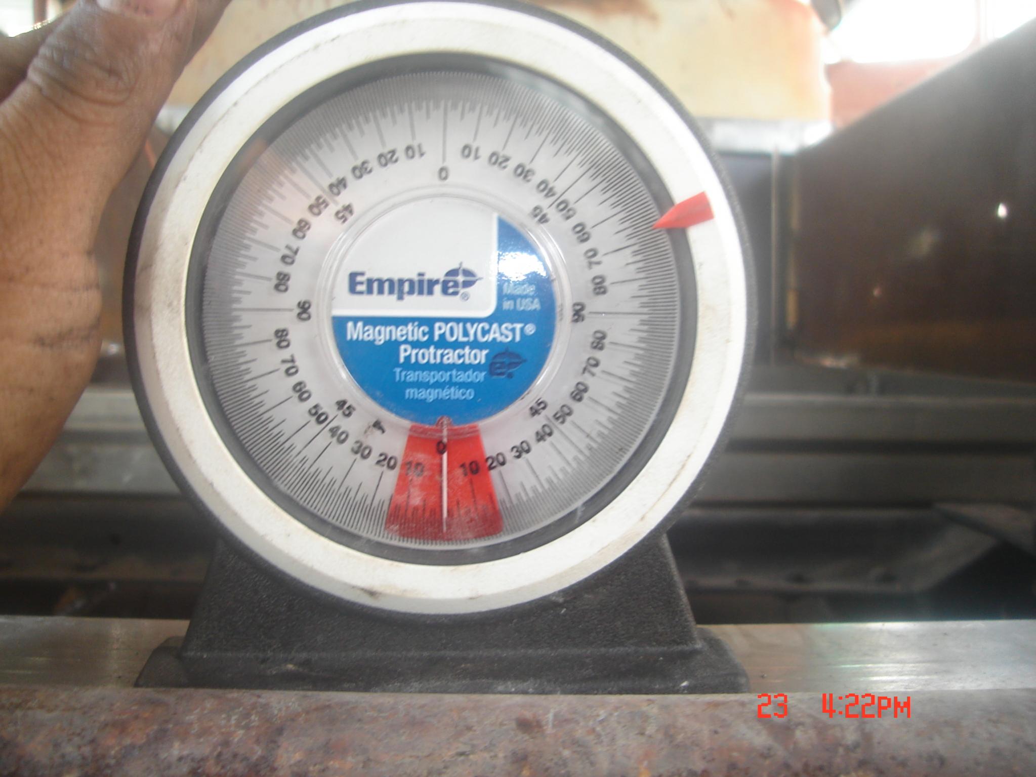

    So basically this is what I have:
    The truck is sitting on its four wheels at ride height..and its level!

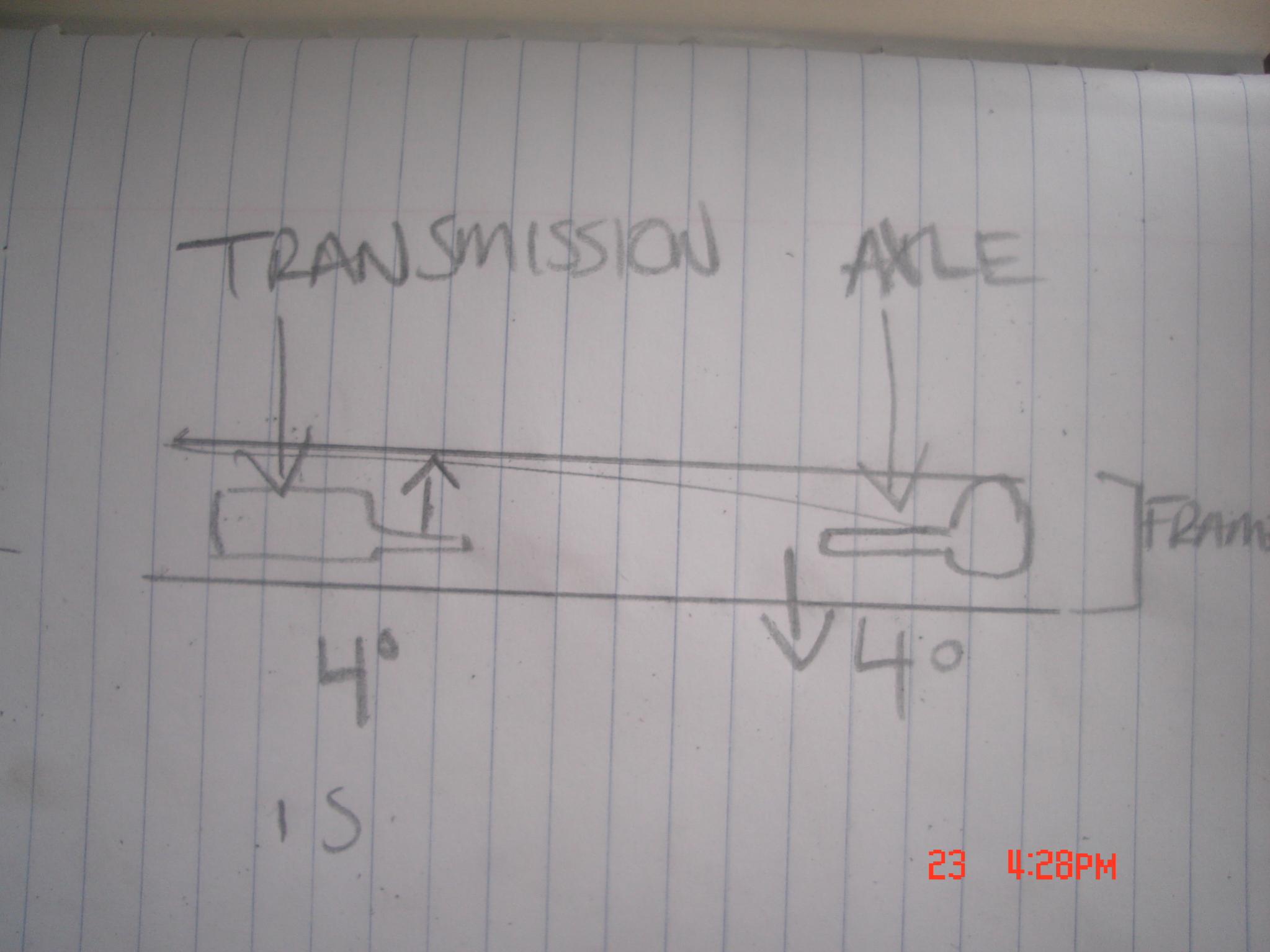

    This from Ray Currie of Currie Enterprises:
    According to Currie, the average car crafter should strive for between 1 and 3 degrees between the tailshaft of the transmission and driveshaft, and 1 to 3 degrees between the driveshaft and pinion. Furthermore, the two angles should be nearly equal (between 1 and 3 degrees), but always opposite (see crude diagram).
    Read more: http://www.carcraft.com/howto/91758/index.html#ixzz1nFwIAXhQ

    Thanks I think Im good to go...

    can you guys take a look at my last ramblings just to have a second opinion?
    my bro is here and he will be welding the pads soon.just want some re***uring

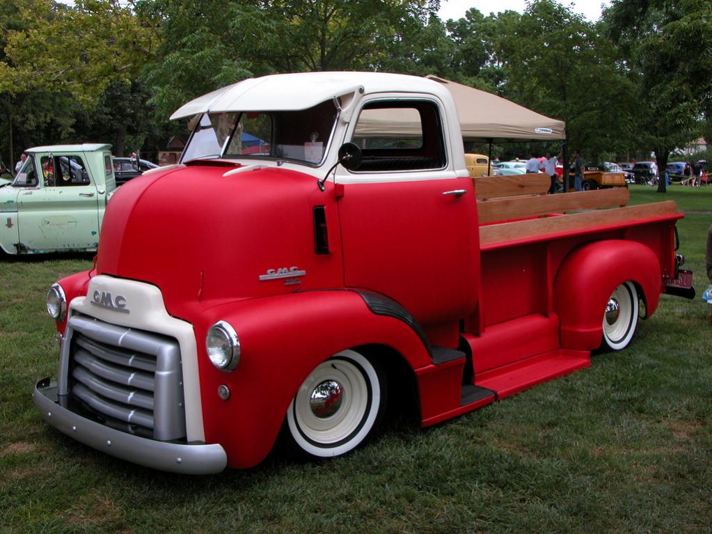

    Time to think about rubber..
    Who makes this and how much do they cost does anyone know?(ford coe tires?)
    Or what other 275/75/16 white wall will look decent on this truck??
    I am even considering the 1" white walls(gmc coe tires ):

    that gmc made me fall in love with coes. it is awesome. saw it at all truck nationals a few years ago. they didn't look any different than car tires to me

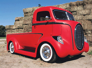

  30. 38Chevy454
    Joined: Oct 19, 2001
    Posts: 6,787
    38Chevy454
    Move the rear fenders so the wheelwell is centered and also move the whole rear fender up so it is same height as the front fenders. Your running boards are higher than the rear fender lip also, make it the same as the front fender where it is at the bottom of the fender. Good progress on the rest of the truck.
