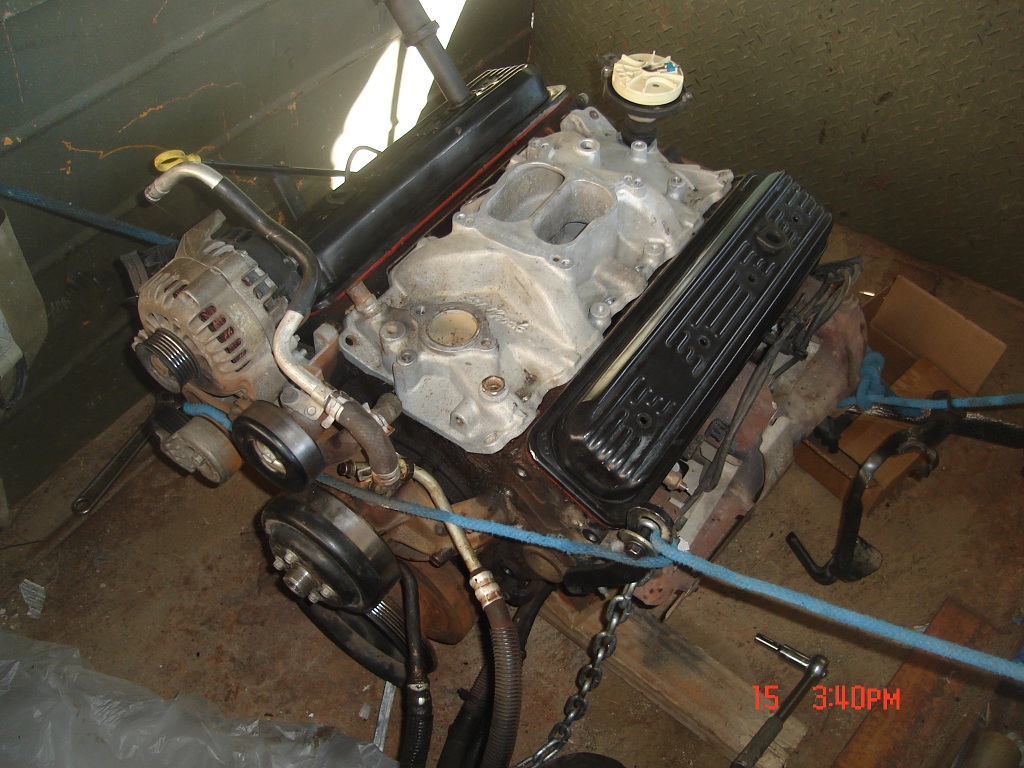

    iwanaflattie
    Tires were too good to be true...only one is new(nov 2008) on the upside my engine will be here in 2 hours,,,,

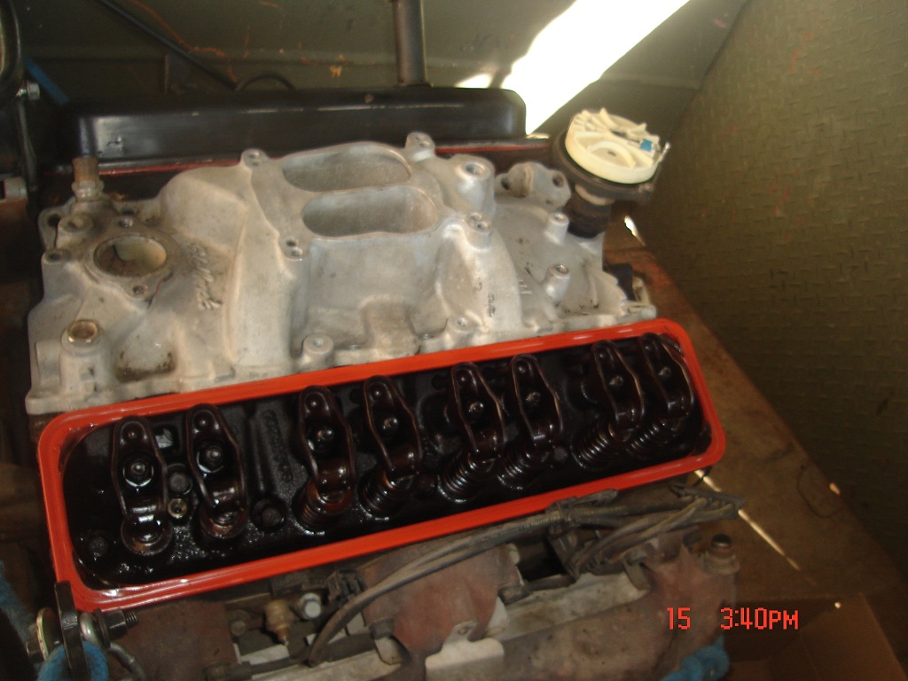

    OK so I got a line on new rubber cheap,I got my engine,just waiting for the intake and carb for my ICS Vortex heads..

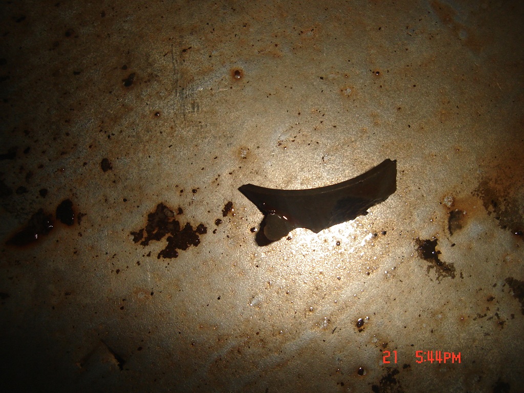

    I am embarr***ed to say this but:
    I usually step on the discs and break them or the grinder falls off the table/truck with the disc installed and the disc bends and breaks,It makes me mad!
    Well I know not to risk a limb by using a defective or bent cutting dis,c But I was being a cheap ******* so I picked a damaged disc up,slapped it on the grinder and said to my self"be careful the disc might explode in your face"
    Amazingly there was no alcohol involved in this decision,I'm sure I would not have used it if Jack warned me before hand.

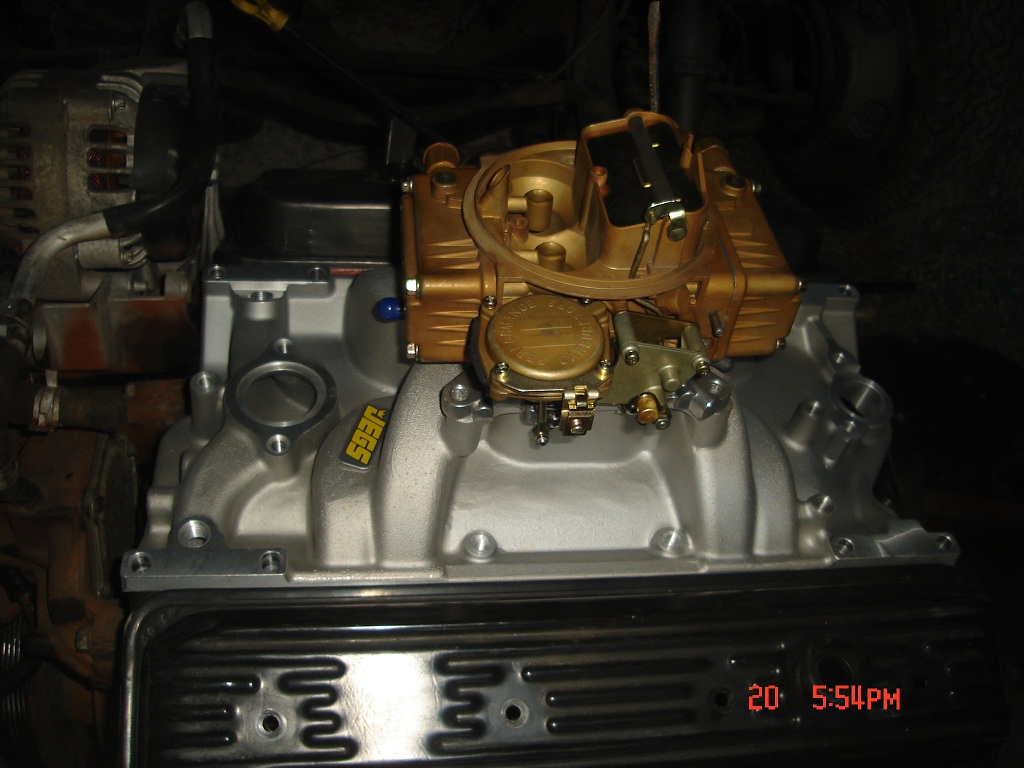

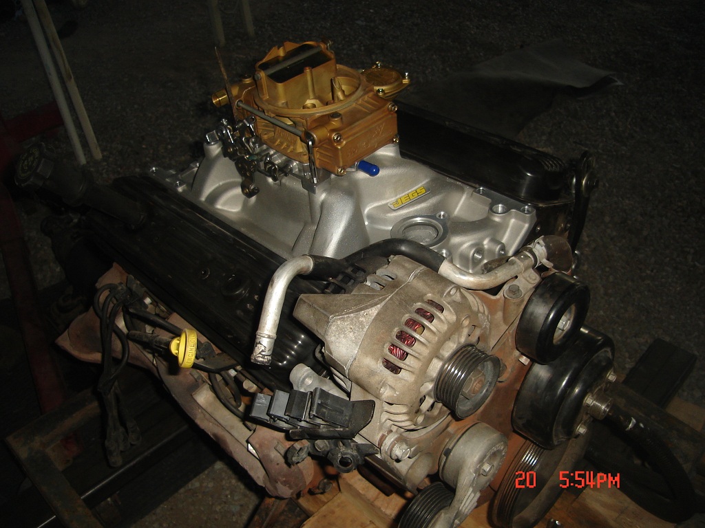

    No,I am going with aftermarket vortec intake and a holley carb,wich eans that I have to go work for that guy.

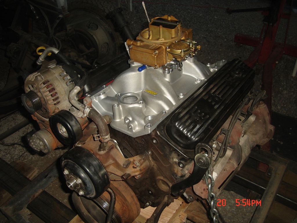

    Got my Holley from the brown truck yesterday.
    I'm waiting for my intake from Jegs.Ordered it at the same time.
    I have the engine on a table and the transmission ready to mate.

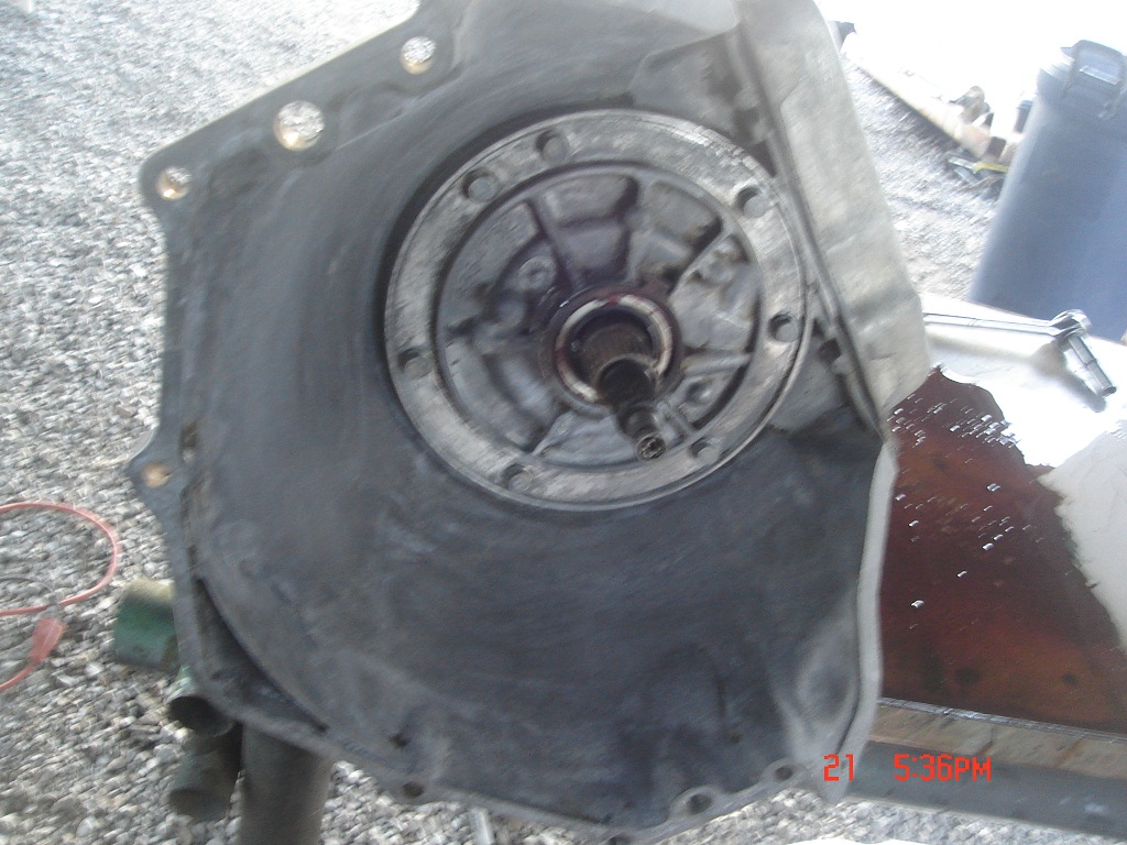

    I have never done this,Is there any clear instructions on how to sit the torque converter into the transmission>?
    I dont have the bolts for it,does anyone know what the sizes are?

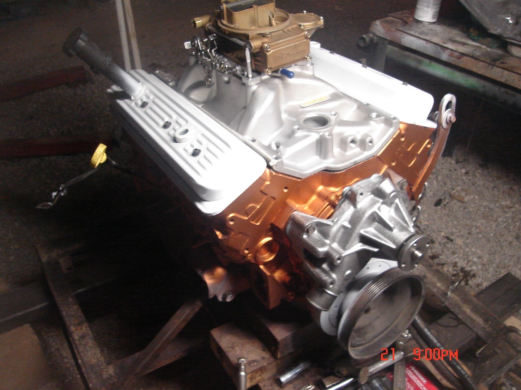

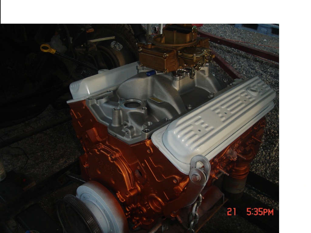

    couldn't resist.
    I might clean it and paint it tomorrow and install new water pump

    Real purty on top, you need to clean up the rest....:D
    With the TQ converter, make sure it is fully engaged. Push in on it while turning slowly. Also might want to replace the ****** front seal first if you haven't.

    Torque converter install:
    http://www.youtube.com/watch?v=vFFIPyv2C_4
    The trick is count the number of splined shafts, and make sure the torque converter drops that many times (plus 1 more for the pump). You shouldn't be able to get your fingers between the converter and the bellhousing when it is all the way in.

    At First it was like :"what the hell is they talking about but once the converter went in,I knew what you meant.

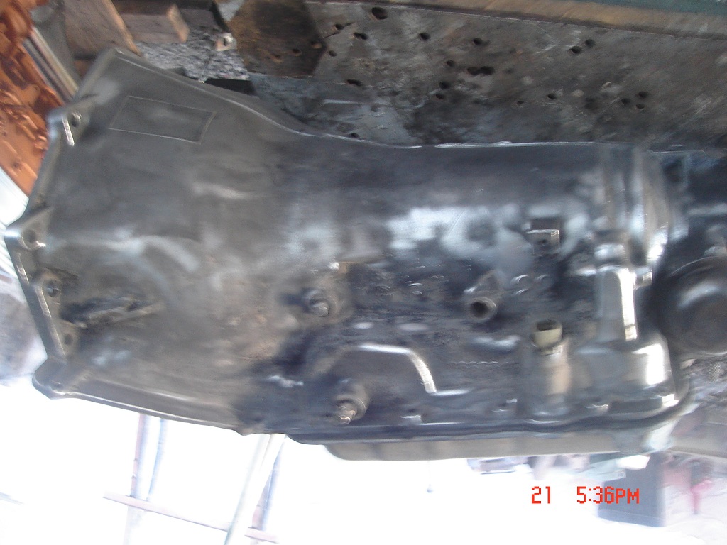

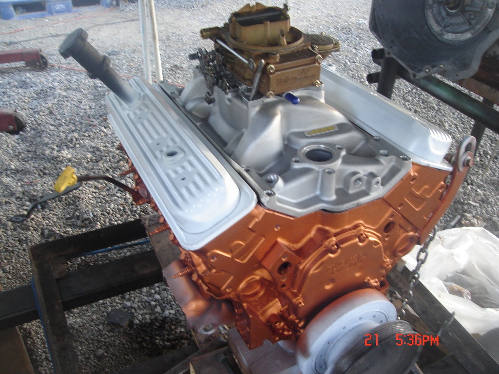

    I got the engine clean and painted,I cleaned the Transmission and got rid of most of the grease.
    I got new intake manifold gasket set,I cleaned the surface where the gasket goes,took a little sanding paper to it,cleaned it again,opened the box.....Let's see,1 gaskets for each side of the valley,1for the distributor,1 for something else...
    Box said to use the little tube of silicon/gasket maker for the front and back of the valley,,,,
    Wait,Neighbor's idiot friend is saying something:
    "Dont use gasket maker for those little places,you shoudda bought the entire kit,if you do it it will leak"
    I ask the HAMB: Is this guy right or is does he have **** for brains?

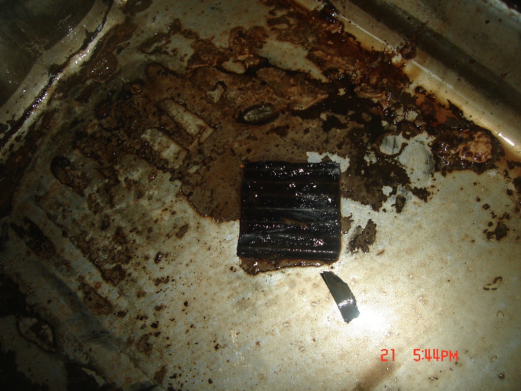

    First time I cleaned this ******,I used degreaser,I covered the 2 holes and washed the sum*****,But water managed to get inside,Will it be ok?
    Or do I need to rebuild?
    I drained the water as soon as I finished.
    Today I cleaned it again but I did a better job at it.
    After I got it clean,I took the oil pan off and took a Peek,found some white sediment,Am I screwed?
    Anywho,
    I sat the torque converter inside the ****** and then I bolted the transmission to the engine,
    I didn't have the right size bolts for the converter,I had some that are longer,Can I cut them down so they fit?

    I've never used the end gaskets on Chevy intakes, I just lay down a thick bead of RTV and bolt up the intake; never had a problem.
    I would get the correct bolts for the torque converter. In my mind that's one of those areas where there is a specific fastener for a good reason.

    your on the right track dont listen to **** for brains, rtv the valley and go, the rubber end gaskets slide out and you get oil everywhere.
    I would replace the filter in the ****** pan and clean it and use it, I have steam cleaned ******s and filled the pan with water and had no issues with them not working.

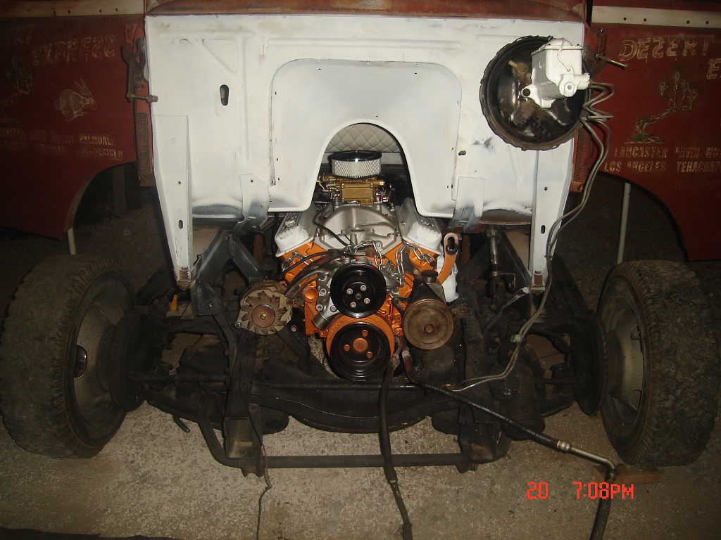

    I managed to drop Vortex between the rails.
    Man! Its a beetch! I had to take 1 exhaust manifold off and the 2 motor mounts,
    I need to make the cab tilt forward other wise maintenance will be a PITA.
    I think Im going to fab new motor mounts to get the engine lower its a bit too high and that way I dont have to fab a lip/spacer for the doghouse.
    Its a bit scary to think that the engine is so close to you and I wonder how hot it will get in there.

    Looking good Seth. The engine sets up higher than I was expecting.....
    On mine I think I may move the engine back about a foot, and as low as I can get it.

    How low can the oil pan be(safely speaking?
    And thanks.

    Oil pan can be as low as you dare, but a 16-oz beer can should fit under it at a minimum. And if you can, work up a skid plate, maybe off an old Bronco or something.

    Thanks I might try to move the engine back a foot also so I can get the engine lower but Im not sure at this point.
    I might run it like this and modify the dog house..
