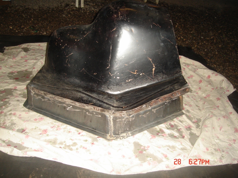

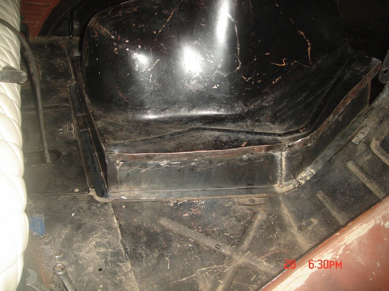

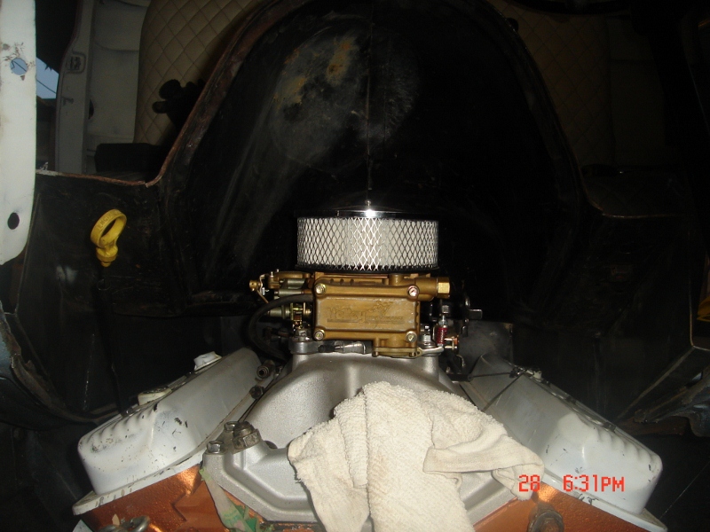

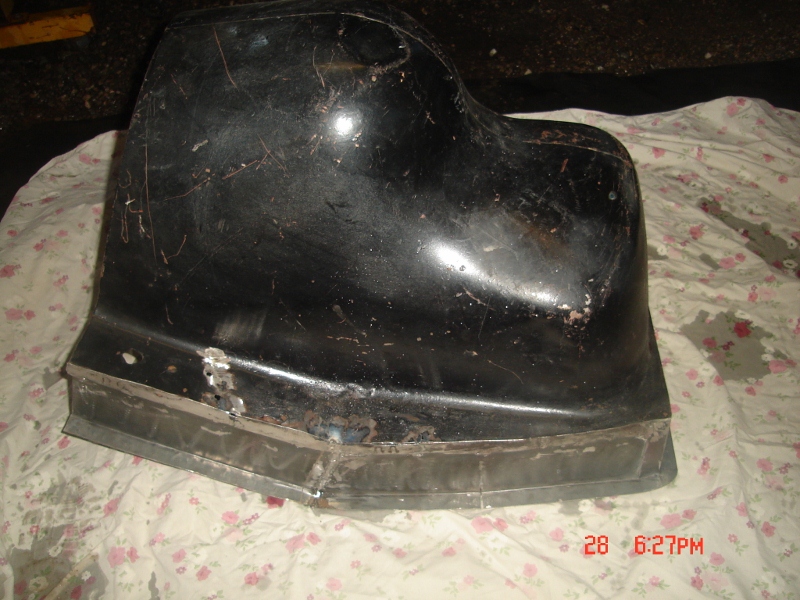

    Today I got some encouraging Words from them hambers and got a little bit done.
    I resolved that Issue with the engine sitting so high.
    I modified the StockDog house because the bottom was hitting the top of the valve covers..
    It was easier than moving the engine down and backwards and fabbing new mounts...
    And probably more fun.
    (Only a few shots Were injured in the modifying of this item)

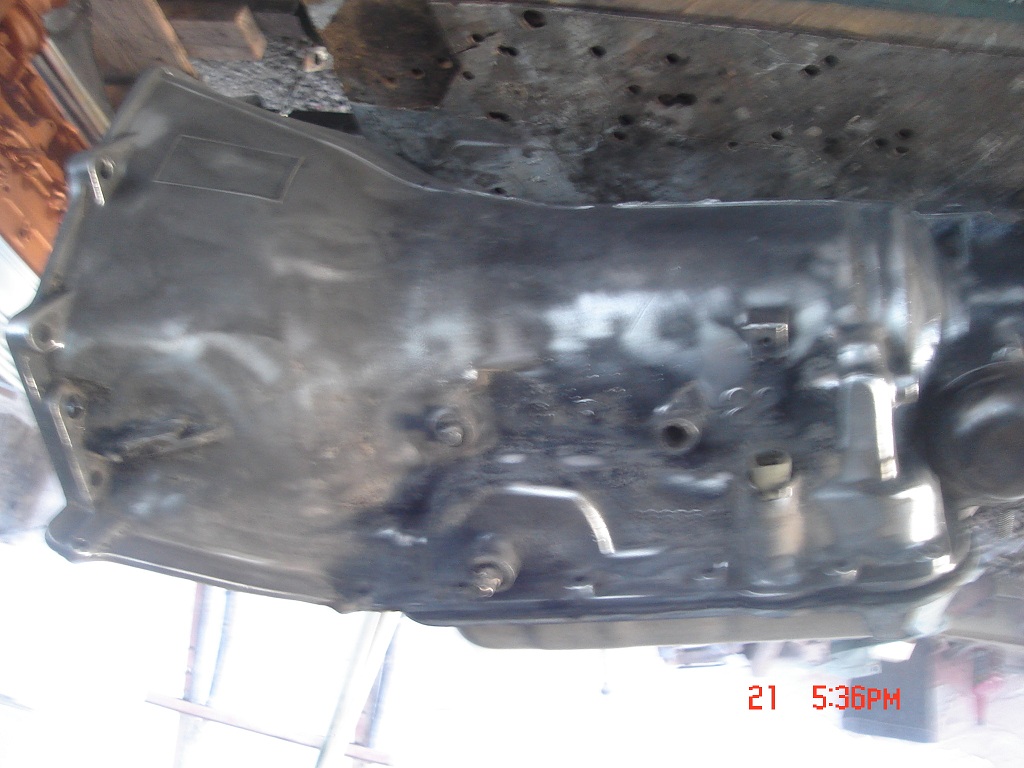

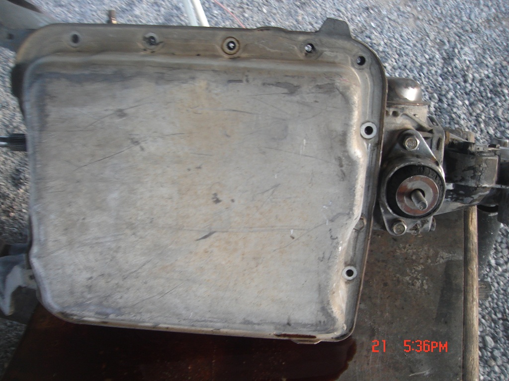

    I have a domb question:
    My th 400 transmission didn't come with a dipstick or cooler liner etc.
    I found an oil dipstick and filler tube? out of a chevy van but now I dont know which of the 2 holes its supposed to go into.
    There is a hole to the right side to the front and there is one behind it with a little wire hook sticking out..Which oneof these is it and whats the other one for?
    Thansk
  24. The hole to the front should be for the dipstick.
    the one with the little hook should be for the kickdown cable.
    I don't have a lot of experience with th400 ,but I remember th 350's having a hook for the kickdown.
    Ever tried the Honey Jack?

    Joined: Dec 16, 2008
    Posts: 427
    kirby1374
    th400 has an electric kickdown so there is no cable. if it has a cable kickdown it is not a th400

    Here is some pictures of the Transmission.
    Now I now that The holes are either for the oil tube and/or the kick down cable.:

    That trans looks like a 4l80E? I thought a th400 had an odd shaped pan?
