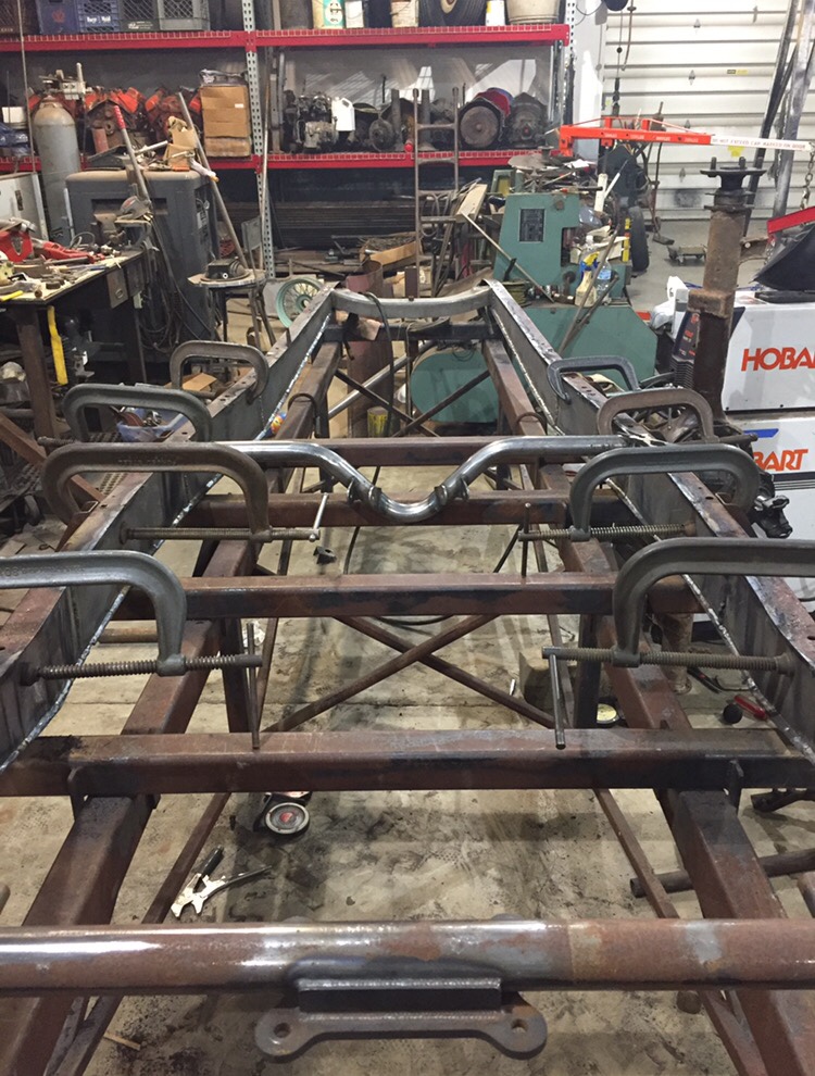

    Here's a quick update on fab32's coupe. I ditched the stock cross member and hacked up K member the got the rails back in the jig. While trying to straighten the steering box area we found a crack and a bad braze job repair. Plus the Hurst bolt in motor mounts left four big holes in the ch***is so I just cut out the whole section and replaced it with new metal.
    Tonight I finally got everything mocked up in the rear so I can tack both crossmembers in, pop it out of the jig, bolt on the suspension and make sure the car sits right. I'm still waiting to hear back on some Ch***is Engineering legs for the center section, then I'll just run that Pete & Jake's ladder bar mount through them then get to boxing the ch***is. So I'm making progress, one step closer to returning this coupe to the streets.[​IMG][​IMG][​IMG][​IMG][​IMG][​IMG][​IMG][​IMG]

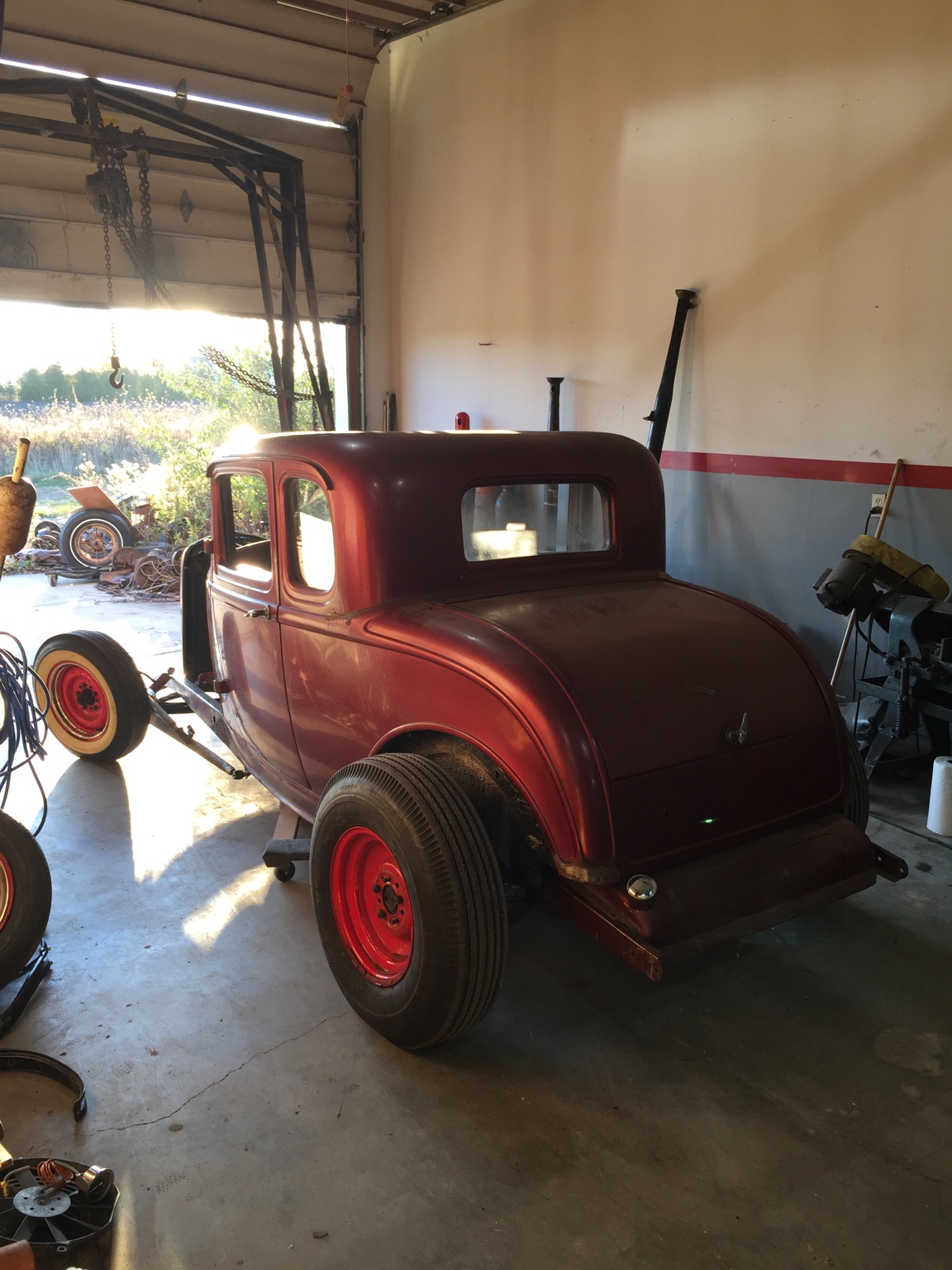

    I took the ch***is out of the jig last night. Bolted everything on then set the body on to see how everything lines up. I'm happy with it, back into the jig to weld it up for good. [​IMG][​IMG][​IMG][​IMG][​IMG][​IMG][​IMG][​IMG]

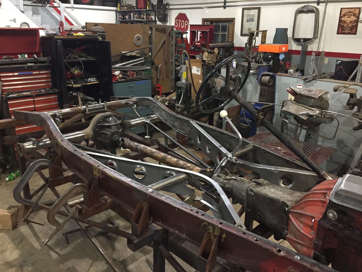

    In case anyone is wondering, I'm still plugging away at fab32's old 5 window. I have the three main crossmembers welded in and I've moved onto the boxing plates. I have to extend them a bit on both sides. Frank mentioned getting a deal on some plates that were cut wrong. I think I found them...
    After that all I have to do is the center section and pedals then this ch***is can come out of the jig and I can start bolting stuff back on. My goal was to have it as a roller by fall and I think I'm still on schedule. I'm still driving his deuce sedan as well. I'm supposed to take my roadster to the Hot Rod Hillclimb in Colorado next month, but it needs some updates. The sedan is ready to go and I got the okay to bring it if the roadster isn't done.[​IMG][​IMG][​IMG][​IMG][​IMG]

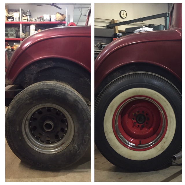

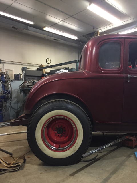

    Quick update on fab32's five window. The ch***is is almost done and I have the engine in the test stand getting it ready to fire. Frank always called it his NASCAR engine, not sure why? But it's definitely a circle track piece, maybe from a NASCAR late model. Angle plug Brodix aluminum heads, lightweight crank, roller rockers, stud girdles, blah blah blah....Not super traditional, but I threw a tri power and finned valve covers on it so it'll look cool, should be pretty quick too. I put the body back on it to check my wheel placements, everything looks good. Got the engine location and mounts welded in as well. I'm still on schedule to debut it at Autorama Detroit and as of today you'll probably see it in Cleveland too. [​IMG][​IMG][​IMG][​IMG][​IMG][​IMG][​IMG][​IMG]

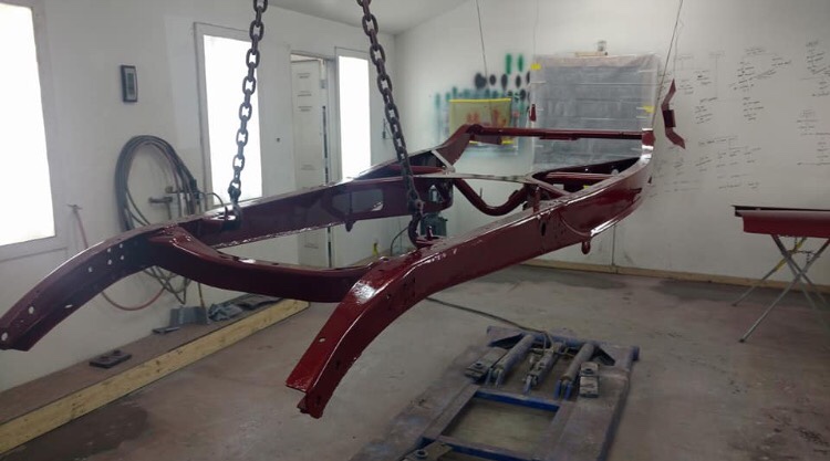

    I'm almost done with the ch***is on Frank Burrell's (fab32) deuce coupe. I just installed the center section legs from Union Speed and Style. Just a few more brackets and mounts and it'll be ready for some paint. I'm going to leave as much of the Honduras Maroon on it as I can and just cover up the new metal and places I had to grind off the paint. On the body its self the paint job is cleaning up really nicely. Two months till Autorama.[​IMG][​IMG][​IMG][​IMG][​IMG][​IMG]

    Just over a month till Autorama. I took an overnight trip to my pal Clay's company, DefenseCoat down in Richmond, VA and had him powder coat my wheels. While that was going on I took the finished ch***is to a local painter who's trying to match the Corvette Honduras Maroon. It's close, and honestly closer to the body color than the original paint was. I got my tires mounted, my Moser axles showed up, and I'm just waiting on the 3.70 gears so I can put the rear end together. I get the ch***is Saturday night then it's on to final ***embly. It's crazy to think that after four decades, this coupe is getting very close to moving under its own power.[​IMG][​IMG][​IMG][​IMG][​IMG][​IMG]
