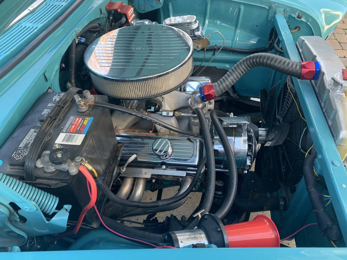

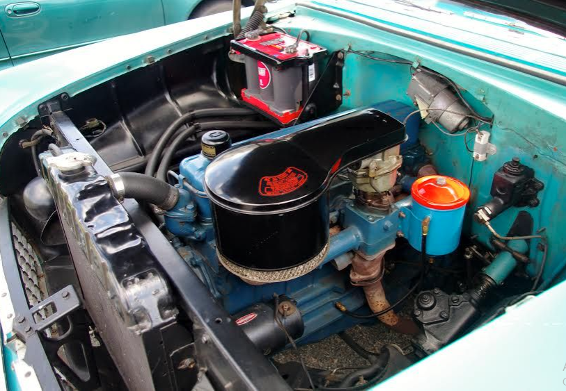

  1. 4 speed ‘55 Bel Air sedan in my colors. I was interested in it ‘till I saw this mess. Radiator on wrong side of support. Goofball corrugated radiator hose, red clamps (?), hose too long. Wires hanging down from
    support.
    Siren, what the heck ? Barney Fife poser ? Heater hoses are suspended in space as siren is bolted where hoses go. Why the heater shut off valve ? One heater hose hanging on fuel line ?
    Wrong style battery, no battery hold down. Welding cable used for alternator wire. Battery cables run across side of motor...M***ive- cable batt to alternator ?, why ? Why not take plastic carry handle off battery. ?
    Why a nice air gap intake and no Holley ? Hard metal fuel line snaked as close to engine heat as possible.
    #1 plug wire wrapped around header. Split loom everywhere. AFAIK, split loom was hardly ever used on automobiles. No Vacuum Advance hose that I can see. Locked Advance race motor ? Hahaha.
    After making a wiring mess, owner then spends $’s for some shiny spark plug wire covers, which IMO, do little but make it more difficult so service spark plugs.
    Why the Pro Comp ignition box screwed front and center on fire wall ? ? This appears to be a very mild 350.
    A simple MSD RTR 8360 should suffice.

    i do agree on the hose and wires could be cleaner, but rad is on the proper side for a v8, and thats a agooa horn... so maybe its better you look elsewhere

    The alt cable is a ground. I think the siren is a horn?

    I have to agree with others above, it looks like it would be very easy to redo the engine compartment to your own liking. As to why the heater shut off valve. A great must for warm weather driving. The water still flows through the heater with out a shut off valve. And in most cases it can get warm or hot! The placement of this valve could be better in my opinion, but all is good.

    I always thought that the radiator went in front of the core support for a 6 and behind for an 8. And wasn't it traditional to cut the center out of the core support to make engine swaps easier?

    yeah, the stock V8 location is behind the core support, but many cars have it moved forward, to make room for more "stuff" on the front of the engine. This car happens to be one that should have it mounted behind the support, so the fan could do it's job.

    ^^^^^ "Detail's". Wrong core support!

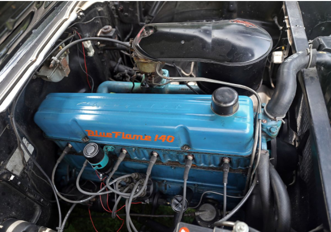

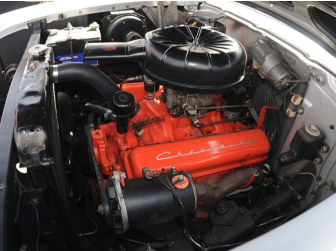

  17. No, that is the 6 cylinder location.
    Early Small blocks used the short water pump.
    The reason people are running the radiator in front in because they are running the long water pump (wrong for a 55-57)

    im wrong the rad is in frt on a 6, and yes i would change alot ...

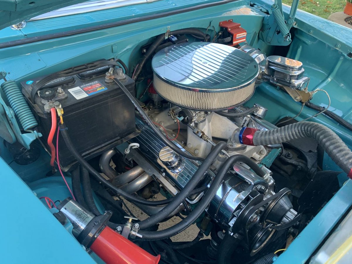

    Looks like they moved the radiator forward to mount an electric fan on the engine side. This is a before pic of the engine in my T. Still bought it... I'm sure that there are lots of things that some don't approve of, but I really don't care... 964.jpeg 20210308_164830.jpg
