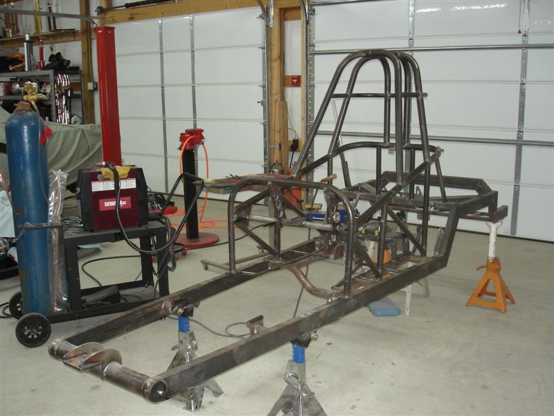

  7. Here's a cool little trick I use to put ladder bar brackets on cross members and rear end housings.
    All-thread.
    To p*** the SFI specs to cert' this thing to 7.50... it needs a diagonal in the frame rails. Most funny cars and street roadsters have the engine above the lower frame rail... so a diagonal is easy. With all my junk hanging down, I had to think about this one.
    When you build a ch***is... you have different ways to keep parallel members from "parallellagramming". You can do it with a "diagonal" (turns a square or rectangle into two triangles... strong) You can do it with a "K" (turns a square into three triangles) or you can do it with an "X" (turns it into four triangles) This K will be sufficient...
    Timmy helped me with the trans mounts and engine mounts.
    I got those fancy laser cut trans mount pieces at the Stockton Swap meet... I bought the whole she-bang for $15. I ended up only using the fancy laser cut pieces, as the rest was all wrong for the height I wanted the engine at.
    Tim made the piece with the two holes in it for the trans mount to bolt to... and I cut the brackets to weld to the "K" out of the old cross member that I got at the swap meet.
    It works.
    Then I scabbed some 1/4 wall pipe from my neighbor... he works for PG&E. Let's just say it was free.
    And I used my neighbor Brian's band saw to whittle it down for a nice little drive shaft loop.
    The NHRA spec on the loop is that it needs to be 1/4" thick, and 2" wide... and be within 6" of the front U-Joint. This thing meets or exceeds those specs.
    We've been bending tubing the last few days... so when I get a chance, I'll update ya'all on that.
    Also, I spent today working at my Buddy Steve Pattee's shop in Modesto... and he helped me figger out the rear end.
    More updates to come!
    Sam

  10. The bender I have (On loan from Bro-John) only has an 1 5/8" die. I decided to do the rear section in 1 3/4".
    The main reason I decided to do it that size is that 1 3/4" fits nicely into the 2"x4" square tubing frame that is .120 wall.
    My friend Steve has a bender with the correct 1 3/4" die... so we bent these over at his shop.
    For years I have used a "Joint Jigger" style tubing notcher to notch tubing.
    But with the Bridgeport I have... tubing notching is so much easier!
    I'll show you guys in a later installment how I notch and bend tube.
    But for now, some pics.
    Firewall hoop. 1 5/8" .134 wall ERW... It was actually pretty easy to bend.
    Shoulder hoop. Took more thinkin'!
    Wednesday night we got some uprights in. Simeon and my neighbor Mark helped with the first two little ones. and then I was up until 1am doing the other two.
    According to the NHRA SFI Specs... anything 30 degrees or less from straight up and down is considered an "upright". The small ones are at 28 degrees. :D
    More to come!
    Sam

  12. Been bustin' **** on The Drag Rod...
    Got the seats mounted today with the help of Tim, and even got the shoulder belts mounted. Katie was a big help, and a real trooper. She came out in the 105 degree heat and helped me position the mounting points correctly!
    Teaser pic... more to come.
