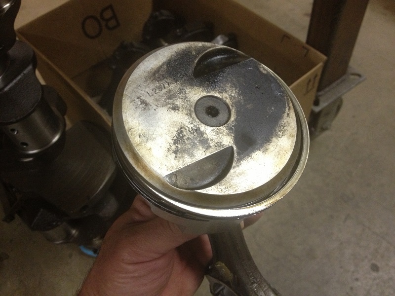

    If you've been on this journey with us from the beginning... you'll remember that my late son Nate pulled the PS454 out of my '57...

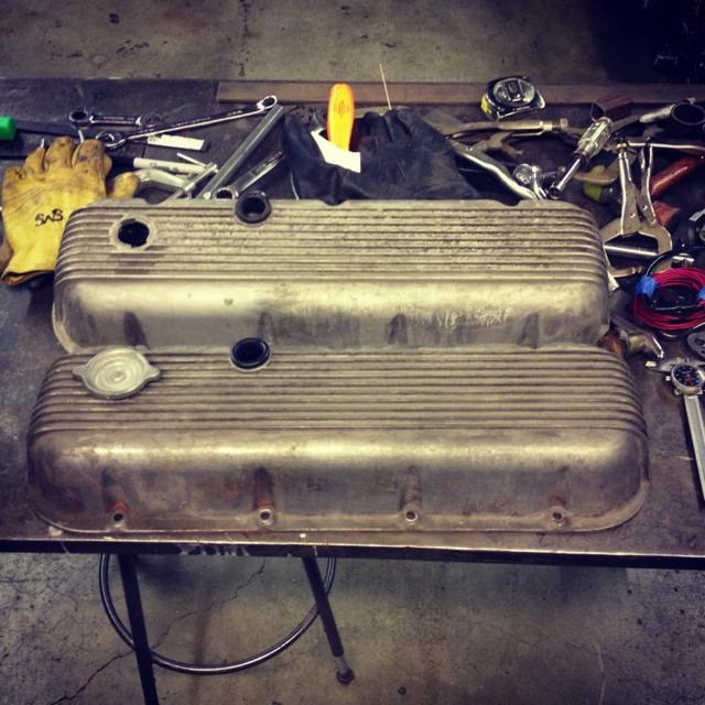

    I really didn't know what to expect from the motor when I pulled it apart. I saw some new parts and what looked like forged pistons through the spark plug holes... but ya' never know.
    So I was pleasantly surprised to find TRW forged .030 pistons and a decent crank and rods in the short block. The heads were also fresh and the thing had never been ran since they had been installed.
    I am at a cross roads with this motor. From the beginning I knew I'd have to stick a new cam in it. The one that came out of it was an "RV" regrind... hardly the cam for a 10 second screamer.
    But then there are the heads. They are closed chamber 427 heads. Sure they have stainless valves with a fresh valve job... but the valves are wimpy little 2.06(ish) intakes and 1.72 exhausts...
    Upon closer inspection however... I noticed that the heads have had a little bowl work. I spoke with my friend Mike Bishop (av8) and he is willing to work some magic on them... which will undoubtedly help.
    Option II is to try and find some better heads with bigger valves. My friend Steve has a pair of used Dart heads... but they are $$ and will lower the compression to 8:1 with the flat tops. That means I would need new pistons...
    So I have pretty much decided that I should keep what I have... and do the following:
