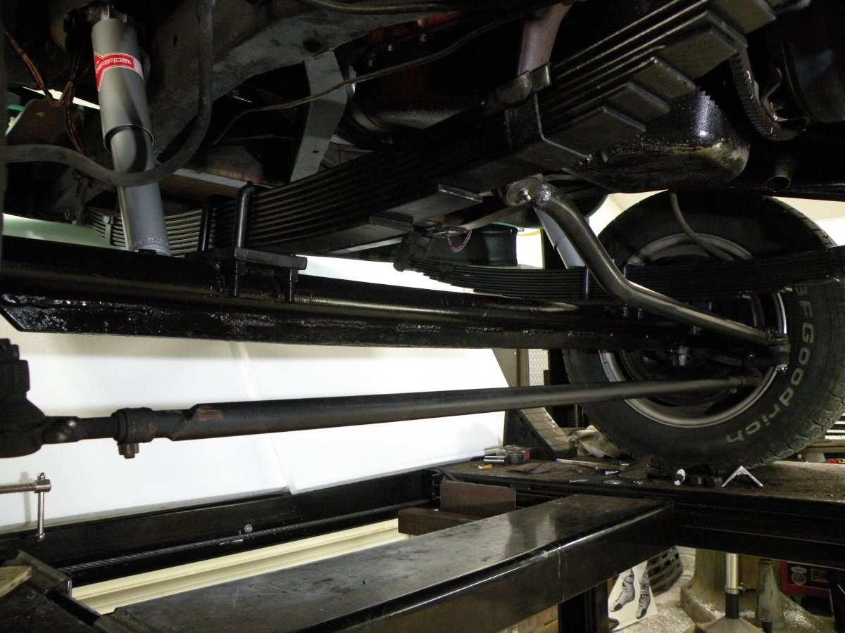

    I have been doing a lot of work trying to get front end/steering issues resolved on my Studebaker pickup with a tube front axle.
    Everything was going well until I tightened that last bolt and discovered I had an issue. It was the bolt that holds the drag link to the steering arm. In the process of trying to correct the previous owners mistakes, I decided now was the time to center the steering wheel so I wasn't driving straight ahead with the wheel pointing 45 degrees off-center. Not an issue; straighten the steering wheel, straighten the front tires, then adjust the drag link to fit in-between.
    The problem I encountered is that the steering arm swings up into the space between my leaf springs and the frame when steering hard to the right. On level ground, the tie rod end swings into and across the leaf spring to get to the other side. I can only imagine the issues if I was NOT on level ground.
    The previous owner must have had the same issue, and he just used the leaf spring as a limit stop. "OK, that's full right turn", and then he found full Left turn, and set the drag link to have the truck going straight ahead at the in-between spot. That explains the crooked steering wheel and the horrible turning radius in both directions.
    Now I am brainstorming to find a solution. I need to change something to avoid the drag link contacting the leaf spring.
    I have thought about using a good heim end in that position, because they tend to be more compact than a standard tie rod end..... or I might be able to bend the steering arm a bit, but room is tight and I can only bend the very end of it. If I bend it any closer to the steering box I will have to cut a relief in the lower frame rail. Maybe I have to cut and shorten my steering arm so it doesn't reach down so far?
    Maybe I have to start all over with a different steering box and a new design. No idea what parts are in there now. Thoughts?

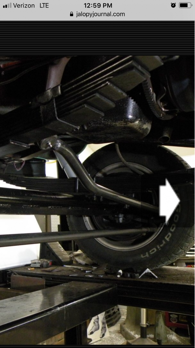

    Picture 1 &2 show point of contact. Once the rod end gets over that edge of the spring it rotates up and out of the way as shown in picture 3. At full turn, the steering arm is just 3/16 from contact with the frame.

    perhaps you could step back and take a few more pictures, that show the rest of the axle and steering system?
    Lots of leafs in that spring.... :)

    Try mounting the tie rod end on top of the pitman arm.. You may have to taper the top of the pitman arm down "only halfway "... The aftermarket pitman arms are tapered that way to except the rod end either way....

    Is that the stock steering box? Looks like the frame may have had a bracket welded for a different box. How about heat and bend the pitman arm up enough to clear the spring?

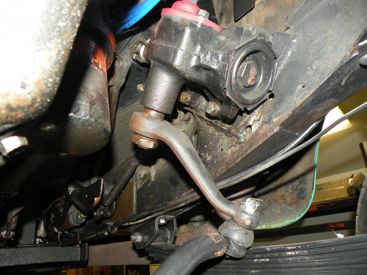

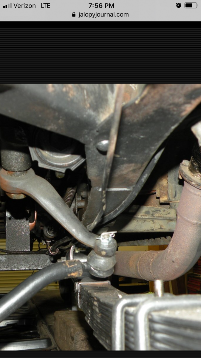

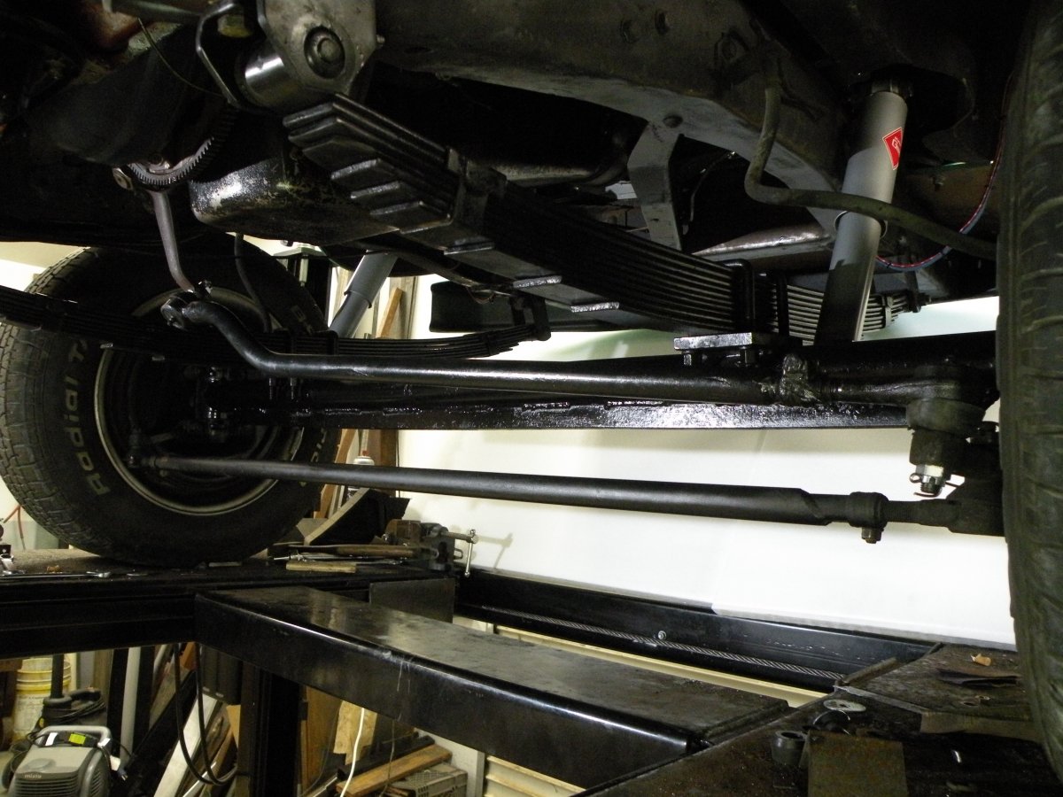

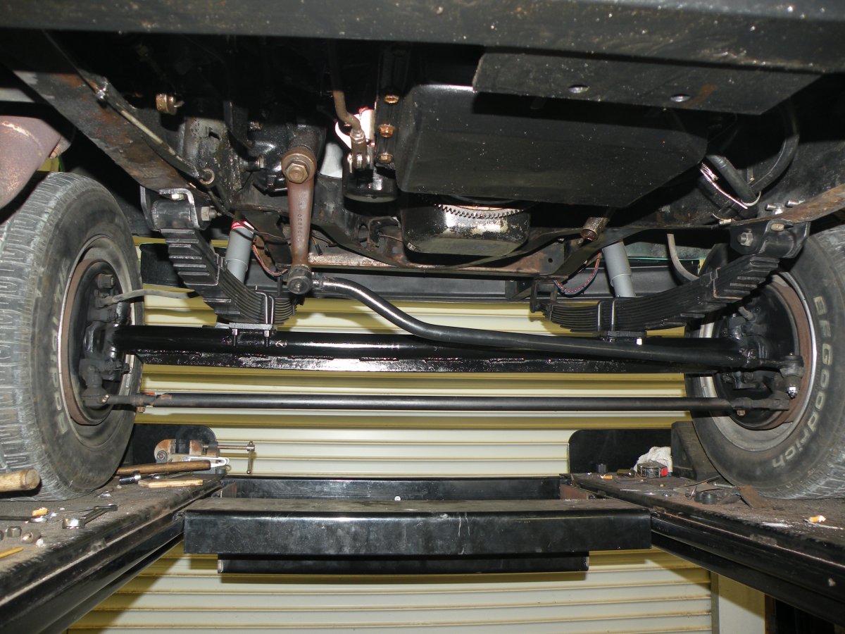

    and as requested...some wider pics of what's under there.
    Oh BTW, I just got done removing 6 leaves from each side. Studebaker used a very thin leaf for some reason, and lots of them. The front spring leaves are .2 thick.

    I'd be looking for a stock axle and steering box, if it were my truck...
    Also, I'd be looking at stock springs, to see which leaves belong in there. Looks like a couple were added near the top. Those are the ones I'd remove.

    There is a **** ton of stuff done wrong there.
    The steering box is at a goofy angle. The drag link is kinda short and has weird bend in it. The pitman arm is too long and the steering box would be better outside the frame rather than inside.
    What is the flatbar on the bottom of the axle for? Why is there space on either side of the u bolts?
    You need a different steering box with a longer sector shaft so it will mount with the pitman arm parallel to the ground.
    The drag link needs to be parallel to the tie rod. And as long and straight as possible.
    Get rid of the ****ty tube axle. An F1, Chevy or econoline beam axle would be a lot stronger and have lots of parts readily available to make the steering work correctly.

    That's an S10 manual box. Circa 82-83. I'd heat the pitman arm and bend it.

    Is it me or is that drag link to low, its begging to get snagged by something.

    I did discover that my box IS centered. 6 1/2 turns lock to lock, it's a snappy handler. Lots of flying elbows in the parking lots. Oh...and there is room to put the rod end on top of the pitman arm. Now all I need is one of them $100 reamers.

  21. I’m guessing this has some kind of nose up g***er stance. Looks like a trailer spring special. The natural consequence of that is the steering arms get further away (vertically) from the pitman arm. That’s one problem.
    The second problem is the springs aren’t far enough away from the pitman arm. That causes some to bend the pitman up to get clearance and if you’re following along that increases the amount of the first problem.
    That’s the easiest (not best by a long shot) one step it help way around this mess is to flip the drag link on top and Re do the drag link so it kinda looks and works better. Hope springs don’t hit the arm.
    Now here’s the best way.
    Get back to a push pull box with steering arms that are above axle. Basically change everything.
    Look at some solid axle 4x4 with suspension lifts for some kind of clue on how to set this up because what’s there is a serious combination of compromises that equal a problem you posted about.
    Pitman arm is up, steering arms are down and lifted suspension separating them even further.

    The u-bolt mounts on the axle would scare me enough to s**** it all, looks like just plate steel welded on the top of the tube. The u-bolts don't even go under the axle for full support!
