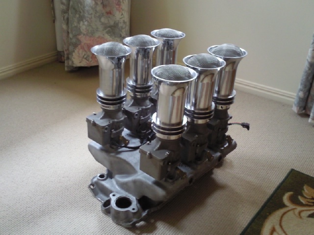

    mgtstumpy
    I acquired that system when it had been bought by Retrotek Speed from Mooneyes. I've yet to run it as this build is taking longer than anticipated! It's no longer made by them however the computer is programmable with lots of parameters. Professional Products acquired Retrotek Speed and now market EFI systems.

  11. I have the Retrotek setup on the 392 hemi in my '51. I was an early purchaser during the time when Retrotek was taking over the product from Mooneyes. It is on an 8 deuce U-fab type manifold. It took several years and three computers from Retrotek, but it runs fine now. It is the self tuning version of the software/firmware with a wide band o2 sensor. I have an MSD programable distributor. That was part of my getting it to work right, even though the devices do not work together. This car is my summertime every day driver. It was a lot of work and persistance getting there, but since the last several years, it has been trouble free. I am happy I kept at it until it was working fine. I know nothing about the new company owner, or what is currently being marketed.
