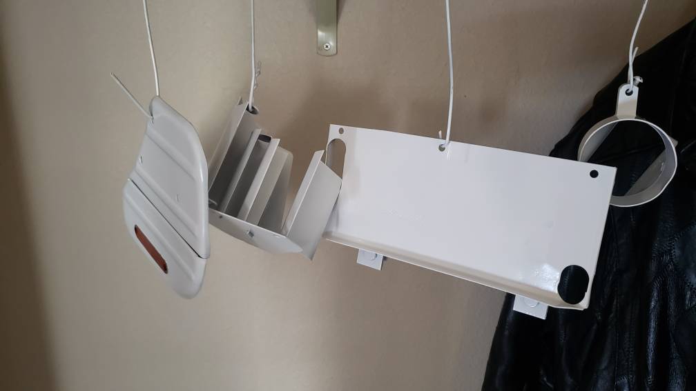

    Ordered two sheets of 1/8in foam neoprene to reseal all the clearance lights. Those'll get abrasive blasted and painted; the lenses cleaned and replicated as needed.

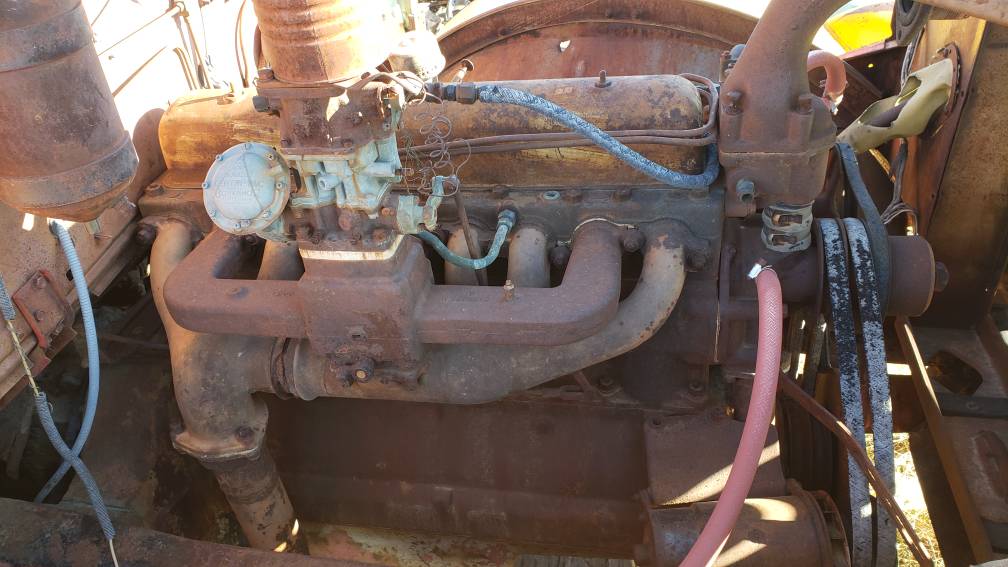

    So I found a GMC 360 inline six in a 1950-ish GMC HC700-series truck. Engine is near complete (missing the fan). Guy wants $400 for it, and the Clark 285V 5-speed behind it.
    I've seen several 503 videos and overhauls, but not the smaller 308/360. GMC rated it for 155ghp/140hp net, with right around 300lb-ft between 1000 and 2000rpm.
    Hm. That's about double my Stovebolt's stock 85hp. And the manifolds and ignition are mirror-imaged when compared to the light-duty inlines.
    I think I'll be doing some measuring, see if it'll fit with minimal modification to the doghouse. Manifolds are already in a better position - lots more room on the right side!
    And I located a Browne-Lipe 5531 auxiliary trans locally. $600 for it, with the shifter. It's all coming together! :)
    This is still just a thought at this point, but I'll probably pick the engine and trans up anyway. Make a neat conversation piece, if nothing else! And the Clark trans would be perfect with the Brownie box, even if it isn't the Dubl-Duti that gets it.

    Nope, not a chance. The damn thing is 11" longer than the Stovebolt! Height is close, when you exclude the oil pan, and the frame widths are within an inch of each other, but man... that water pump and crank pulley are looooong! It could work, but I don't want to push the transmission and Brownie back that far, nor add a foot to the doghouse so it makes getting in difficult.
    Neat idea, but nope. 261, 401M, or Detroit are much better power options. I'll still buy that engine and trans, though - be a neat engine to run on a stand, and that trans would work well behind a Detroit. Hell, $400 for just the trans is worth it!

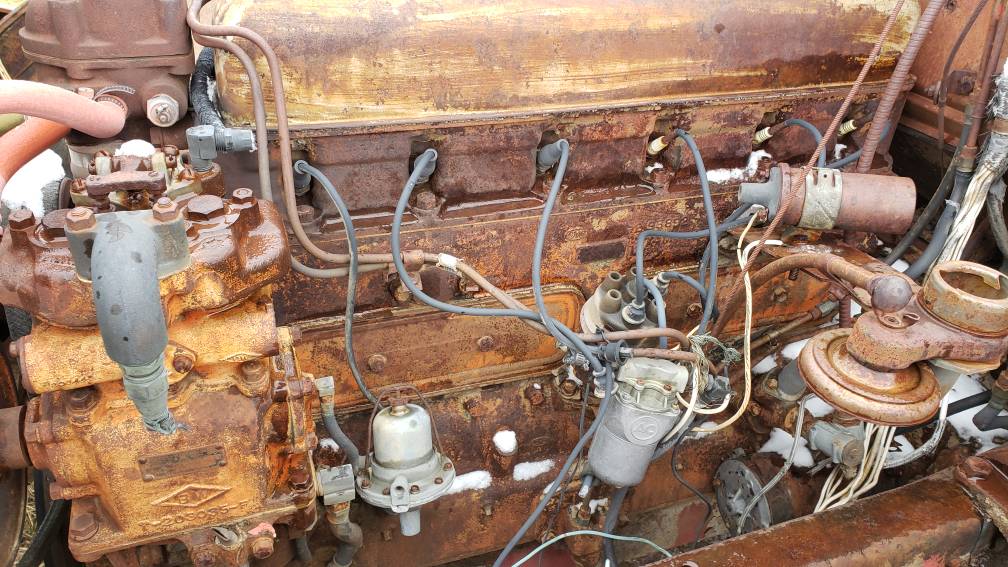

    Updates!
    Discovered why so few Boyertown-bodied Dubl-Dutis remain - the roof panels are riveted. And in my case, leak in a few spots, at the seams. They rust from the top down! My thoughts are to -weld- in replacement metal, to permanently seal off any leaks from occurring again. The damage so far is minimal, so I re-sealed everything with silicone for the meantime. Thoughts on the best way to repair it are welcome!

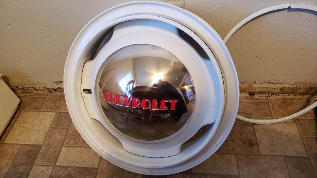

    Took the spare tire and carrier down, and broke the split rim down to ditch the ancient re-capped Goodyear on it. Think I'm one of a few my age who knows how to do so, and do it safely. Did a lot of them on the farm, and again in the desert (our M-series trailers use Dayton-style 3-piece rims; the dreaded widowmaker types). Much wire wheeling, since it's too big to fit in my abrasive blast cabinet, sanding and painting was done.
    Took apart the as-installed electric/hot water heater, and found a replacement. Mine's missing a few bits, and pretty bashed around anyway. It's a Mopar model 53 Comfort Master. Replacement came from a '48 DeSoto. Blasted everything, freed up and cleaned the motor. The replacement housing even had a good core in it yet! More cleaning and painting ensued.
    Ordered two new hubcaps from Jim Carter Parts (I have one GMC one, and one badly rusted), and one new tire, tube and flap. We'll see how it looks in white!
    More to come. 20200202_122357.jpeg 20200209_160627.jpeg 20200202_112407.jpeg 20200208_150401.jpeg 20200208_162733.jpeg 20200209_123508.jpeg 20200209_123540.jpeg

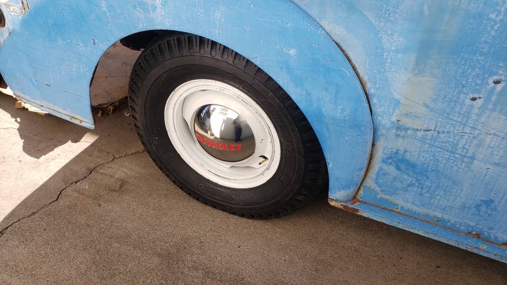

    One down, four to go...

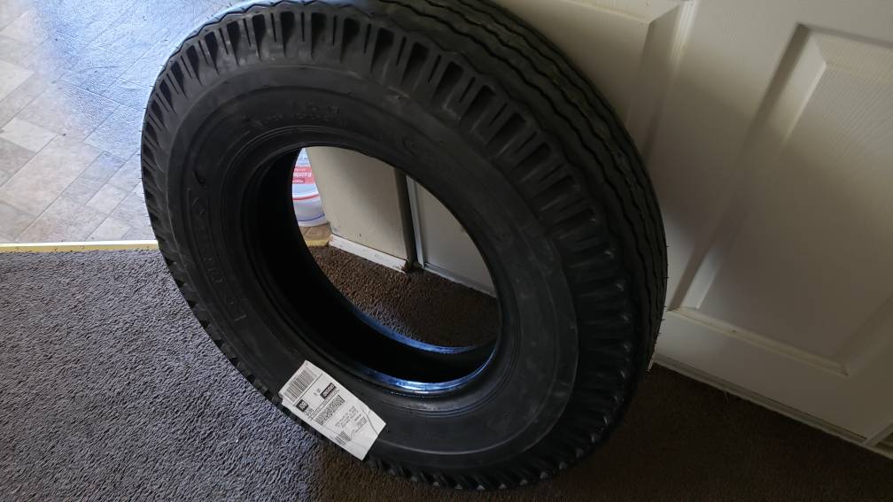

    Tires cost $269.22 each (with a tube and flap) after tax. Yeesh. Good thing I don't pay labor, huh? Really impressed with the quality of Jim Carter's repop hubcaps!
    Need to to a little touch-up, but man does that white paint look good. It'll be even better, once there's a nicely painted fender to tuck it under! 20200222_144645.jpeg

    Wish I'd have gotten a deal like that! The tires themselves aren't too bad - $187 each - but the tubes and flaps and tax added up. Summit has free shipping on orders over $100, so there's that much at least.
    I don't have a tire sledge, actually! I use a gooseneck (looks like a long iron rod with a wide, flat hook on one end), sledgehammer, and two tire irons to break the bead and work the lock ring and outer rim off. Not too bad, but it can take a lot of persuasion and a few choice expletives! I find that wedging the gooseneck between tire and rim, then angling it and using the hammer to 'push' it around the wheel to break the tire loose usually does it.
    In fact, I just broke down the next wheel today using this method. If you're interested, I'd be happy to video it next time. This one proved to be a bear to get apart. I did the spare first, and it came apart pretty easy. This one had been mounted for 50-some years, with the weight of the truck on it. It was stuck good! But I'm stubborn. Hit it with penetrating oil (Hilco Lube), since I'm not salvaging any rubber part, let it sit, then hammered away again. Third time, got it off! Worked on bead blasting the mirror brackets and some painting between 'sessions'.
    Also took my angle grinder with a wire wheel to some suspect spots, and discovered more rust to repair. Still not too bad, all things considered. Looks like all of it was the result of a leaky roof. Hit them with some rust encapsulater to hold it off until I can get the metal and welder to repair it. Found some lead filler, too! I'll leave it be, since it's the best way to fix stuff, other than new metal.
    Finally got around to installing a new hot wire to the ignition switch. No more jumper from the battery to the coil! Will order the wiring harness next month.

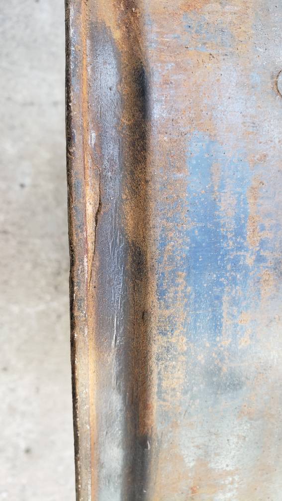

    Regarding the rust - I meant the body! There's a line of rusty spots all around the belt line, evidently from the roof panels leaking. I think I'll weld the new metal in the roof, as opposed to riveted as original...
    The wheels so far have been great! Surface rust, easily taken care of with the grinder and wire wheel. I throw the lock rings in the abrasive blaster, and check them carefully. I think with this design, the rings could be in several pieces and still not come apart, as the outer rim completely traps them once it's set. But I'll not risk it, thanks.

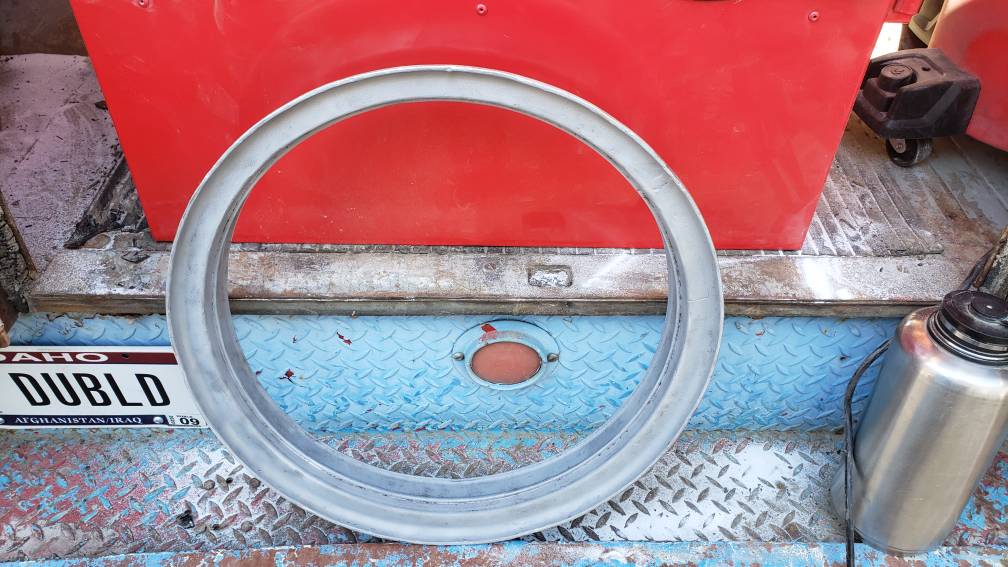

    Well, ****. Can't use that wheel - found a 1 1/2" crack in it, right along the split ring channel.
    Got another one at Jim's ($20), but can't get the $&#@+$+ tire off. Outer rim and split ring were toast - badly rusted - but what I can see of the main part of the wheel looks good. Bit of rust on the backside edge, but nothing I don't think would cause a safety issue. Ring channel looks fine. Clean, surface rust only.

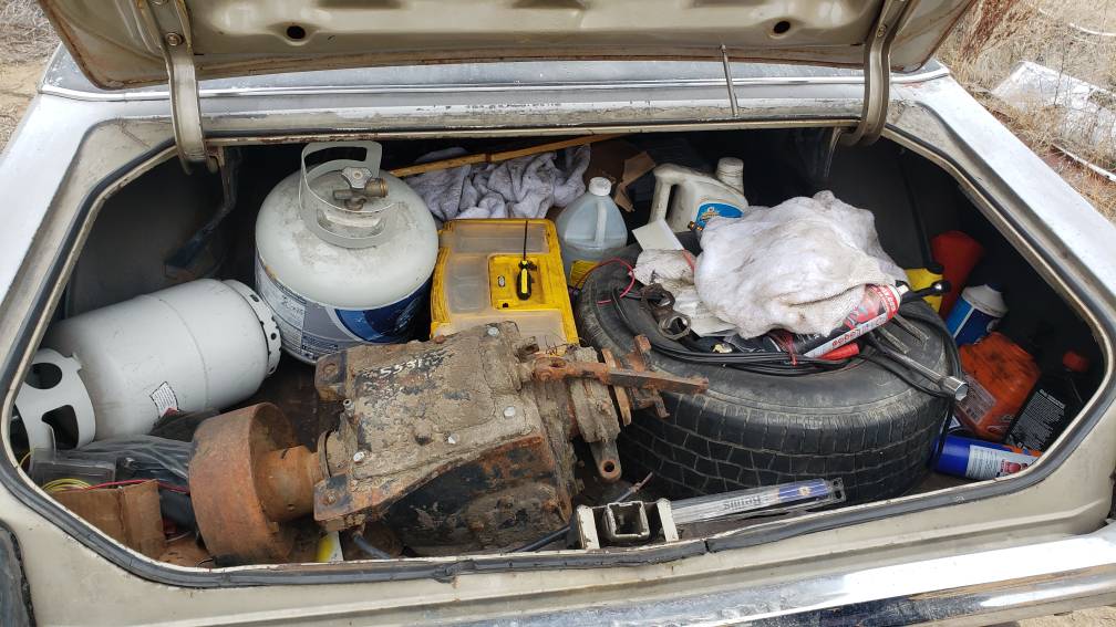

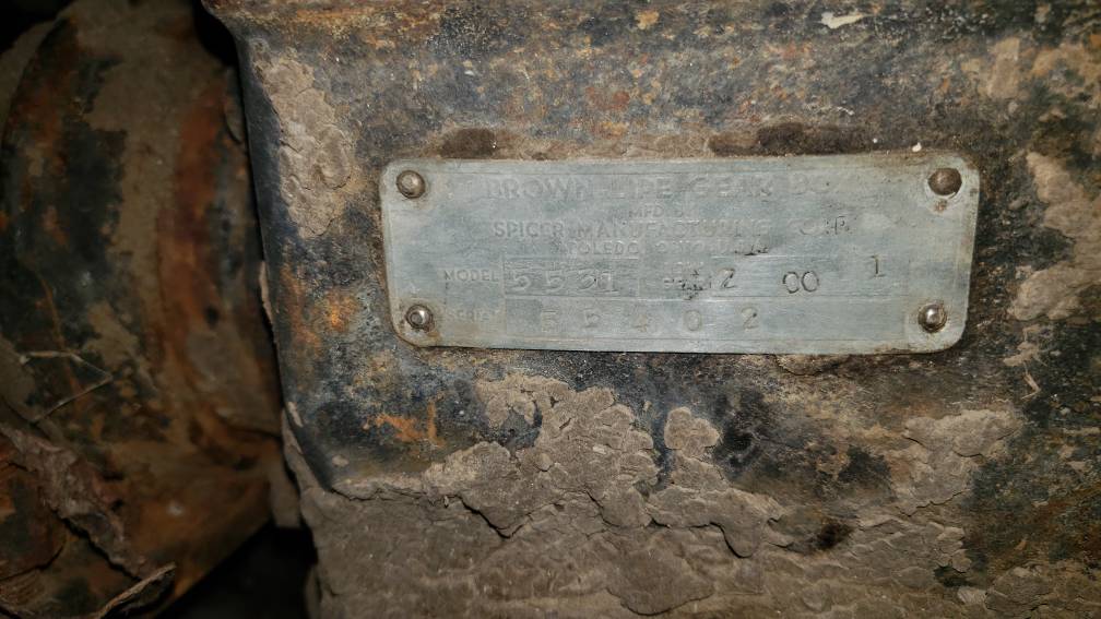

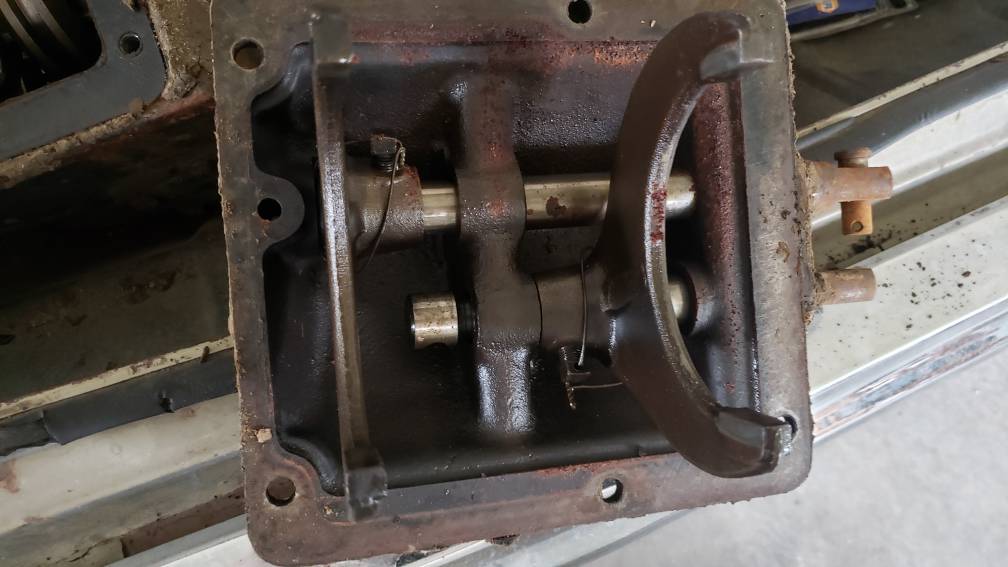

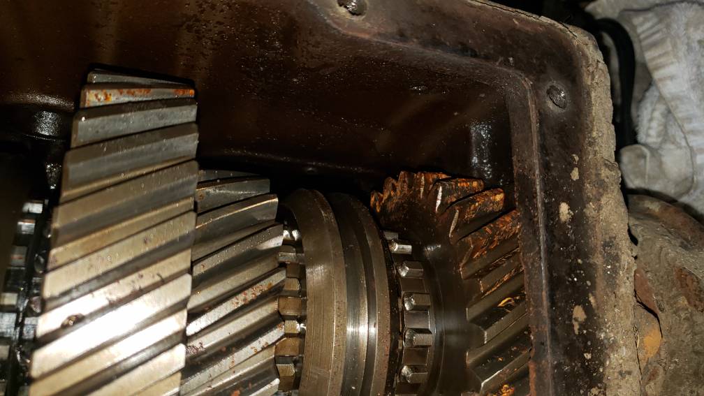

    Oh, hell... forgot to post this: One Brown-Lipe 5531 auxiliary transmission!
    Looks to be in acceptable shape - turns smoothly, still a bit of oil in it, and no water. Little of the soft surface rust one a couple of gears, but seems to wipe right off. Little 'rumbly', so I'll tear it down and check the bearings, and put new seals in. Got a good shifter with it, too.
    Gear ratios are:

    I'd cut the b!T@# off if you have to. You probably figured out some way of getting it off by now though, I haven't been around here in a while. Now that we have a mandate for Shelter In Place in California, I have time on the computer...:rolleyes:
  21. Alister
    Joined: May 10, 2009
    Posts: 51
    Alister
    from Idaho
    Ugh. Sorry to hear, man.
    Yeah, I did cut the tire off, only to find the rim was way too badly rusted to be used. So, another trip to Jim's, got another rim (broke it down out there without issue), looked good. Cleaned it up, painted, and installed the new tire without issue. Oh the price we pay to play the game!

    Welp, one more tire mounted and the spare tire carrier is cleaned up and ready for paint. Took a peek at the brake and bearings on that wheel, while I had it off - lots of meat on the linings still, no sign of leaks, and the bearings felt/looked fine, so put it back together. If it ain't broke, don't fix it!
    It'll last more than long enough to convert to disc brakes and dual-circuit, anyway.
    4th tire just arrived, so that'll be this weekend. :)

    Last tire went on today, so she got driven a little. Much better ride, now, versus the 40+ year old flat-spotted ones!
    Sent from my SM-G960U using The H.A.M.B. mobile app

    Hey man, great truck!
    I'm looking for a browne auxiliary trans for my 46 Chevy two ton if you come across any more, or if you decide not to use this one, let me know please.

    No problem! I believe he has a couple of 5831s out there still (slightly bigger than my 5531), but no tags on them so I can't be sure. One was straight, no parking brake; the other had a disc-type brake on it. He wants $500 for the boxes, and $100 for a shifter to go with. Shoot me a PM if you're interested, and I'll send his info.

    Holy cow, that looks like a pretty bad wreck. Good thing RIP Alice wasn't RIP Alister!
    The rust is probably not too bad on the gear, but the synchro teeth look a bit chewed up:
