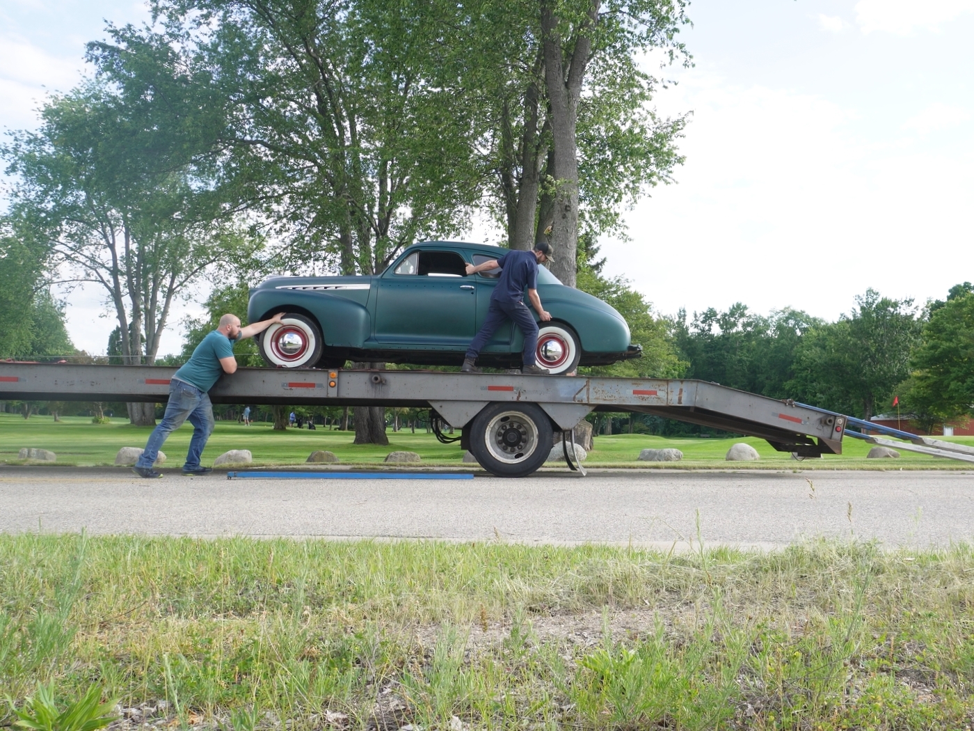

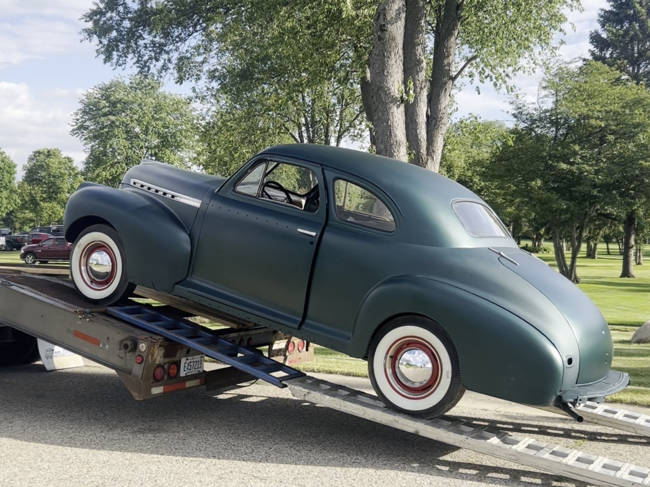

    I'll be using this thread to do***ent progress on my 1941 Chevy Coupe.
    It's April, 2024, and I had just sold a modern motorcycle and had some cash making my right rear pocket hot. I was really looking for something in the traditional vein, and for some reason, this '41 Chevy from Kentucky kept coming across my marketplace feed.
    The guy who owned it had gotten it in a trade deal, and was looking to move it down the road. It was pitched as "could be driveable in a weekend." We know how that song goes, right?
    I texted a couple buddies about it, and with very little convincing needed, I pulled the trigger. I bought it sight unseen and sent another good friend down to Kentucky to fetch it for me.

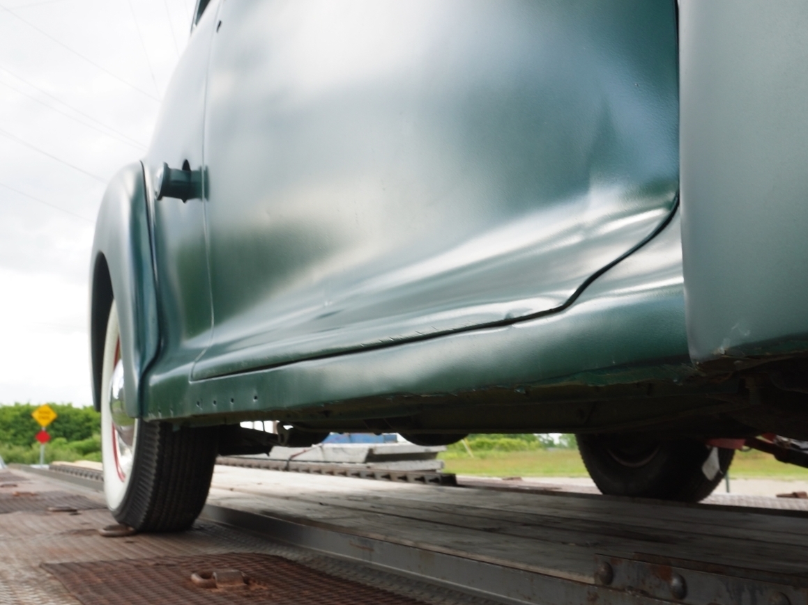

    It turns out to be an overall very solid car with some "quick" body work and paint done. There's mud in the right hand rocker, and its painted in this satin metallic green color with varying levels of sheen per body panel.
    The rest of the sheet metal, frame, and floor is pretty rock solid.

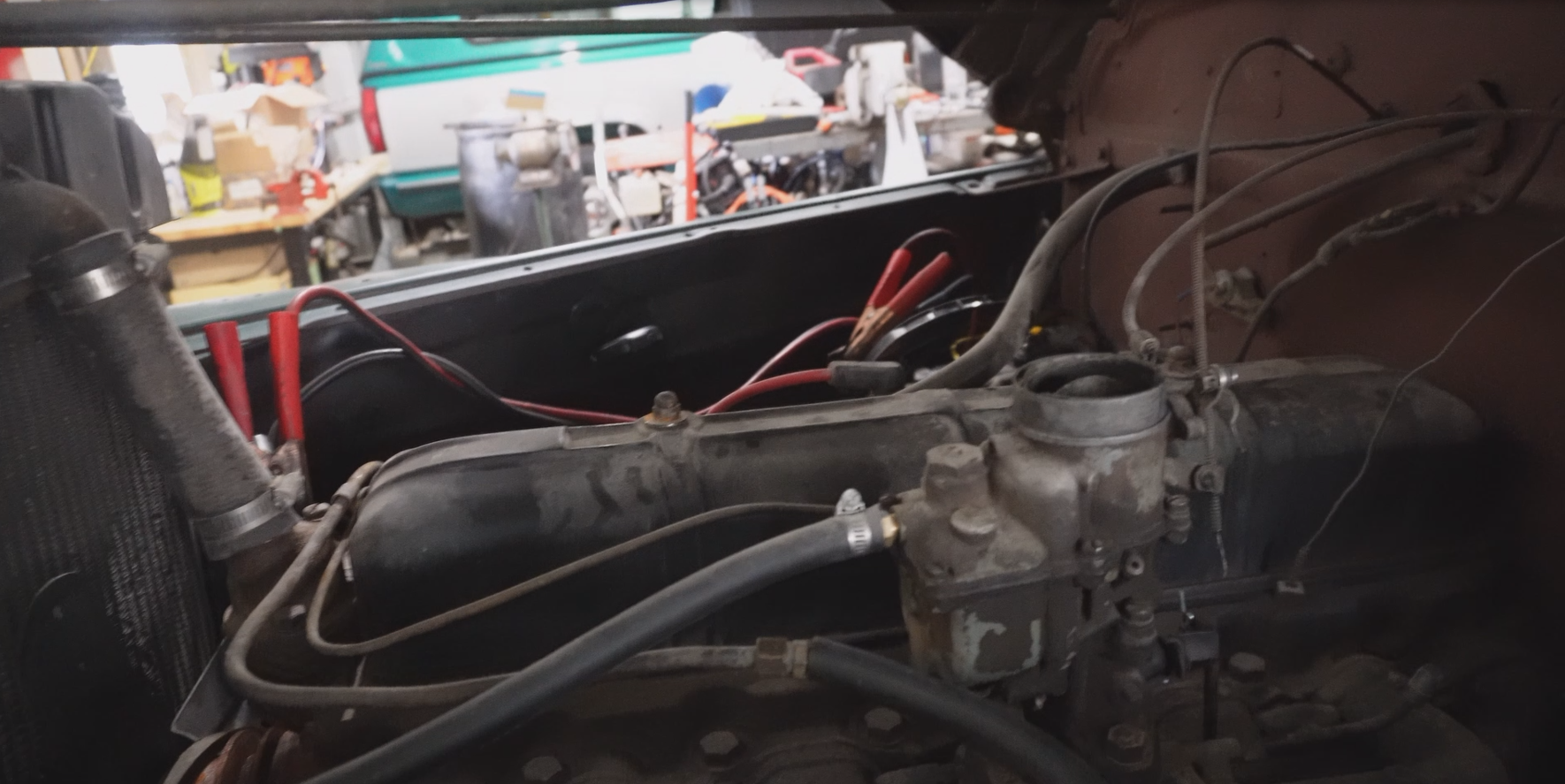

    The Chevy is running the original drivetrain with a 216 buzzin' half dozen, vacuum ***ist 3 on the tree, and solid driveline.
    The "12 volt conversion" made me laugh a little as it appeared to be as simple as a 12 volt ignition coil and a couple wires run to a toggle switch on the dash.
    I utilized these parts to get it fired up and running shortly after getting it into my shop.

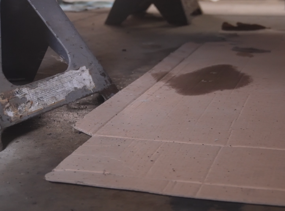

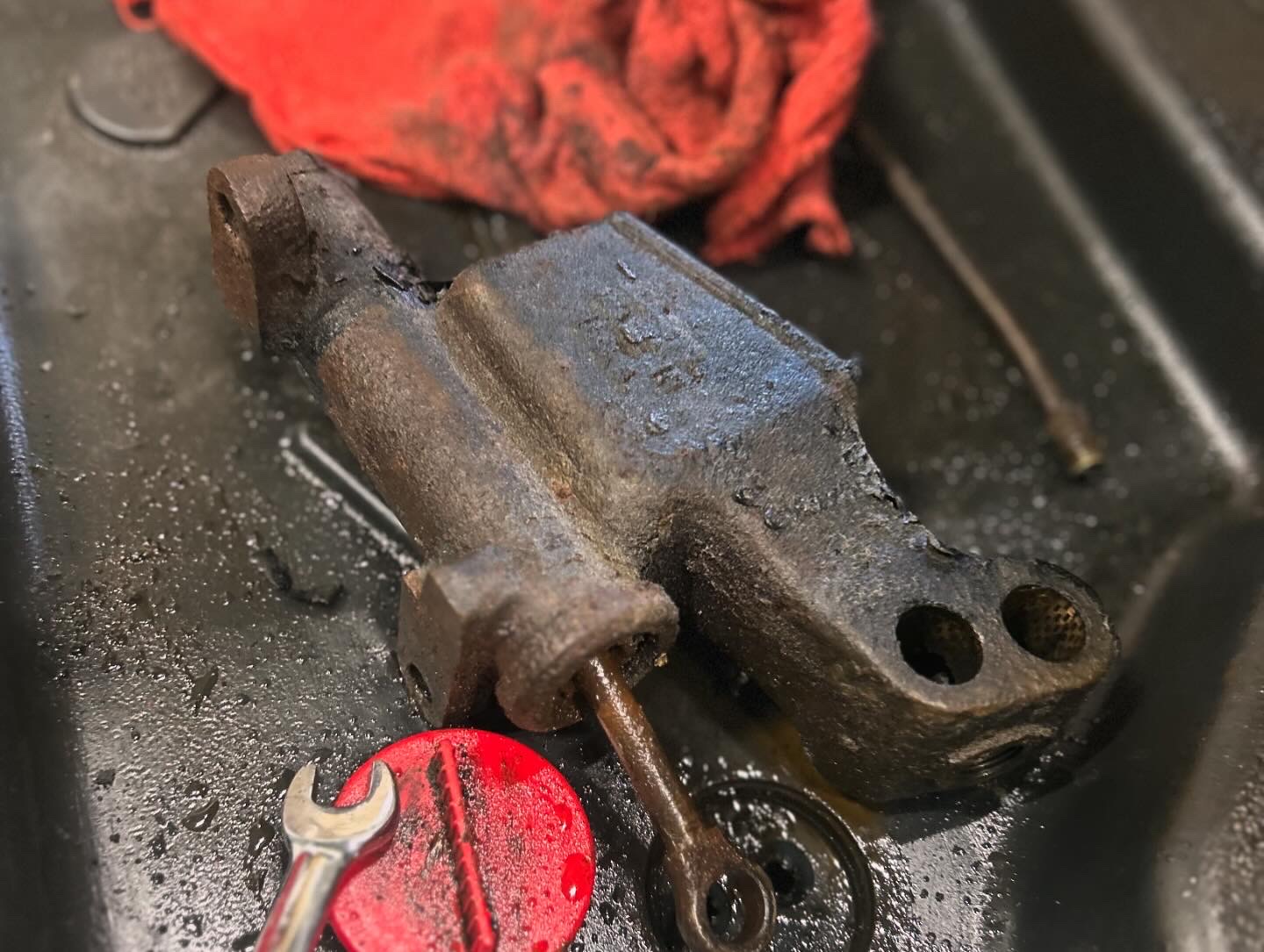

    The master cylinder is leaking brake fluid past the seals!
    The large spot on the cardboard in the above photo ac***ulated over the course of about a week directly under the master. I could see on the front of the master it was all wet too...
    Looks like I'll have to replace the master cylinder.... Wasn't looking forward to that, but it was always in the back of my mind that I might have to do it.
    Here goes!

    Alright boys, I'm sick of playing catchup, and I've been tinkering on the car pretty regularly lately so lets get caught up!

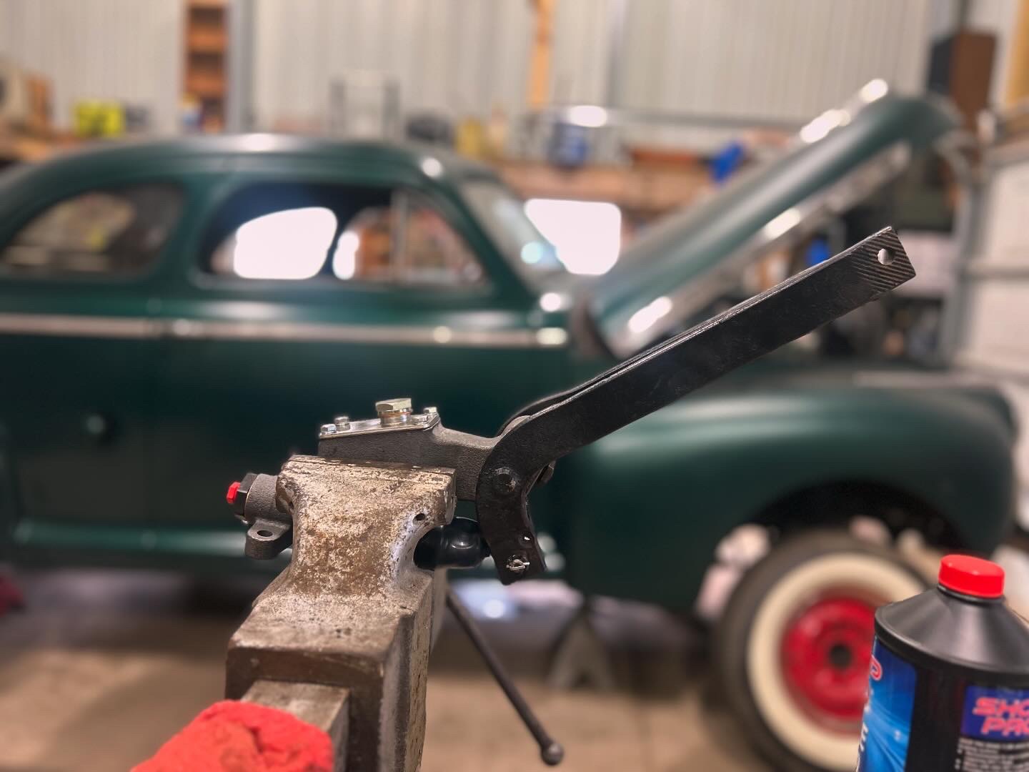

    So.....I replaced the master cylinder!
    Wasn't nearly as bad as I thought it would be. I made up a new piece of 1/4" brake line with a piece I had lying in the corner that was the perfect length. I had do do some ultra-light fabrication with the fitting that came with the new master. It needed to be cut shorter in order to work with the tube nut on the end of the line, and I needed to change the flare on the master end of the line to a bubble-type flare.
    After all this, I was able to bleed the brakes using a bungee cord after removing the pedal return spring with only one man: ME! I did have some pedal pressure after a few pumps. Good enough to know the brakes would work with some more bleeding and adjustment.

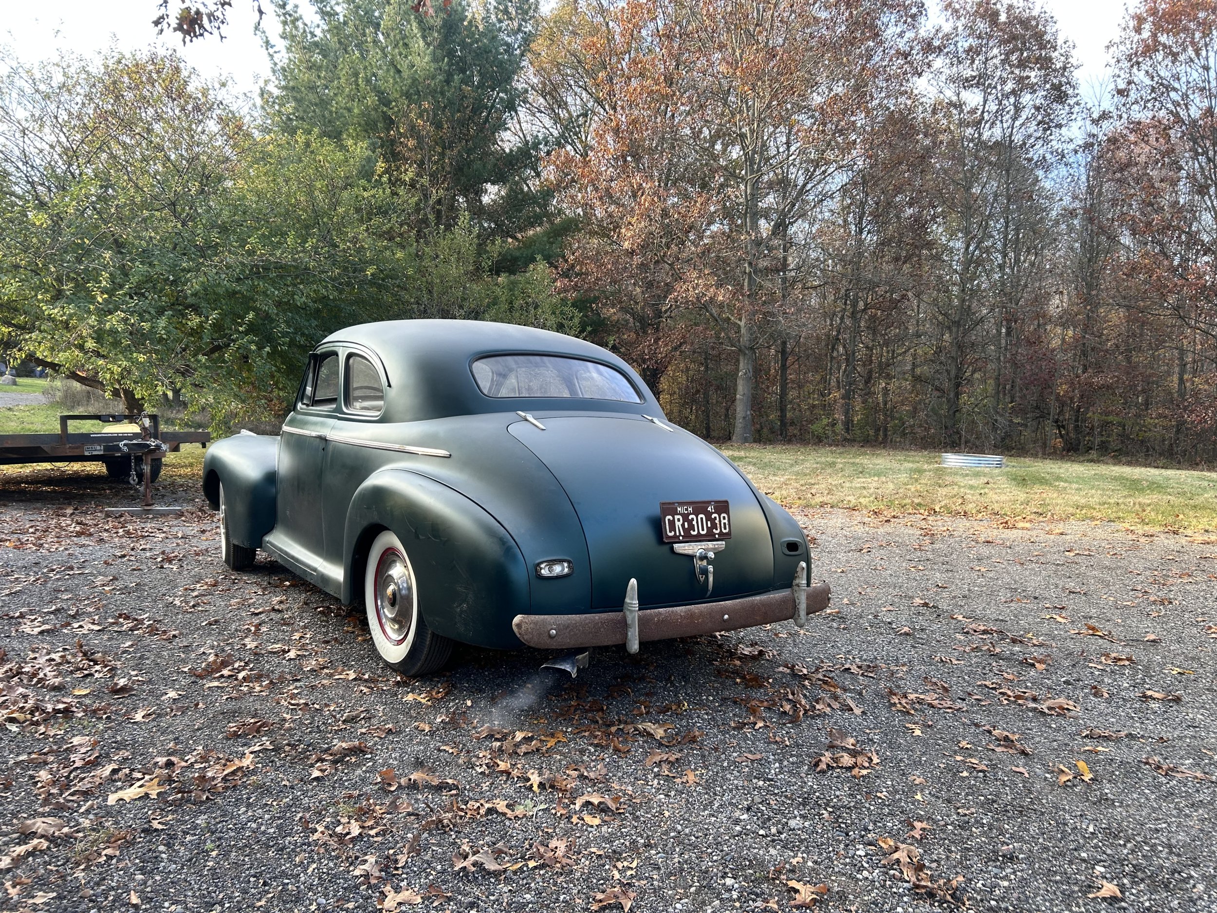

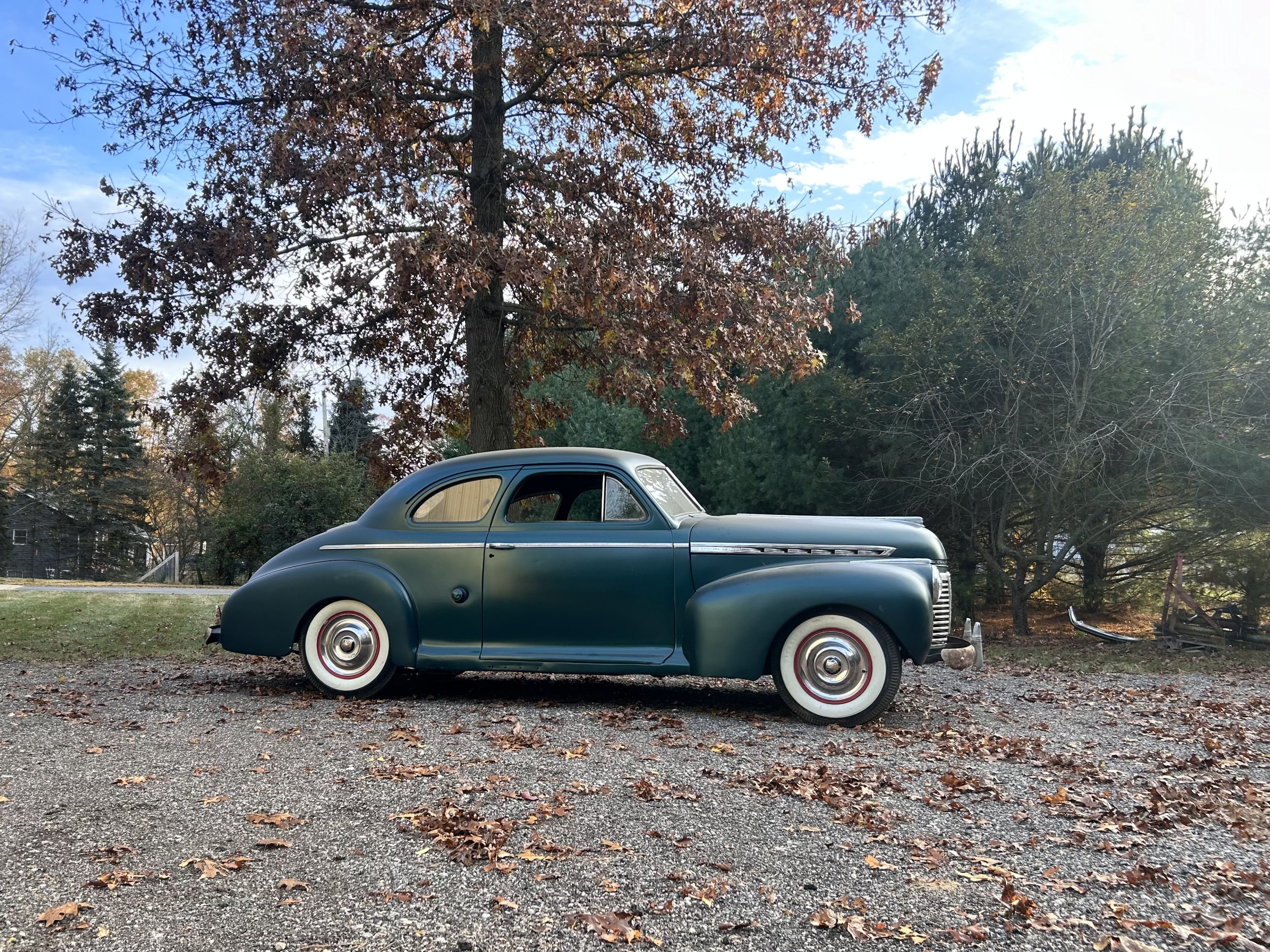

    I’ve been slacking on this thing a little bit, I mean busy with my real life… anyway. I get a couple hours here and there to do ANYTHING around my house, and when I was done working on my broken lean-to, I had to fire the Chevy up and pull it outside for some motivation.
    There’s a little video of me walking around the car on my Instagram if you are interest in seeing that: https://www.instagram.com/p/DBrzN1Zv5jd/?igsh=MWNva3V4a244Yjk4Mw==
