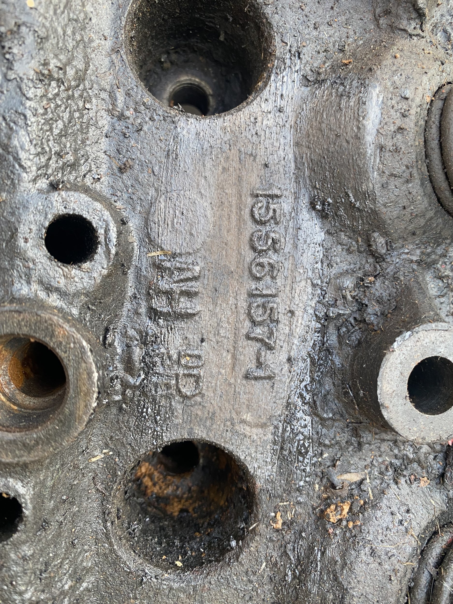

    I found this at Hamb, se piture but all info I had before it was told be 54/55 331 and the 555 heads or ’triple nickel’ had the casting number
    1556157-1 ( as I got today ) and I know 2 locally has that head on a 392 block, and AI on internet also say its that number.
    But this ’source’ means the true triple nickle had the number 1555758 (?)
    -Ideas as just for the records.

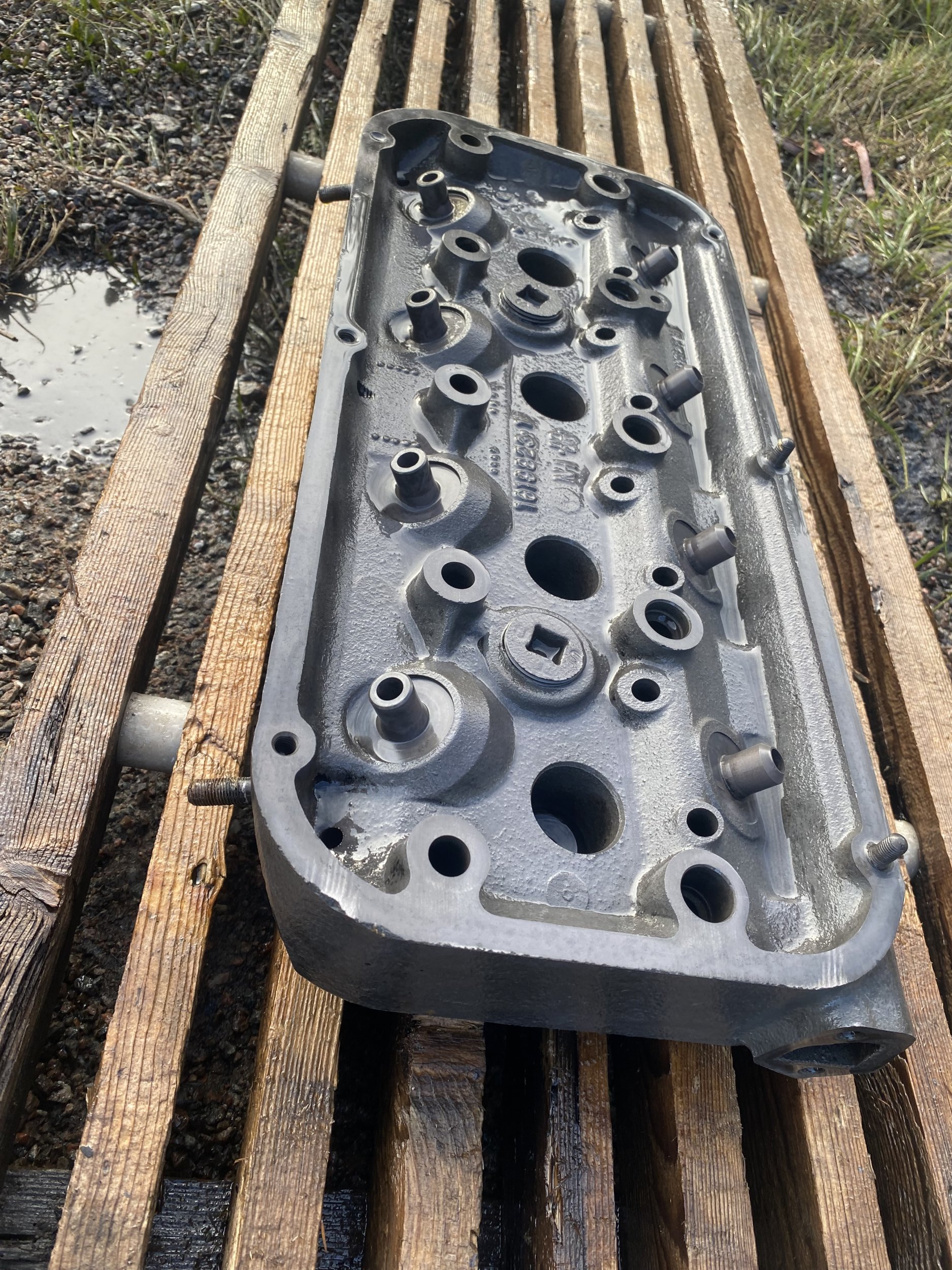

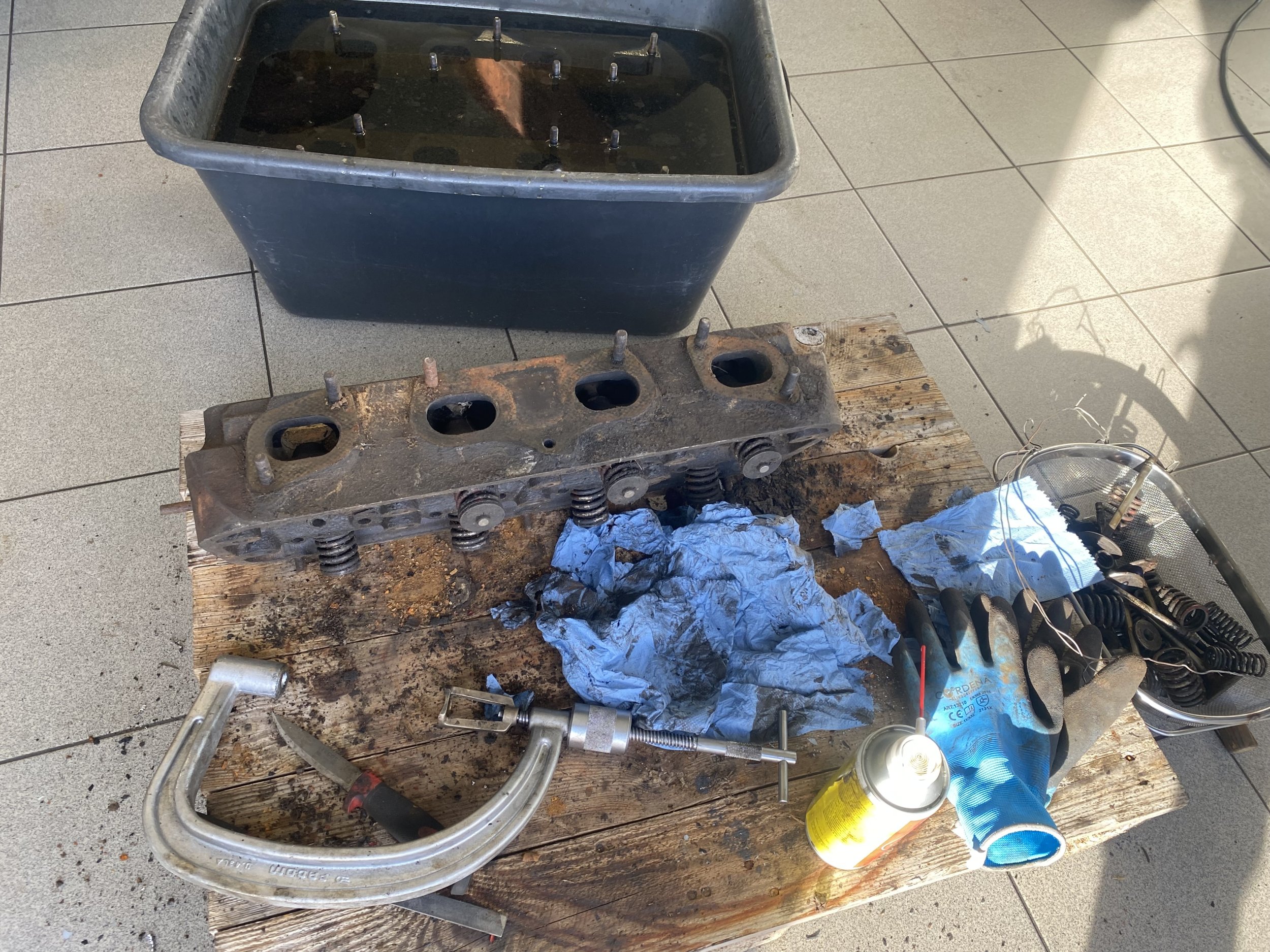

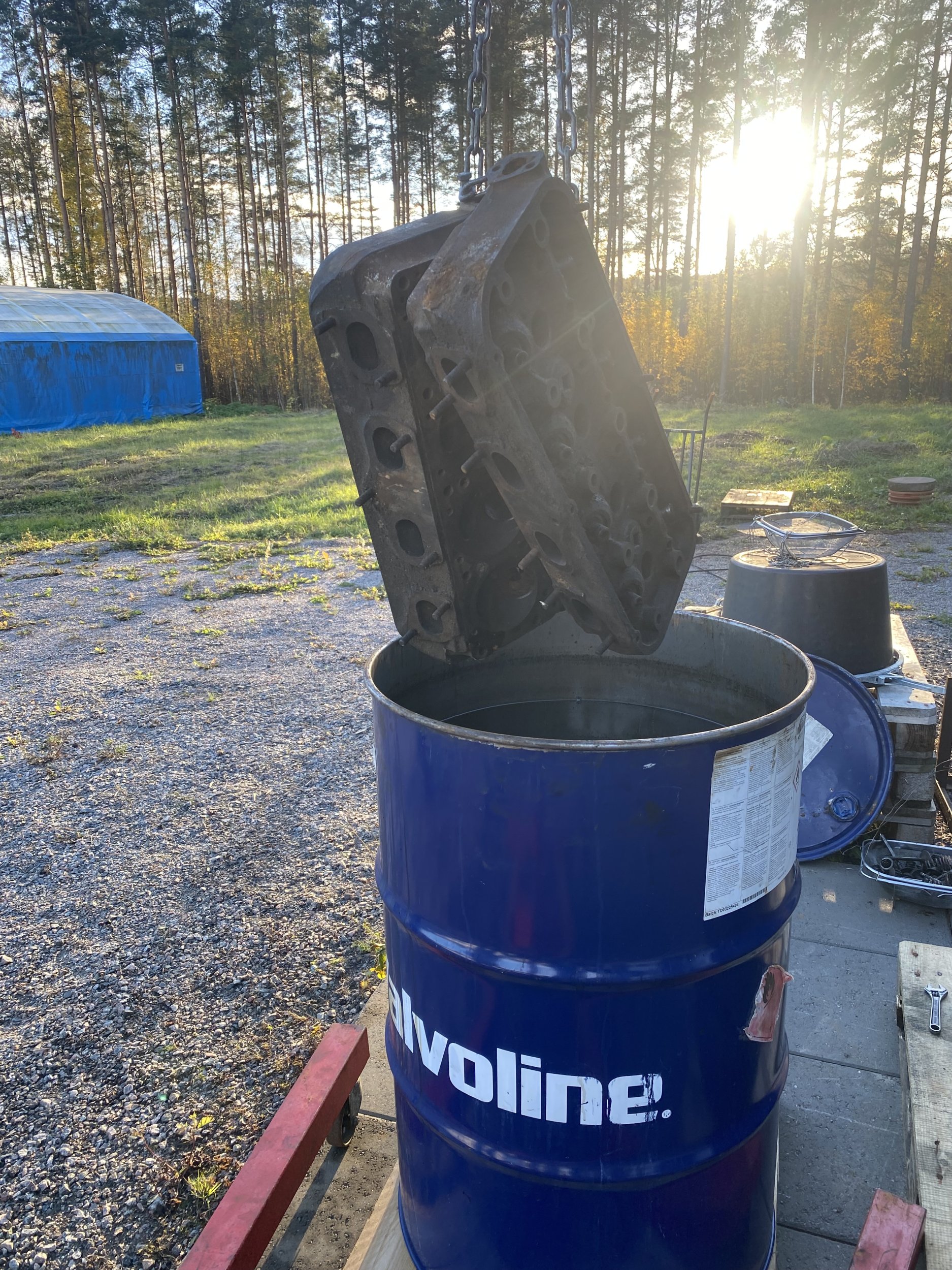

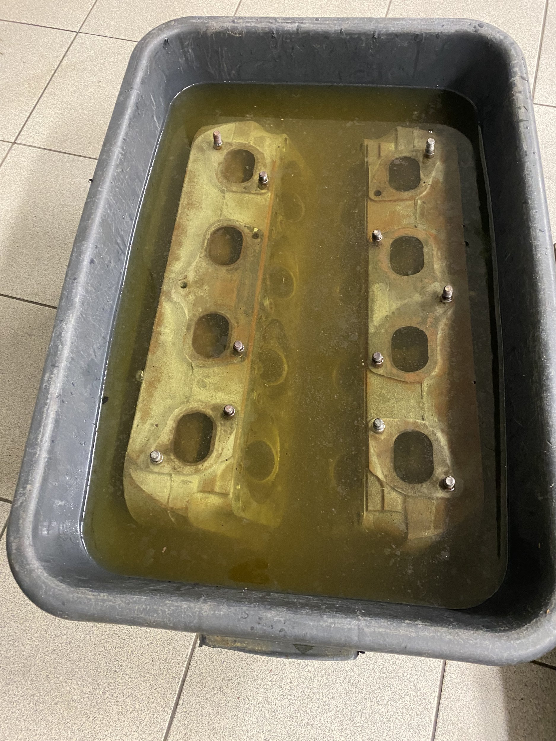

    354 heads In lemon accid after hot tank.
    I has bought a laser cleaner that I get soon.
    Now the 555 hies hot tank.

    I tested it on a block and I was amazed.
    Rockers out of hot tak, some rust but the laser its super clean.
    Normally I use lemon accid.

    My source says 1556157 is correct, was thinking the 555 together was the right # but it's not in the refs. The '55 331 & 354 car hemis w/o valves you can look in the intake port & see out the ex port, but it won't run well that way.;) Might make a difference on a 2 stroke engine. In the Tex Smith book Garlitz said it doesn't make much difference so he doesn't bother changing them out, of course he could have been blowing smoke up our ***es.

    I thought the "555" was at the end of the part number. I had a set about 20 years ago and I seem to remember it that way.
