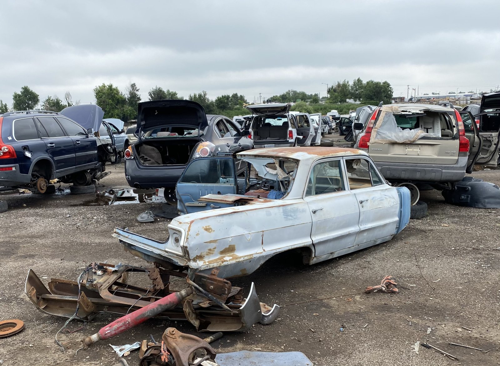

    Dammit...both of those pancaked Buicks have a 430 or a 455, hopefully had. Makes me wanna cry. This crushing frenzy as of late isn't just up in MT it's here in CO too. If you watch Roadkill, this is the same yard where they got the Disgustang. Putting the last of their old stuff out there too....got a bunch of stuff off of these. Never enough though.

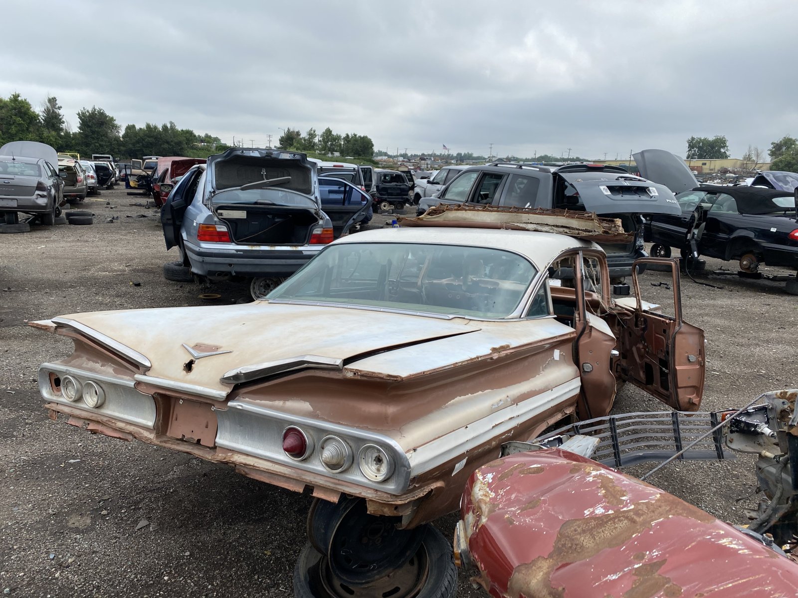

    Oh man, that 63 and 60 look pretty picked over, but I bet there’s still goodies there. I’d love to dig around in the 60 especially. It’s wild that the taillights and cove panels are still there.

    Appears the dash is still in that '60 as well, at least the sheetmetal part of it is. That'd be worth cutting out, and whatever trim parts are left, even if they're dinged up. Glad someone is saving something off of them before they're gone, that '60 would be worth picking clean if the price is right.

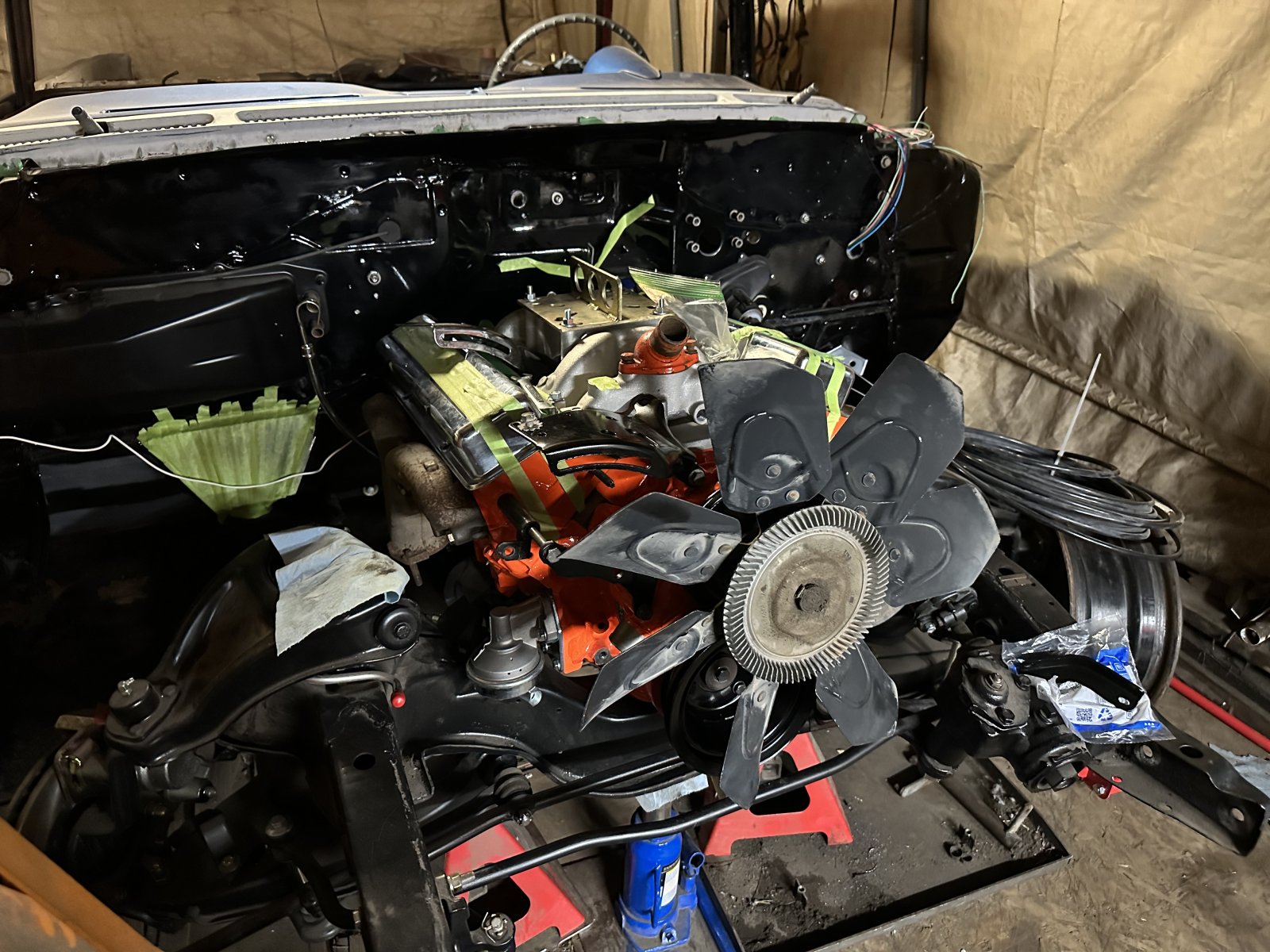

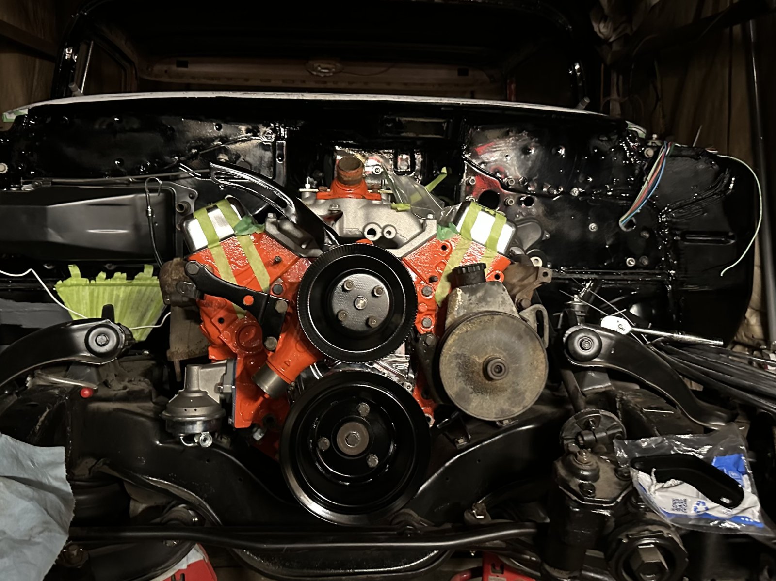

    Nothing too exciting…. I’m trying to make accessory brackets line up. You’d think that everything would want to behave since most of it was off the same car, but nope. EC657F57-022F-4454-A050-0970C8048601.jpeg
    I’m still running wild with the green tape.

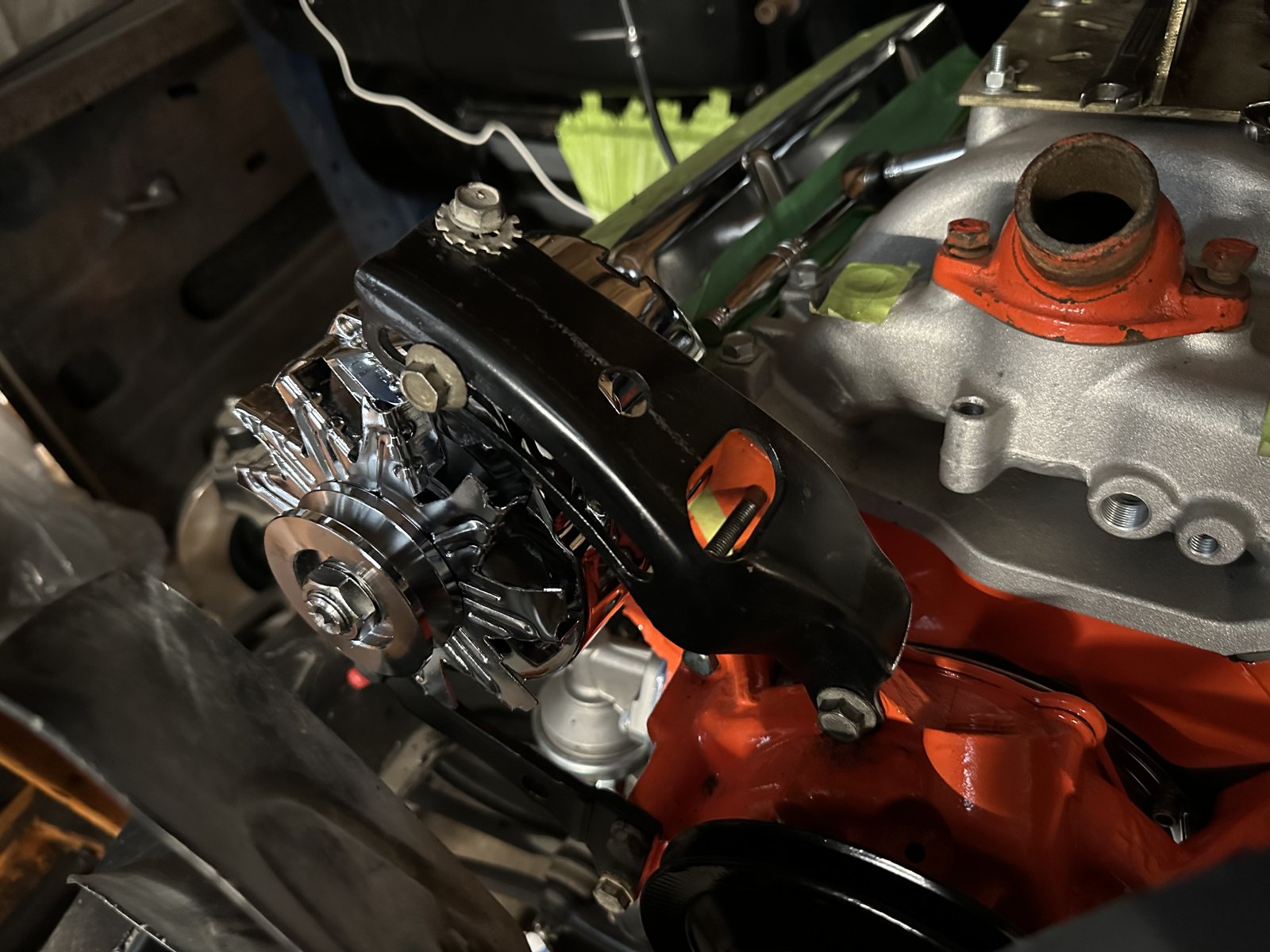

    The cheapy Jegs Airgap has the boss for the top alternator bracket too high. I’ve got the style that bolts to the thermostat housing too, and that’s even worse.
    At least the fan and WP pulley fit.

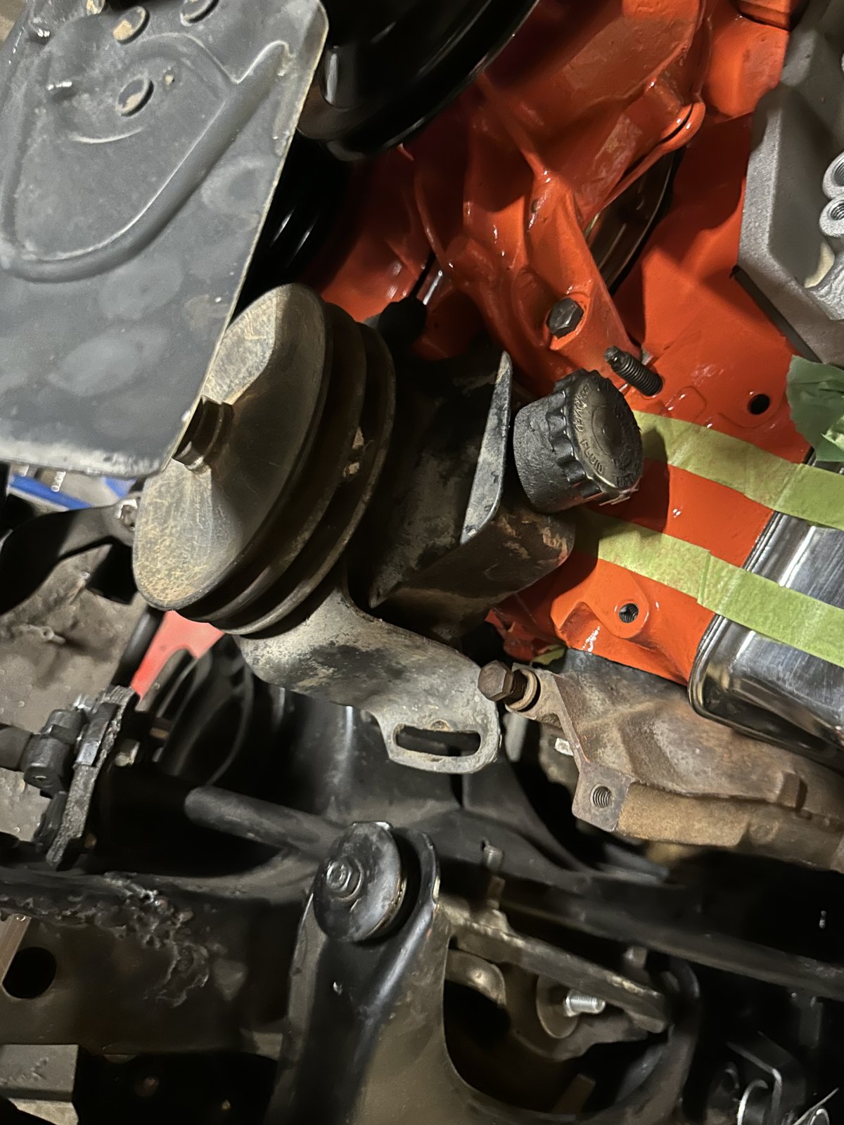

    The new water pump and the one that came with my block both have a threaded hole where this power steering bracket bolts to it. The car I took it off of was a through hole with a nut on the back of the bracket. I’ll drill it out if I decide to use this setup. The bracket is also hitting one of my timing cover bolts.

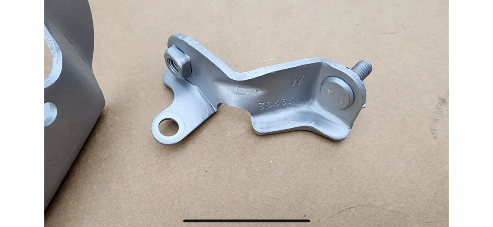

    I left this bracket on the donor car exhaust manifold hoping the holes in the end of my rams horn would line up. They don’t, but making a plate with 3 holes in it will be easy.

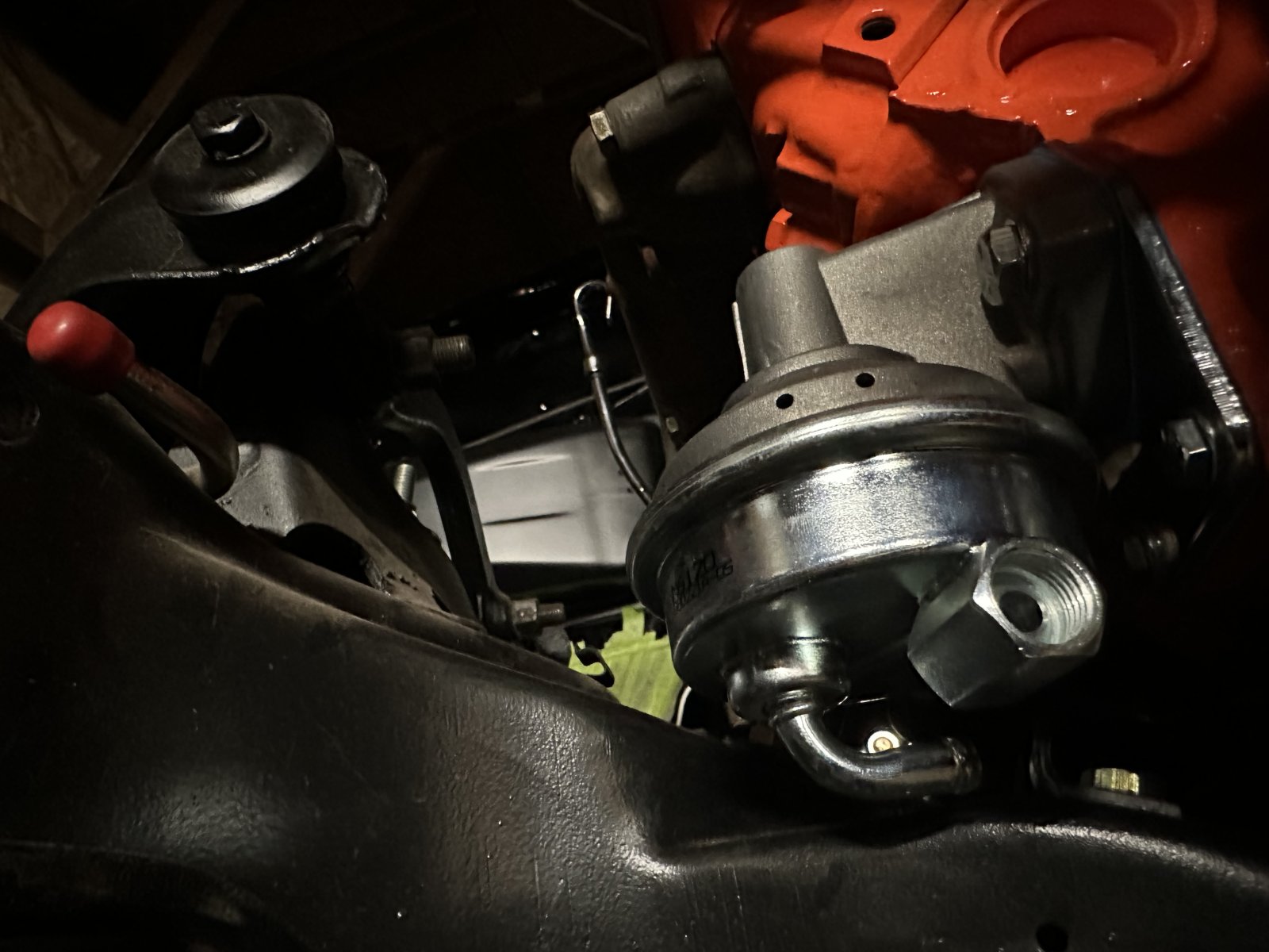

    The new Carter fuel pump I bought’s inlet is facing a stupid direction. Noting I can’t deal with but it seems goofy.
    My lighting is now lousy because I decided to plug an angle grinder into my LED 4’ fluorescent rather than pull an extension cord. That didn’t work out.
    I’ve got an alternator in the mail. Once it’s here I’ll either cut up the top mount or chase up a different style. I’ve got decisions to make about the PS pump mount too. I still need to finish up the HEI.
    Stogy, bchctybob, brEad and 3 others like this.

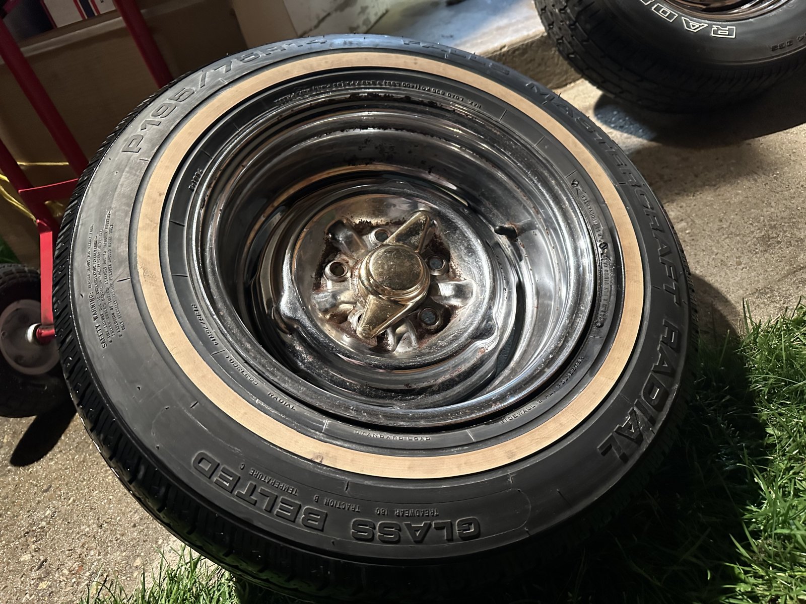

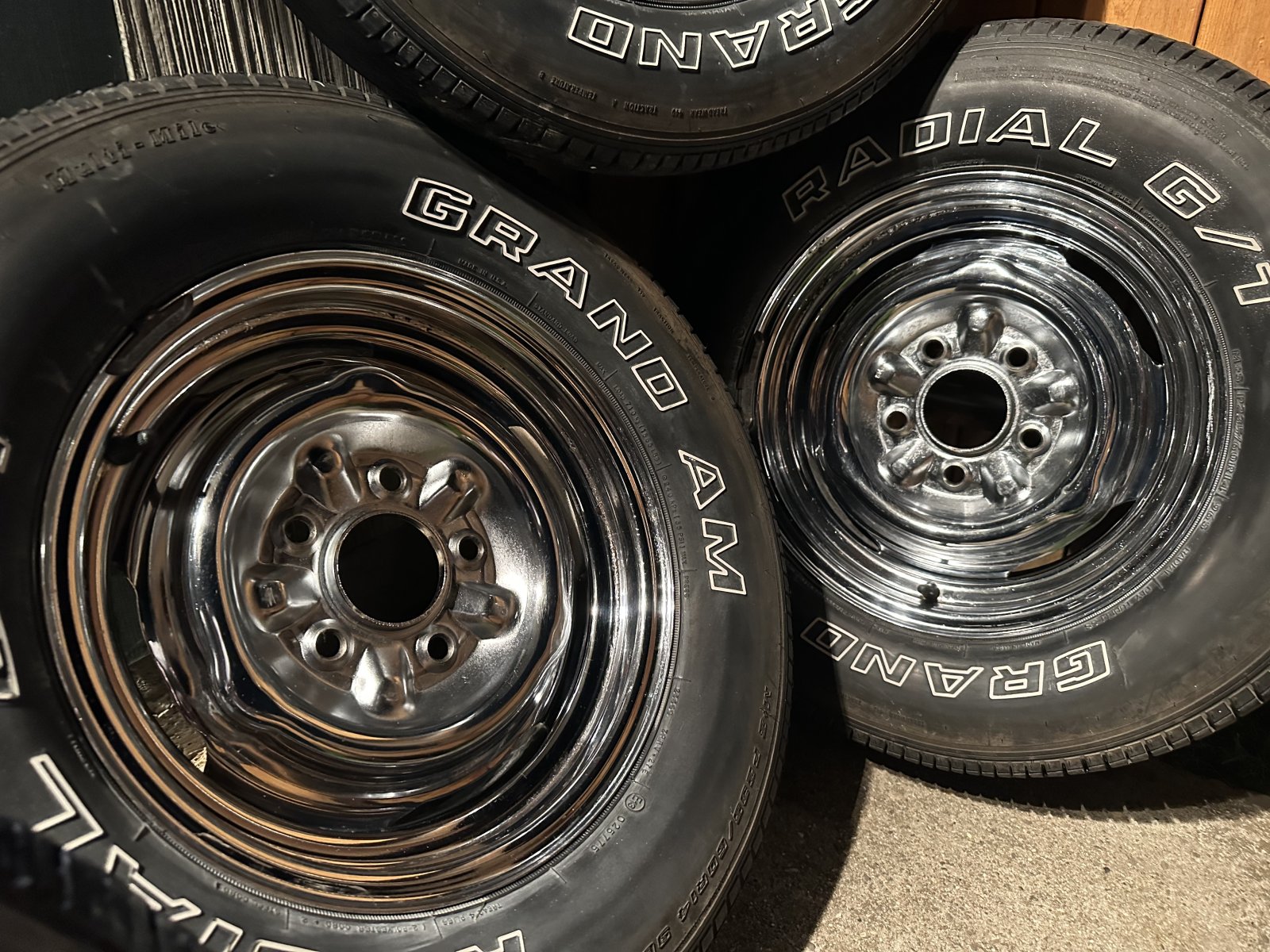

    Morning break time score. I got 3 standards on one reverse. I’ll get 4 of something one of these days. They look like they’re probably 14x6. I’ll clean em up later and see if they’re p***able.
  11. lewk
    Joined: Apr 8, 2011
    Posts: 1,084
    lewk
    from Mt

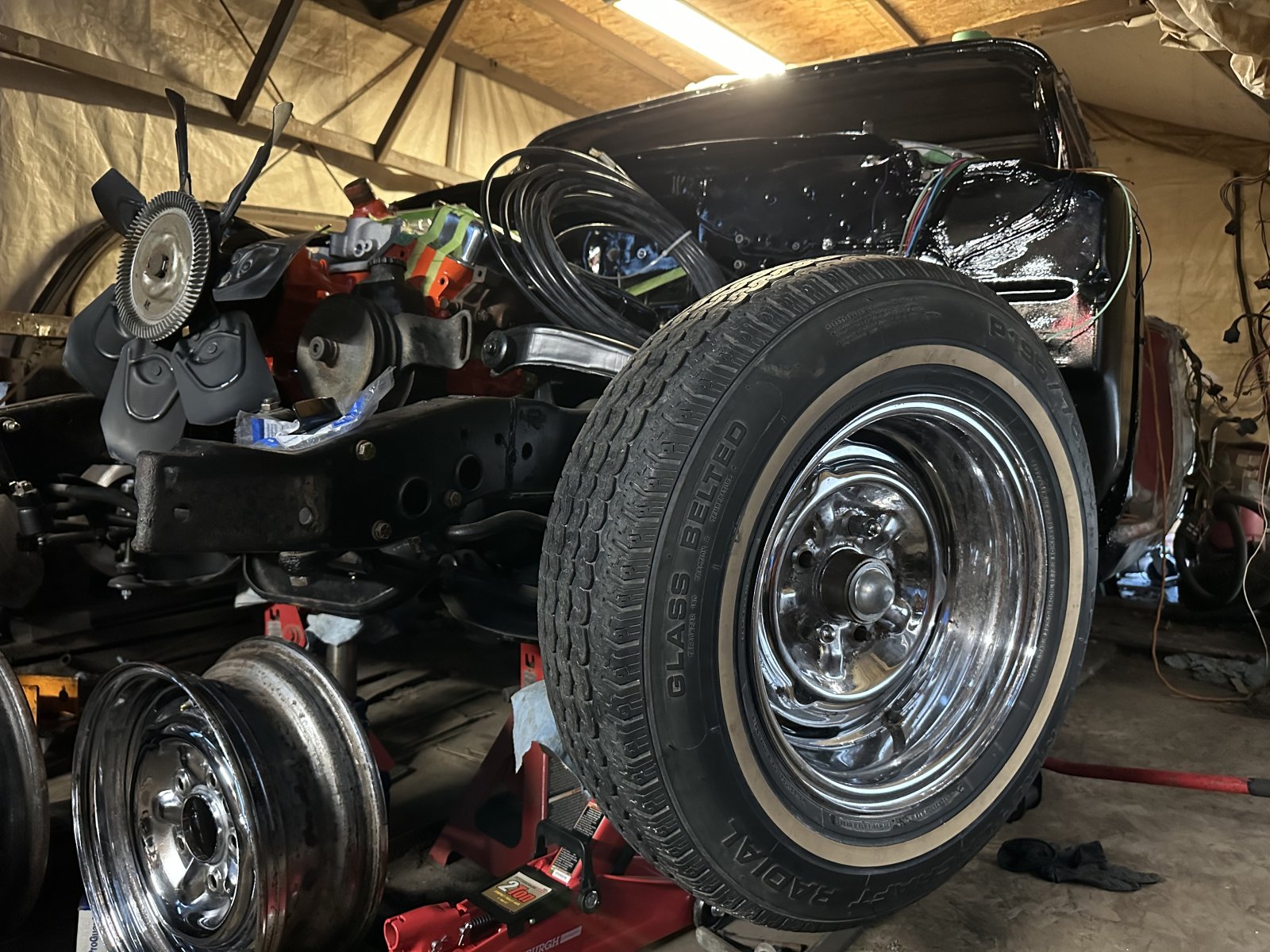

    After a little cleanup, they’re far from perfect but probably good enough. (3) 14x5s and a reverse 14x6. I need to come up with 4 of something!
    D5CDECAD-231B-49C7-B7B6-EA77A1122FD8.jpeg 9D389BC2-290A-4619-9543-07F8A6FA8C86.jpeg 767EC237-C36E-43EC-9B76-EA41C93CDA80.jpeg
    Wide whites or pinners?
    Stock Racer, Stogy, AHotRod and 5 others like this.

    Nice score any chromes are good chromes. Pinners or blackwall. Wide whites are no go they're so over used these days and never correctly. @Moriarity is the only one who uses wide whites in the correct context. Well, he and maybe a couple others...

    What about putting the bracket on the bottom of the boss and thru bolting it for the alt?

    It’s going to be low so it needs whitewalls. Pinners are an order of magnitude cheaper than wide whites anyway. I’m pretty excited about these even if 3 of them are only 5”.
    I tried underneath. The bracket looks like it wants to be in the middle of the boss. My alternator should turn up today or tomorrow and I’ll double check. If I can’t get it to work, I’ll get one of these:
    I’m pretty excited about the chrome wheels and skinny whites.
    Anyone got one 14x5 or (especially) 3 14x6 reverse OEM style in old chrome they don’t want an arm and a leg for? I know I can get new ones, but if I’m spending a grand on wheels I’ll get Supremes.

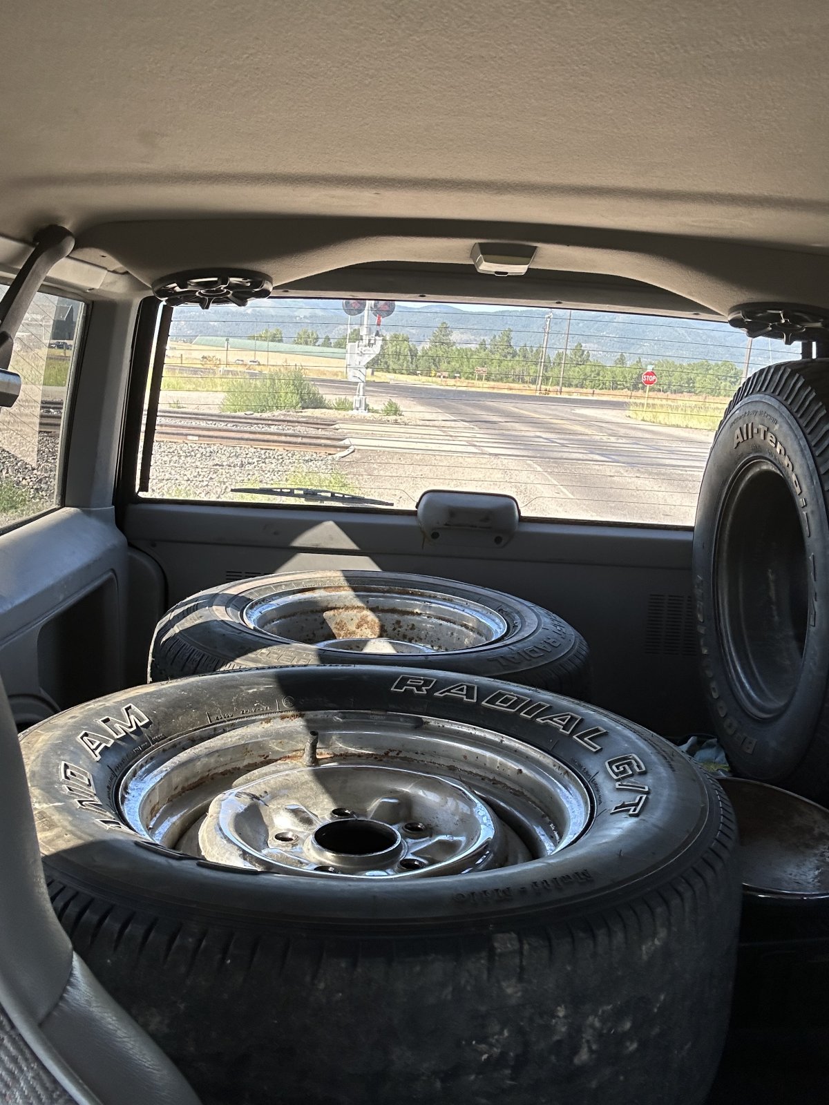

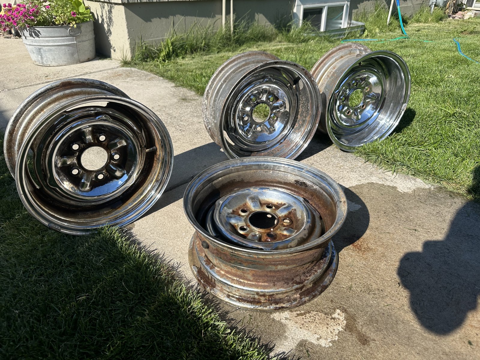

    I’m out shaking every chrome wheel bush I can find and I’m up to 8. More 14x6, need to check the offsets and see where we’re at. Here they are after a really basic clean up with barkeeper’s friend. I haven’t busted out the Coke, ketchup, aluminum foil, 0000, or wood bleach yet. 4F7A0C5B-116B-4F54-81FA-D3846D41B3BA.jpeg
    They’re still pretty grubby and the rust might be too awful on a couple.

    Hey Luke , we always used to cut down the factory alt bracket to the same basic shape as that aftermarket one, always worked fine.

    Thanks for the tip Colin. I was looking at it this morning wondering how one would hold up if I cut it down. Sound like it will!

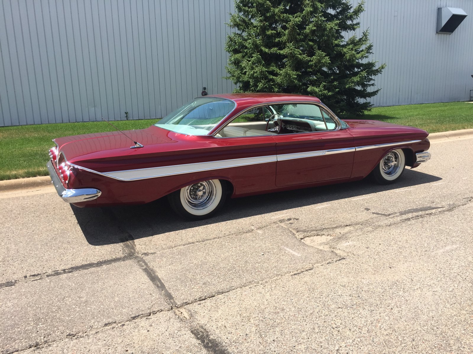

    60’s can run wide whites and be correct but they need to be 2 1/4” whites, 61 is the last year that wide whites were available from the factory, here’s a picture of my Impala, it would be so wrong with anything but wide whites

    I never get tired of looking at your '61. That's a strong argument for wide whites. I like this '60 Elco too: (no idea who's it is, would like more pics)

    I trimmed my alternator bracket. It still needs a repaint, but I might whittle a little more off it before I do.

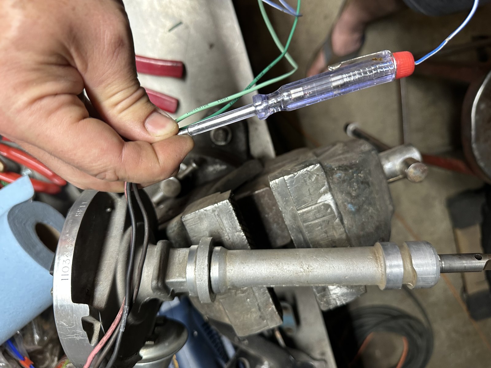

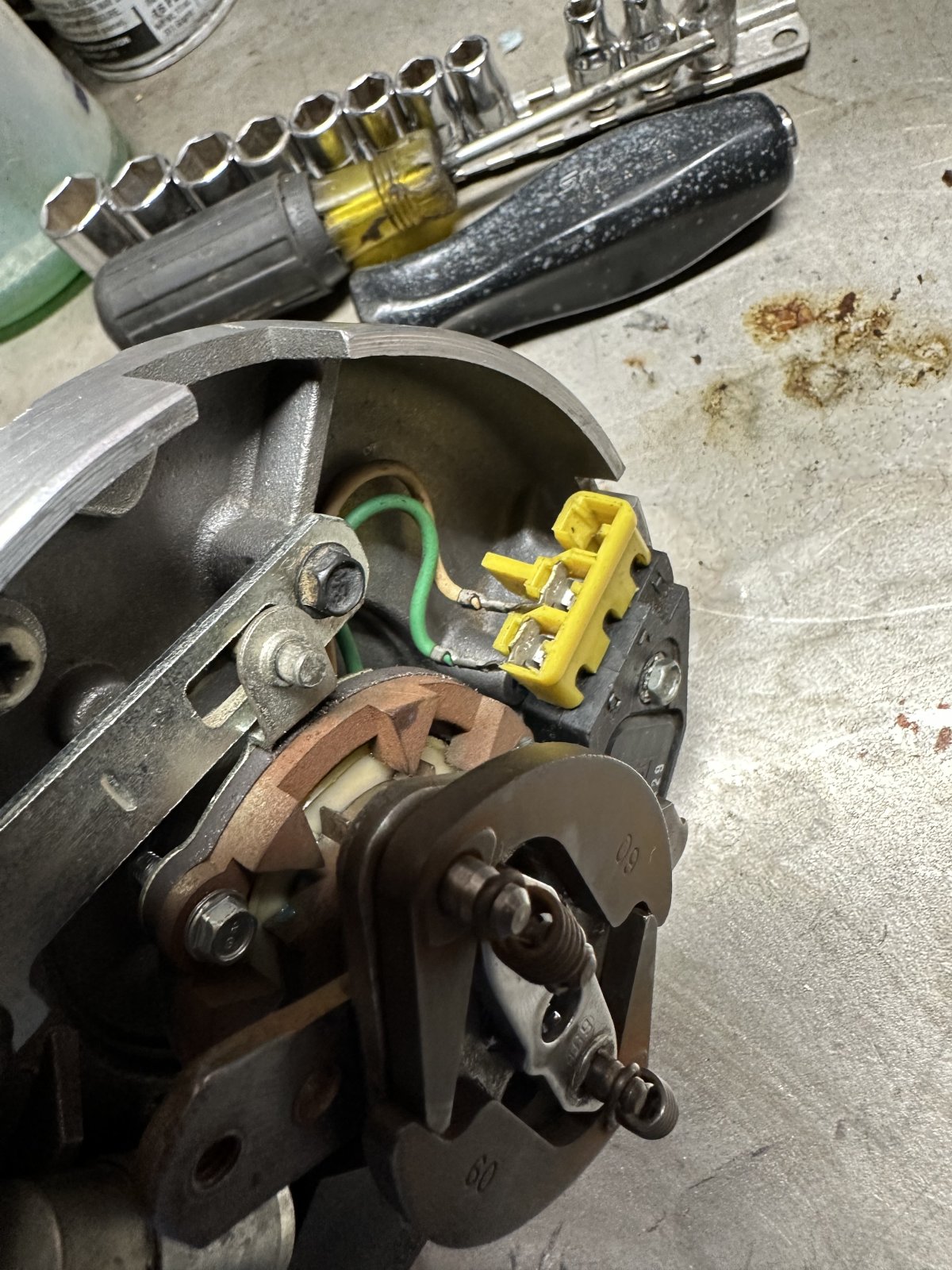

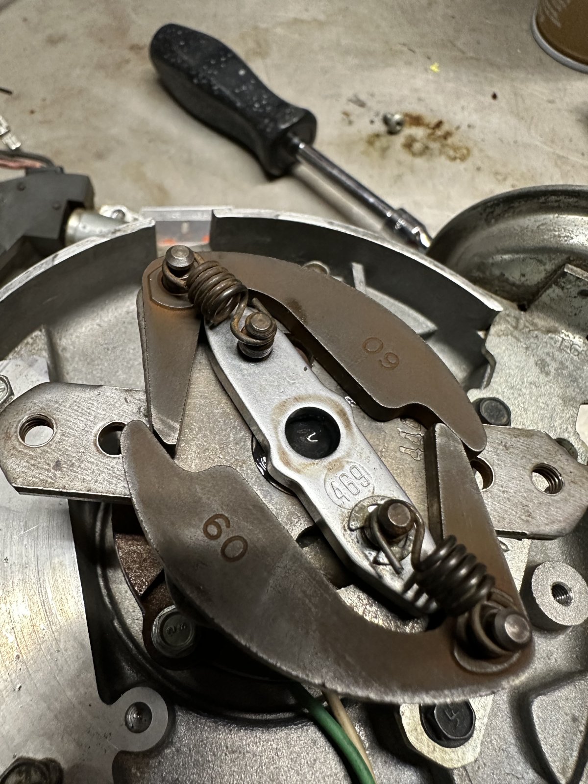

    My distributor has an extra harness coming out for some 305 80s truck external timing module. The last guy had already jumpered it but all that extra **** is ugly, and I’m already not smitten with that big HEI.

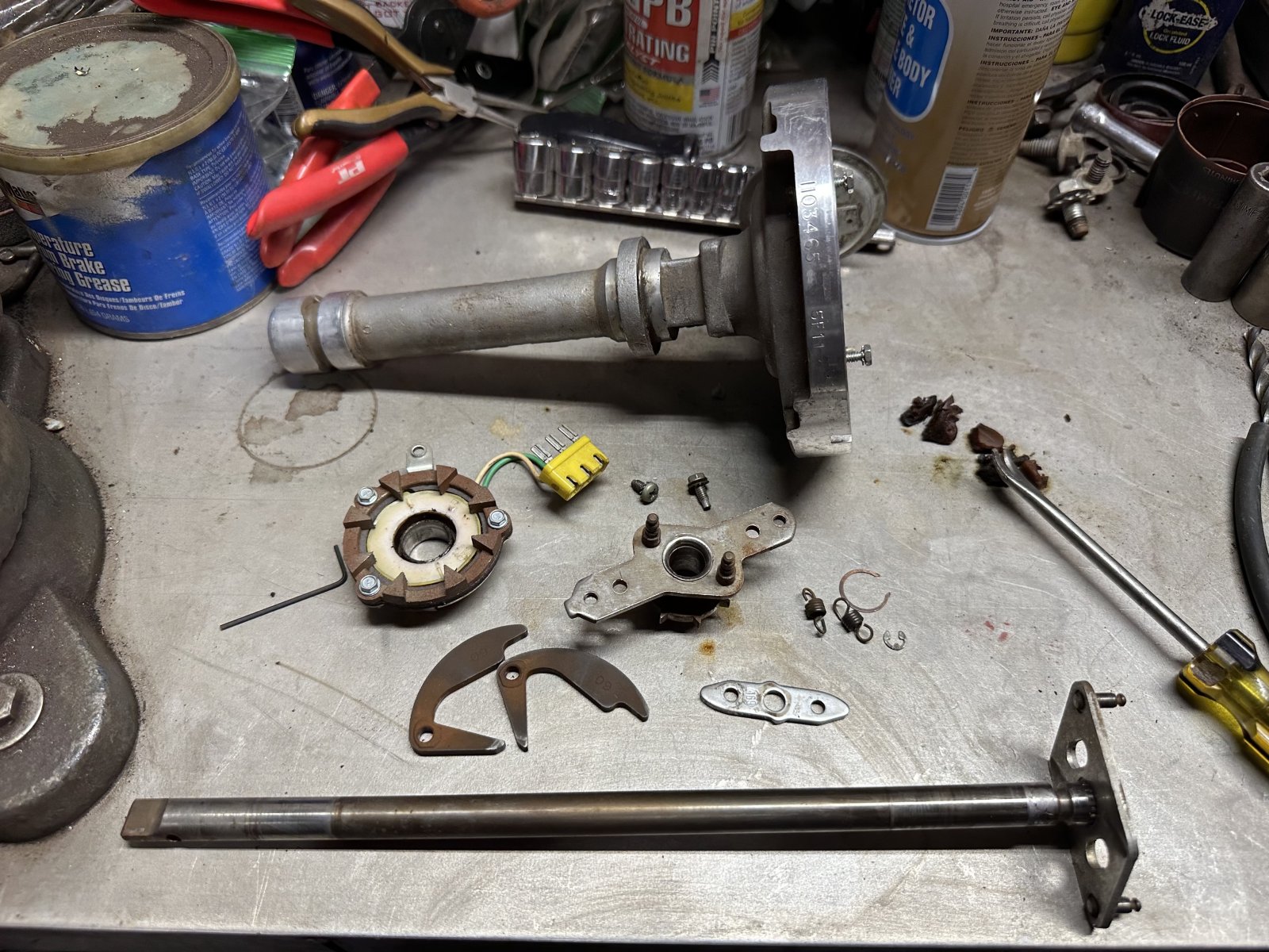

    I tore it down and cleaned and lubed everything. The mechanical advance was very sticky but it improved.
    The pick up connector has an extra pin compared to a 4 pin model. YouTube came through and I swapped the position of the green and basically byp***ed all the extra external stuff. I broke off the extra males and plugged it in.
    I know tuning mechanical advance is a whole science. I don’t have access to a distributor machine. Here’s my existing weight and spring combo. Should I fool with it at this point, or get it up and running and then tune? I guess I’m asking if there’s a baseline setup I should consider now?
    I hooked a battery and a janky little test light to it and got a blinky light, so it works.
