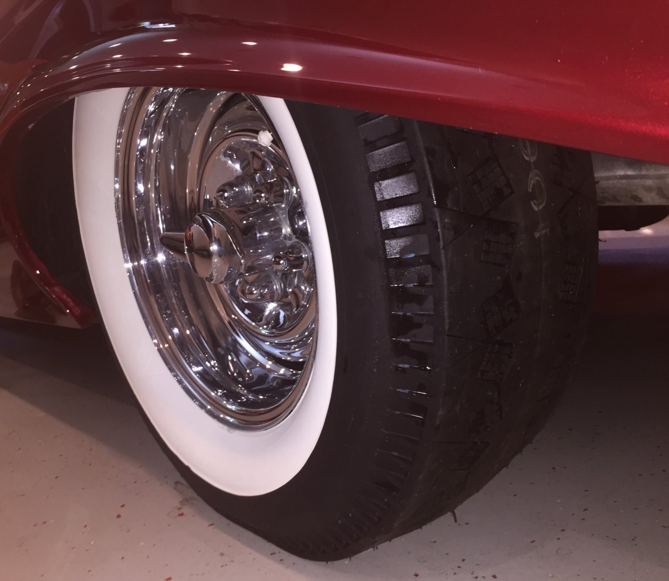

    I take back what I said earlier about wide whites, your Camino would look so *****in done this way. Every now and then you see a car where everything, and I mean everything is right. This car is one of em. Coolest 61 bubbletop ever.
    *side note, I think he has PA6 factory chromes on the front. 14x5 I think, can't remember what the RPO code is for the 14x6's. Anyway, very very hard to find now.

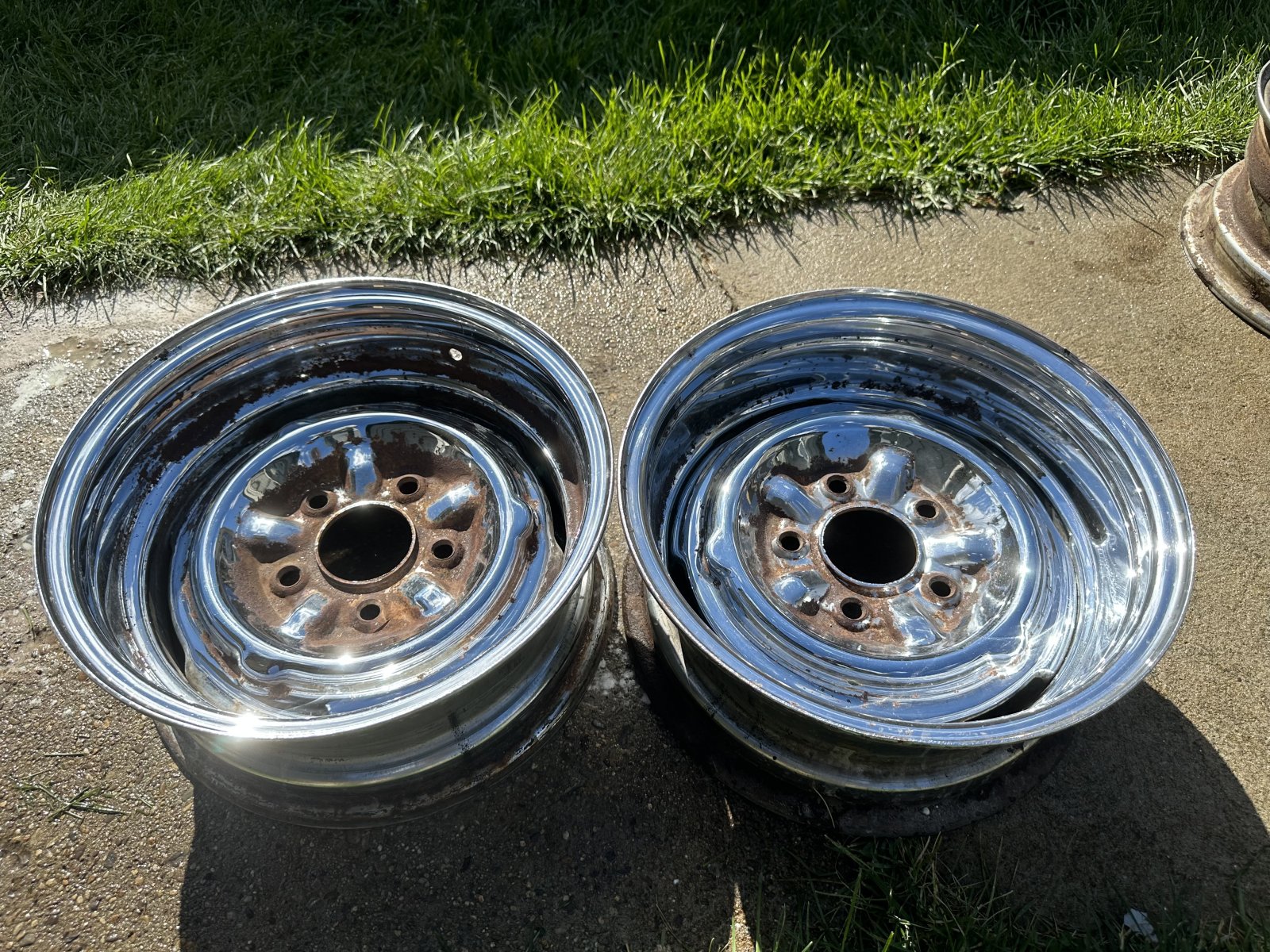

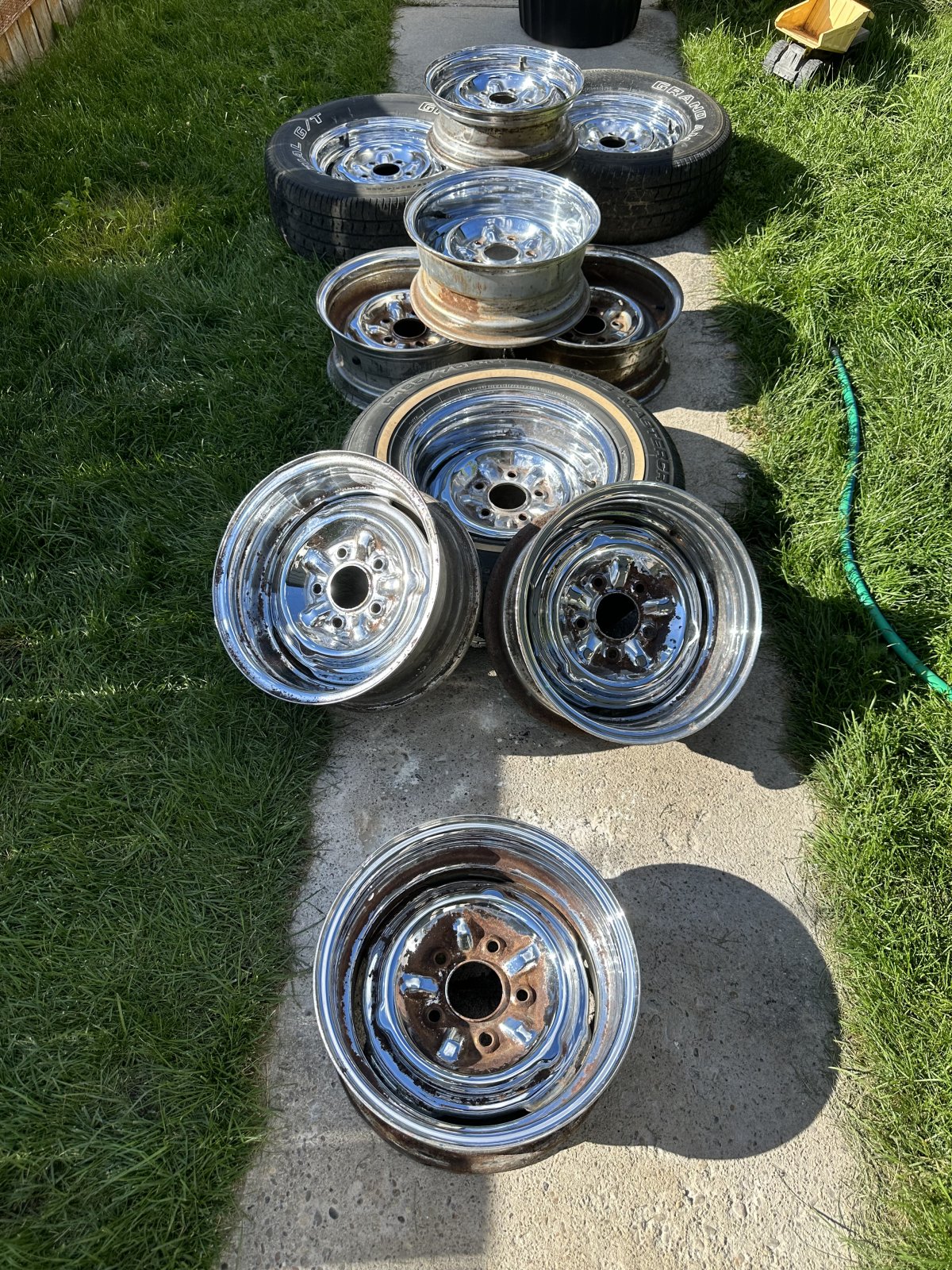

  9. lewk
    Joined: Apr 8, 2011
    Posts: 1,080
    lewk
    from Mt

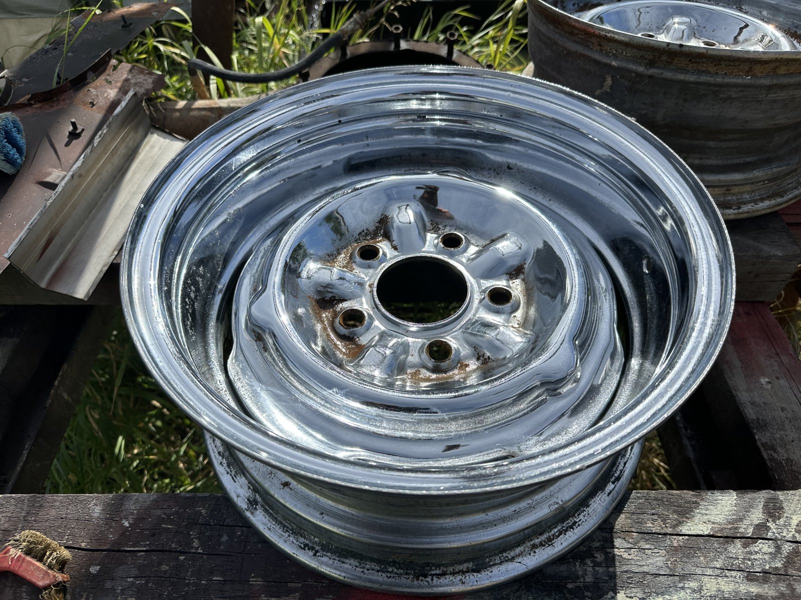

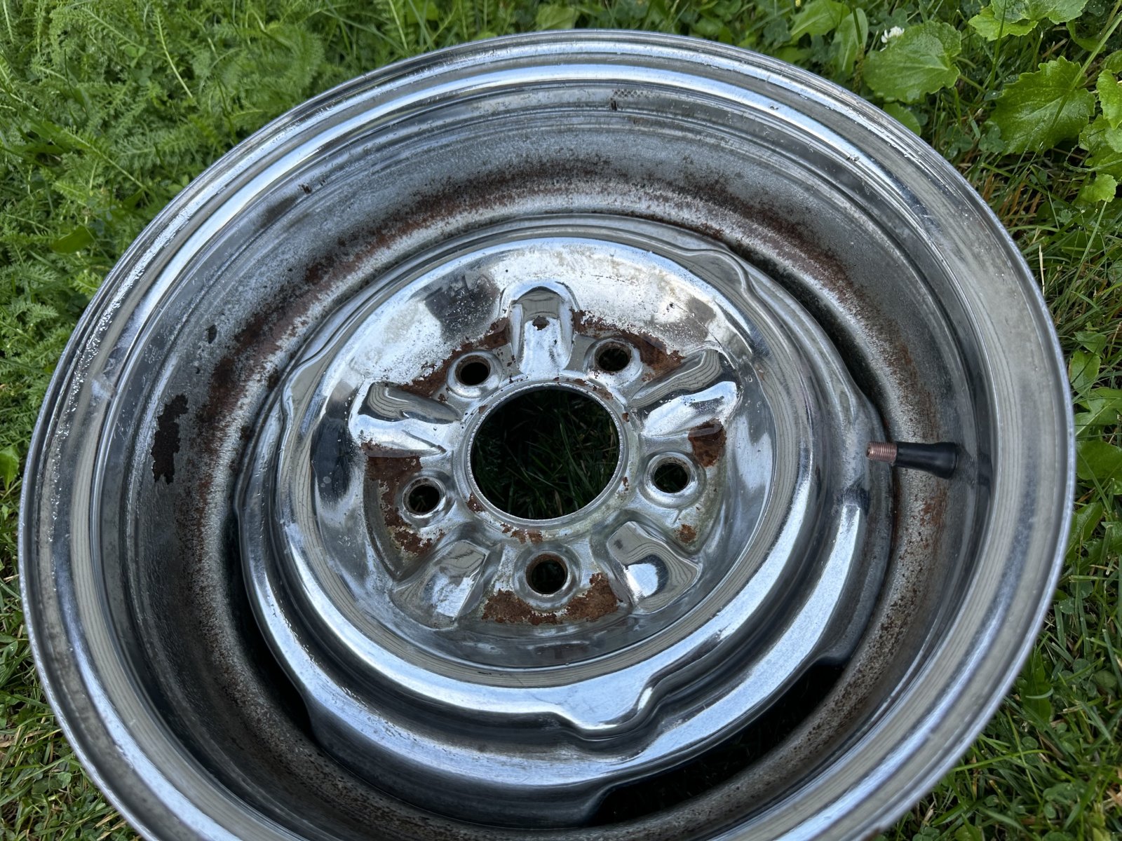

    My daily was in a mood, so that took most of my weekend car time. I did run up north Friday evening and picked up two wheels from RMR&C. Thanks Scott! After a little cleanup:
    I’m becoming the rusty chromie king of at least my street. Maybe even this half of the state.
    I’ve now got 3 sets of three and a random deep reverse single. Of course the 5” ones are in the best shape.
    Current plan is to order some wood bleach and do a soak tank. If I can get the rust build up out of the pits, I’ll wipe silver paint into them and then polish it off the main surface. I could run spiders and cover up more of it. That might make them p***able. I’ve got one extra bad wheel to use as a guinea pig. Hopefully it doesn’t make the chrome peel.

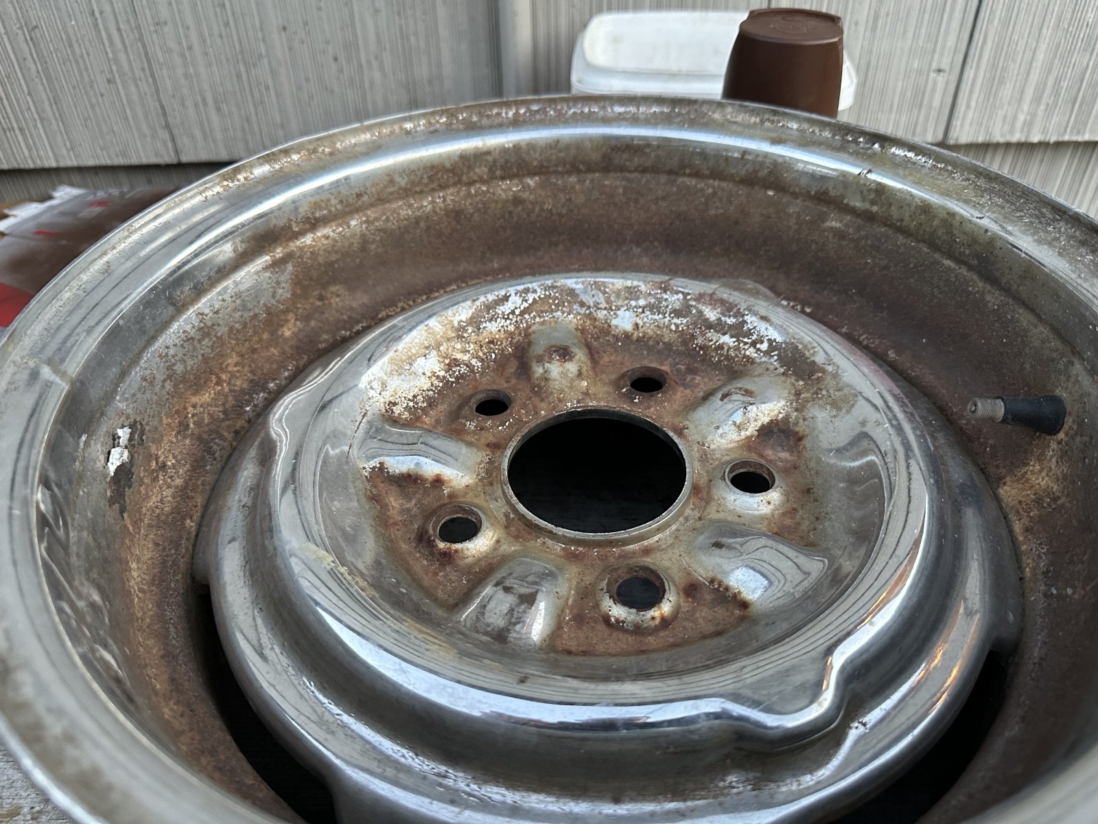

  19. lewk
    Joined: Apr 8, 2011
    Posts: 1,080
    lewk
    from Mt

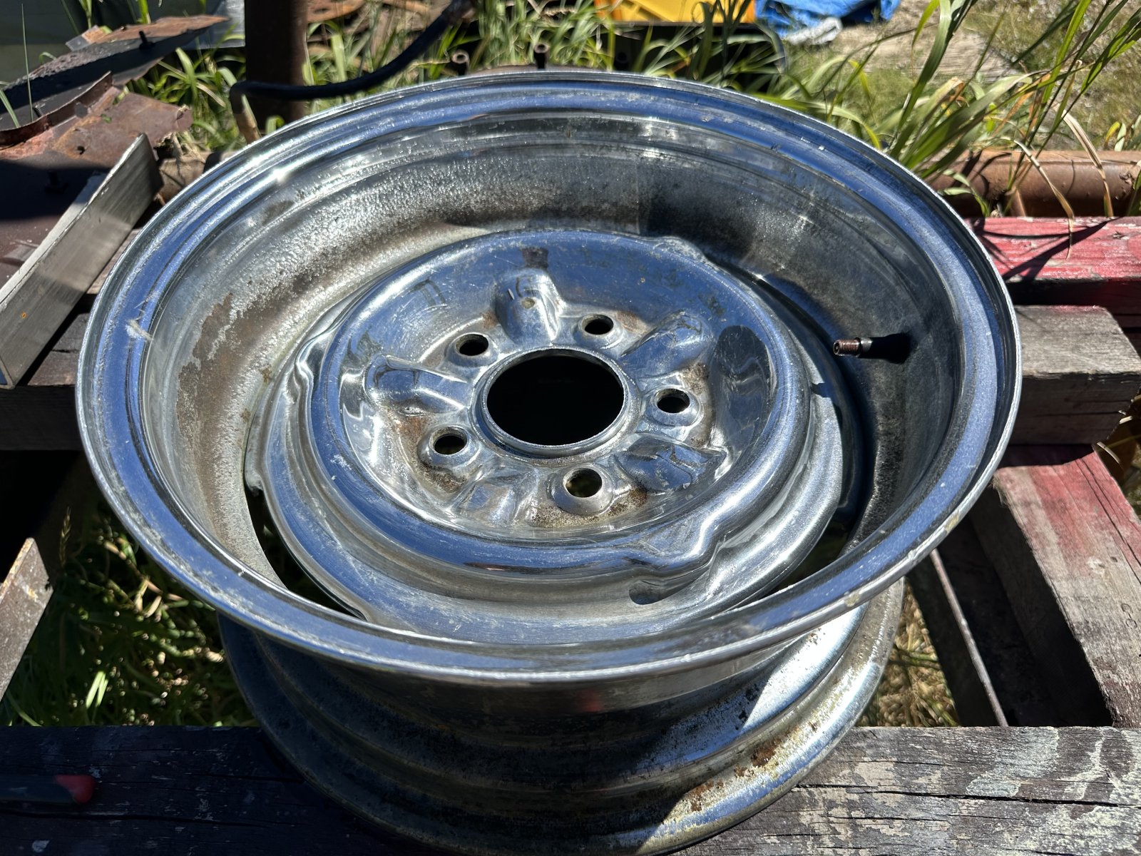

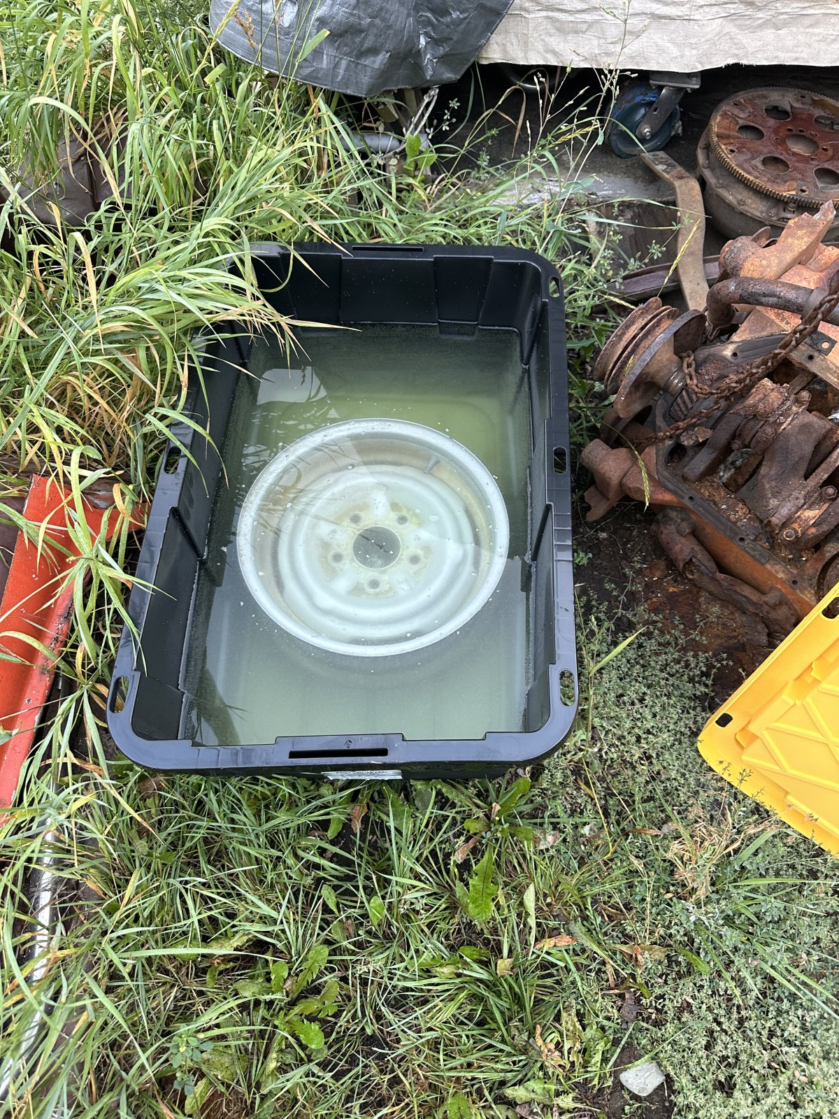

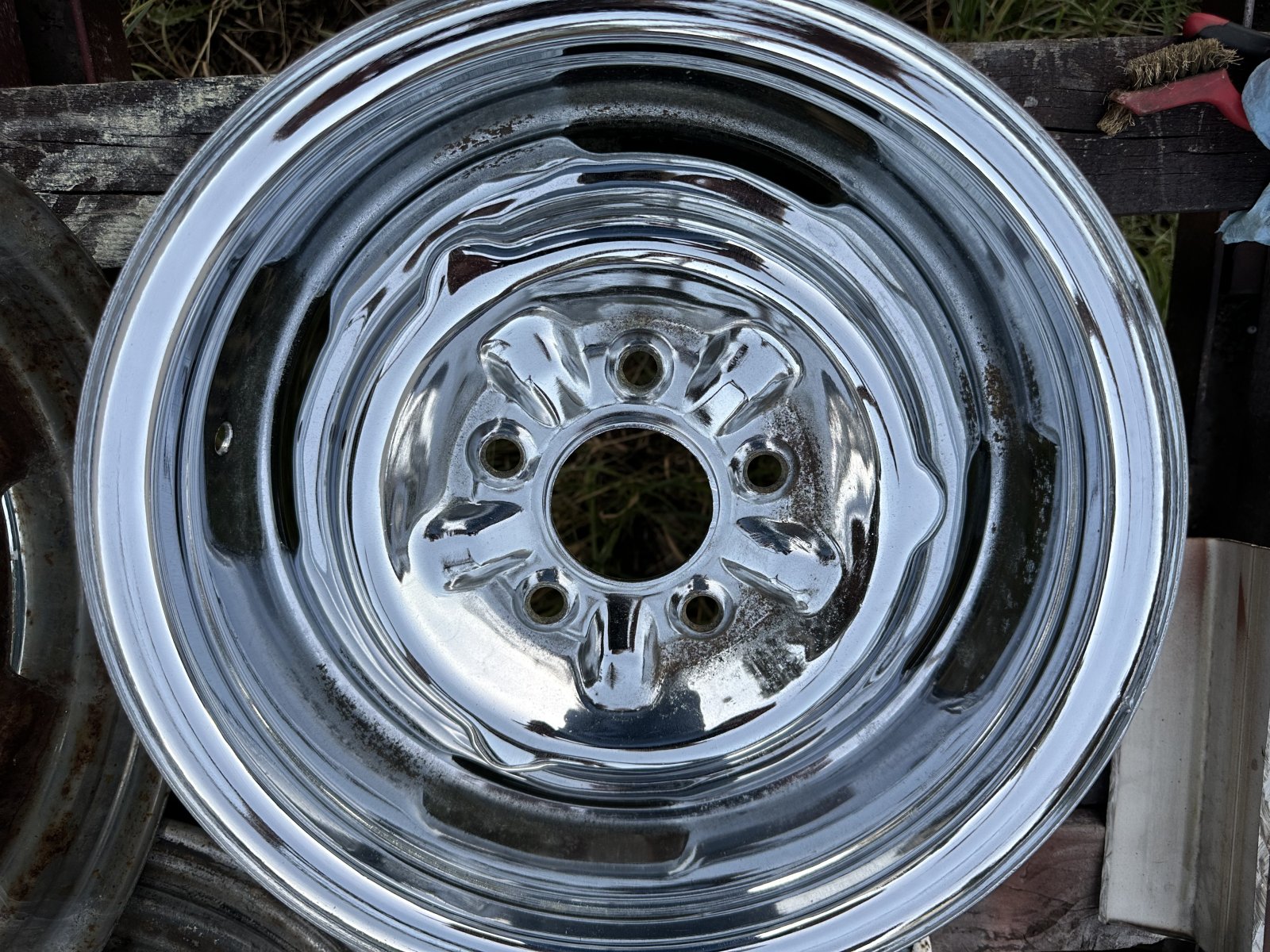

    I got my oxalic acid.
    Chose my worst wheel.
    Soaked it overnight. My mix is 3 hefty tables****s per about 4 gallons of water.
    This is after a quick scrub and rinse.
    I’ve got to come home at lunch so I’ll check it again then.
  20. Squablow
    Joined: Apr 26, 2005
    Posts: 18,498
    Squablow
    Already better, certainly isn't hurting it any.
    bchctybob and lewk like this.
  21. SS327
    Joined: Sep 11, 2017
    Posts: 3,881
    SS327
    Might want to add a little more to the mix?

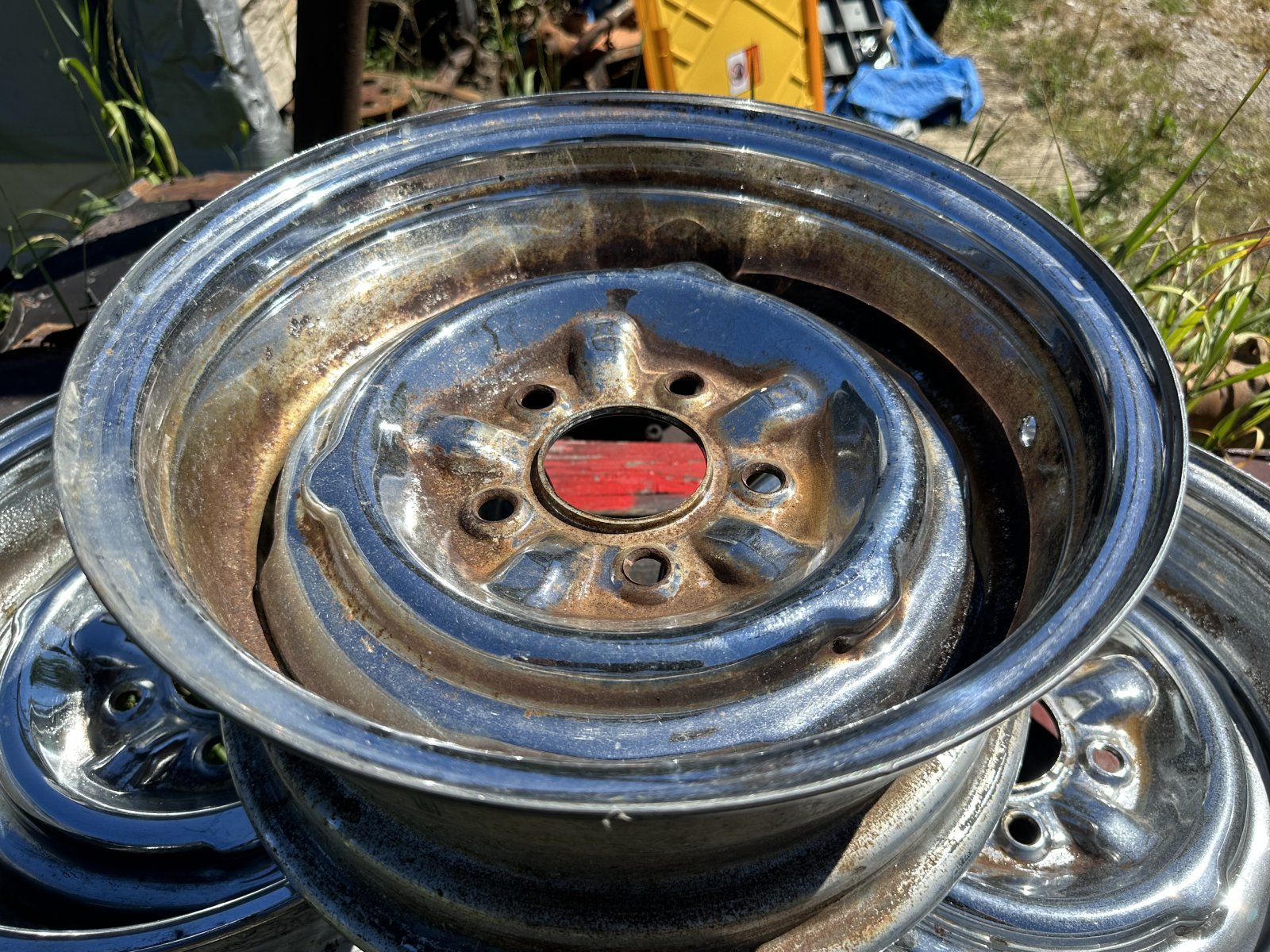

  22. lewk
    Joined: Apr 8, 2011
    Posts: 1,080
    lewk
    from Mt

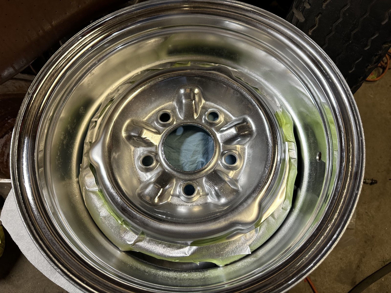

    I left it in a day and a half and here are the results.
    That’s long enough for a wheel I’m not going to use. I mainly wanted to watch what it did to the chrome. Nothing peeled that wasn’t already peeling.
    Next wheel:
    I souped up the soup a little. After 20 hours:
    I’ll soak it a little more and then try the silver paint thing. I want the pits cleaner.

    Posts: 5,987
    bchctybob
    That worked well.... Great, now I'm going to have to do the old rusty chrome wheels that were on my Stude pickup when I got it. LOL. Gotta save old parts if you can.
    I bought some citric acid powder a while back, is Oxalic better?
    benchseat4speed and lewk like this.
  24. lewk
    Joined: Apr 8, 2011
    Posts: 1,080
    lewk
    from Mt
    I’ve never tried citric acid. I had some green stuff I thought was citric but it turned out to be a sulfuric/phosphoric mix. That stuff will eat metal. I’ve also had some good luck with vinegar, but did pinhole some stuff too. People on various forums use oxalic on chrome, so I thought I’d try it. I’m. $30 in with the tub and the powder.
    bchctybob and benchseat4speed like this.

    Best results I've had using paint in the pit areas was with a metallic silver paint pen. It's not a perfect match but it's much easier to hit a tiny spot and fill it in with that rather than trying to use a brush or a spray can and having to clean the excess off. Although if there's a better way, I'd be very interested to hear about it.
  27. lewk
    Joined: Apr 8, 2011
    Posts: 1,080
    lewk
    from Mt
    A paint pen is a good idea. I already hit some spots with a spray can. I’m waiting a day and I was going to hit it with some polishing compound and see how it goes.
    Done with oxalic:
    A little Rustoleum bright metallic aluminum:
    The lighting is different between the pics.
    I’m really eager to polish and see how this works out.

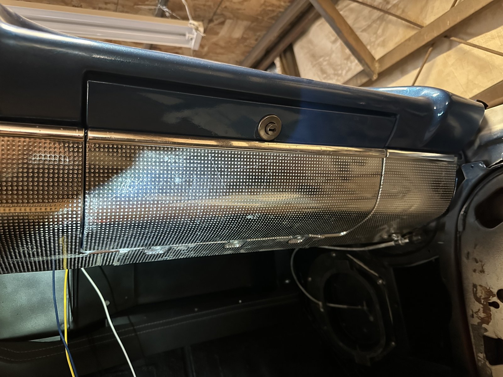

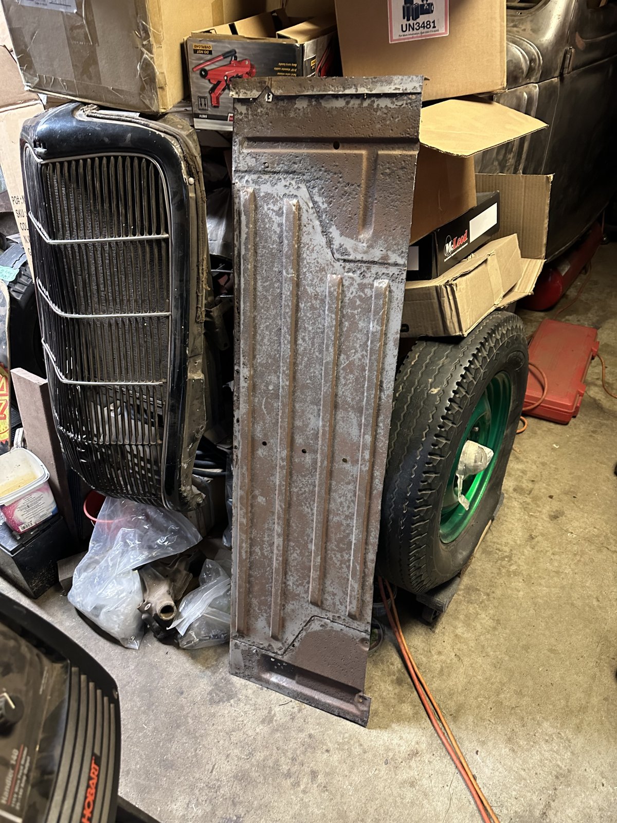

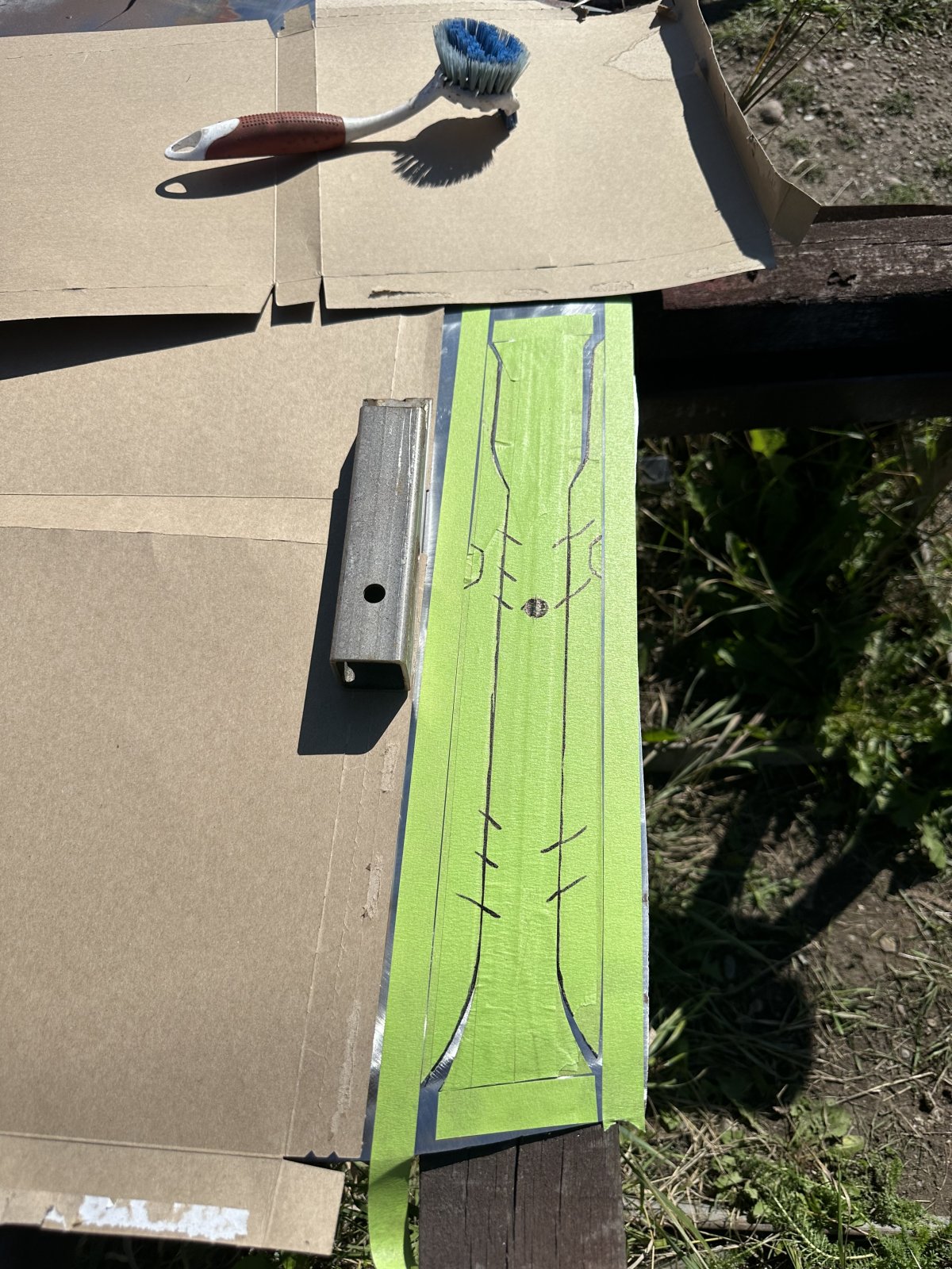

    I’ve been pecking away at a lot of little stuff. I got my poly locks for the rockers. I got some Chinese bling.
    I’ve dipped a million chrome wheels in oxalic acid. I finally installed the p***enger side front shock relocation mount. I rebuilt and installed the ebrake and glove box light switches. The reproduction glove box had the light pocket stapled on wrong.
    So I fixed it.

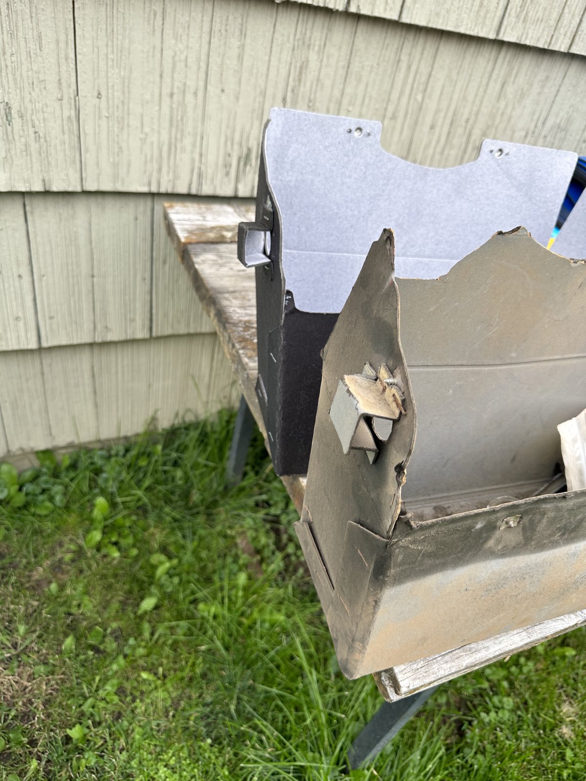

    I put the glove box door in.

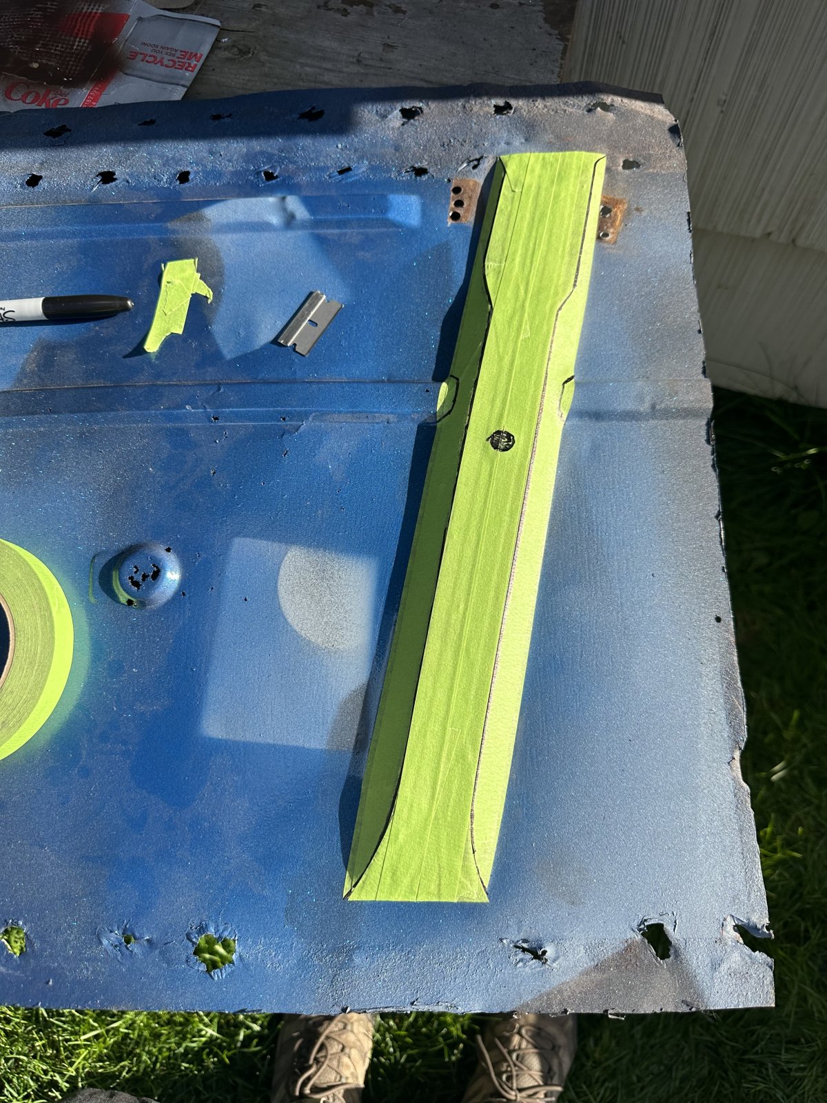

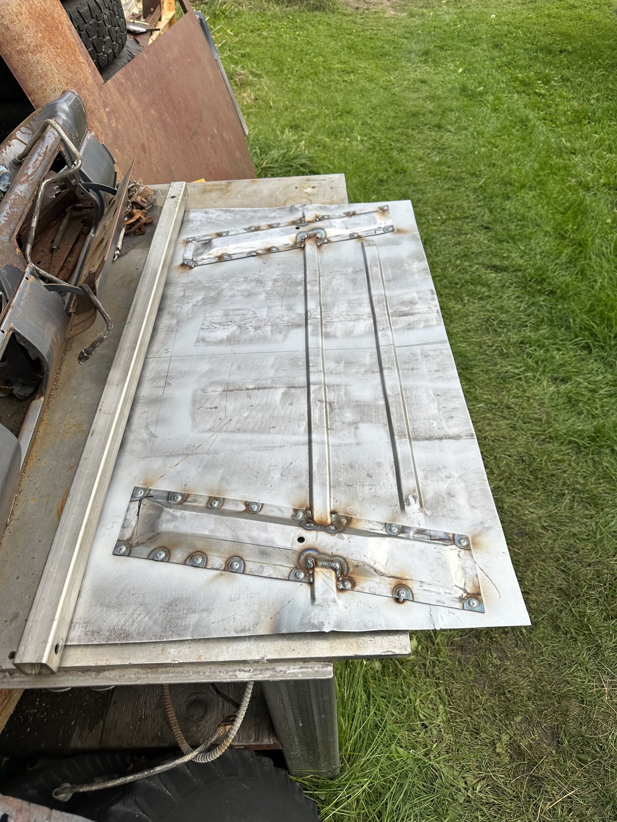

    The bed subfloor has stampings that locate the gas tank. It isn’t reproduced and I need it. Pattern:
    And I made some stuff.
    I harvested some metal from the BeAir roof
    And cobbled this together
    First try bead rolling. If this was visible, I’d try for straighter lines. This goes under the car above the gas tank.
    And ***embled:
    There are a couple little brackets that still need to go on in this pic. I forgot to take a pic after they were done. Here are panels stuck in place but not trimmed. The front panel is sedan from the Bel Air. The ribs are different, but it’ll be just fine.
    I still need to make this one. I have a plan…

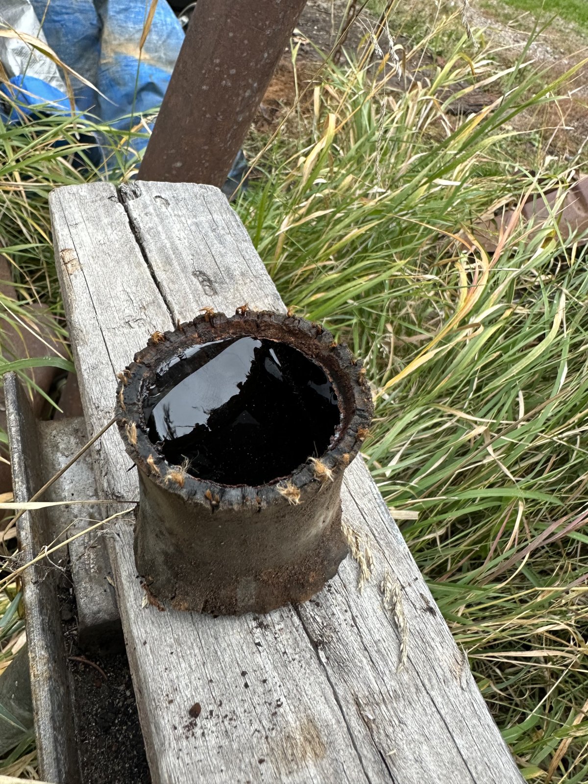

    I’ve had the gas tank tipped up with the filler neck pointing down. Terrible sludge ac***ulated in the rubber filler neck hose.
    Next up, I’m going to trim those panes, fix a cowl gusset, set the valves, and fool with the PS pump. I might put oil and a distributor in it too. I’ve got a radiator from the 59. I might mess with it before I have to turn off the garden hoses for the winter. I need to do some stuff to my daily before winter too.

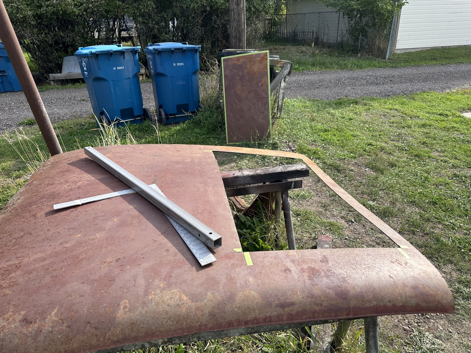

    I’m finally back on the El Stinko. My wife’s Toyota’s rear hatch devoured its spoiler. That cost me some car time and money with backordered parts and cleaning my mess up enough to do paint. Then I decided to do a little deferred maintenance on my daily Jeep before winter. That spiraled into a header and full exhaust, slip yoke eliminator and new driveshaft plus lots of little stuff. I stopped myself before I re-geared and put lockers in it…

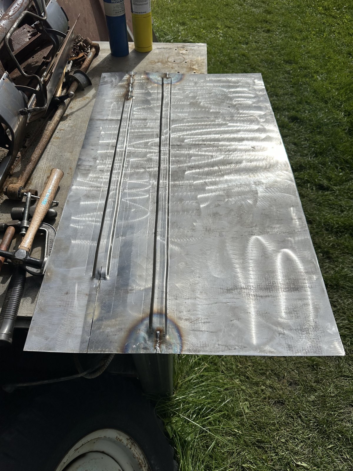

    I trimmed that sedan floor it fit. The radius on the turn down is different, but I’ll make it work. It’s all hidden anyway.
    I started making my rearmost section. It’ll take a few sections to get what I have in mind made. My beads are getting straighter, but still need improvement.

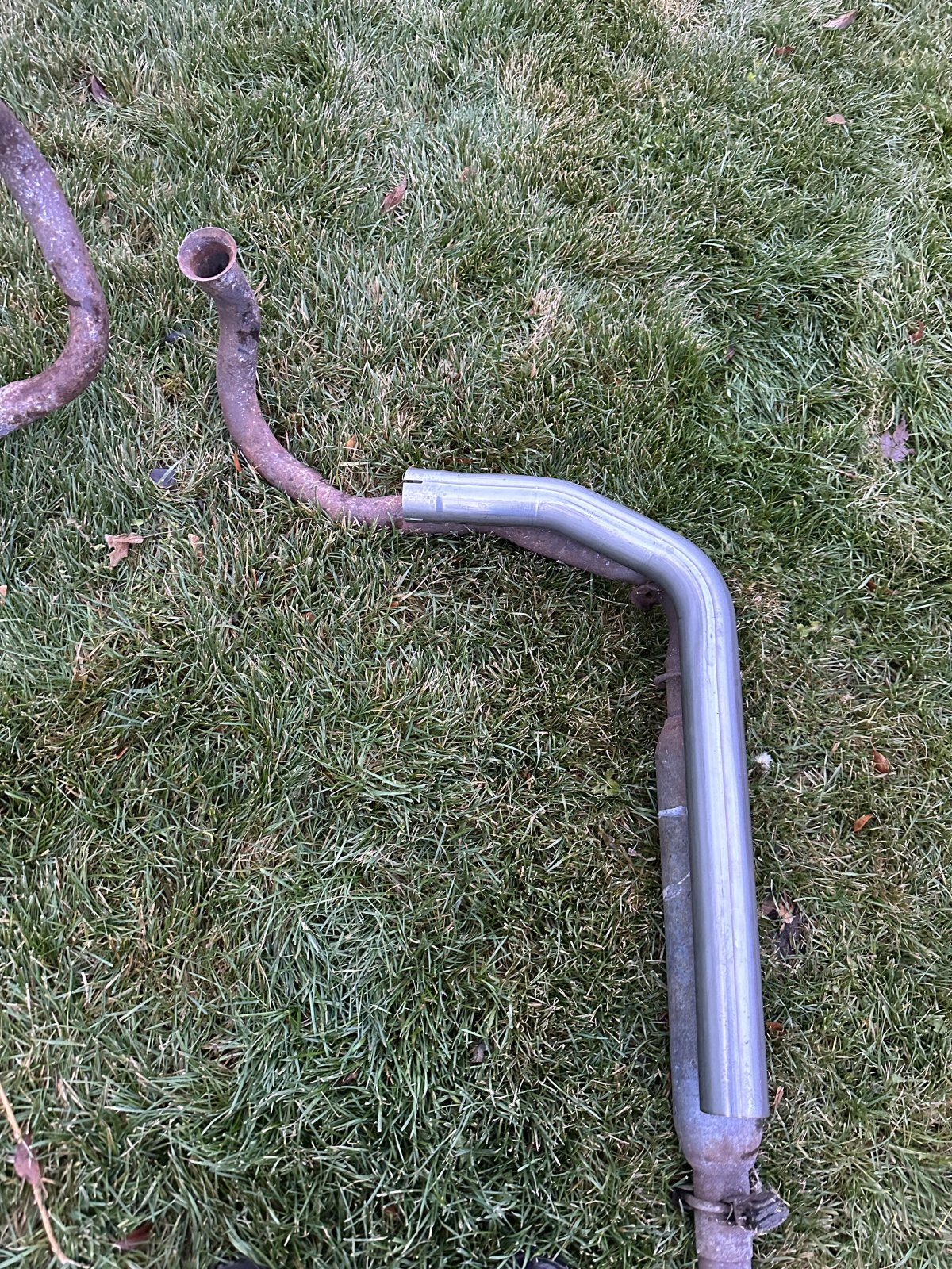

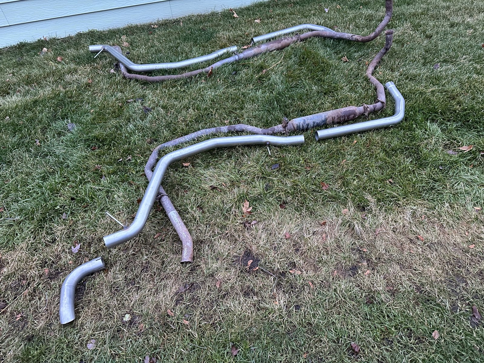

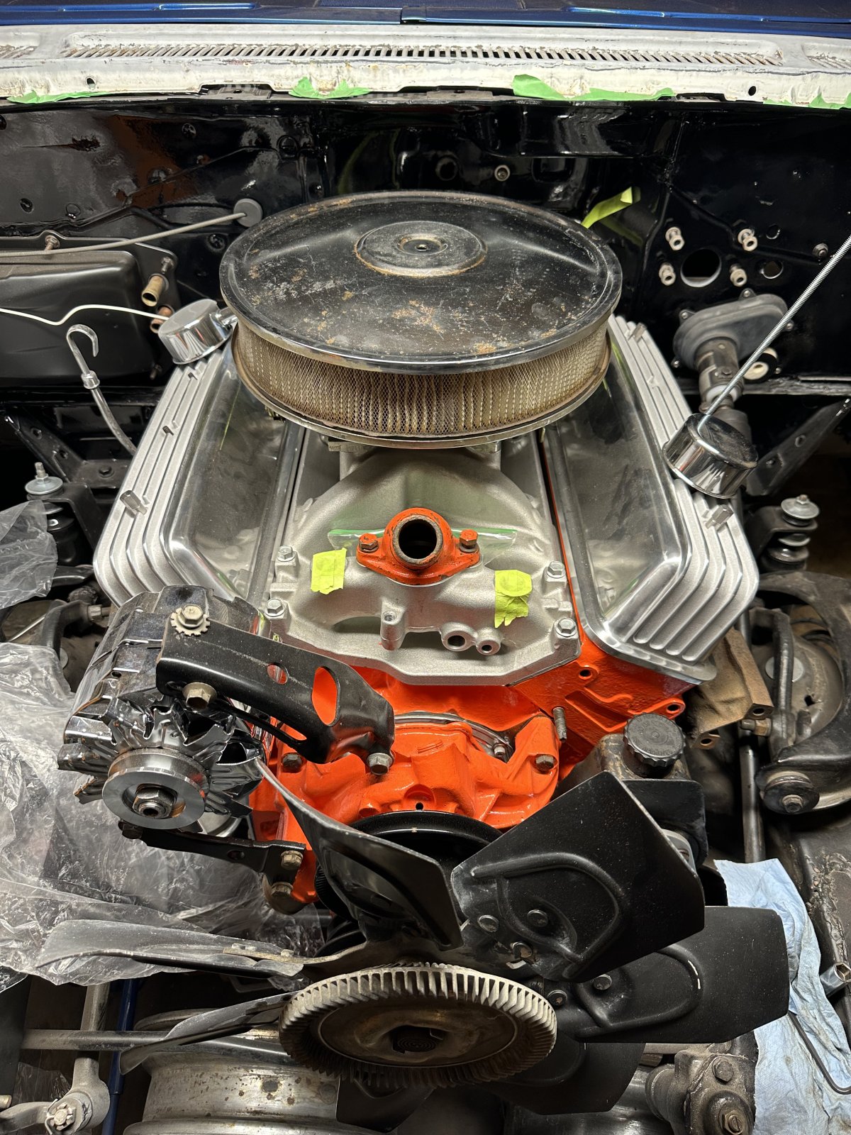

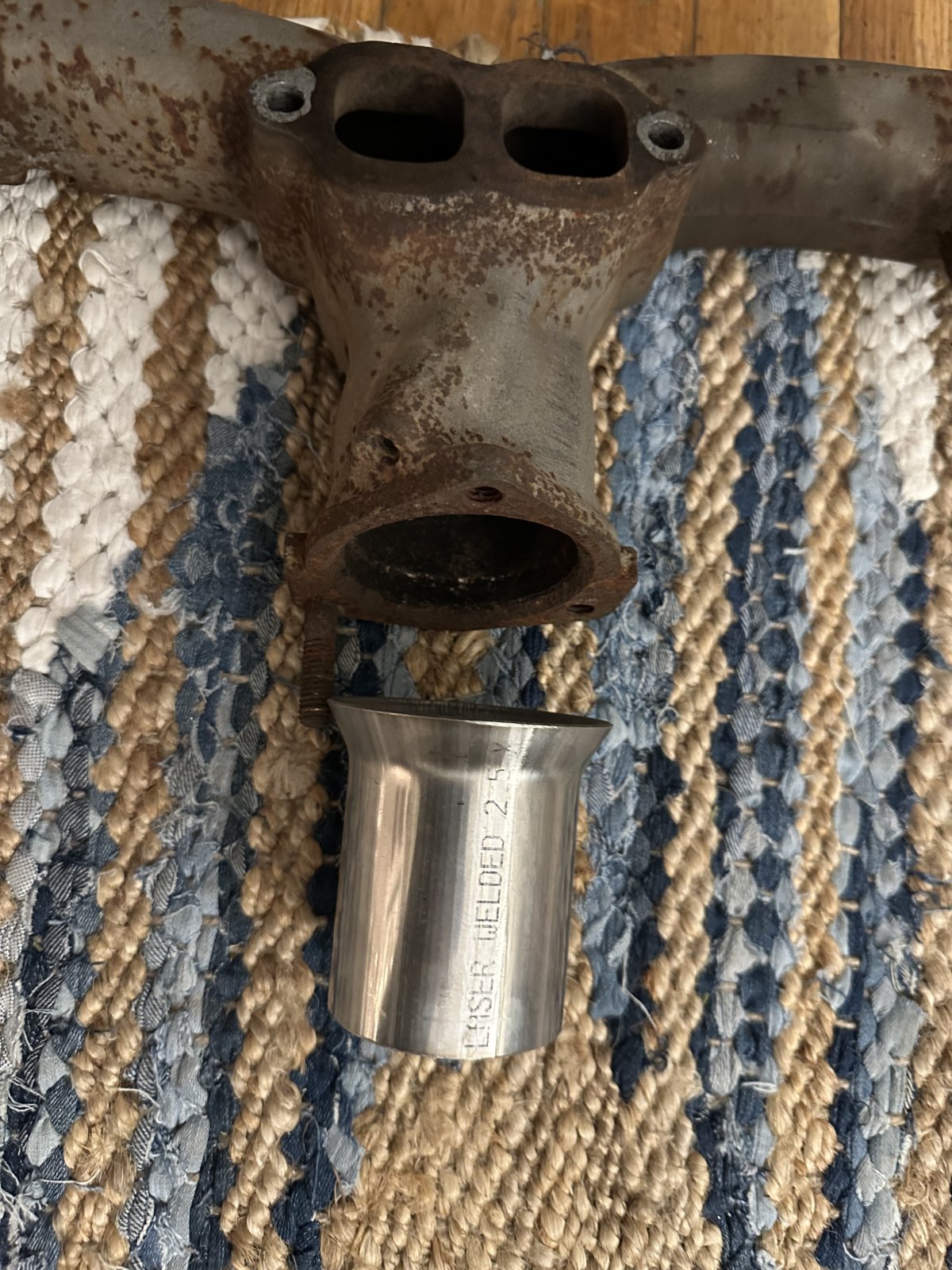

    After the Jeep, I had exhaust on the brain. I’ve never fabricated an exhaust before. I was going to buy a bunch of 2.5” 304 bends and do it the hard way, but a discounted open box kit turned up on the auction site. It was missing the clamps and one turn down. This ends before the rear tires, but there’s a rear kit available. This will save a ton of mess around. Unfortunately it’s 409 instead of 304, but it’ll still be great.
    This exhaust is set up for headers. I need to work out the missing section. I’ve got some bends in the mail that should have been here 5 days ago.
    I’m going to run gl***packs. I need to order em. Stainless ones are $$$. I’m not an exhaust guy and finding the right pieces to mate up to my 2.5” rams horn in stainless has been a pain. There are a few guys on the auction site selling aluminumized stubs, but not stainless. I’ve gotten this far.
    I still need a donut and a flange. I know I could try bugging the local exhaust shop, but my buddy’s buddy got in a fight with them over them using aluminumized connections on his high dollar stainless kit on a 56 210. I’m not interested in repeating his experience.
    I dug around and found an air cleaner. It’s ugly but it’ll do for now.
    I still need to go through the carb, PS pump, put the distributor in it, and more. Something has been dis***embling squirrels and birds under the car. I’m looking forward to laying in that mess as I do the exhaust.
