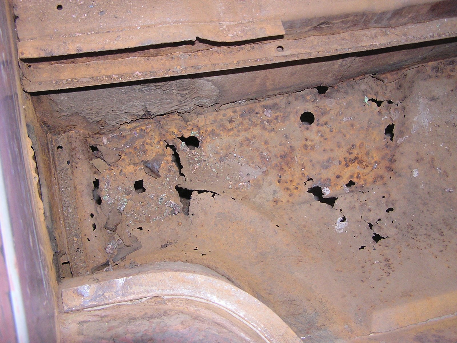

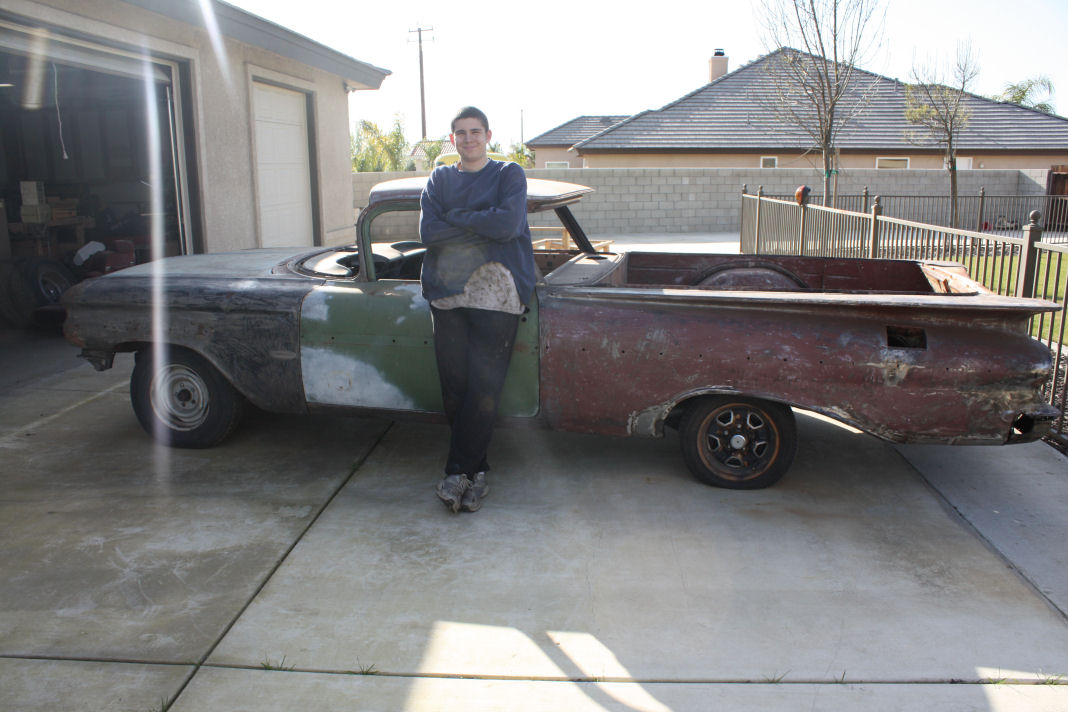

    Glad you found a 348, that’s just what it needed. Any idea how you are going to handle the pinholes in the floor? I’m enjoying the progress, keep up the good work.

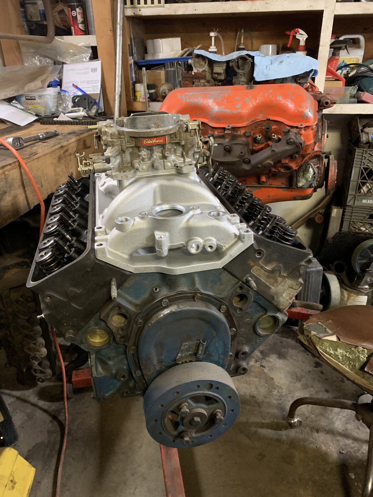

    Joined: Apr 8, 2011

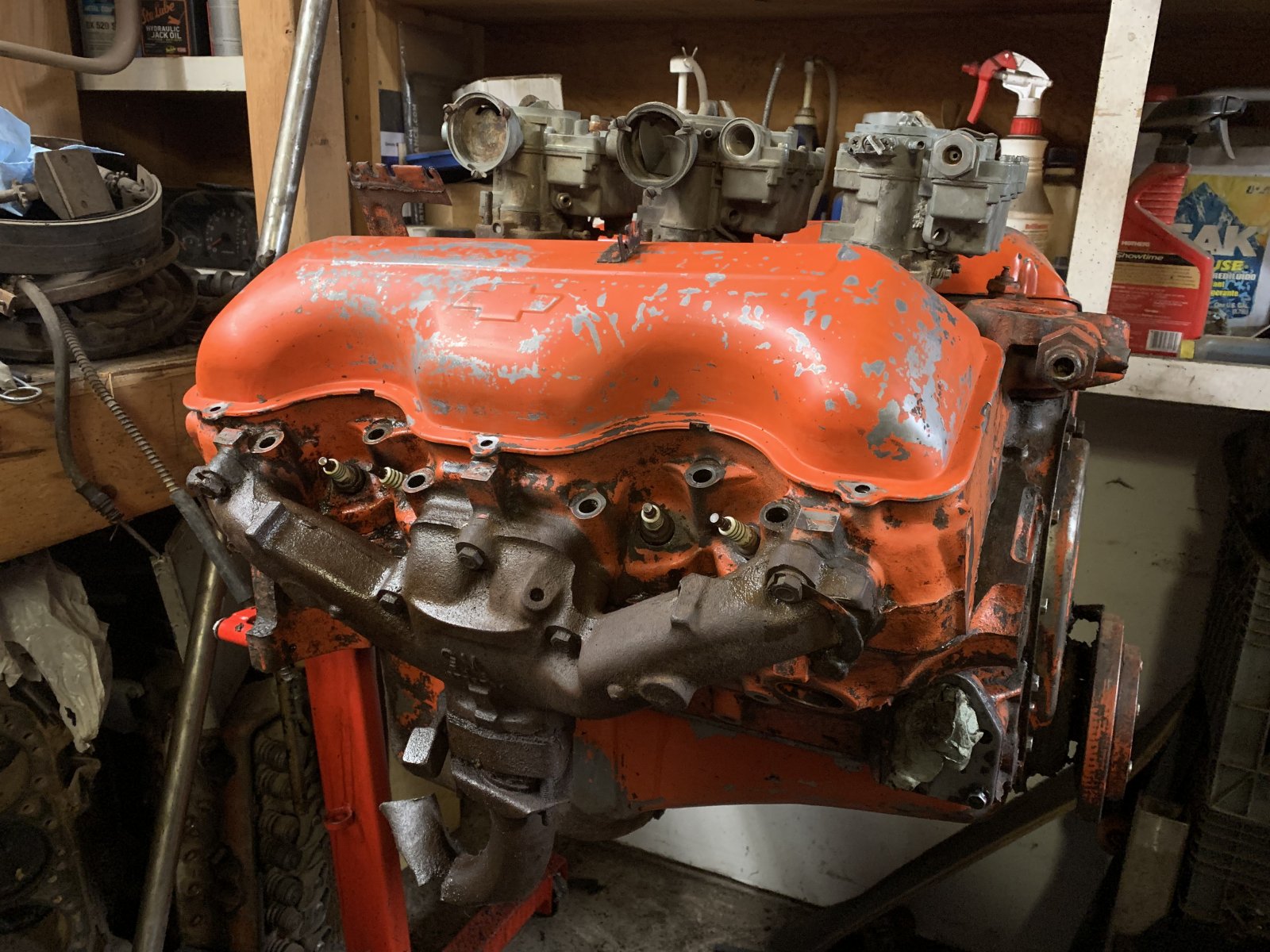

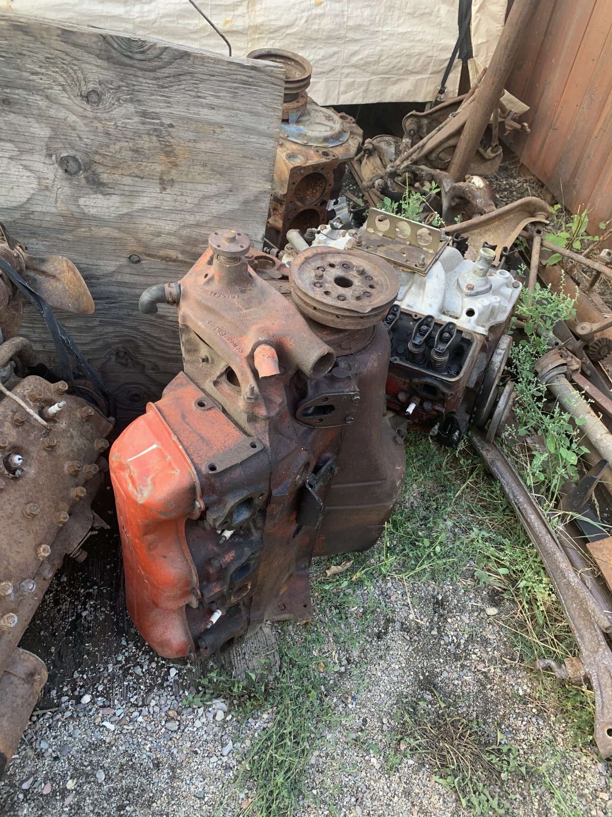

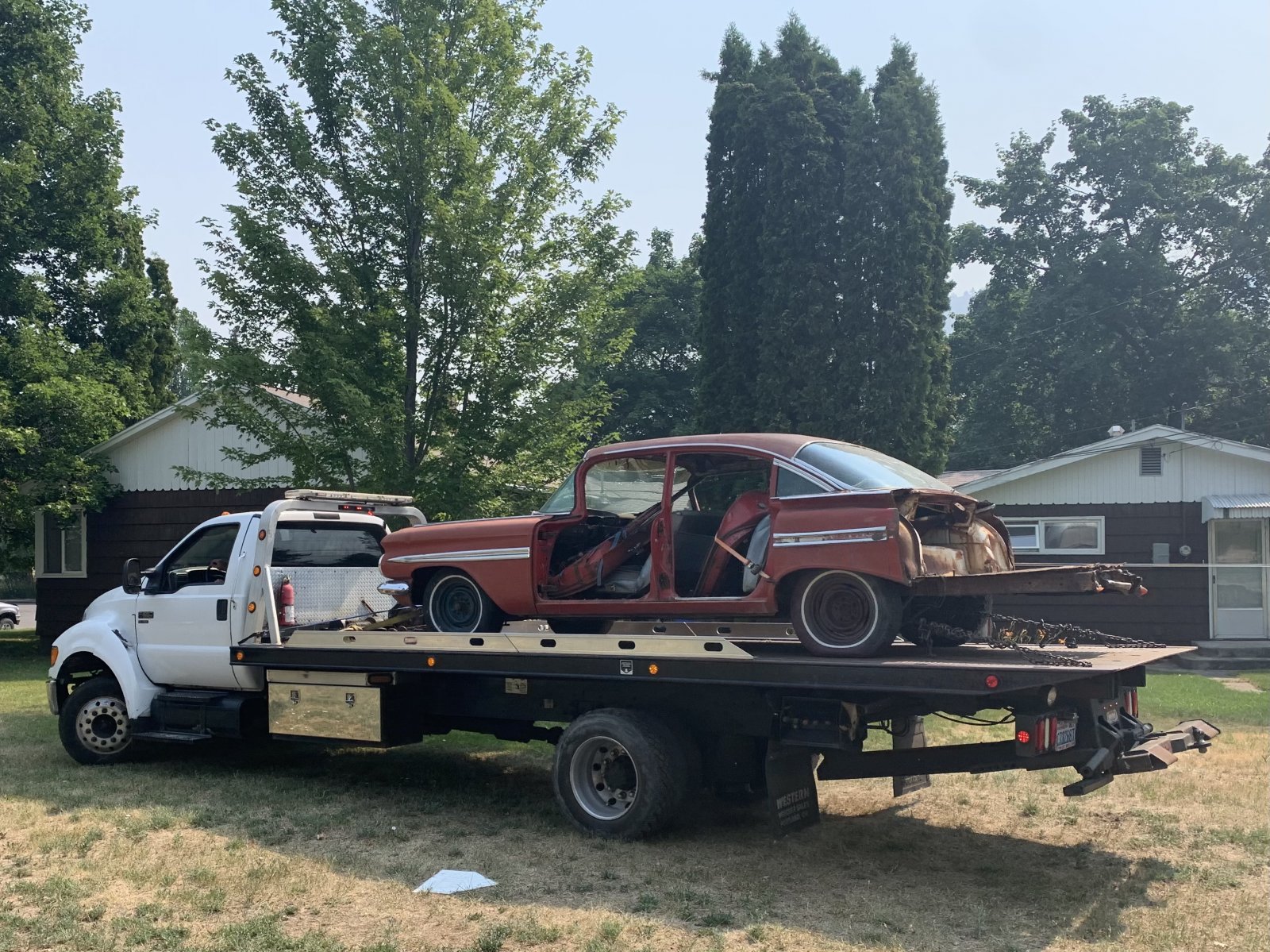

    I finished murdering the 59.
    Just kidding. It’s off to live on a farm in Idaho where it can run free with other 59s. I was going to part it out but a guy wanted the whole thing.
    Lucky guy had a roll back so no come alongs for him. I did some horse trading with the deal and got some nice goodies for the El Camino.
    The carbs are wrong but there are conversion kits for the outside carbs. I’ll probably run progressive linkage instead of trying to track down all the factory vacuum stuff.

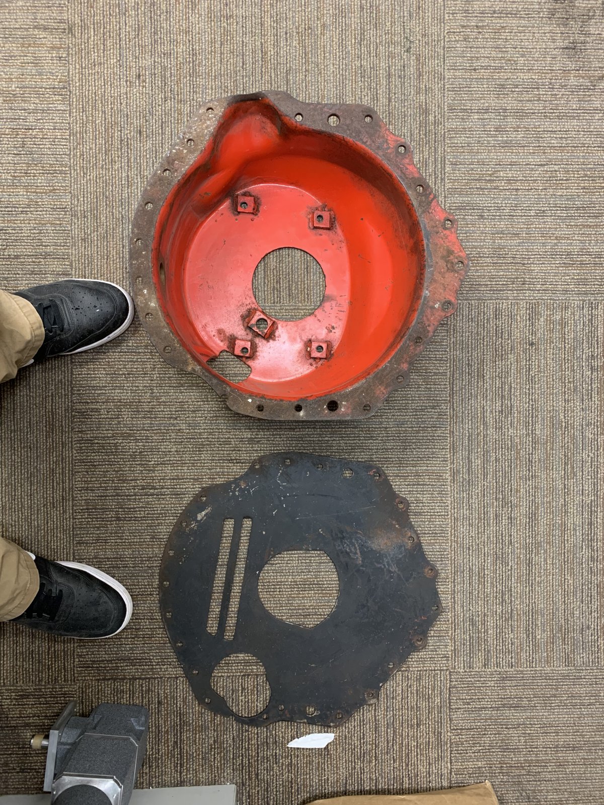

    I got a decent deal on a Lakewood ****ter shield but it’s for an early Nova. I need move the clutch window.

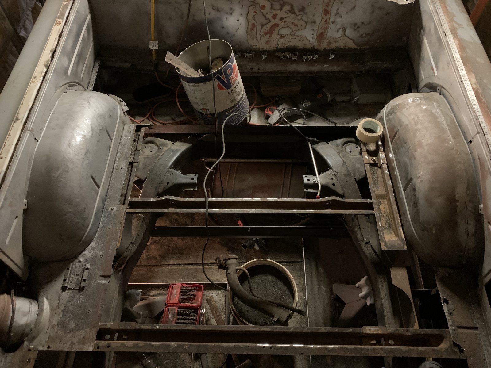

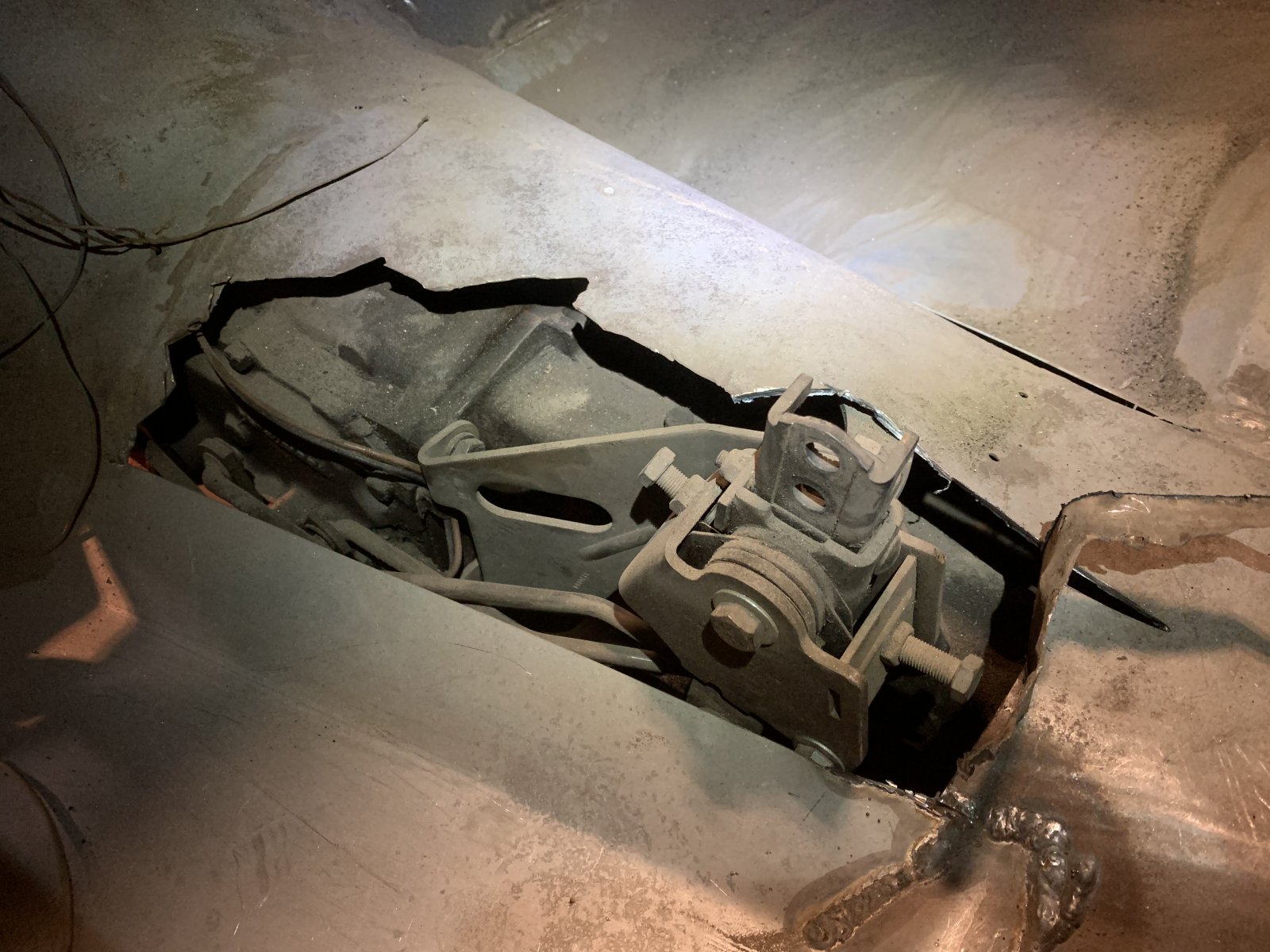

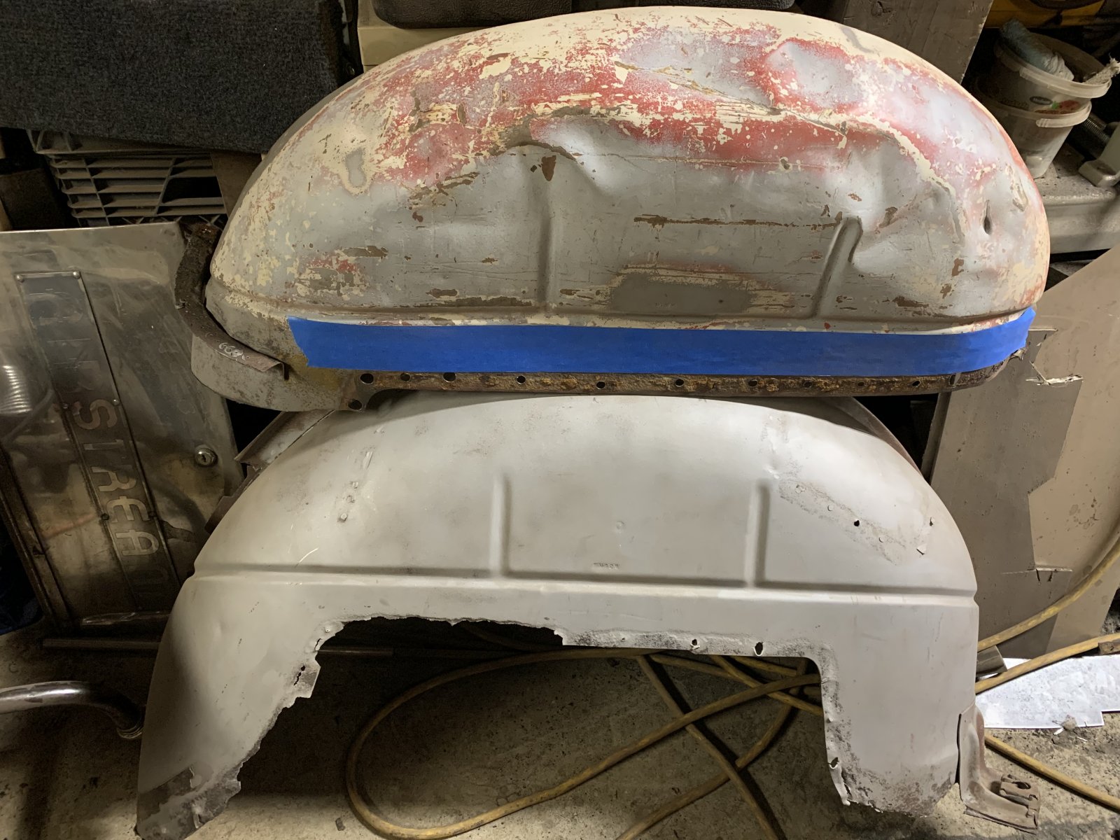

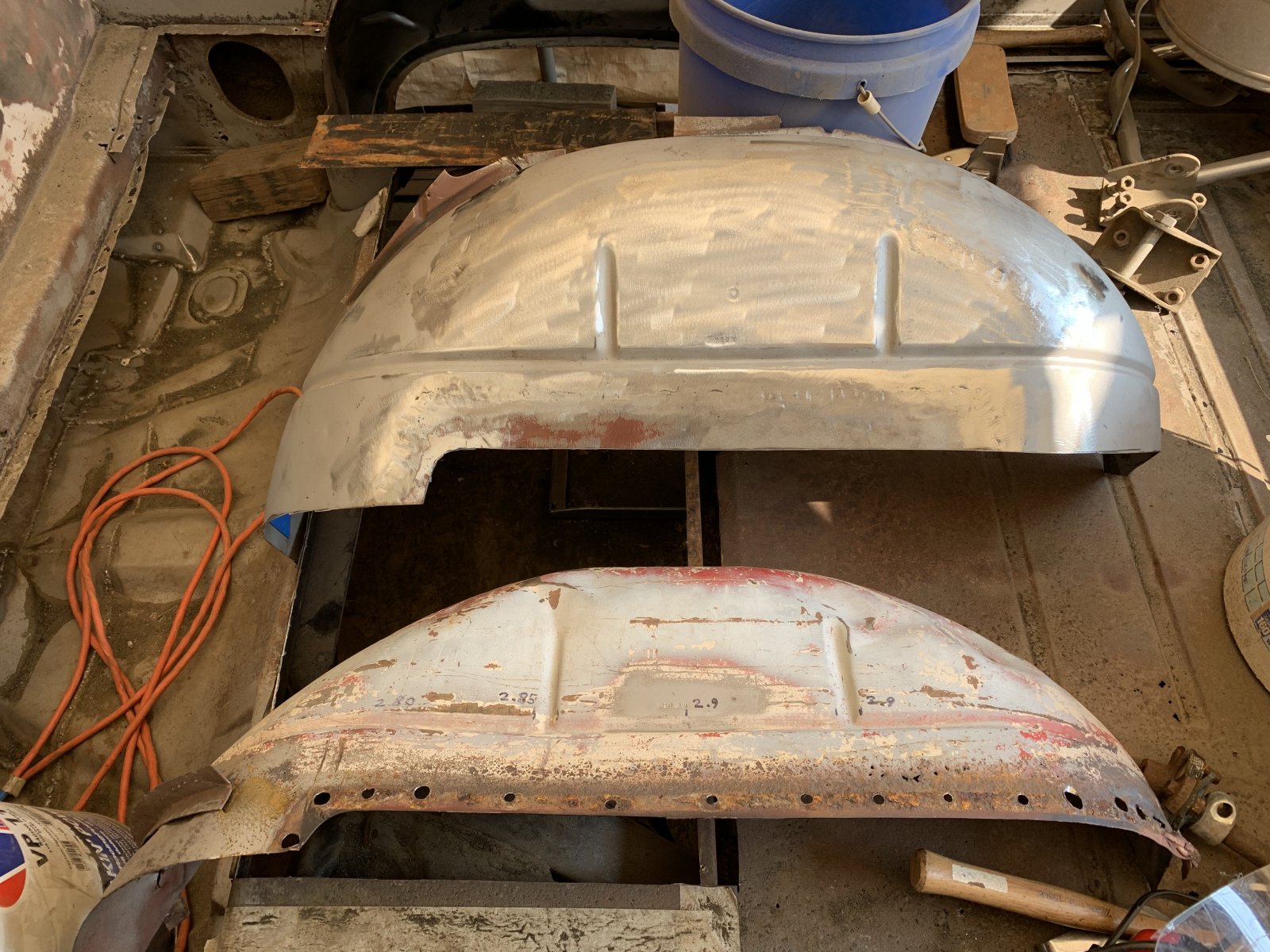

    I repaired and modified the p***enger wheel well from the Bel Air I parted last winter. I *think* sedans and El Caminos/wagons used the same stamping but it was trimmed differently.
    Then I cut the bed subfloor out.
    I’ve been beating on the driver’s wheel well and it’s starting to take shape.
    I want to get the subfloor back in and epoxy primer down before the weather turns. It’s getting cold at night.

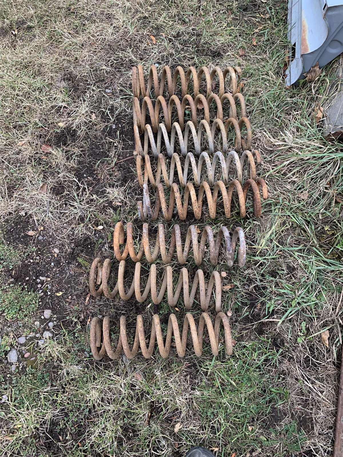

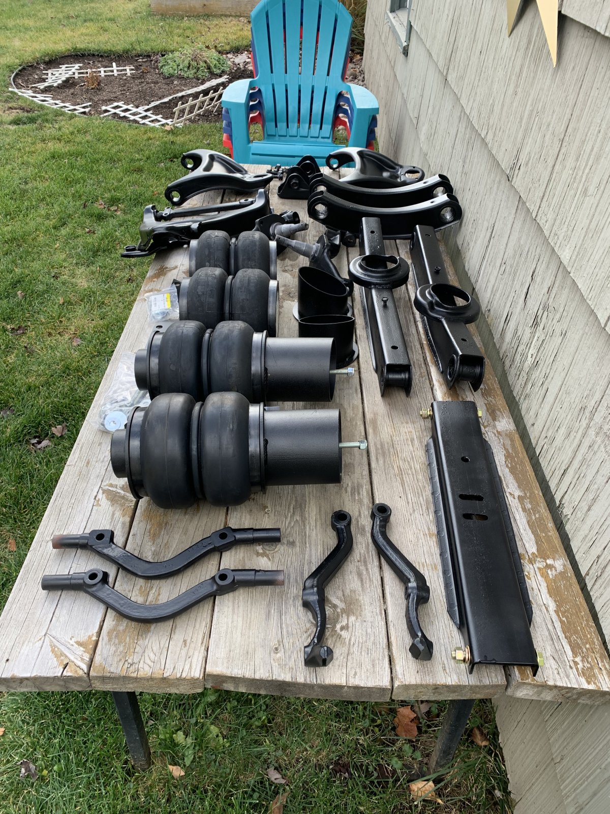

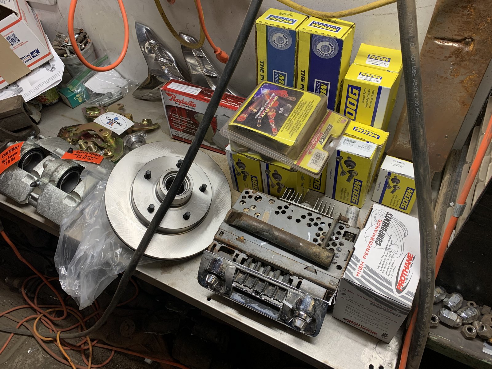

    I’ve been doing a lot of time consuming boring stuff. Sort parts, blast the best ones, paint them.
    I laid out all my ‘60 springs and chose the best ones.
    Here they are with fresh paint and a bunch of other goodies too.

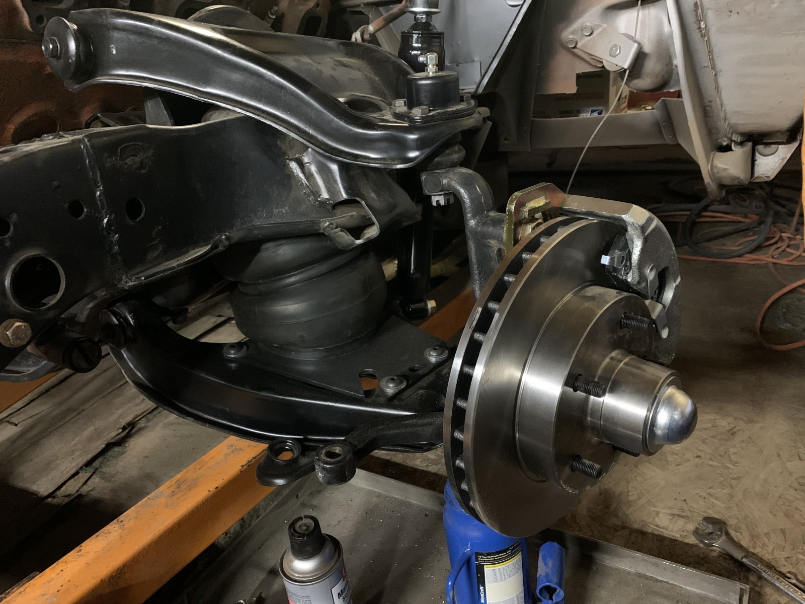

    Both the Bel Air and the ElCo were 6 cylinder cars so they didn’t have a front sway bar. I have a pair of sway bar LCAs from a V8 4dr post 63 Impala I killed 10 years ago but I can only find one of them. I think the other must be behind my lathe in my storage garage. It the only place I haven’t checked because it’s hard to get to.
    Between family stuff, the kitchen project, and ElCo rust repair, I’ve kinda been shoveling boxes onto my coupe as they arrive without even opening them.
    I finally opened everything to see where I’m at. I need an idler arm, fittings for my front springs, and some wheel bearings and I can put the front end together.

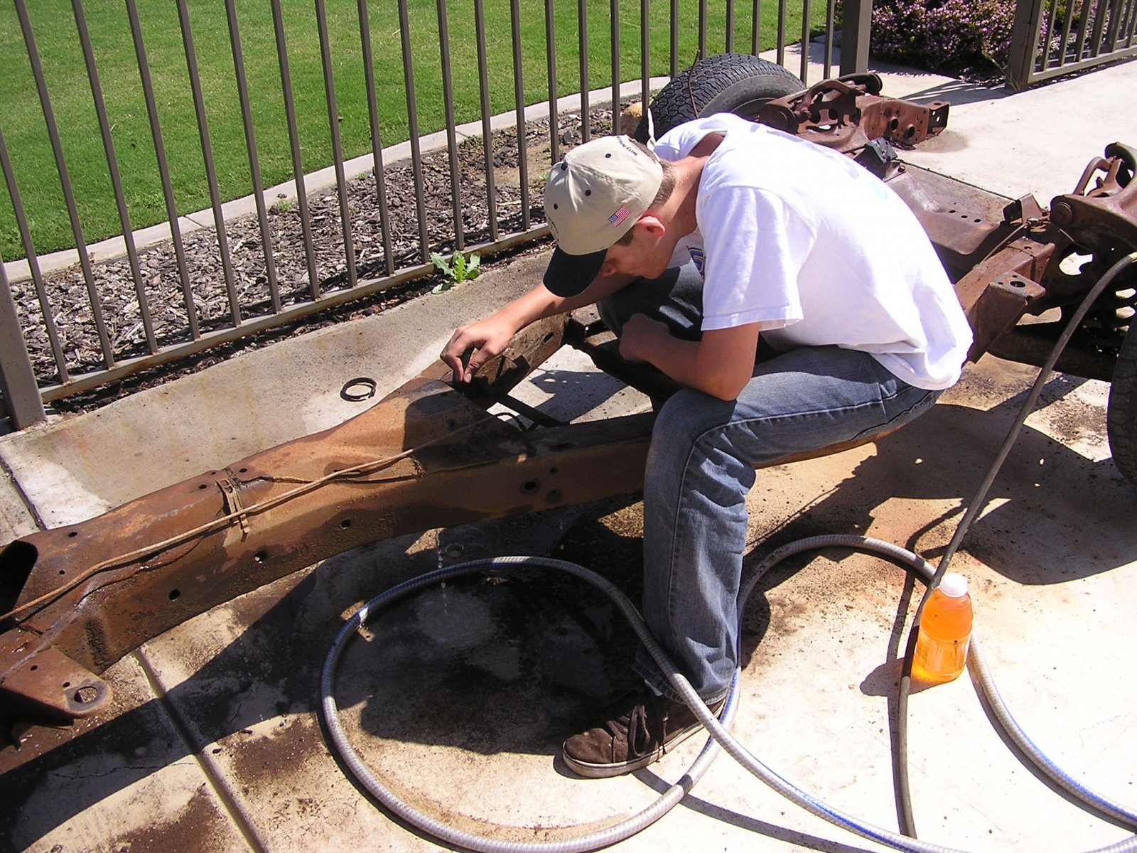

  13. willys36
    Joined: May 6, 2006
    Posts: 3,179
    willys36

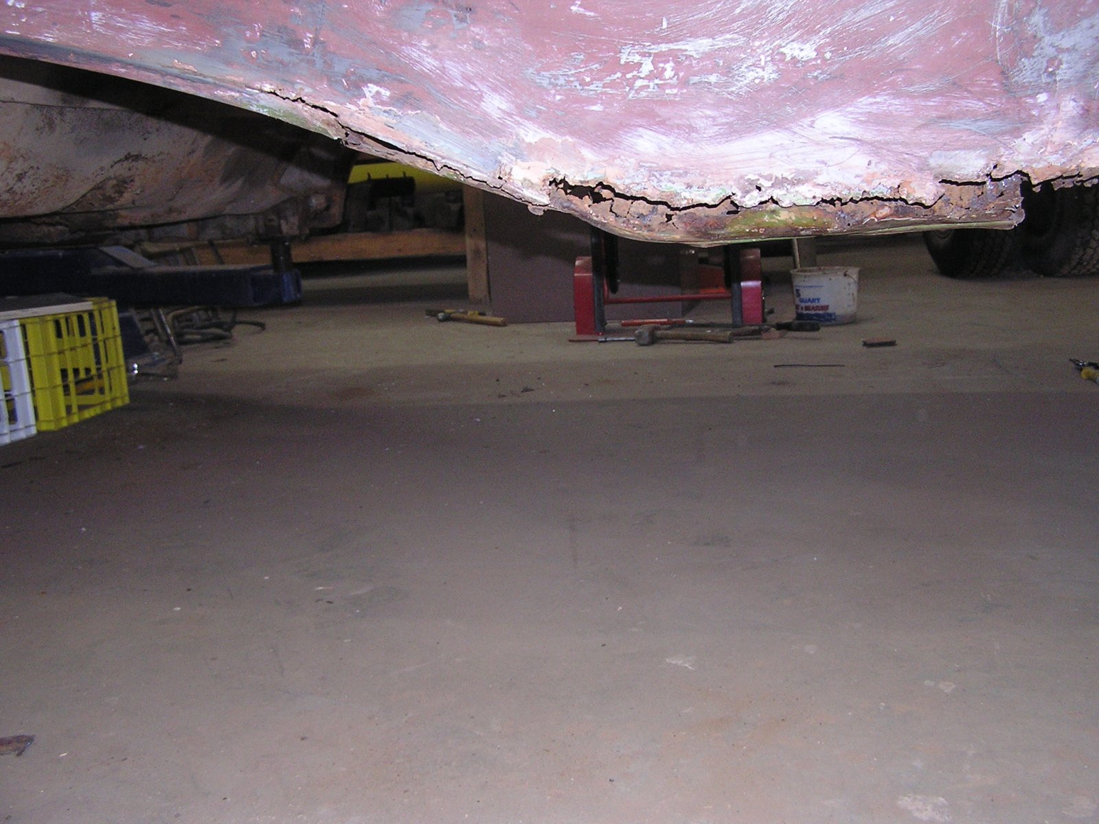

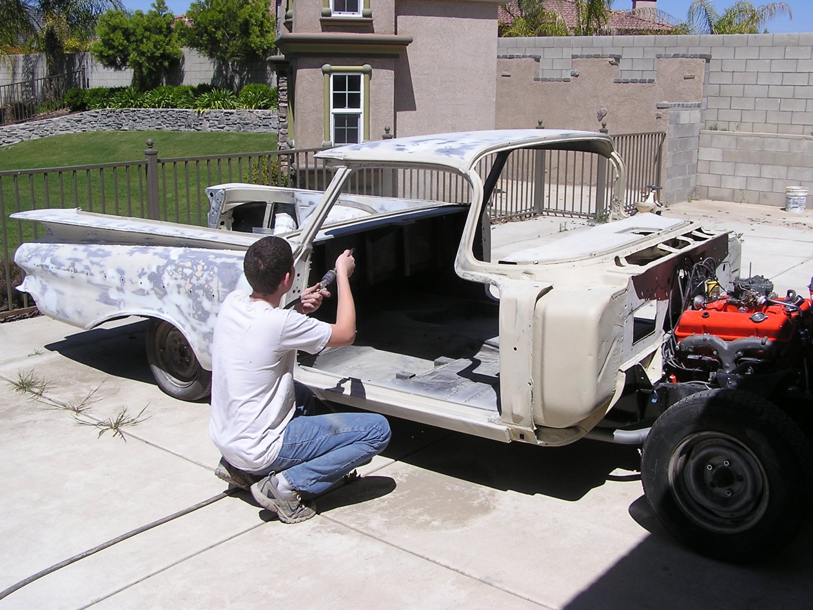

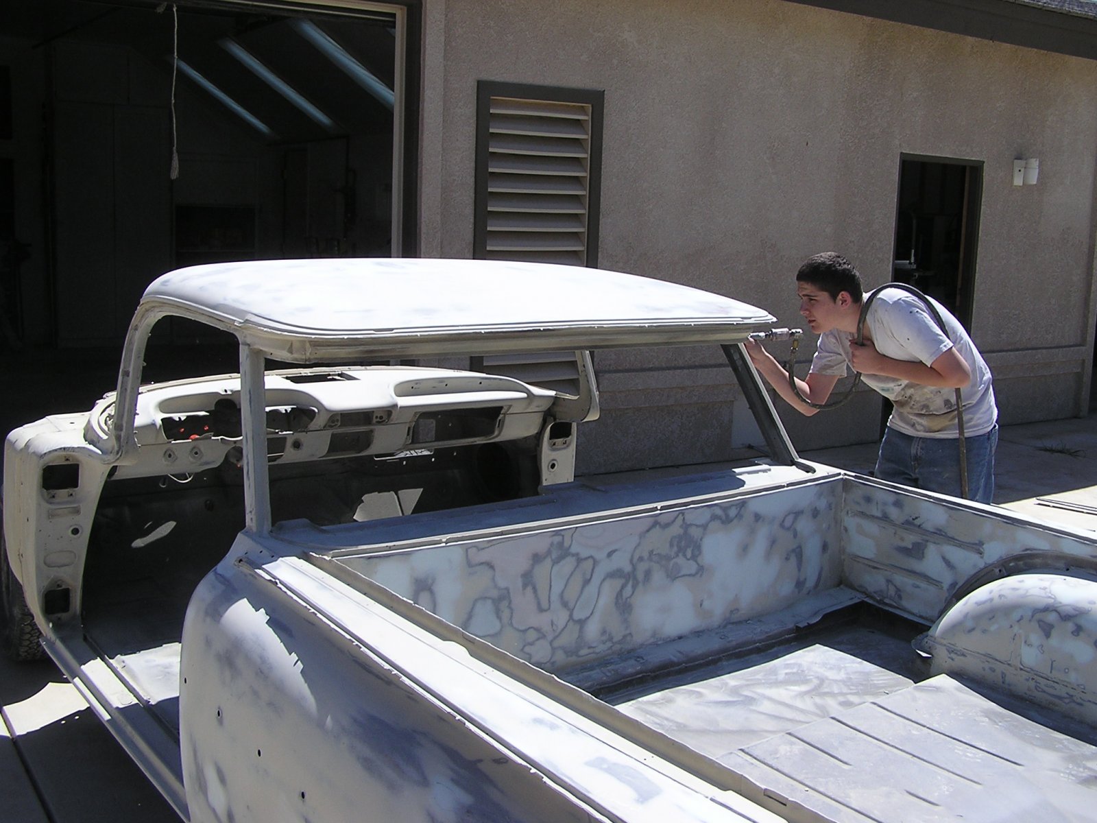

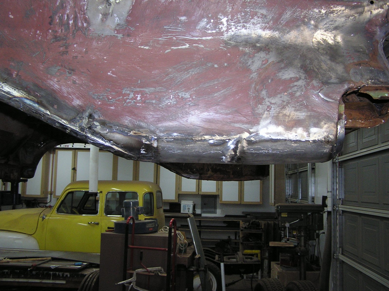

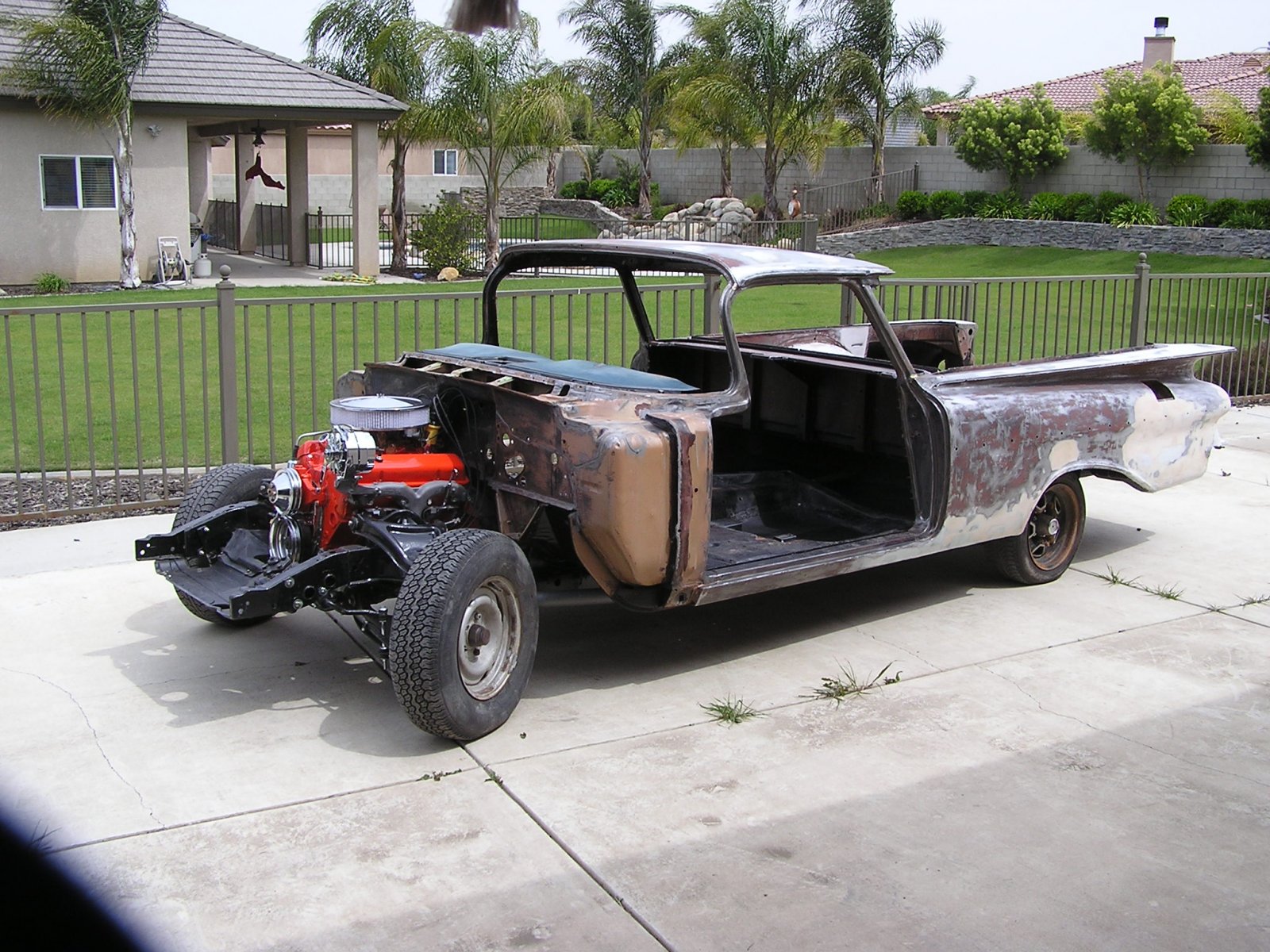

    We did the same thing on a '59 Elky for my grandson. Took us 2 yrs but we rebuilt every part of the car. He can now build a complete car from scratch.
    Left rear quarter patch.JPG left rear quarter rust 2.JPG Ready for final prime 3.jpg Ready to prime3.JPG Smuggler's compartment rust.JPG start car 10.JPG Troy cleaning1.JPG troy to prime 1.JPG Troy welding 2.JPG working small.jpg

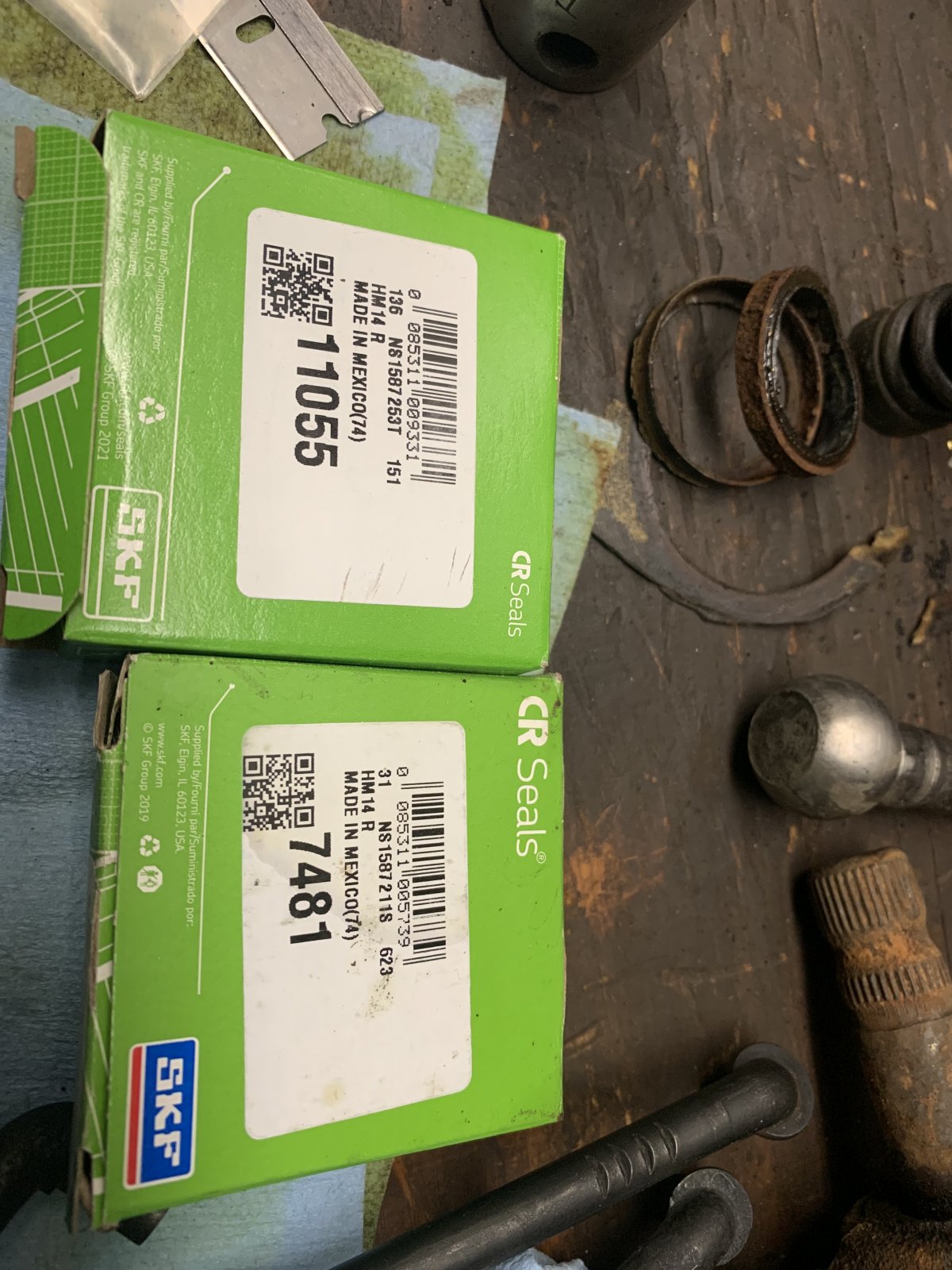

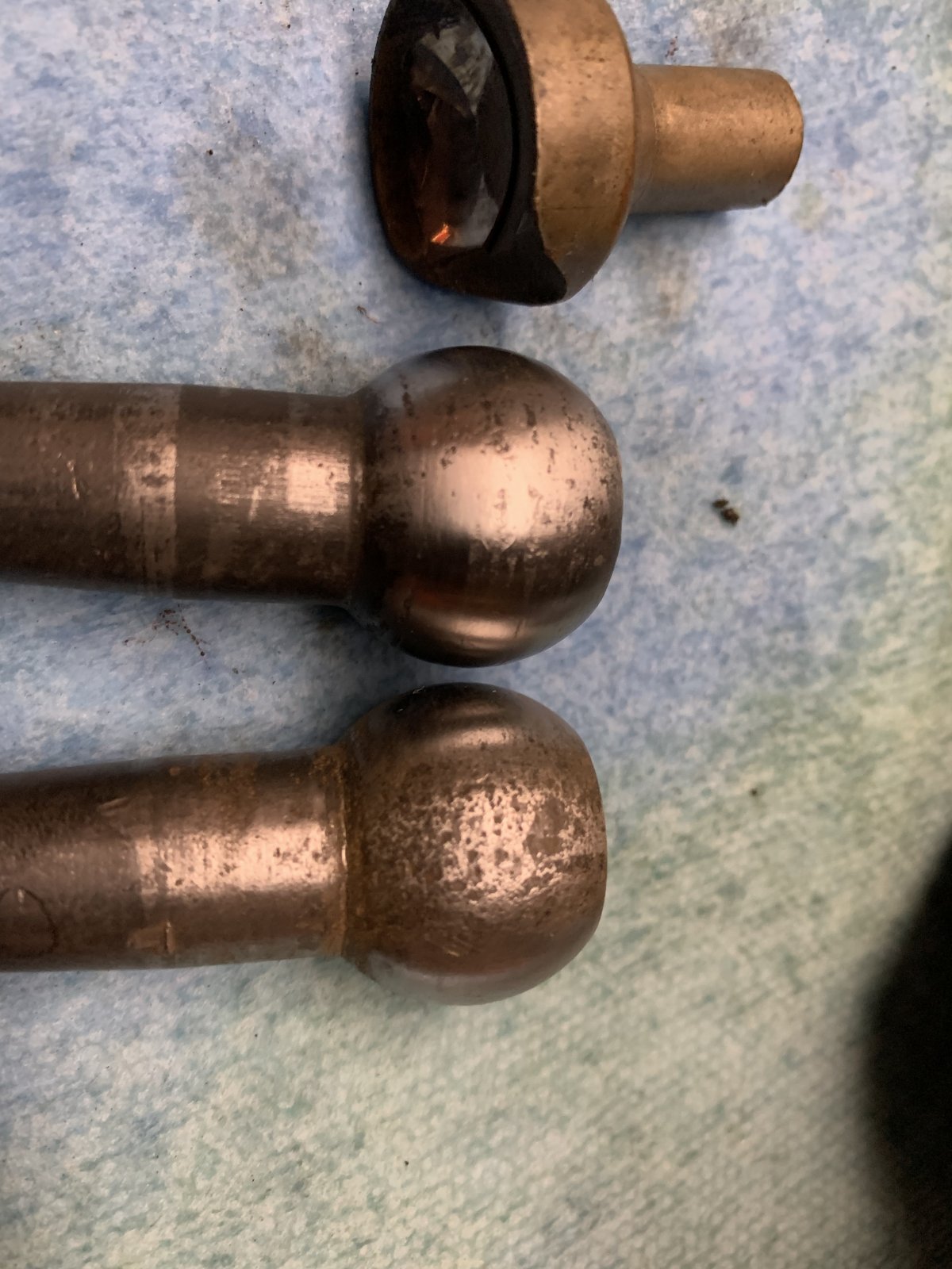

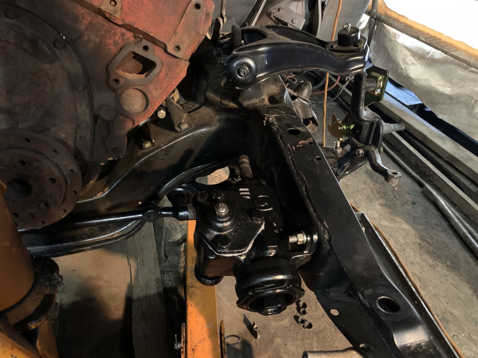

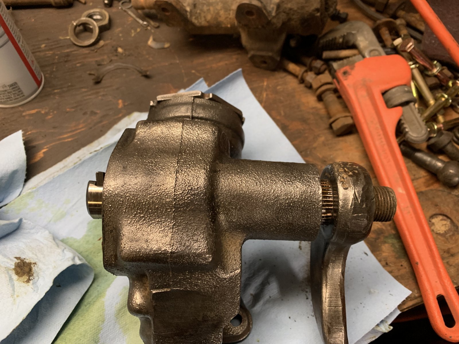

    I cleaned up and resealed the better of the two manual Saginaw steering boxes. Power would be nice in the future, but I have this and it’s paid for, so…
    It was full of rust colored sludge and water, but the guts seemed good.
    The part numbers for the pitman shaft seal out in the world all seem to be wrong, Luckily I found a seal that would work after actually measuring things. (Imagine that). Here are the numbers in case someone else ever decides to do this. Figuring this out was a pain and wasted time shipping stupid little seals. I had to make the paper gasket, no one seems to sell it loose.
    I chose the best center link body and the best internals and built a part.

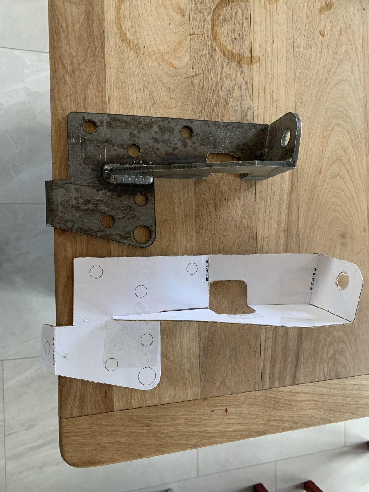

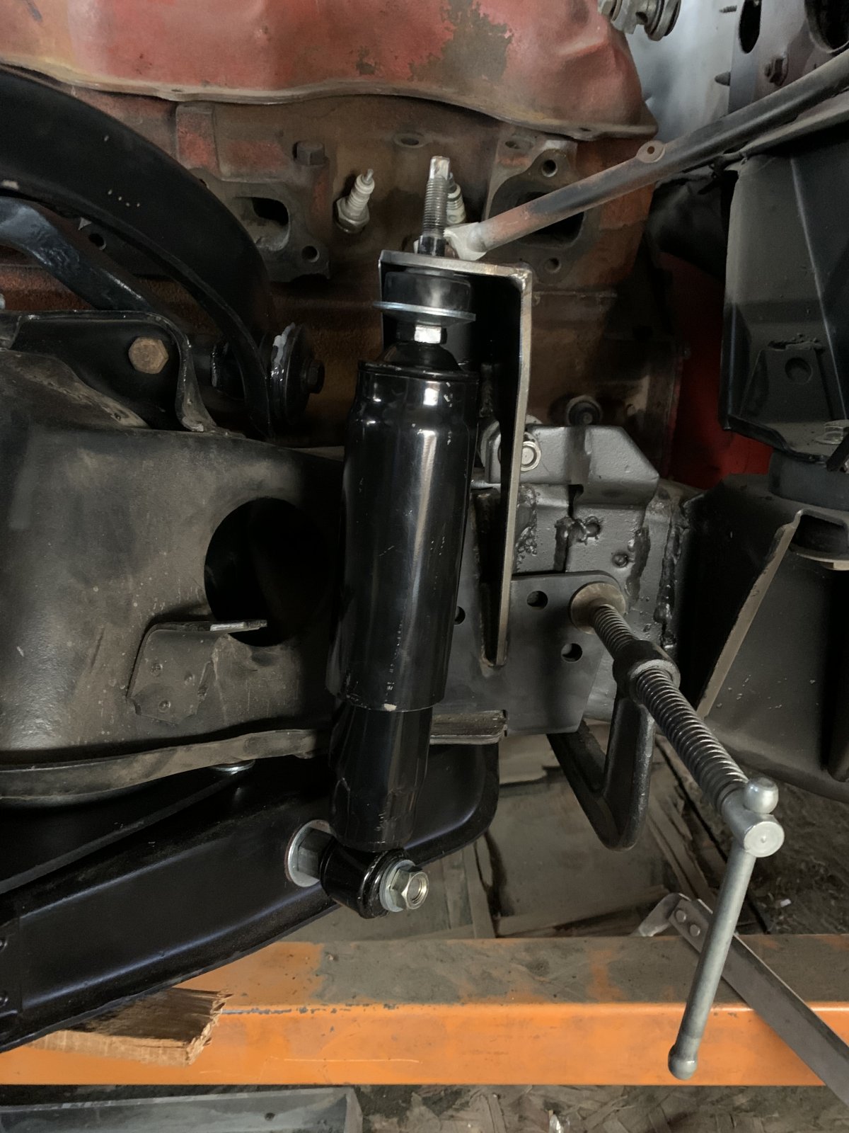

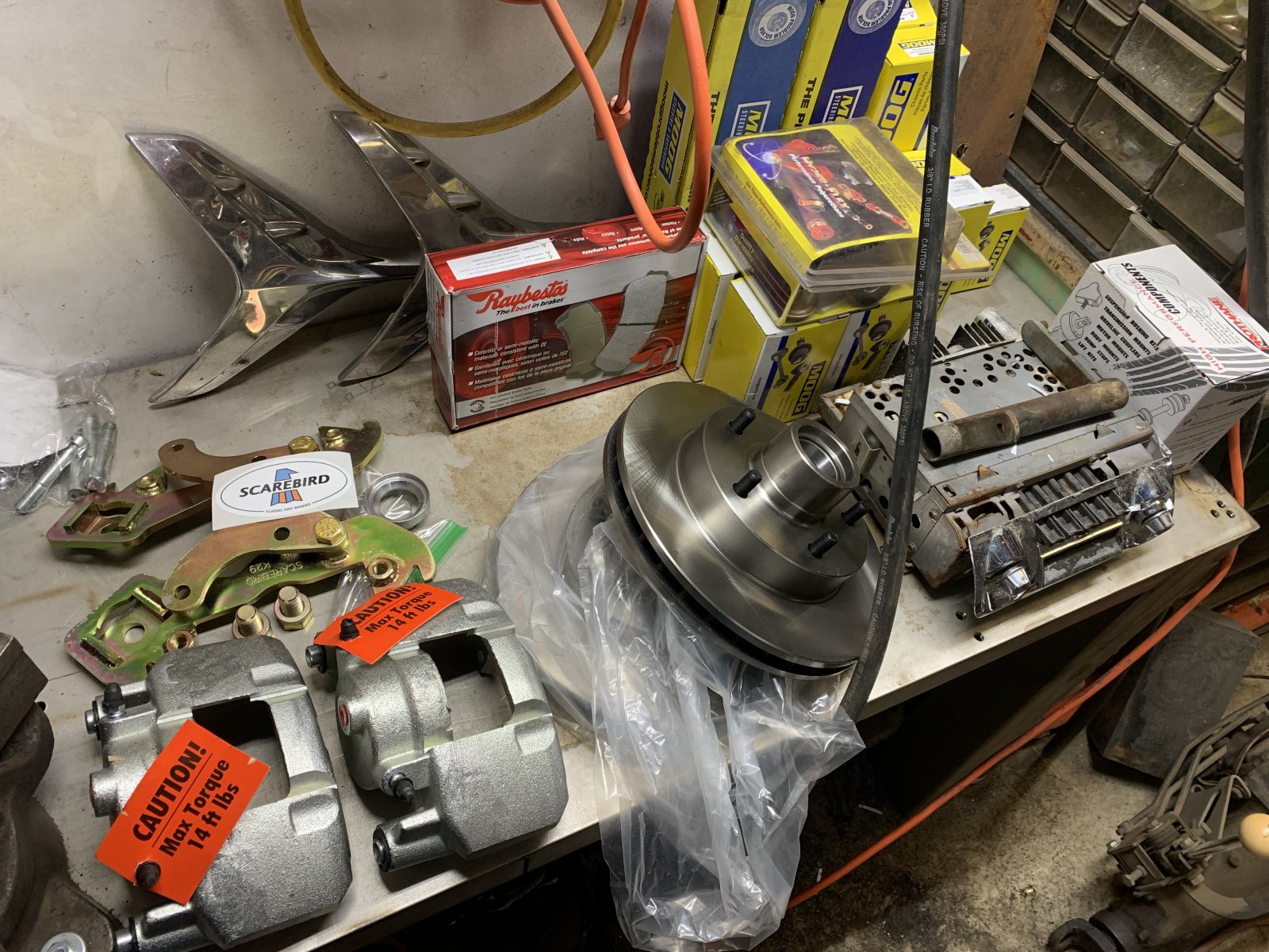

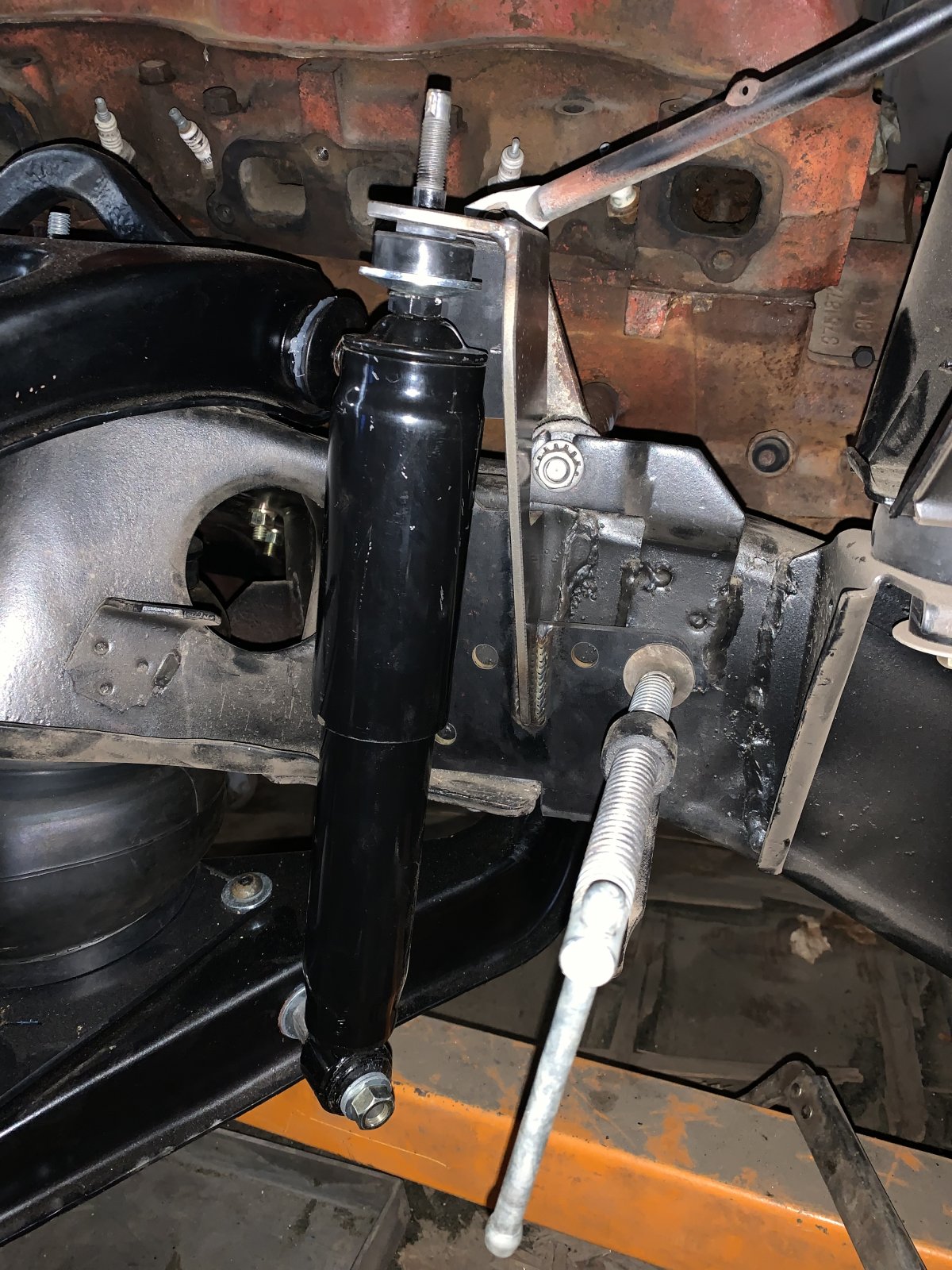

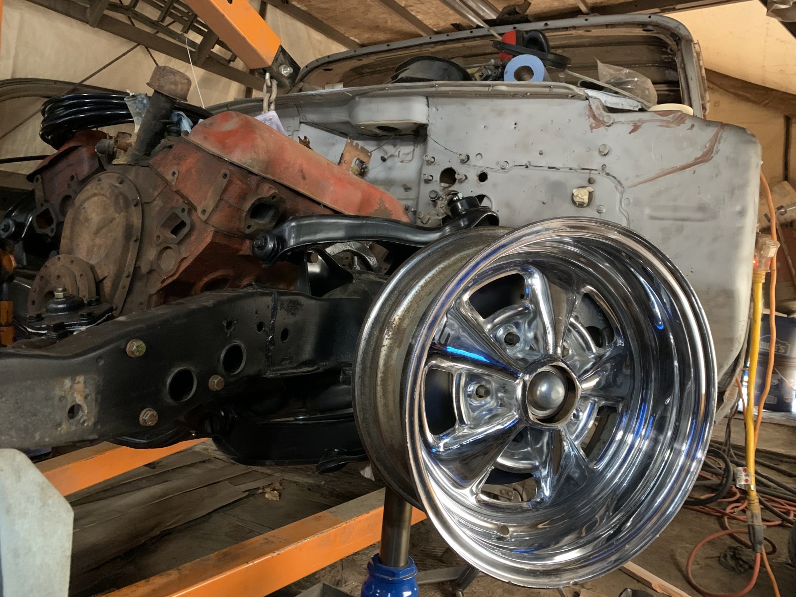

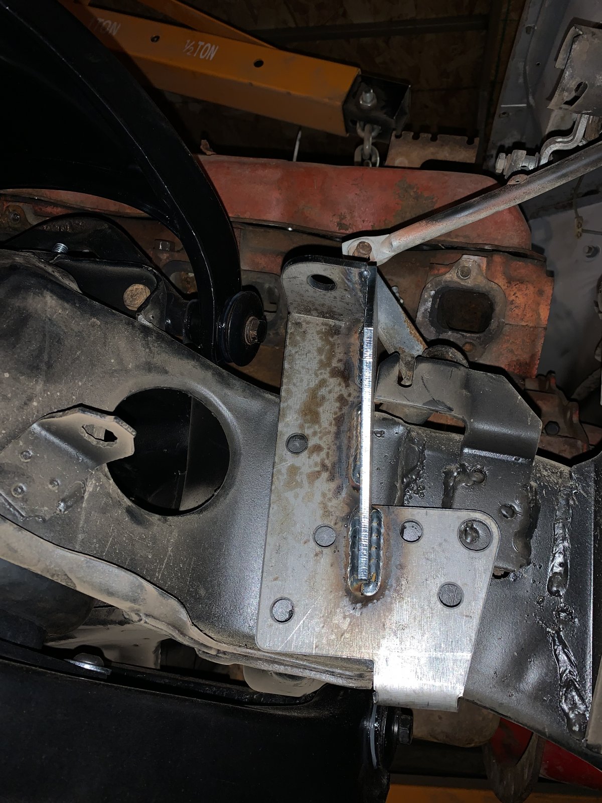

    I put some more stuff together. The Scarebird brakes were easy to work with.
    The auction site shock relocation brackets were not. They interfere with the clutch linkage and are too short for the suggested shocks.
    I added a height, a hole, and a bend and got something that fits better. Paper mock up vs original.
    I got some parts cut, had a friend with a brake help a little, and got a good part with all the travel I need.

    The bed is still a mess. That the trans tunnel, and the temporary 350 are next after the front suspension. I’m not happy with the Saginaw 4 speed and the shifter position.

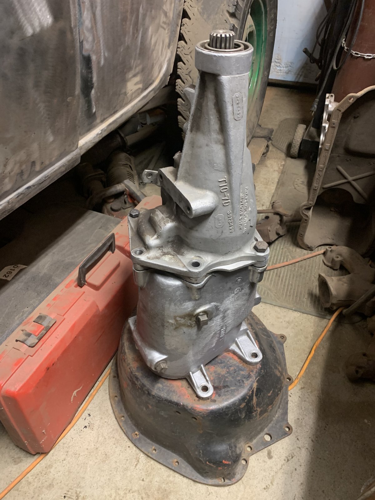

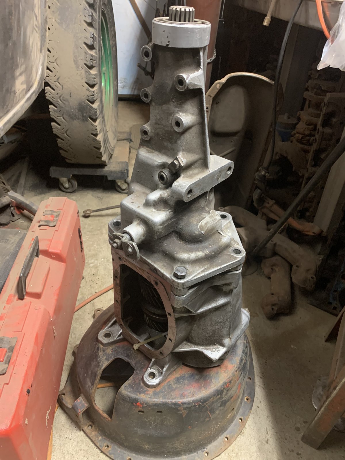

    i scored a 63 T10 and the proper ****ter shield instead of the Chevy II one. The 63 T10 came in a 5 gallon bucket. At this point I have complete ‘60 T10 in my coupe, a ‘62 T10 with a weird output for aluminum V8 Buicks and Oldsmobiles, and this 63 one. I’ve got a 63 SS with a Saginaw 4 speed. The coupe needs to give up its 60 box, and the 63 needs the right trans too, so I guess I’m still buying t10 ****.

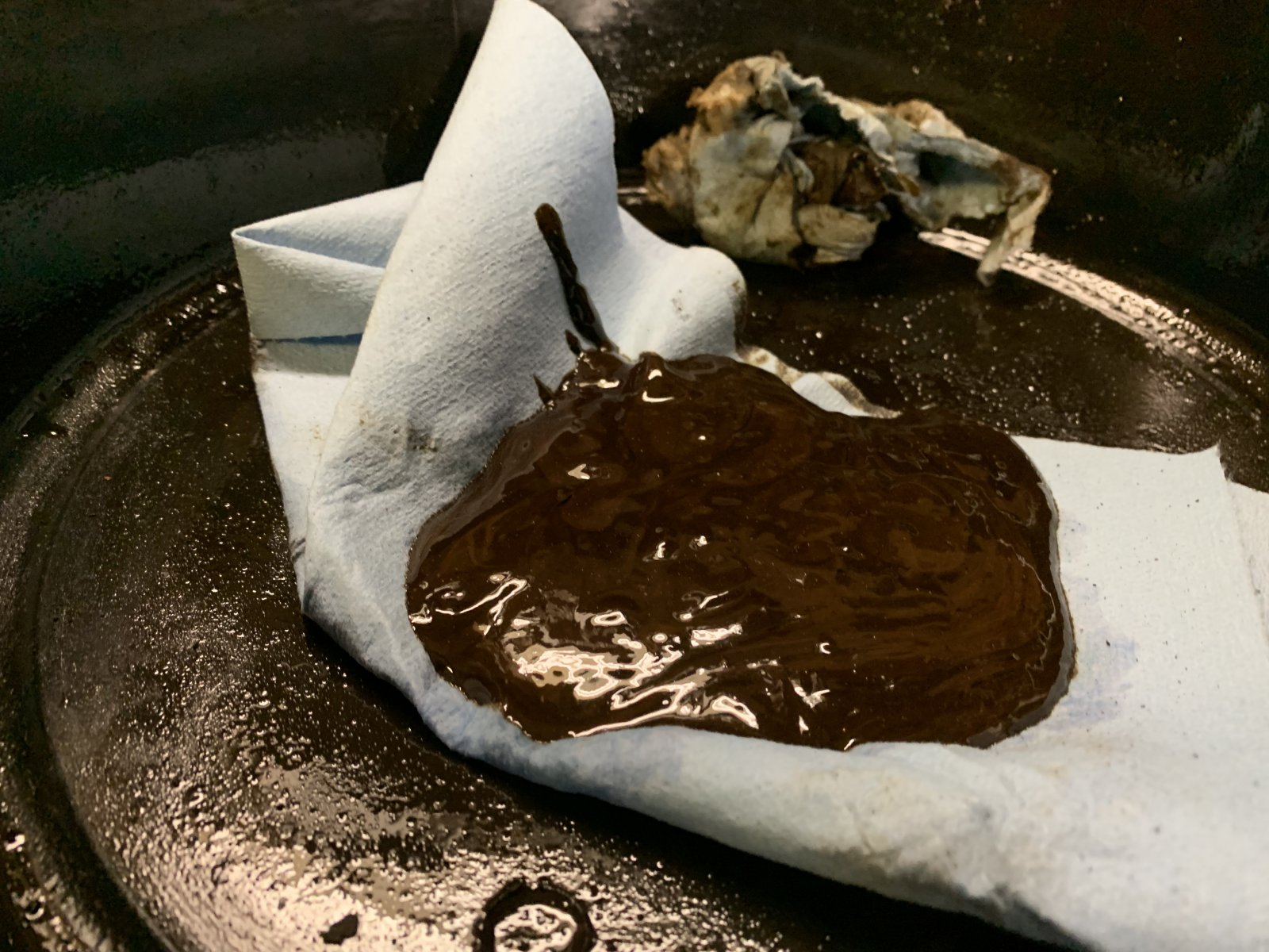

    I’ve got it soaking full of various oils right now. Eventually I’ll take it all the way apart and get really serious. There’s a layer of crust almost like a layer of ice inside the water jacket where the top of the coolant was for 40 years. It’s wild. Right now, I just wanna drive it even if it’s got a boring old 350 in it.

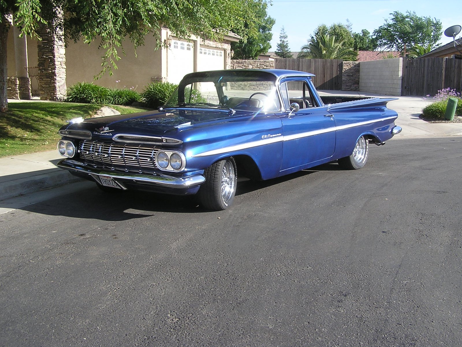

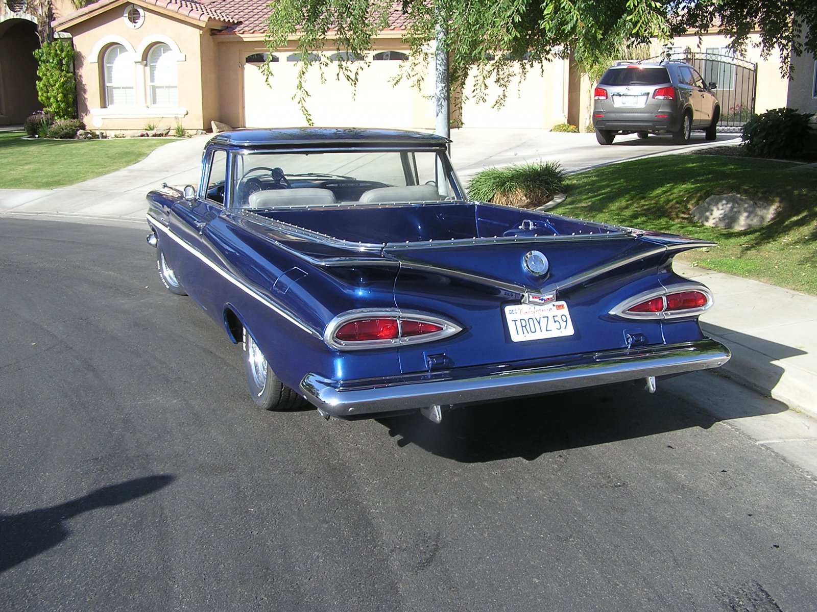

    408BFD67-5A08-461B-817D-489273DDAE1F.jpeg 8632FEDE-686B-408D-A7BD-9B9C8692A6EE.jpeg Here’s my ‘59 El Camino. I chopped it a tiny bit.

    Your 59 looks great Nads. I remember the build from the Los Boulevardos forum (if I’m remembering right. )

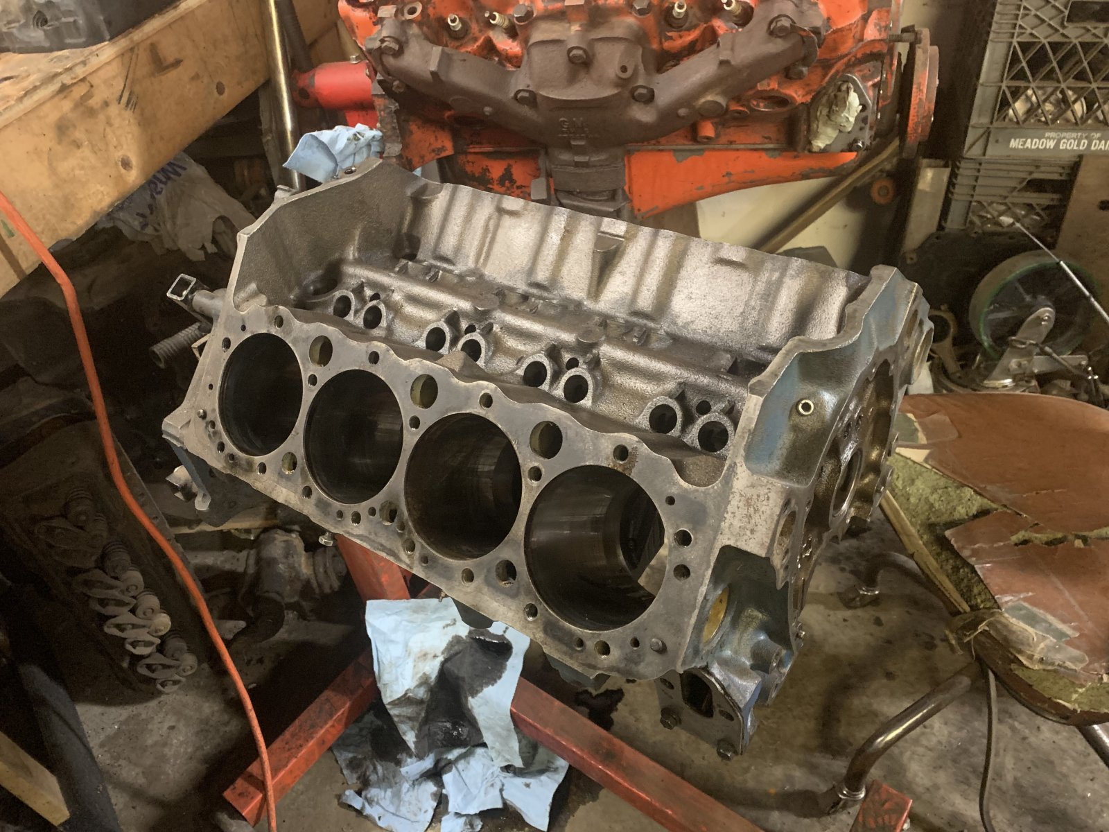

    This is kinda like sticking all the parts of you 1/25 scale kit together before you paint and glue them.

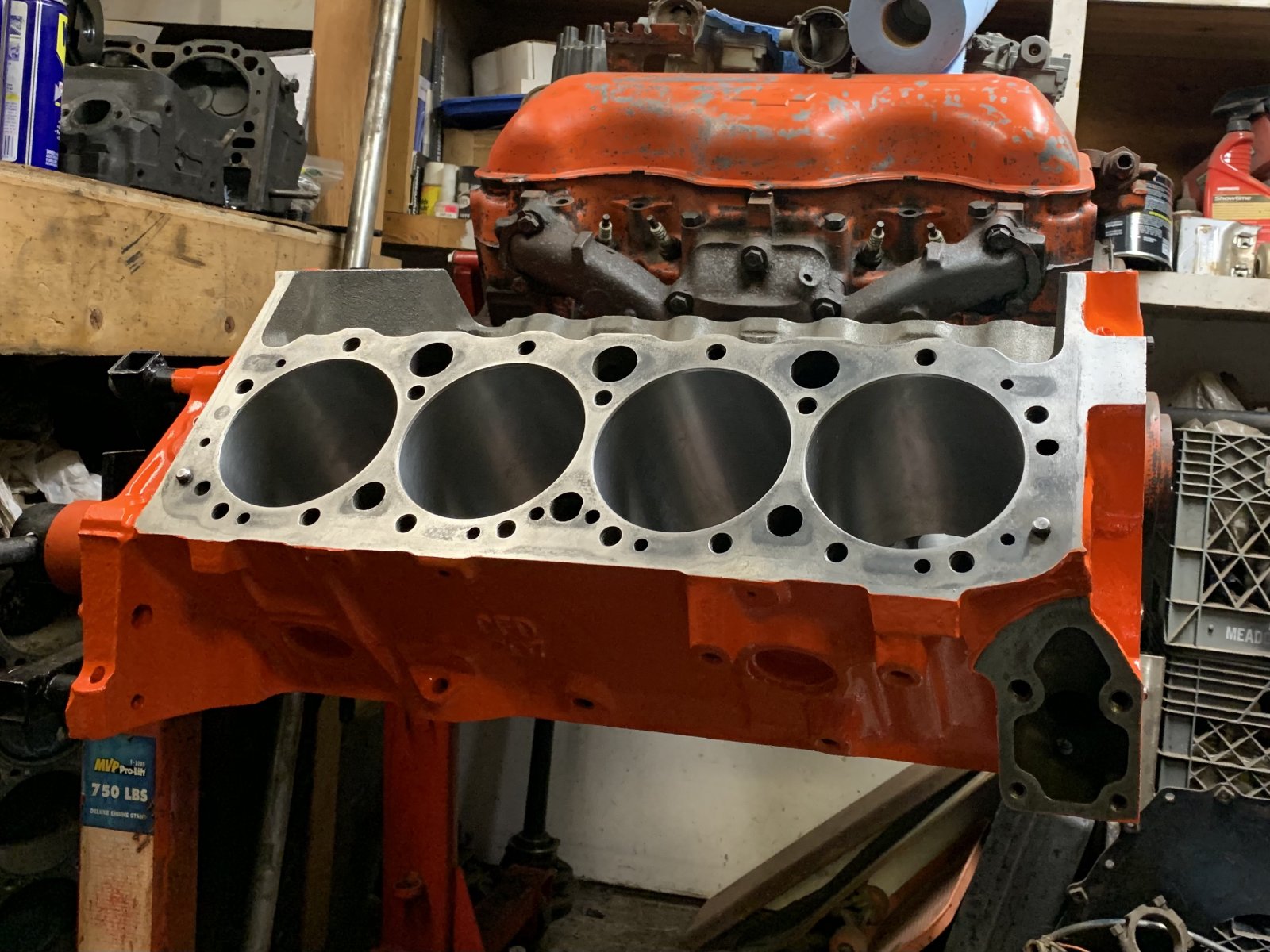

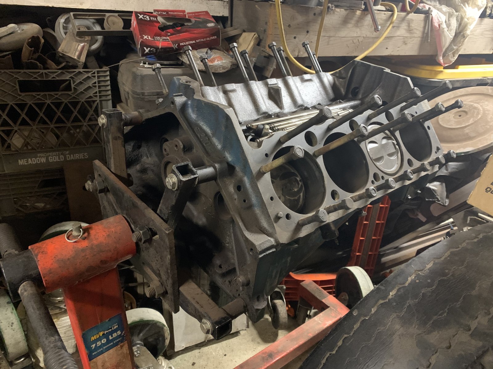

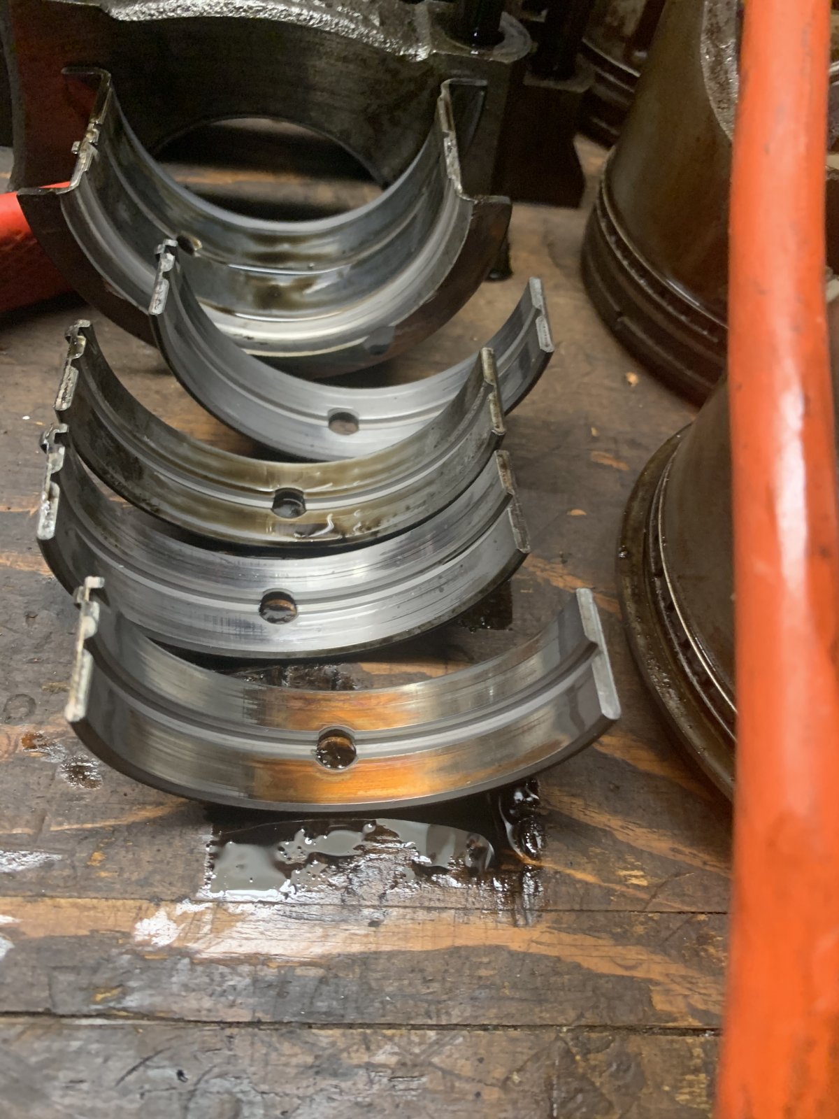

    Then the tear down
    Mains
    The worst bore. It cleaned up.
    After a hone and some POR 15 engine enamel. I brush painted it for some reason. It doesn’t look bad, but it doesn’t look good. It reminded me of that Testers Orange enamel. Goes on like honey.
