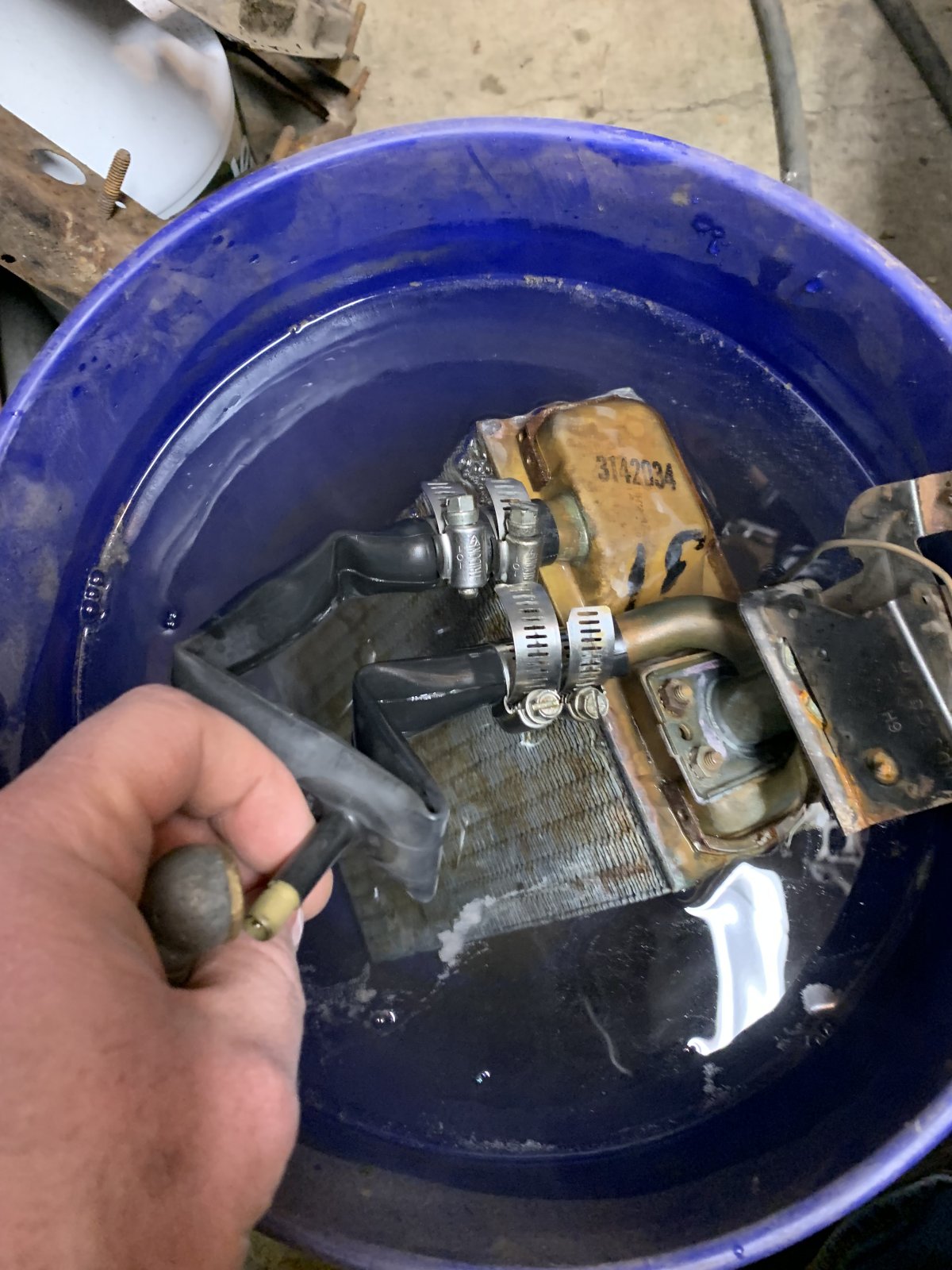

    Heater core time. I was ***uming that I’d just spend a couple bucks and buy a new one when everything went back together but no such luck. They don’t seem to be reproduced plus they have a built in heat valve that only one guy seems to be rebuilding. I’ve got 3 cores and 3 valves. 2 of the valves are Harrison, one is missing the thermal coil. The other is a Ranco that’s badly corroded. Squirrel did the only tutorial I found on the entire internet on rebuilding Rancos but I think it’s too crusty to mess with. The Harrisons seem to need to go to the heat valve guy.
    I messed one core up getting the crusty old heater hoses off and being careless before I knew it wasn’t replaceable. I was figuring that if I was going this deep I’d put new parts in just so I wouldn’t have to later.

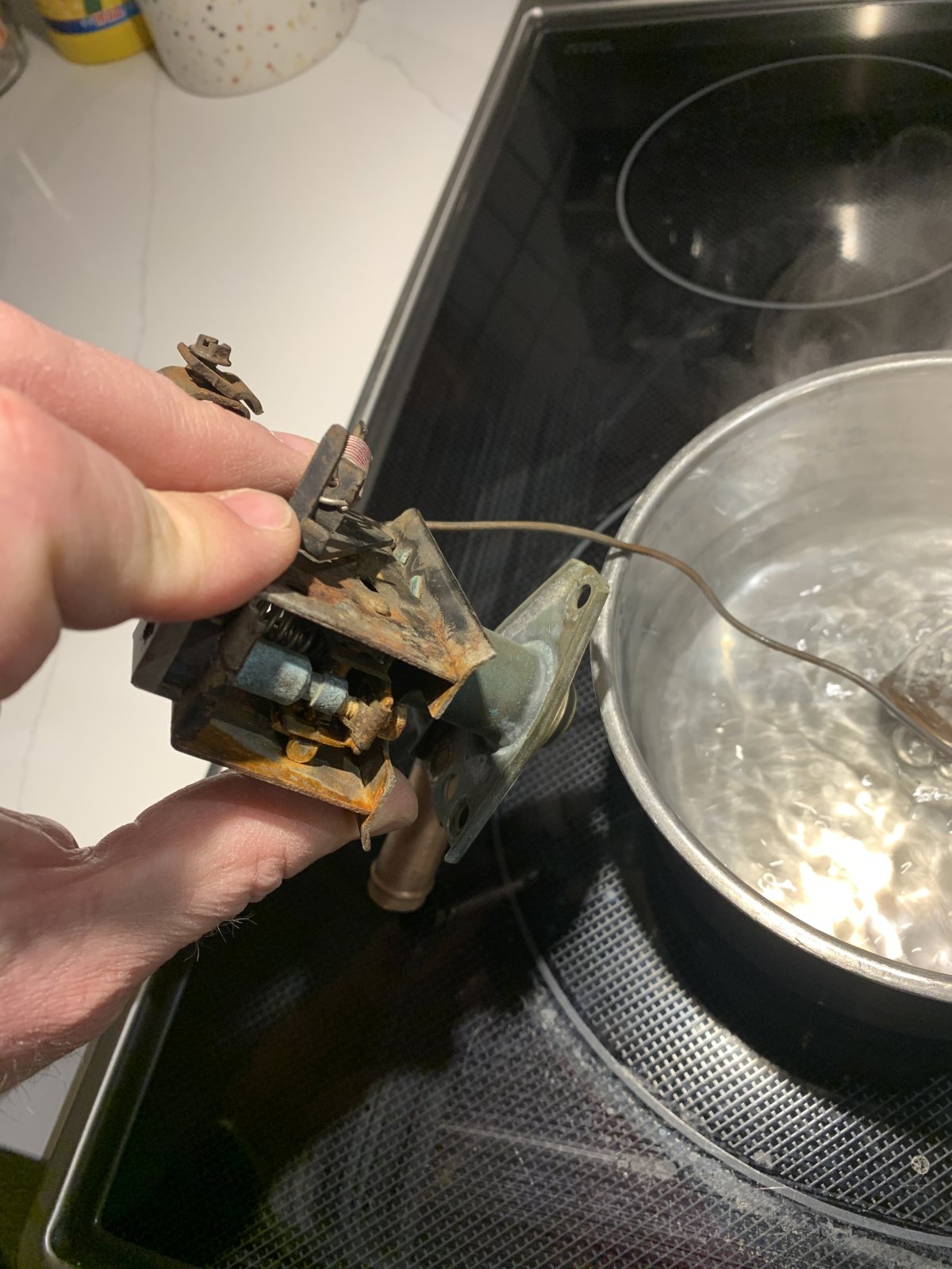

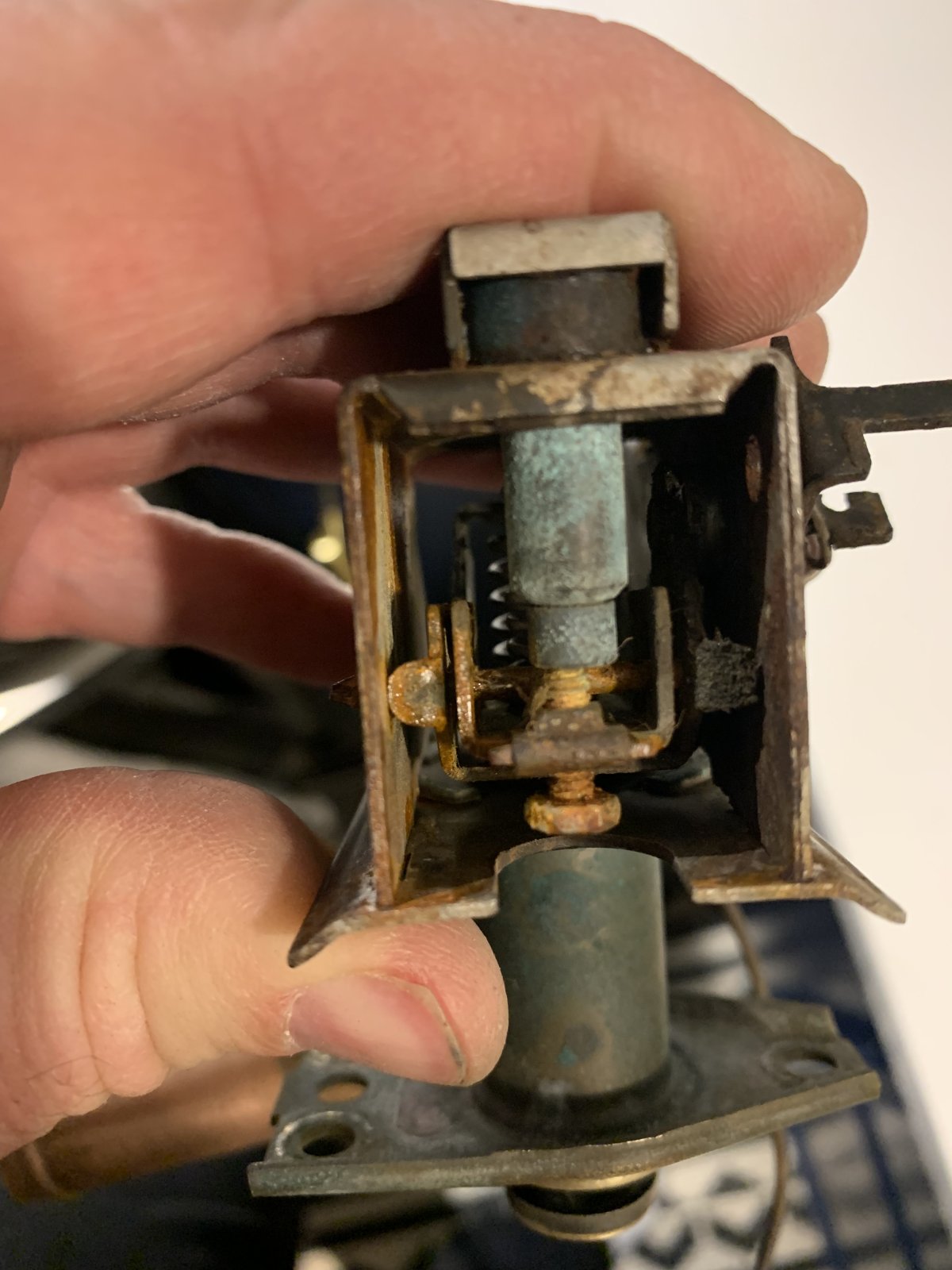

    Core, valve, thermal coil. I’m pretty sure this is from the ElCo.

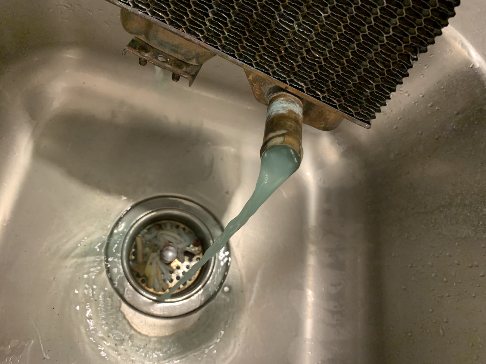

    Cleaned the better two with hot water and finally white vinegar. Here’s the forbidden blue ice Gatorade pouring out of the ‘59 core.
    I scienced on the thermal feature on the better Harrison valve and it seems to be working. Room temp:
    And hot

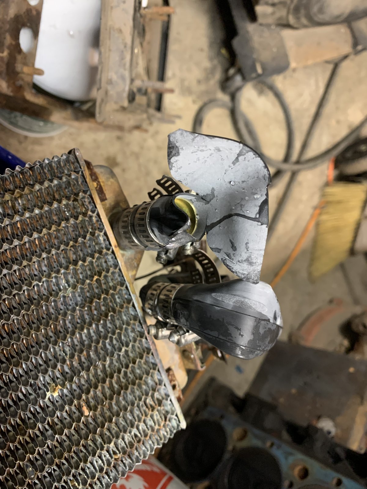

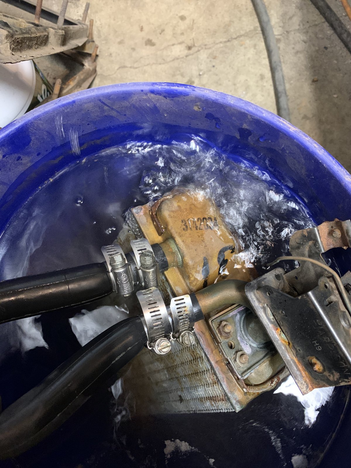

    I put together a very sophisticated pressure test rig.
    And got some bad news. This is the 59 core.
    And not bad news from the ElCo core
    Then I was have too much fun making bubbles and popped my test rig.
    There’s an old radiator place in town I’ll hit up next week and see what they can do. I *think* I might be able to use the better Harrison valve as is. I didn’t manage to make it leak. I did replace the O ring between the valve and the core. I got bubbles everywhere other than that valve.

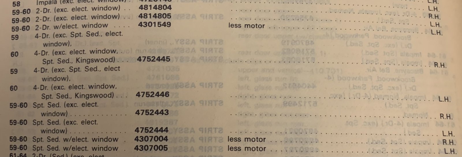

    I dug around in my Chevy 38-64 parts and accessories catalogue and it looks like 59-60 vent window parts are categorized as “exc. Spt. Mdls.” and “Spt. Mdls.” I’m ***uming it’s Sport Coupes, Sport Sedans, and Ragtops vs everything else. I think our cars are everything else, so my extra post sedan vents should fit. Unfortunately, the door gl*** regulator needs to be 2dr, so no luck there. I’ll dig things out this weekend and see what I can do.
    Door gl*** regulator P/Ns
