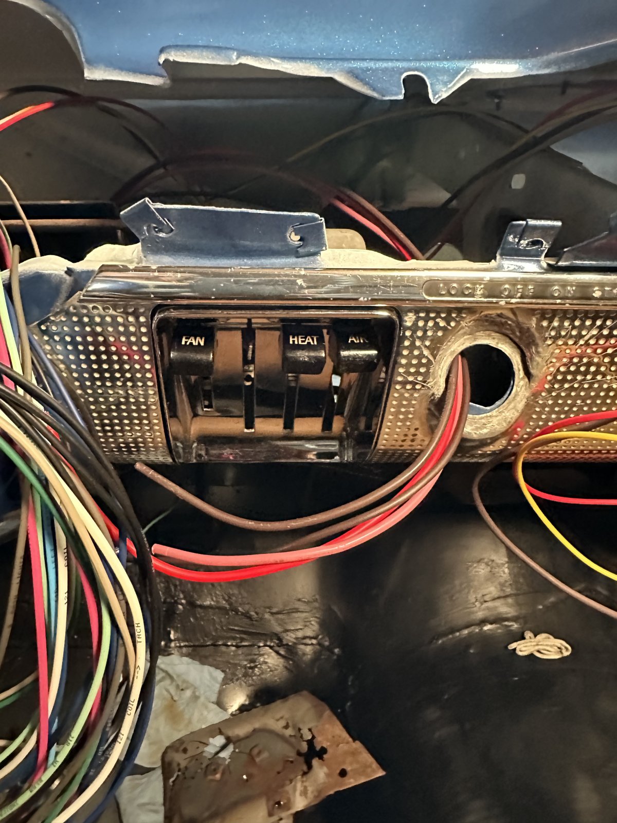

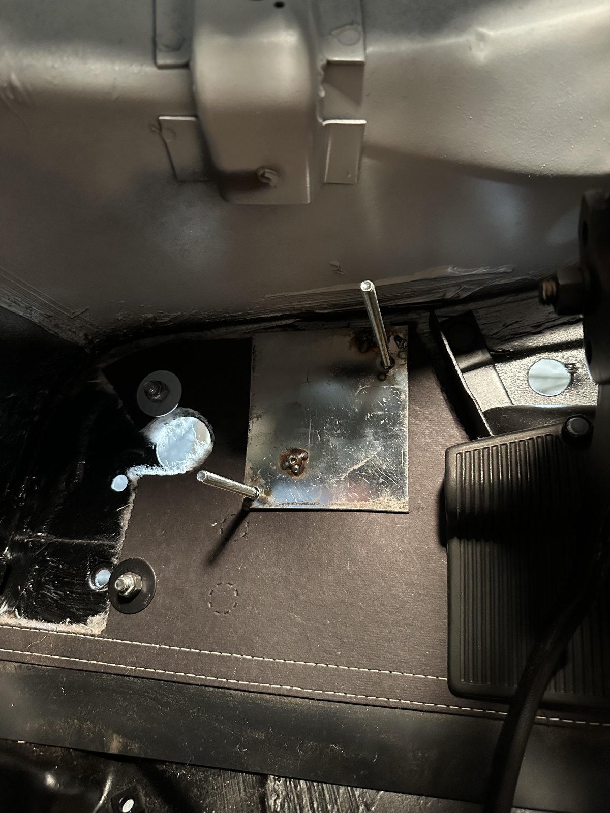

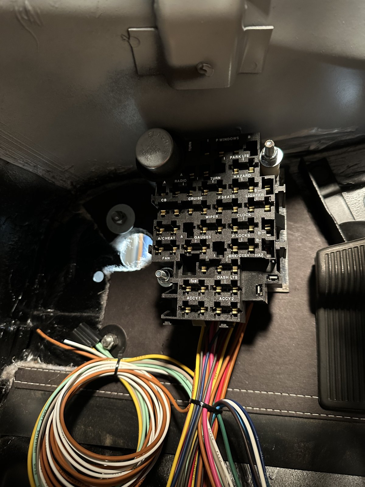

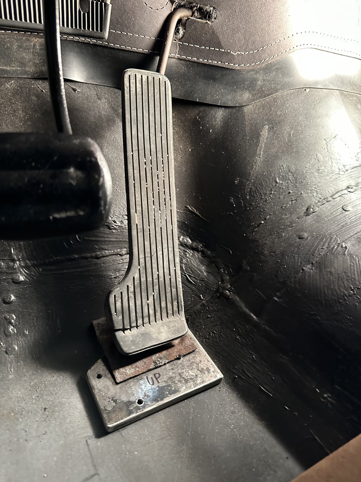

    I worked on a bunch of little stuff waiting for the heater core to get back. I made an adapter plate for the fuse block so I wouldn’t have to poke new holes in the firewall.
    And hung the Speedway harness
    The only original V8 gas pedal linkage I had was from the 59 and was rusted and split. The ElCo had a hodgepodge someone built and the Bel Air had linkage for a 6.
    I got new bushings, chunks of the Bel Air linkage, and some spray paint.
    The factory floor pan has a slightly raised area under the gas pedal pivot that had weld nuts and a welded bracket for the parking brake pulley on the bottom side. My cheap patch panels don’t have that. I decided to keep it simple and tapped some holes in a piece of plate. I had to hammer a little room in the floor up front, but noting too bad.
    Just set in place.

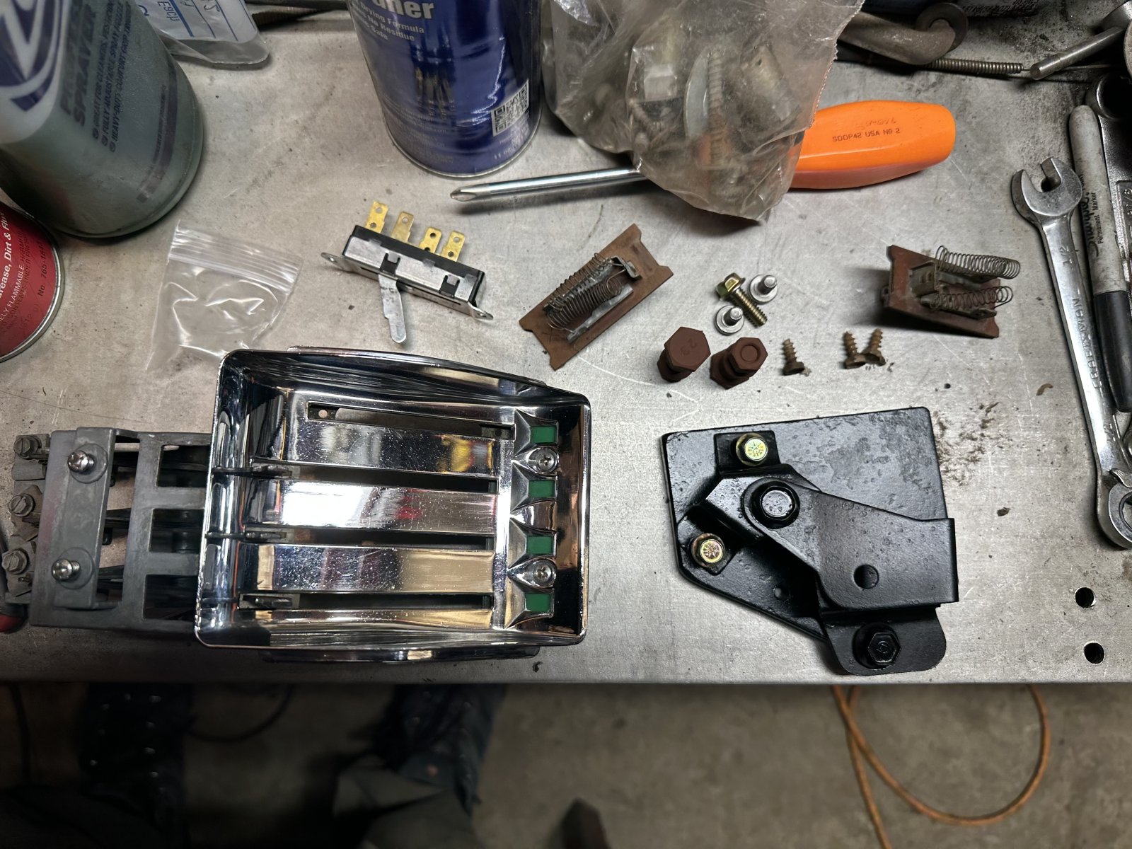

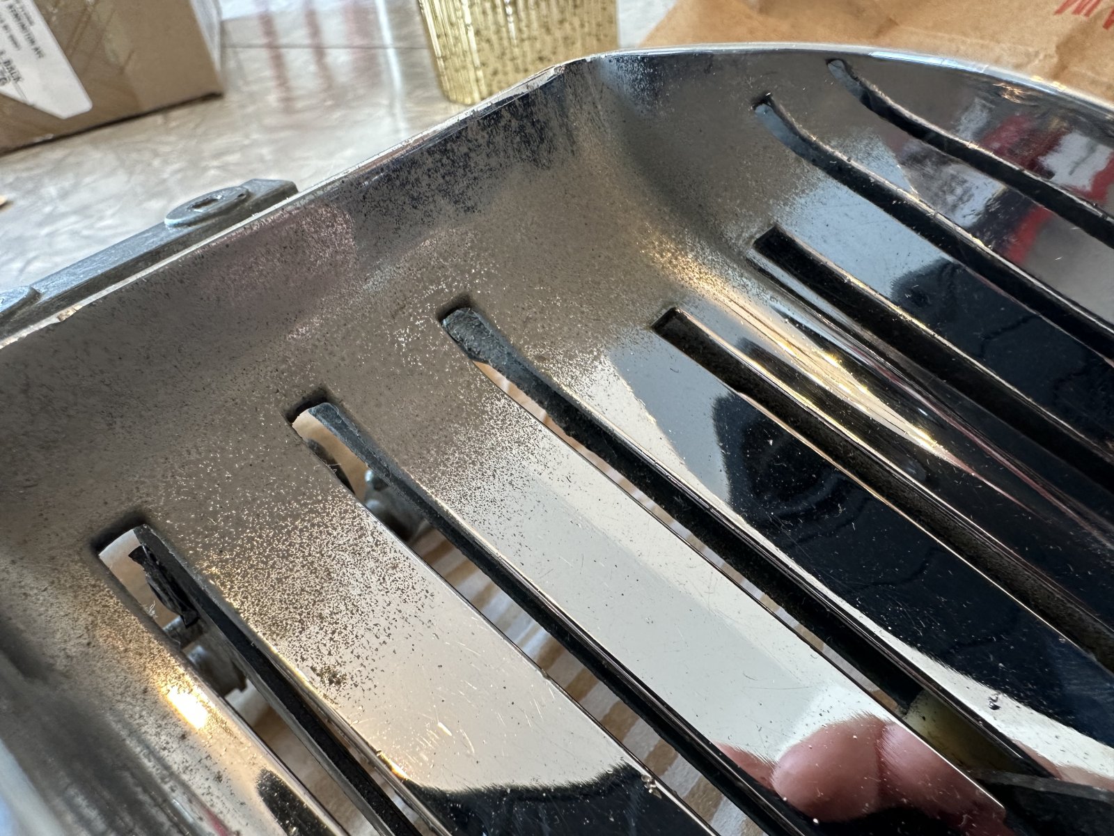

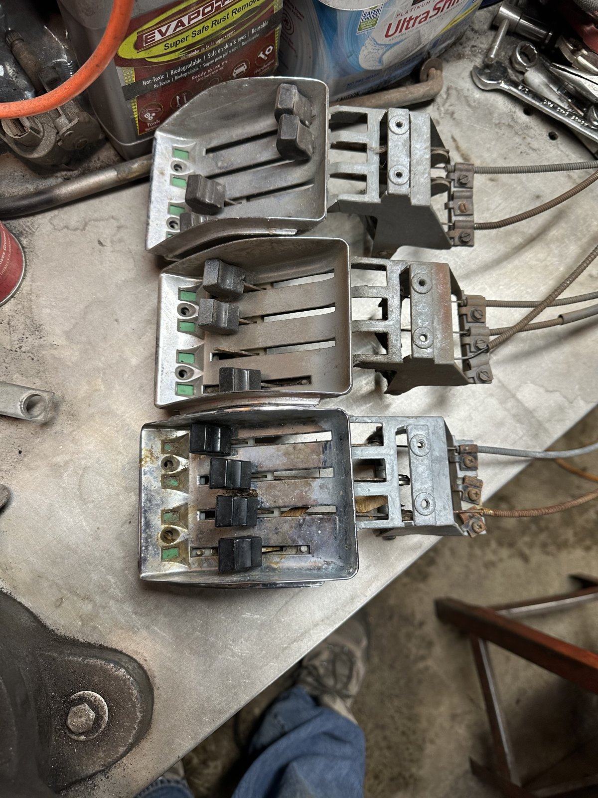

    The heater control from the ElCo had the least pitting, but it was really scuzzy and dull. It’s the middle one.
    It came up OK with some elbow grease.
    Here it is polished. My gas pedal pivot/parking brake pulley bracket is next to it.

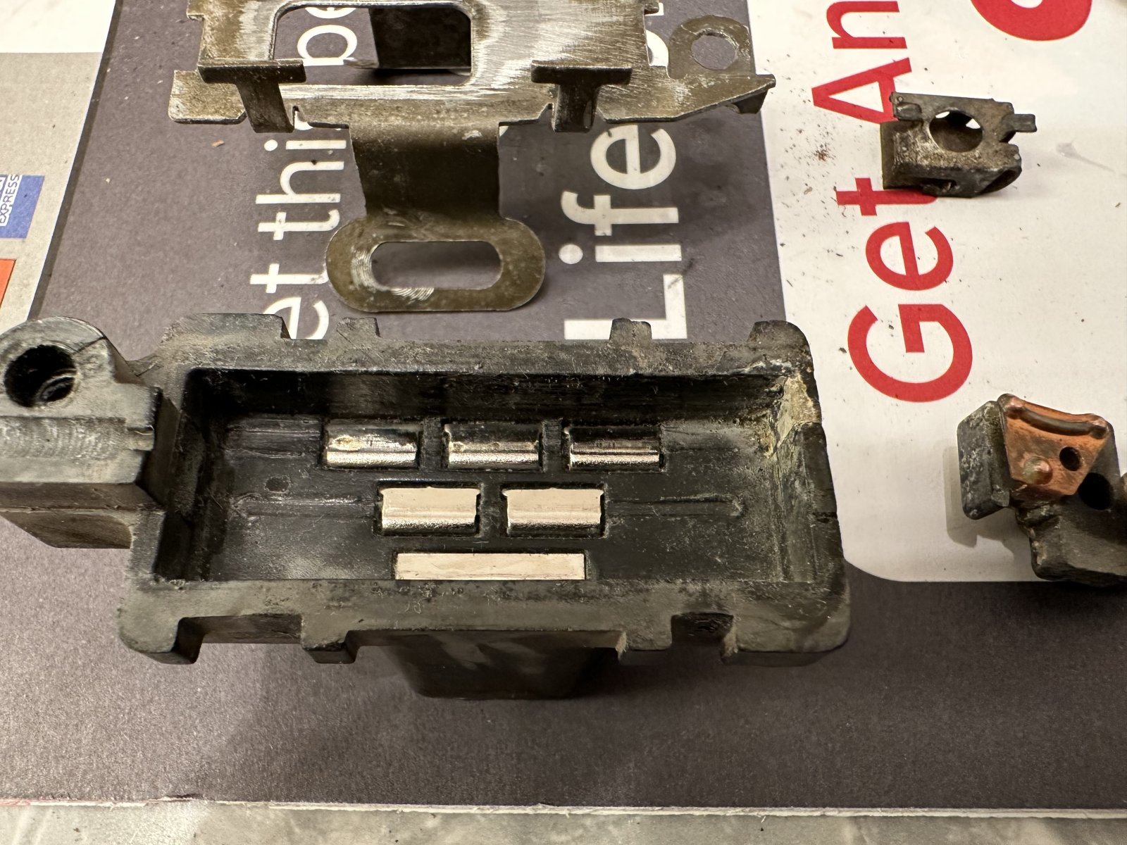

    I dismantled and cleaned the turn signal switch.

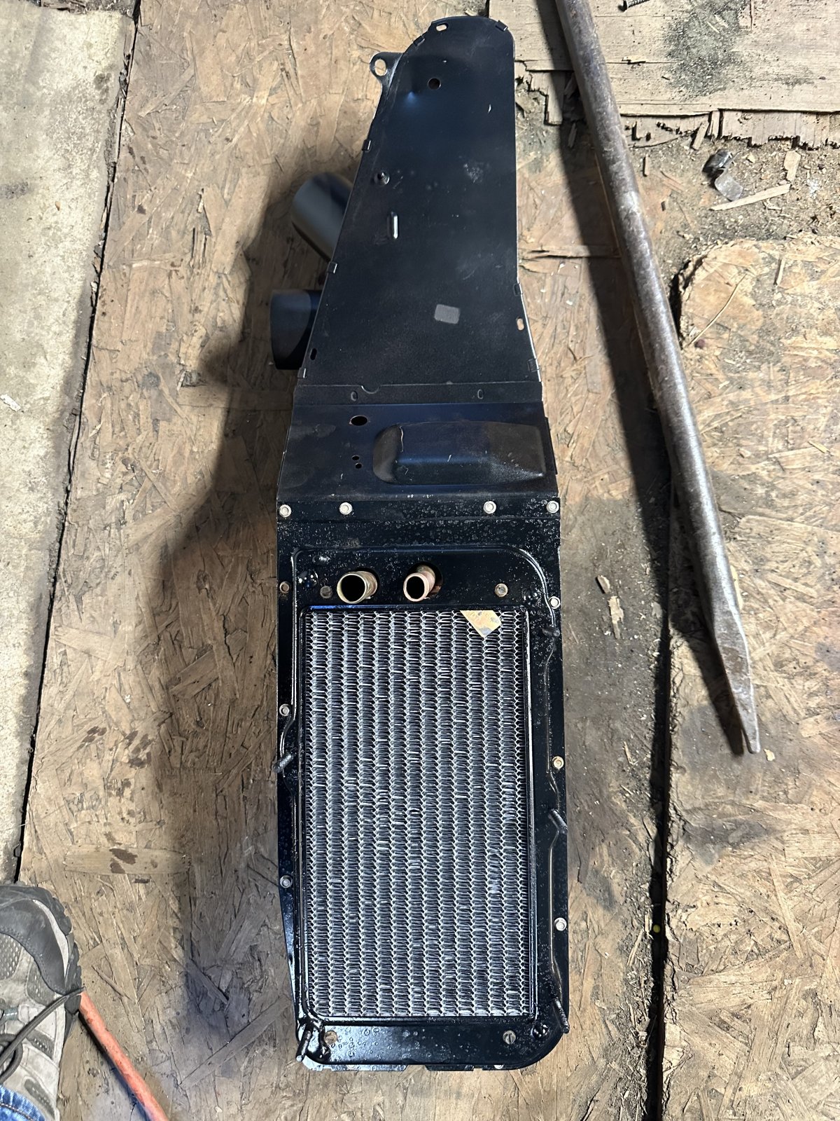

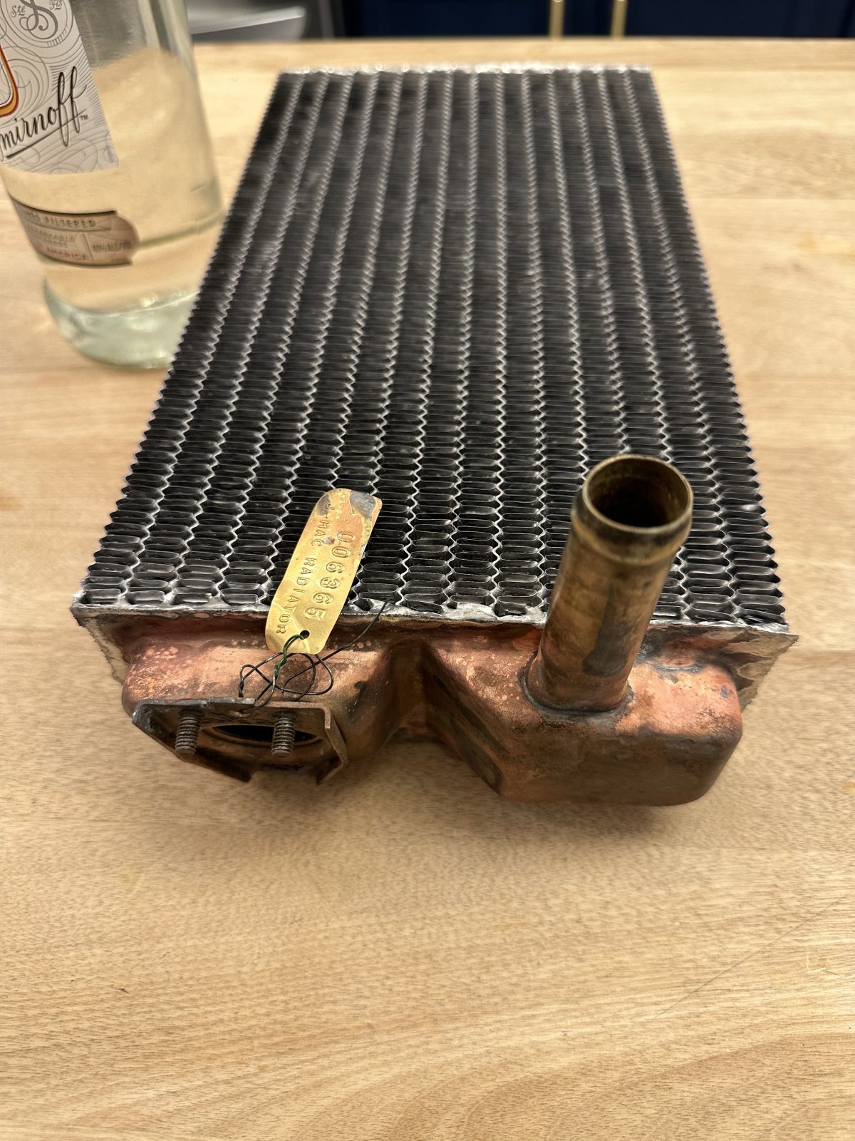

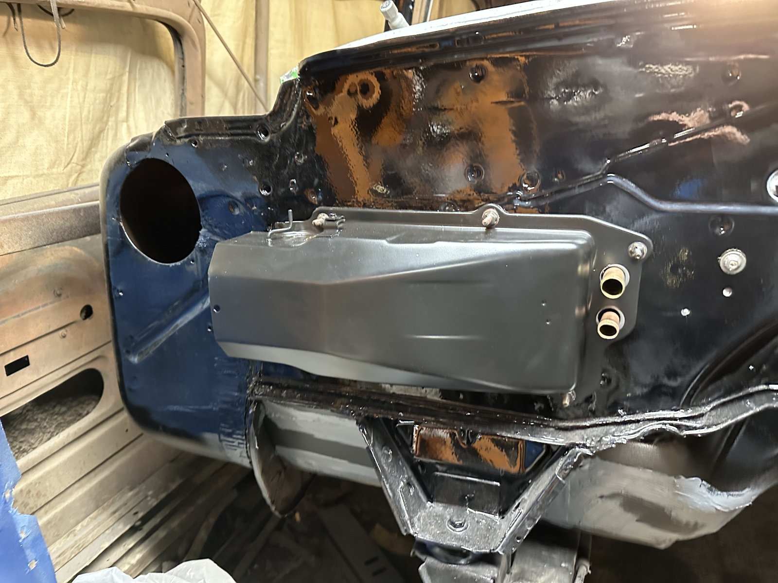

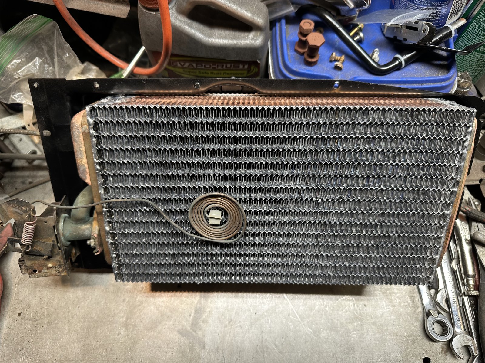

    I sent it to Oregon, it came back to me from Utah. I mounted the valve.
    And ***embled the heater box.

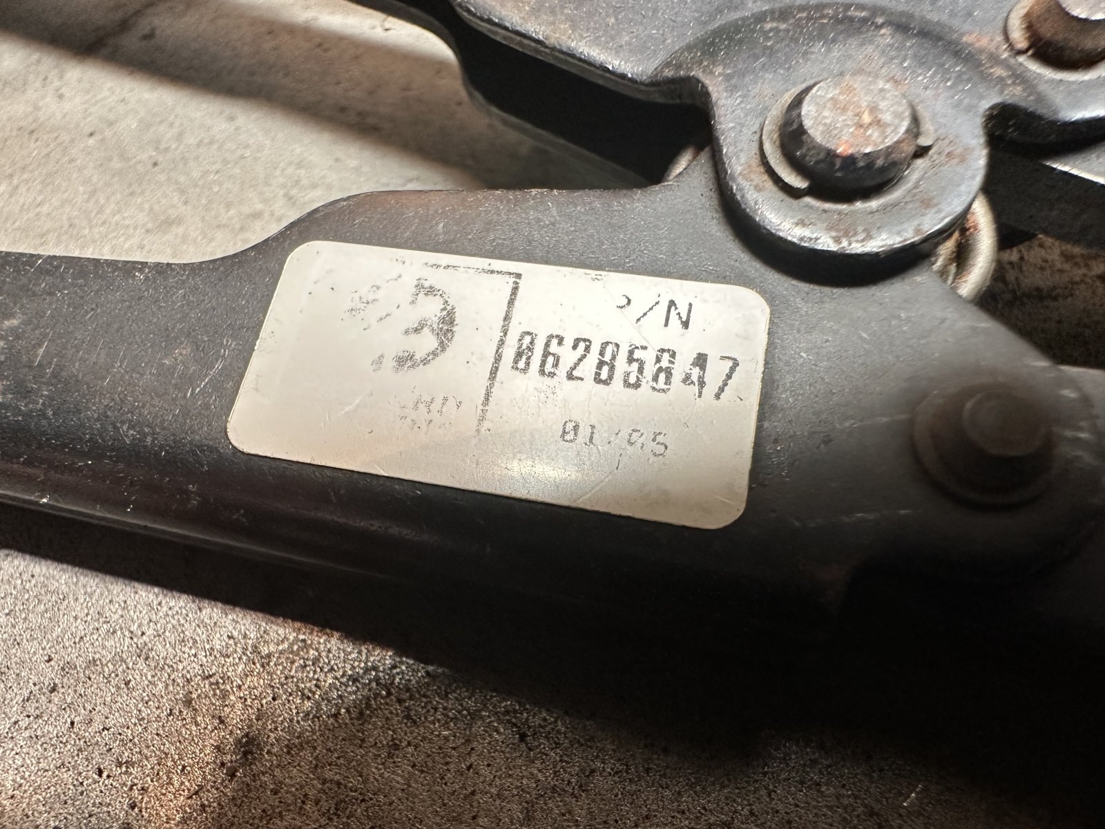

    Part numbers for the seals. They were actually kinda hard to track down. Several companies have their cabin side seal labeled engine side. The only engine side seal I could find came from a Chevelle place in Canada.
    Someone had sprayed right over the dirt on this one, so I took it down to bare metal.
    Sprayed and mounted.

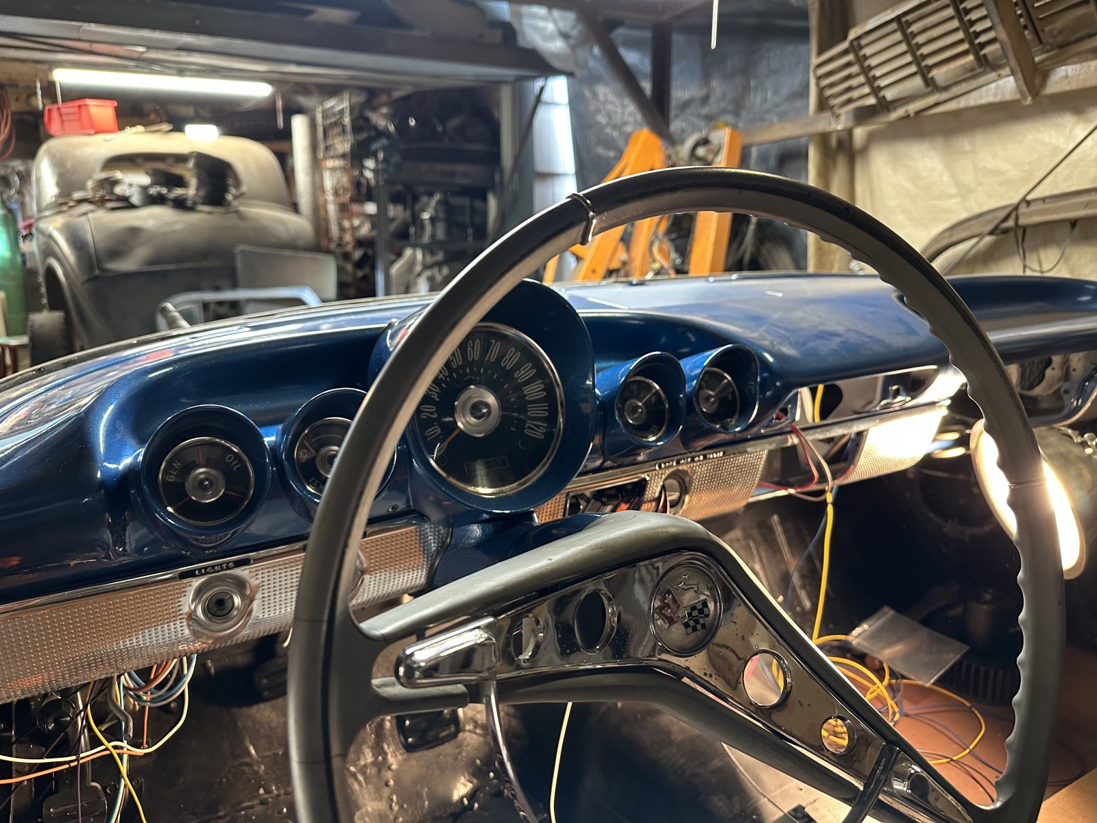

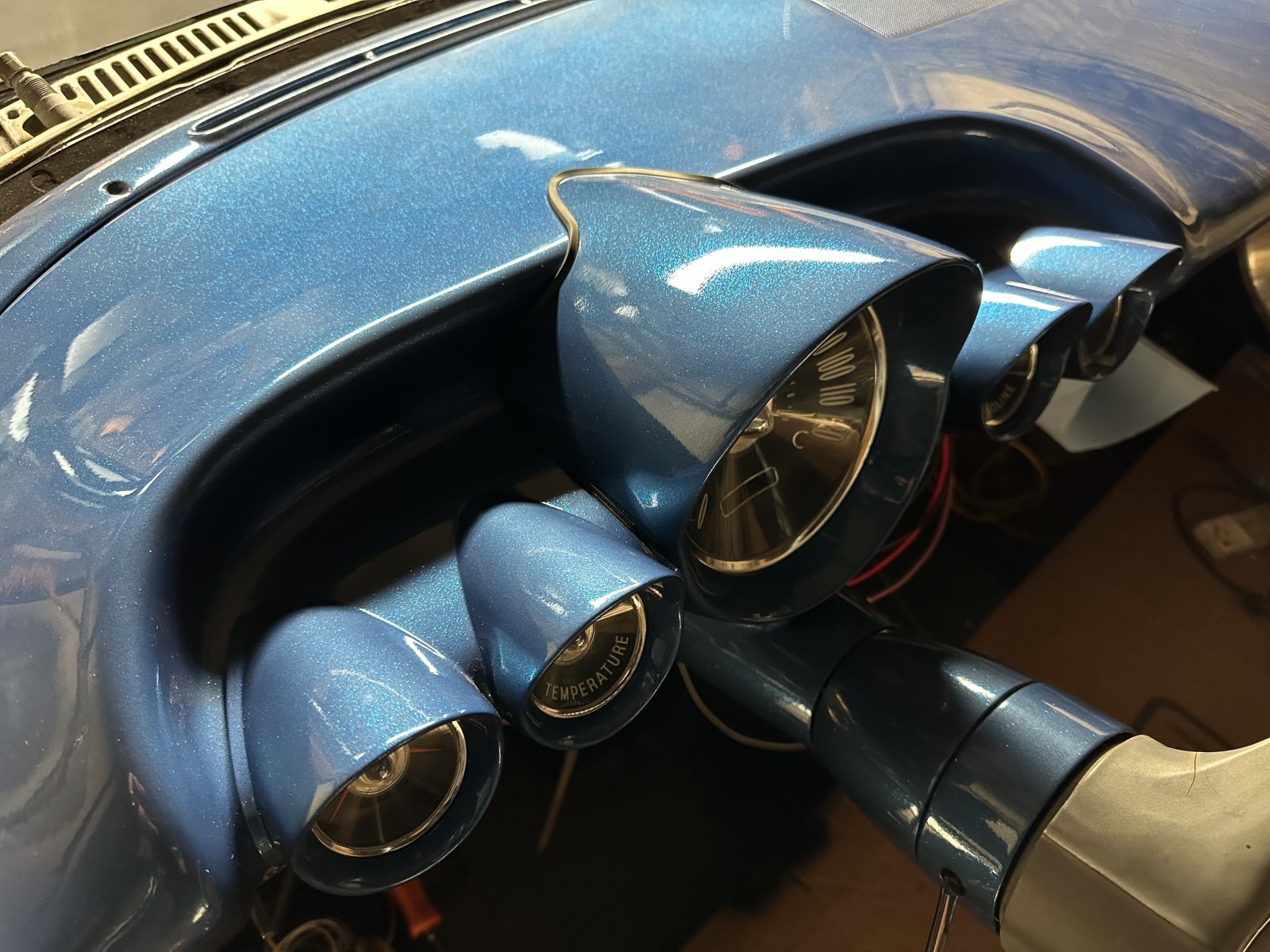

    I’ve been collecting dashboard jewelry. OG tach, NOS gauge panel, new Volt, Oil, and Temp. I still need to find a tach cup.
    I hope I can be as cool as this guy now that I have this gauge panel.

    I’ve been doing a lot of little stuff with the dash and the wiring. A lot of it has come together. I still need to sort the parking brake warning light, glove box light, and wipers. It’s got the wrong steering wheel on it for now.

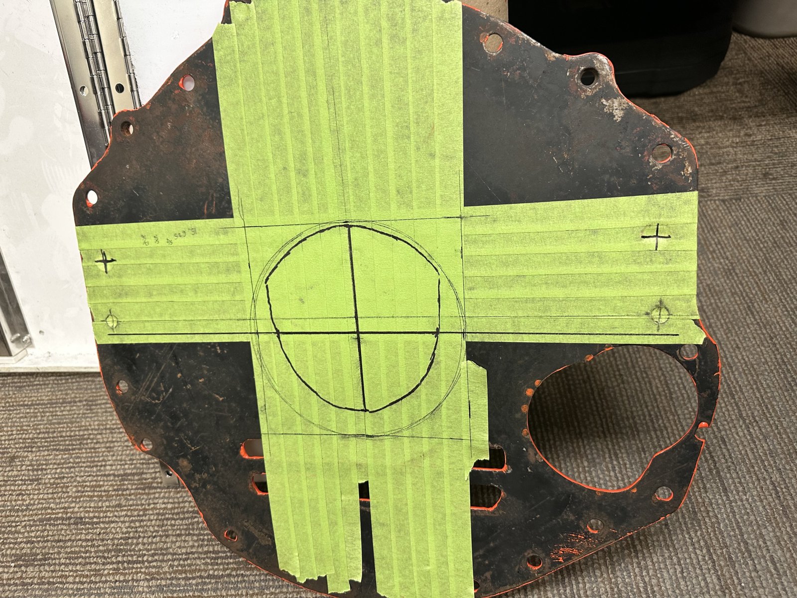

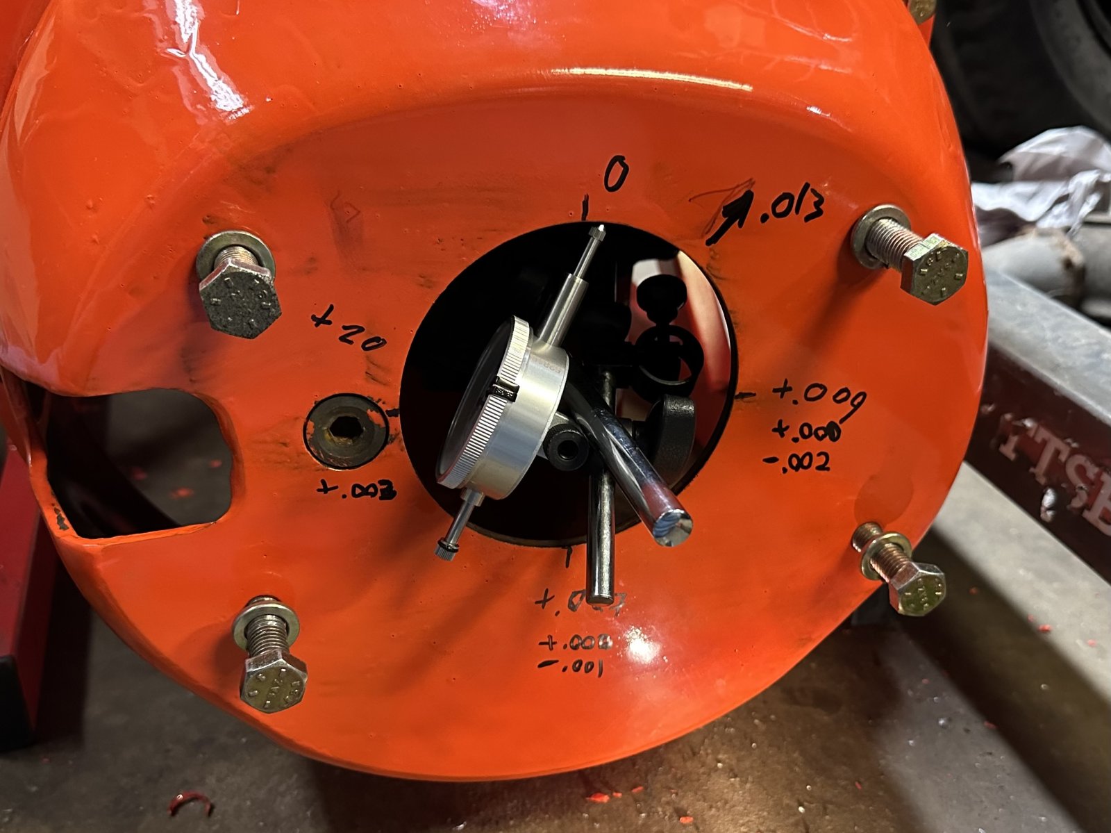

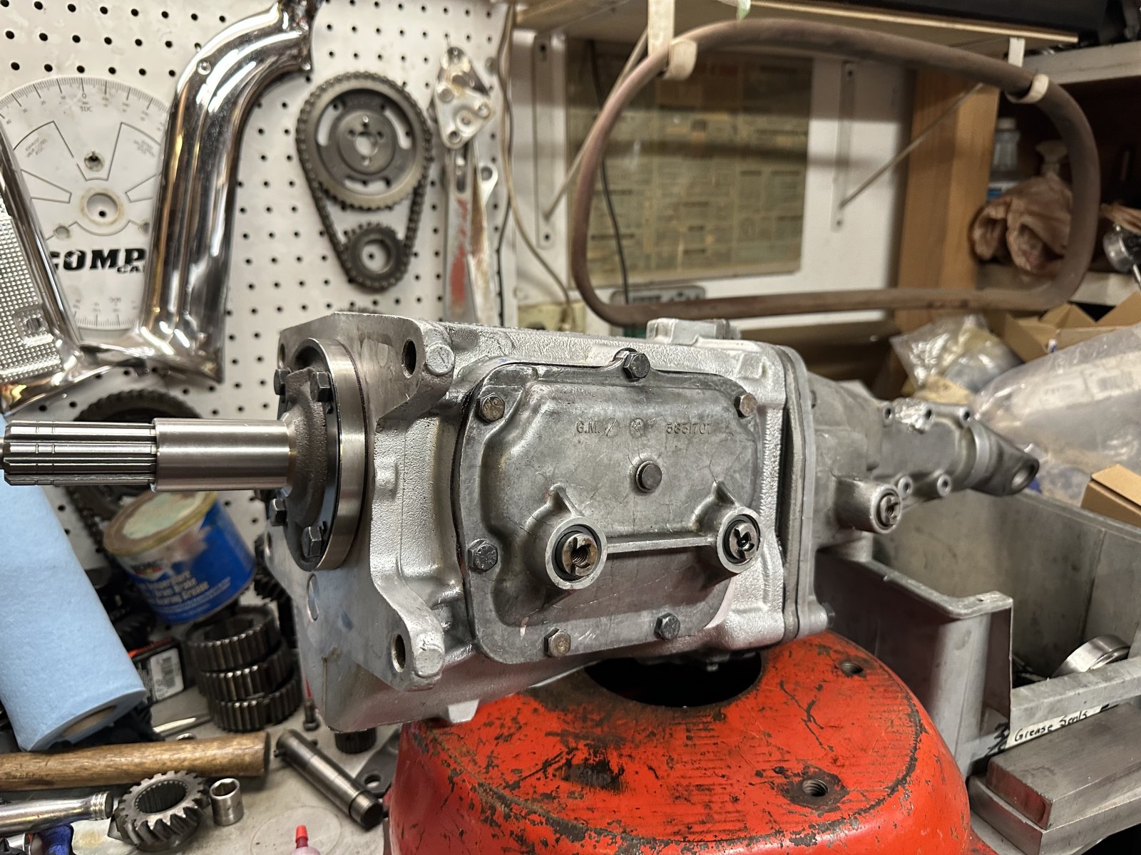

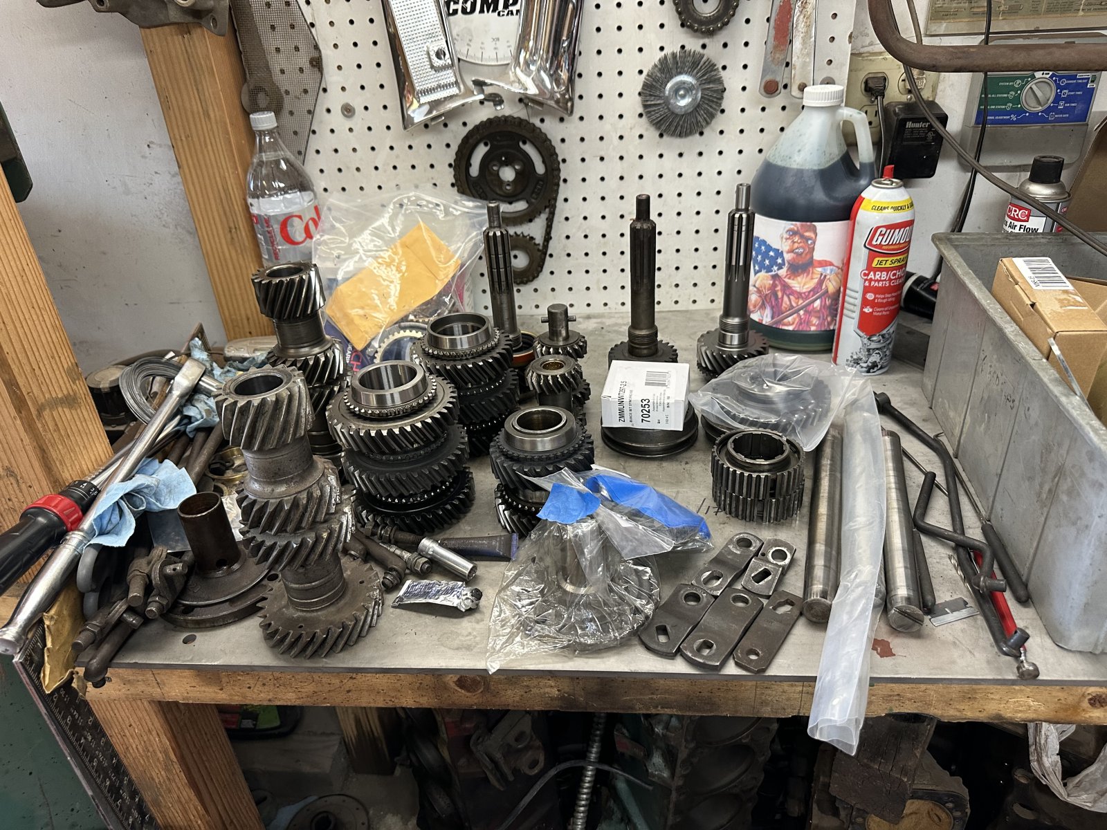

    I pulled the Muncie apart thinking it would need a kit and be good to go. It wound up needing everything. I reused the case, mainshaft, tailshaft housing, side cover, shift levers, and ***orted small things. A HAMB member helped me with some gears and I got some others new. It’s now got a nodular iron midplate, and a combination of new Asian and Italian and used gears. I know it isn’t best practices, but I’m on a pretty strict budget.
    The motor plate that came with one of my Lakewoods is an early one with a center hole that only seemed to fit small journal crank flanges. I needed to open it up for my flange. I took it to work to use the plasma, but my office mate suggested we feed it to the new laser instead.
    Cut, but not knocked out yet.
    I would have felt bad about cutting vintage parts, but someone had already cut the louvers.
    I indicated the hole in the Lakewood ****tershield itself, and it was off. I used Moroso .014 offset pins and got it within .005.
    All set to start ***embling the clutch. I was trying to get the motor in tomorrow, but unfortunately I have the wrong clutch fork. I could cobble together the linkage, but I think I’ll wait for the right part so that it’s all easy to service in the future with off the shelf stuff. Family stuff is about to get really busy so I probably won’t get another chance until July. It’s kind of a bummer.
    I’ve also been playing with wheel ideas. The car is going to be pretty low and my slots don’t feel right. New Supremes have gotten expensive and they don’t turn up used around here, so they won’t happen in the near future. I’ve got most of a set of Appliances stamped steel cragar things, and most of a set of 14x6 409/wagon wheels. I might run those with spiders or baby moons or something.

    That dash is gorgeous, that blue with Impala trim. Wheel is perfect too. Good call leaving the original gauges in, temp, clock etc. even if they don't work. They're too pretty to remove.
    Like the four gear and all the work that went into it, and it'll look great with any of the wheels you mentioned honestly. Really like the look of those real deal 61-63(??) 409/wagon wheels and the 58 dog dish caps. You'll figure it out, you have good taste.
    You can never go wrong with chrome reverse on a 60 chevy, just sayin.

    The Impala steering wheel looks great, but my wife gave me the metal flake moon wheel so I should use that. It’ll look good too. OEM style chrome reverse look great and I’d do those in a heart beat but I’m not sure I’d do smoothies. Finding a used set that isn’t trashed from rust pits up here is tricky and their new price is on par with Supremes. I’ve got a mix of 63 date code and 64 date code 409/wagon wheels and the earlier ones look so much better with that flat lip. I scooped em up because I’ve been gathering to do my 63 SS one of these days. I missed a $200 409 that would have been perfect for it last weekend. I’ll be kicking myself for a long time on that one. I’ve got that one 58 dog dish, but if I get serious I could chase up a set (or maybe 59 or 60, I’m not too picky)
    I keep plugging away. I’ve got 2 standard and 2 reverse 14x6 Appliance Steelspokes plus a 14x7 reverse. I’d probably run em if I could get a full set of reverse of either size. They might be a little late for the HAMB though and I wouldn’t want to rub the wheel police too wrong. I’m chasing a set of Rocket 5 spokes too, but it’s a kinda convoluted deal and might not work out.
