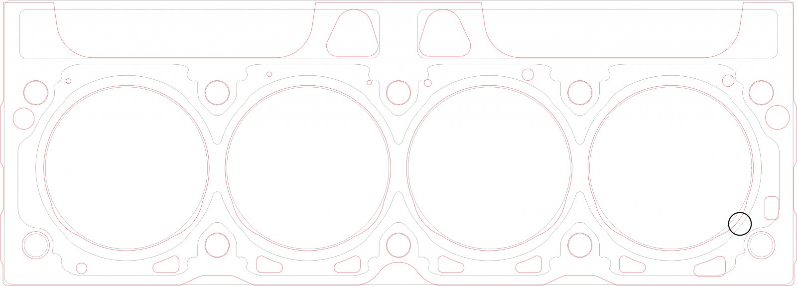

    If anyone has a profile of a rod or measurements they want modeled for clearance I will see if it works for you, the more we all know the better. The incl. picture is what measurements I need. just print it and fill it in with good caliper measurements send it to me and away we go. Like I said I am happy to build a model and see if it fits. I have to do the disclaimer thing though - and of course there is no guarantee expressed or implied. I would like a tracing of the rod too although most rods clear the bottom of the cylinders just fine.
    On head gaskets - if you look at the next picture you can see why these fail. The drawing in black is the deck and Cylinders, the red layer is the Mahle gasket from merc- marine. If you look at the area I circled you will see just how little gasket contacts the head and sleeve, where those pockets are its .090" to .100" that is all that is holding back something like 1700 PSI in normal operation, If you had knock I think it could work that gasket to death very quickly. I couldn't believe it and reminded me of those famous last words: "The engineer says its good"
    To answer Dennis in post 2864 The 3D cad I use does mechanical stuff great but is really not good with organic shapes
  5. The gasket you drew has an irregular, out of round, shape around the cylinders. Is it a used gasket ? I have removed used gaskets that look like that.
    If a new gasket is round and regular in its shape at the cylinders, a possible explanation for distortion in an in-service gasket might be due to the deck height being irregular. Could the gaskets be squirming out of shape?
    As engines heat up and expand the expansion will be more where the metal is hotter. Add to that the different rates of expansion of steel, aluminum and cast iron, the expansion gets complex. That steel connecting rods have half the expansion rate of aluminum saves those of us with zero decked engines.
    In some engines, there is a slit in the block between the cylinders, supposedly to allow otherwise trapped air bubbles to escape. It is another place where headgaskets blow out as sealing area there is limited.
    Randy identified the sealing surface between the water jacket and where the pushrods operate as a problem area for water leaks. The aluminum there is narrow.
  6. Sean Lougheed
    Joined: Dec 26, 2021
    Posts: 40
    Sean Lougheed
    from Canada
    Hi Dennis,
    It is a brand new Mahle gasket out of the 470 "kit" I got. Those notches would never be an issue on an iron decked 460, but with the free standing liners in the 470 look to be problematic to me. I am pretty sure this is just a 460 gasket as I doubt Mahle or anyone else would make a special one for the 470.
    I would think that having part of the gasket less exposed to the combustion would be more problematic than a round one that can expand equally all the way around, although in both cases the heat would probably go to the liner or head PDQ. I am curious what the notches are really there for? They are on the valve side but there is miles of room - the valves are well inside the cylinder area and these notches (and part of the cylinder) are all covered with the stock head. Anyhow, this notch thing is something to be aware of when putting one back together.[/QUOTE]

  8. Flatrod17
    Joined: Apr 25, 2017
    Posts: 693
    Flatrod17
    My bore is 4.390 and I used a Cometic 4.400 gasket. If you used the same, that is only .020 over your bore, I don't think that would be a problem.
  9. Sean,
    The composition gaskets which had sealant beads matching the water jacket were, I believe for Mercruisers because when the 3.7 has sealing issues, Randy Dupree wrote that the problem area was between the water jacket and the chamber where the pushrods run up and down. Check the flatness of your deck. It is better quite flat even when the gaskets are the forgiving composition ones.
    The metal gaskets are more "fussy" about the surface and that may be why sealant is added on them.
    Sealing the cylinders is usually ok, but if there is detonation, a much greater load is on the gaskets at the cylinders. It seems that a round opening in the gasket is a better match for a round cylinder. If a removed gasket is distorted around the cylinders, I would guess that it was due to an uneveness in the gasket, the deck or the torque. The gasket may be required to distort to seal an uneven place. That the casting around the liners is usually not even in width and may play a role in this.
    [edit: I had not read sufficently carefully what Sean wrote. My reply would not apply to his carefully worded question. So I wrote the next post, 2980.
  10. Sean, I read your post again, this time more carefully, and looked at your illustration. The deviations from round that you show on your gasket would seem to be less than ideal considering the limited sealing area available on a Mercruiser 3.7 block. I suggest calling Mahle tech suport 1-800-223-9152 about this concern. I just checked several gaskets. New ones from Mahle have the odd deviations in them but the others (also new but made by Felpro and Sierra) are perfectly round. It strikes me as odd and yes , as you wrote, the out of roundness would not matter on a closed deck Ford 460...but on our open deck engines it may indeed matter.

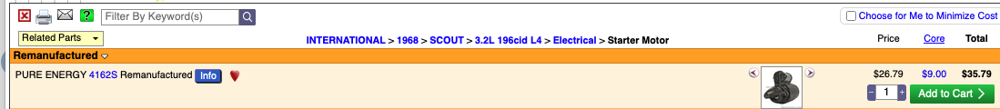

  19. arse_sidewards
    Joined: Oct 12, 2021
    Posts: 343
    arse_sidewards
    from Central MA
    The only PMGR starters I can find are $200+ and DB electrical doesn't list a model on their website anymore. I'm probably going to go with a traditional starter for $50ish. DB electrical doesn't even list IH
    The weight reduction would be nice but not +$150 and the inconvenience of using a less available service component nice.
  20. The starter shown in post 2989 is not an open snout starter but it worked for me after I cut a hole in the bellhousing see post 276. The snout on it is narrow compared the other starters.
    One that I used for several years looks like that an is strong enough to split a cylinder end to end.( mine did that)
    My narrow snout starter turns the engine over faster than the smaller geared one from db electric. the price is great. I'm pleased to see that you are not just standing back and throwing money at it.
  21. I tried the DB Electrical website and found it useless.
    I suggest contacting them by phone to see if they still sell what you need.
    LiPO4 batteries put out over 14 volts. So they will work better than a lead acid battery which gives around 12 volts ( the glass matt lead acid batteries put out a little more)

    Sean, I just got off the phone with Mahle. Their tech support is excellent. He checked blueprints of the headgaskets, all they had were from the 1980's and the "notches" are not on them. I sent him your excellent drawing and it compares well with gaskets in my hand.
    He said that this is the first report of the headgasket notch concern and naturally he is quite interested in it. The notches do not show up on mahle gasket drawings....something strange there.
    He asked if the mark from the gasket on the tops of the cylinders show an adequate fit. I surface all of my decks so I could not reply on that one. We agreed that any leak around the cylinder will quickly erode the cylinder.
    He wants to know if we encounter any problems with the gasket.

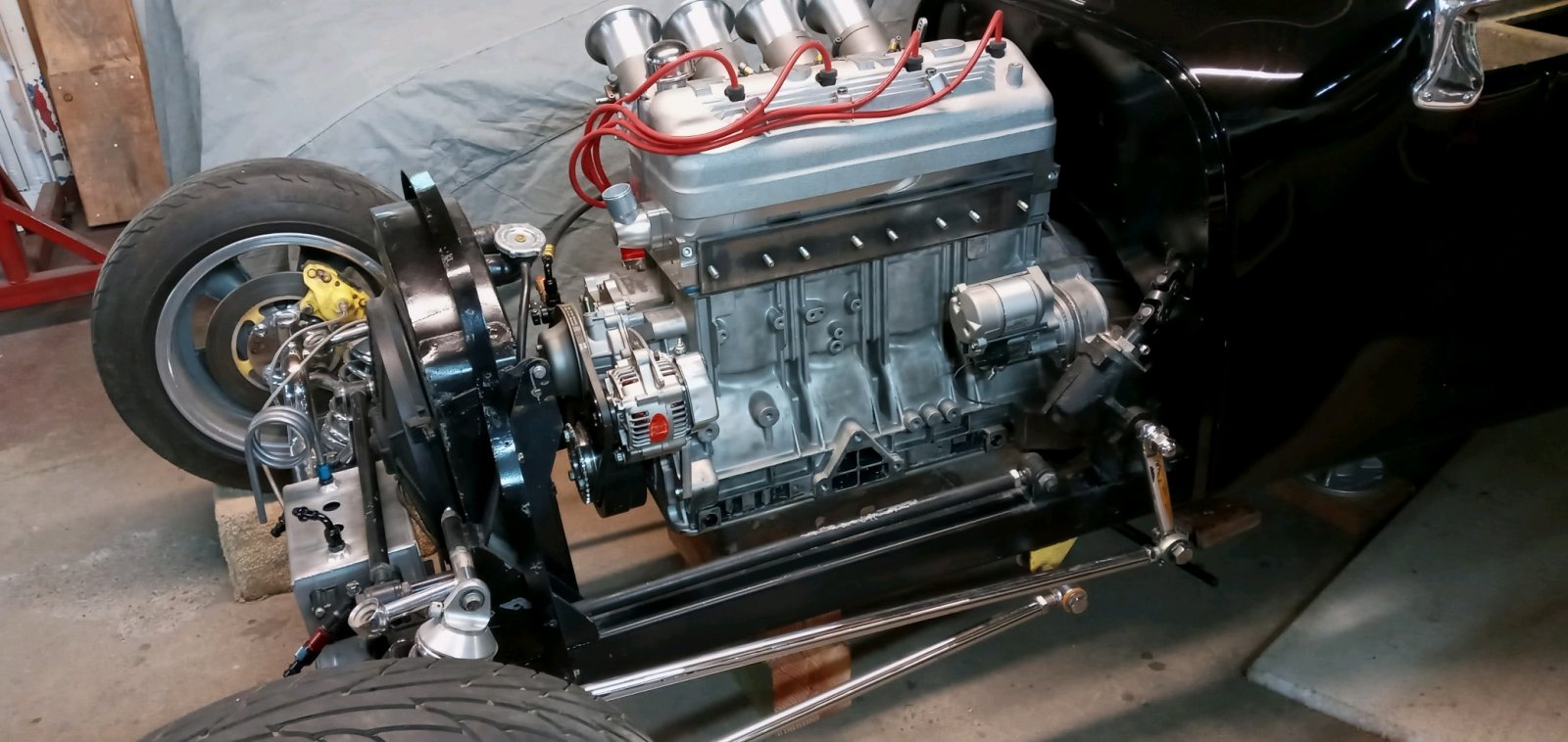

  29. Flatrod17
    Posts: 693
    Flatrod17
    dennis g and Calkins like this.
  30. 1bigun:
    I normally buy Mercruiser engines for $100. As parts, they are worth much more than that.
    They can be rebored. Most rebores are 30 thousandths over as that is the commonly available size. Sometimes you see engines which are 60 over but I think, at that point, their best use is for a coffee table base like on Top Gear..
    mid 80's Mustang pressure plates bolt right onto the older Mercruiser flywheels.
    It makes an outstanding street rod engine.
    1biggun likes this.
