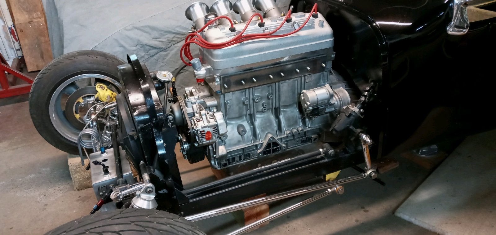

    1biggun, I have 4 of the 3.7 engines now, but this summer I picked up 5, 3.0 engines for $100. I only wanted one, but he made me deal I could not refuse! The 181 is a baby compared to the 3.7!
    I will admit my engine is on the wilder side with the Boss head and mechanical injector, but its just .030 over bore. I did stroke the crank to 4". With my Ford trans (T5Z) and chevy bell I had to drill the crank for pilot bearing, no other work for me. Others say cut the block, but don't do it till you at least check to see if you need to.

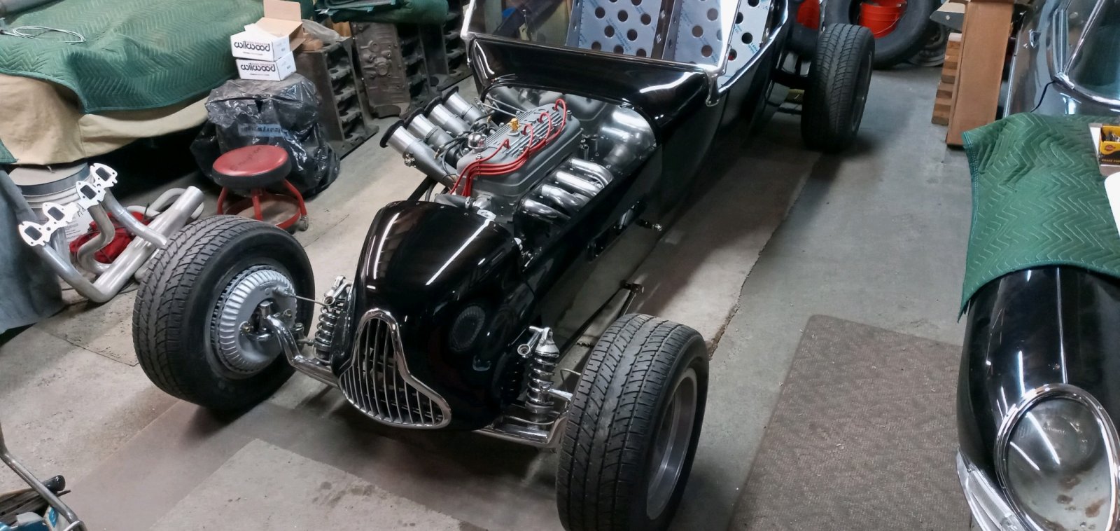

    1biggun, forget the bbc head, buy a real head and make one of these!! lol Track T is what I have! trackt12.jpg

    It's is the shorter input. It is what the Z trans came with. It is what I was told is the Muncie GM case. Only differences are some reverse shift springs and lever. It did not come up short, the input is in the bearing I machine the crank for by 1/2".
    I have since come up with a aftermarket bellhousing that is Chevy bell but Ford Trans pattern. I think it was for a jeep. That bellhousing is deeper than the regular Chevy housing I used. It may be for the longer ford input. It may work with the 94 the newer Ford trans. This stuff is all over the place and needs to mocked up to see what is needed.
    I had mine mocked up with a T56 6 speed, a Muncie 4 speed and the Z trans. None of them needed anything special other then machining for a polit bearing.

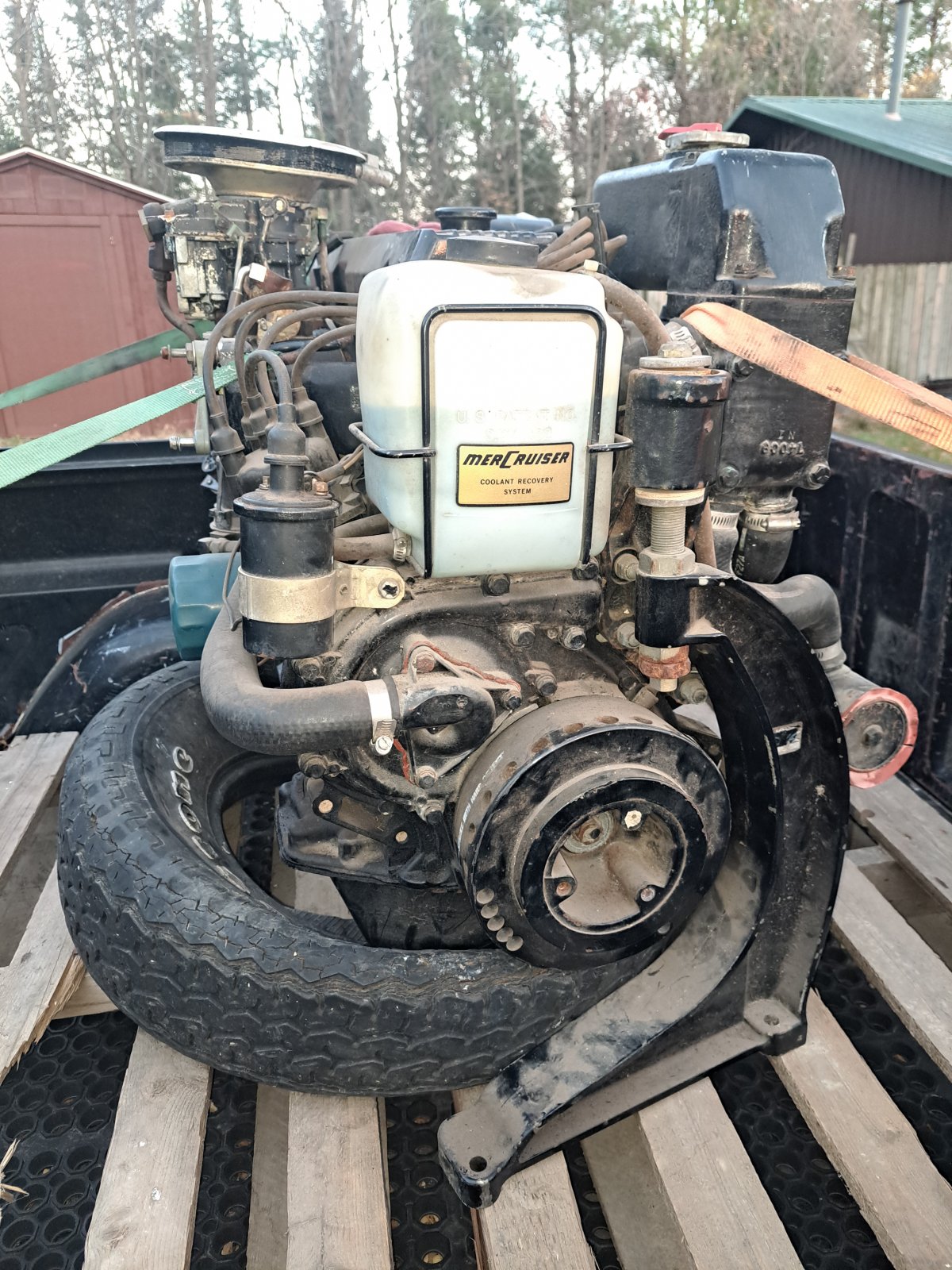

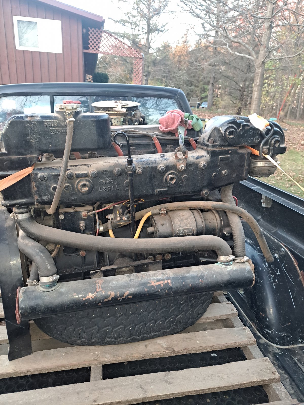

    Picked up 470.
    Never seen one before . It's BIG .
    Much bigger than I expected.
    Kid had it was in his grandfather's barn .
    Said it turns over no compression on two cylinders. Thinks it got moisture in it from years of storage. On the cylindets with open valves Supposedly was good when removed. Not susposed to be a head gasket failure .
    Pully on damper, flywheel is pretty thin but drilled for what looks to be a pressure plate pattern .
    Big heavy starter. Ring gear pretty worn in spots .
    2bbl manifold and carb :(
    I'll pull the head hopefully soon .
    Hope the cylinders are good enough to bore .030.
    Interesting engine.
    $75 and 2 hours of driving can't really get hurt .
    Will definitely fill the gap between the firewall and radiator.

  26. From the photos, you have the ford flywheel so a ford pressure plate bolts on, just s****e the paint off the friction surface. Ford may be able to supply a ring gear for you to shrink on.
    Your "dampener" is the alternator rotor. It has no elastomer in it but may work as its weight is needed. Its magnets sometimes fall out. Aftermarket dampeners bolt on and have timing marks that will be helpful. You can sell the alternator windings for much more the your engine cost. The heat exchanger can be sold as for you, its only use was to keep sea water out of the engine, has been fulfilled so you have no further use for it.
    It makes the chevy 4's look dainty. At a racetrack, the crew for a chevy 4 car saw my engine and panicked and tried to disqualfy me. You have begun an adventure.
