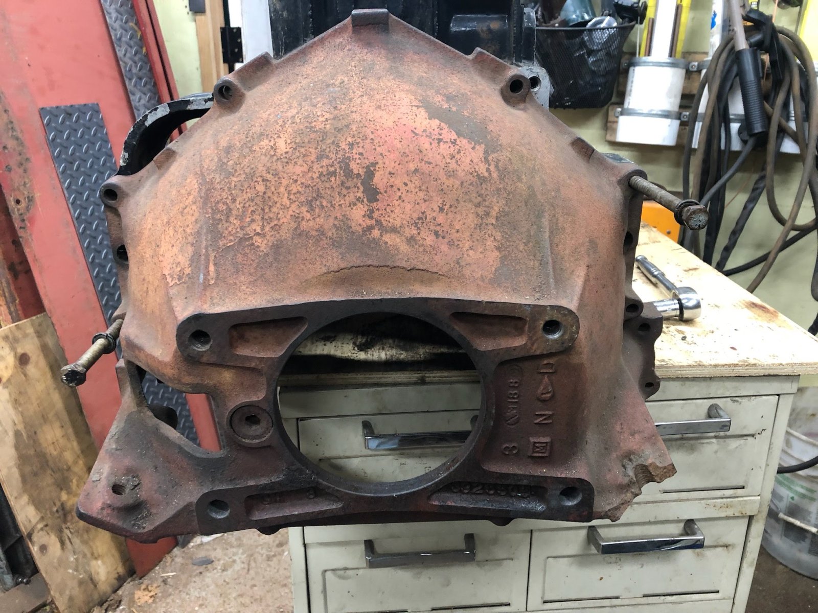

  14. GearheadsQCE
    Joined: Mar 23, 2011
    Posts: 3,670
    GearheadsQCE
    Alliance Vendor
    @****_sidewards,
    I knew that was going to piss you off. Sorry!
    As to the bellhousing, that is Mercruiser's pattern. The general consensus is to just ignore that hole. I am planning on using a block plate and will include that one and tap a hole for the bellhousing bolt in the plate.

  15. drtrcrV-8
    Joined: Jan 6, 2013
    Posts: 1,806
    drtrcrV-8
    As to that hole, if you were to use a "Lakewood-style" steel bellhousing it is a simple matter to remove/relocate/weld the tab on the bellhousing to line-up with the block. I've been told (unable to verify, sorry ) that the block bolt pattern is for a six-cyl Chevy, & that's why the location is different. Another benefit of using a "Lakewood-style" housing is that it is much easier to modify (relocate) the starter mounting location to accommodate the MerCruiser starter mounting, as steel is much easier to cut & weld than cast iron or aluminum (Duh!!) LOL!
  16. arse_sidewards
    Joined: Oct 12, 2021
    Posts: 344
    arse_sidewards
    from Central MA
    I'm going to fix the hole because I already have to go the whole pre/post heat process for my patch over the starter area.

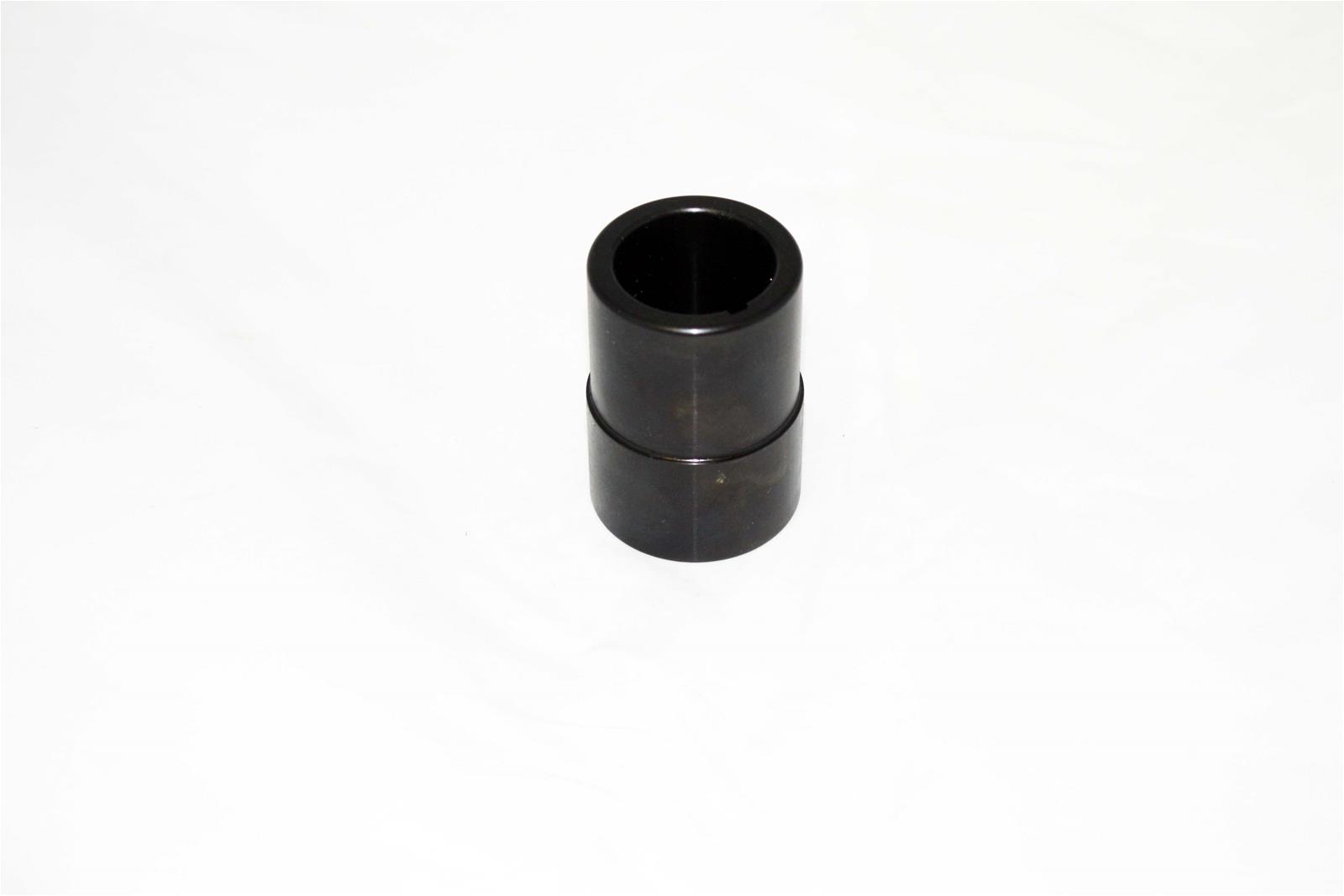

    Has anyone actually tried using a BBF balancer on one of these?
    Speedmaster has the high dollar fluid balancers on sale for ~$100 through tonight.
    I ***ume there's some interference between something since the SBF balancer is offset further forward than the BBF balancer but I'm wondering if it's a solveable amount of interference.
    The bore is the same between the two (1.375).
    The seal diameter is different (2.100 for the 385 vs 1.875 for the Windsor)
    Charles Easter likes this.
  26. AccurateMike
    Joined: Sep 14, 2020
    Posts: 785
    AccurateMike
    Not like I know, but...
    Balancer spacer make up the difference? I just remember them being a BBF thing. Mike
  27. CNC-Dude
    Joined: Nov 23, 2007
    Posts: 1,043
    CNC-Dude
    The difference in seal diameters is going to be the biggest challenge. Any difference in offset should be an easy fix...
