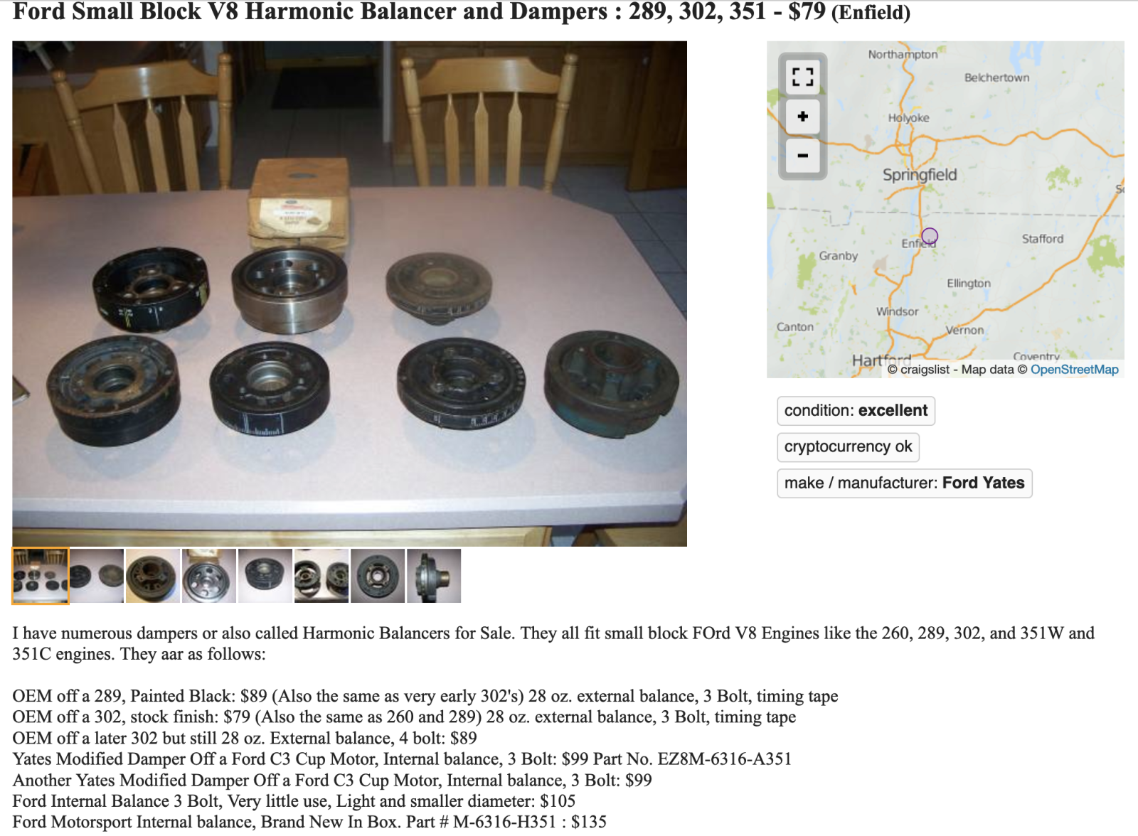

    I'm thinking of buying one of the C3 dampers this guy has for sale since they're cheaper than any new aftermarket dampers but I'm not 100% sure it will work. Has anyone actually put an SBF damper on one of these engines. Lots of talk over the last 100 pages but no pics...
    I've never used a fancypants aftermarket race damper on anything but it seems like those are my only option for an internally balanced SBF damper. Do these dampers use some sort of common crank pulley?

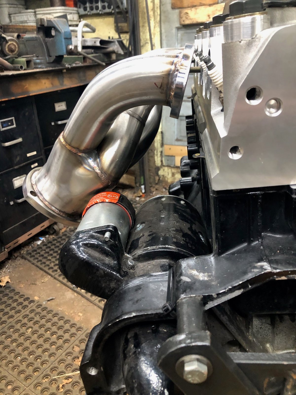

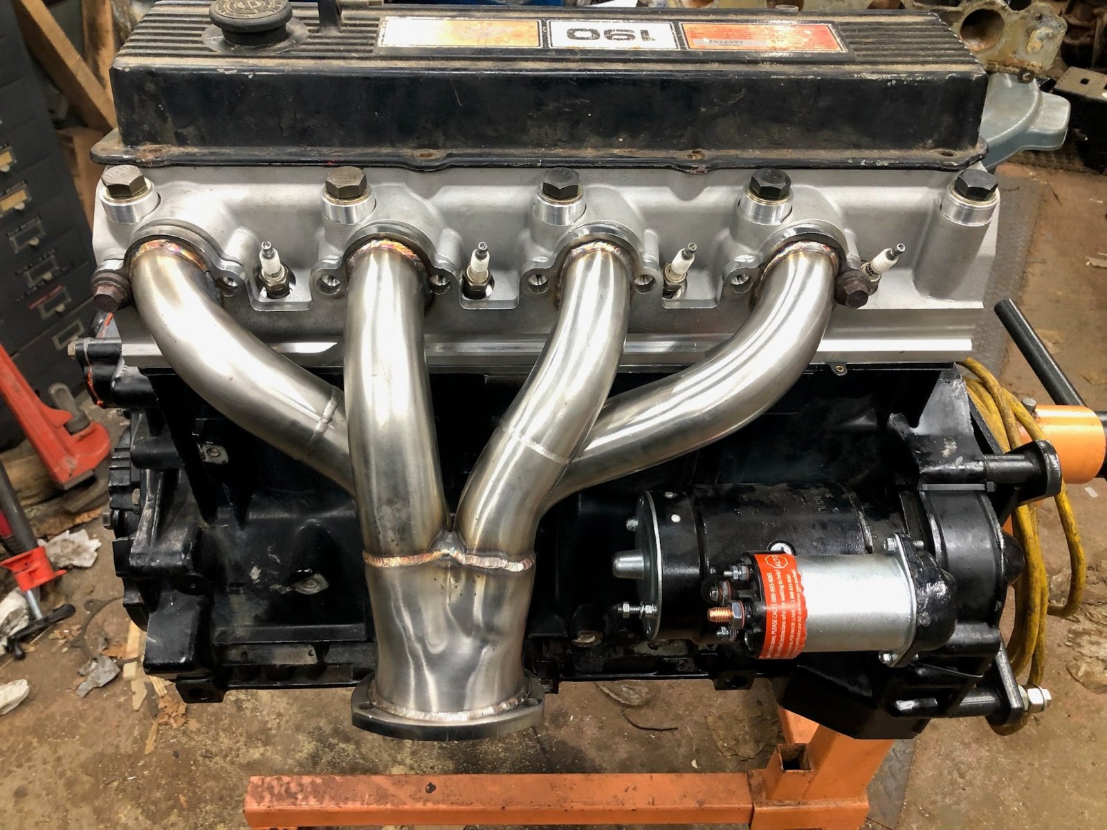

    Of the pair of "cheapest stainless shorty headers money can buy" that I bought the driver's side (as installed on a typical V8) has comical amount of interference with the solenoid. This would probably be a non-issue on a PMGR starter and definitely a non-issue on a clockable one but I don't really want to constrain myself to using those.
    It's sitting on the solenoid in those pictures.
    If anyone running a small starter thinks they can use this it's yours for little more than the cost of shipping.

    I was going to use a aluminum innovators west small block damper, but read I should keep the weight, so I had a old nos motorsports neutral balance 351w damper so I went with that. I had a 69 FE lower pulley that would of worked but I ended up making a new lower pulley. Any small block damper you use will have to be neutral balanced.

    The p*** side header fit just fine though. The starter goes in like a hotdog down a hallway. From the crank center-line to the edge of the collector flange is 14" or thereabouts which is a consideration...

    I made my header for mine. Collector cost the most to make it. This is the best I have of my damper that I have. header4.jpg
