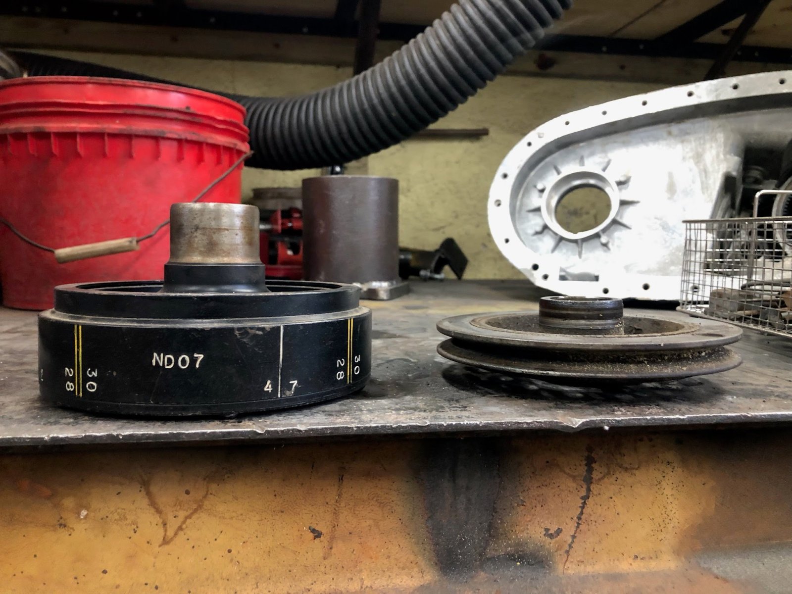

  19. arse_sidewards
    Joined: Oct 12, 2021
    Posts: 344
    arse_sidewards
    from Central MA
    I tried because I have a bunch around. The damper isn't offset enough relative to the keyed hub to come anywhere near close to clearing the timing cover. It simply won't work.
    I bought a Ford Performance neutral balance SBF damper from some guy in Connecticut who races professionally. The inside diameter steps down for some reason so it doesn't seat. I'm just gonna hit it with the boring head.

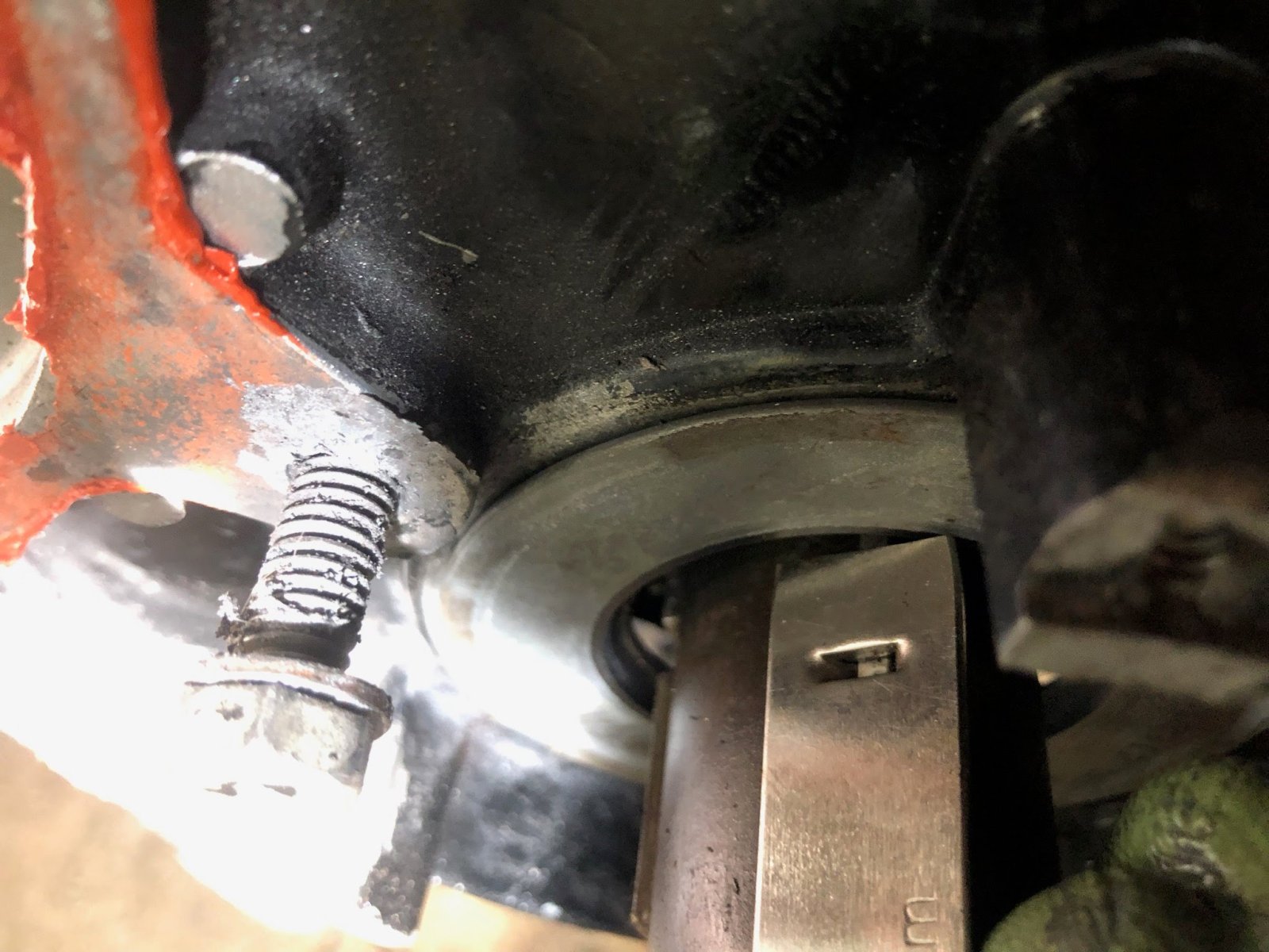

  20. The alternator stator has mounting bosses on the timing cover which have to be removed. Then a common aftermarket dampener fits. You don't need the mercruiser alternator and regulator as it can't supply enough power for a car.

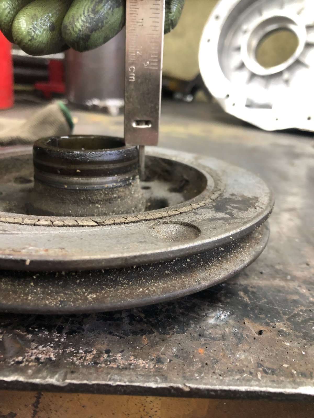

  21. arse_sidewards
    Posts: 344
    arse_sidewards
    from Central MA
    The 240/300 damper still won't fit. The keyed hub sticks out enough to fit the seal and bottom out on the timing sprocket without problem but the body interferes with the whole timing cover because it doesn't offset forward relative to the crank snout as far as the 302 one. You might clear the main face of the cover just barely but you'll still be well into the coolant area. That coolant bolt in the last picture is positioned to hit the internal hub, the rubber and the external hub of the damper and even if the bolt wasn't there the damper still has to go in far enough to hit the boss on the timing cover.
    Believe me, if it were doable I'd be doing it because as it stands I'll be cutting the firewall.
    The Ford FE uses the same ID/OD for the keyed hub. Someone who has one lying around should do a test fit.

  23. arse_sidewards
    Posts: 344
    arse_sidewards
    from Central MA
    It may. The 250 is a completely different family of engine.
  24. Seeing your photos, The balancer with a pulley for its rim will never fit. It somewhat resembles one used on the little 2.5 liter Mercruiser.
    I bought a Professional Products small block Ford balancer see post #267 in this thread it cost $67 from Speedway. It bolted in except for grinding away the protrusions from the front cover that held the alternator stator.
    iadr likes this.

  26. arse_sidewards
    Posts: 344
    arse_sidewards
    from Central MA
    That thinner balancer is off of a Ford 240. I know because it was installed on it before that picture was taken and went back onto it when I was done. I wasn't expecting it to fit but I originally test fit it weeks ago because I have all manner of 300s and 240s around and if it did fit that would be convenient.
    I know about the Professional Products SBF balancer (part #80006). It has been covered many times in this thread. While I could just buy it I'm probably going to bore out the 302/351M damper I already have since it fits other than a step inside the bore.
