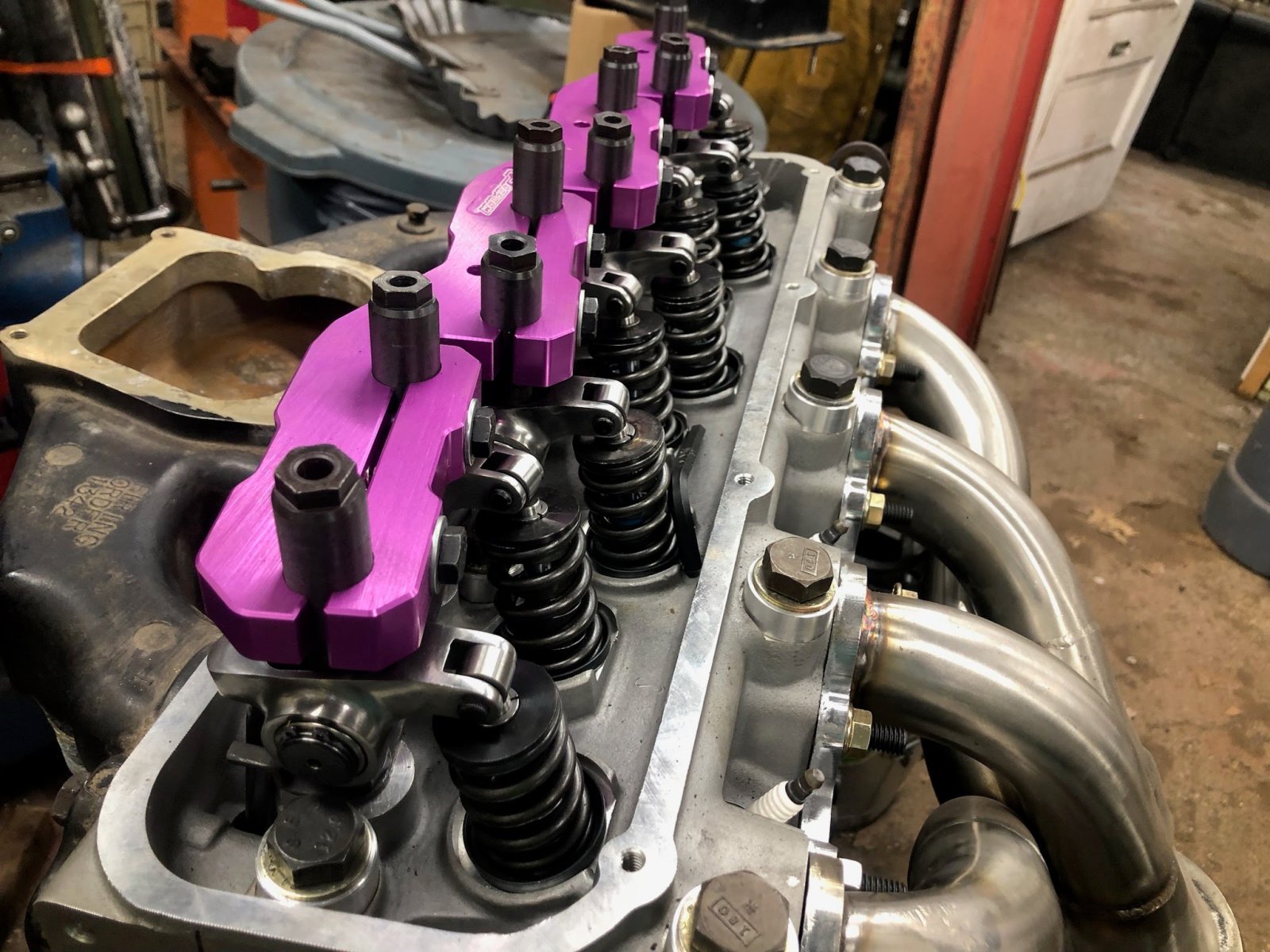

    I have a left over valve cover spacer somewhere around here. How tall of a spacer do you need if you could use it?
  3. He needs inches to cover those locking things and the stud girdles. It will help that the rockers are away from the top.

  4. Flatrod17
    Joined: Apr 25, 2017
    Posts: 698
    Flatrod17
    He is using a stud gridle. The spacer I have is .510 thick. Probably not tall enough. Its mate went on a 470 using a stock valve cover with roller rockers.

    Brazing up one with that thin steel bolted onto a spare head is easier than welding it unless the extra section is clecoed in place and you have a nice welder. My results would need Bondo not to look odd. Aluminum is expensive unless it is s****. Wood is cheap and the right size but can crack where it the spacer is end grain.

    the spacer I referenced is 1.4" thick plus a gasket height
