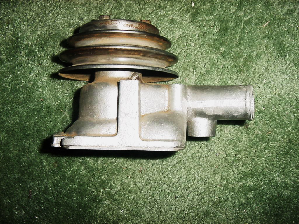

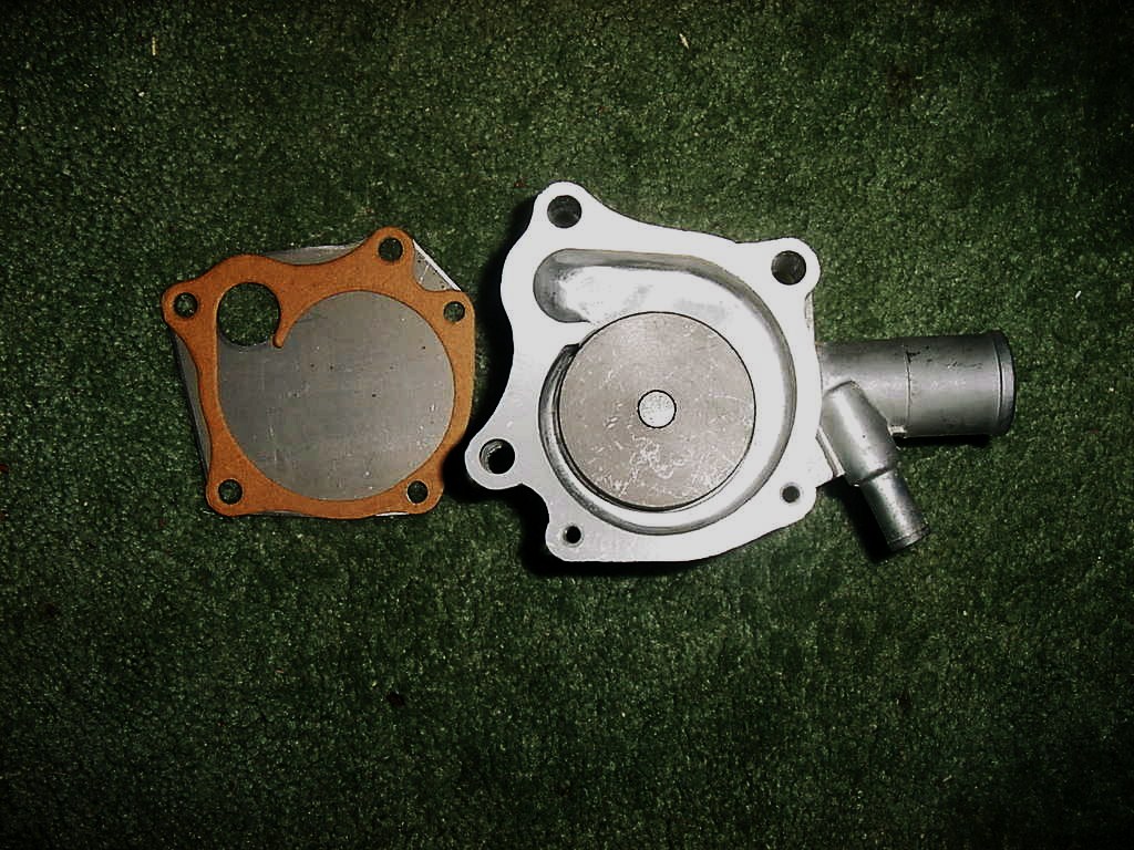

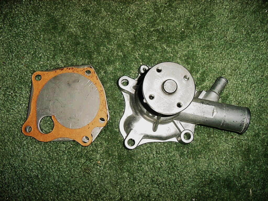

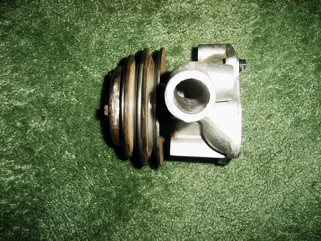

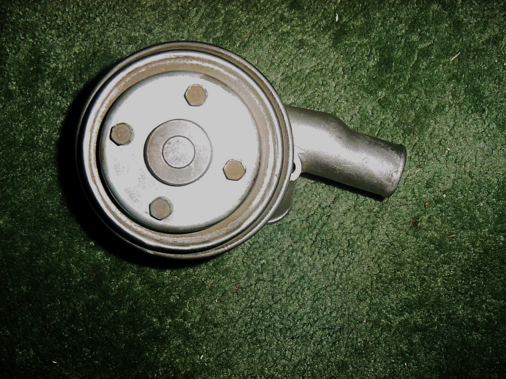

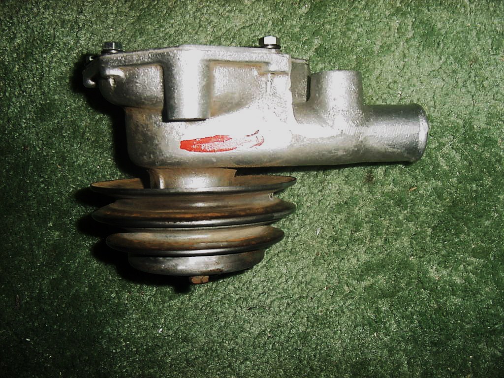

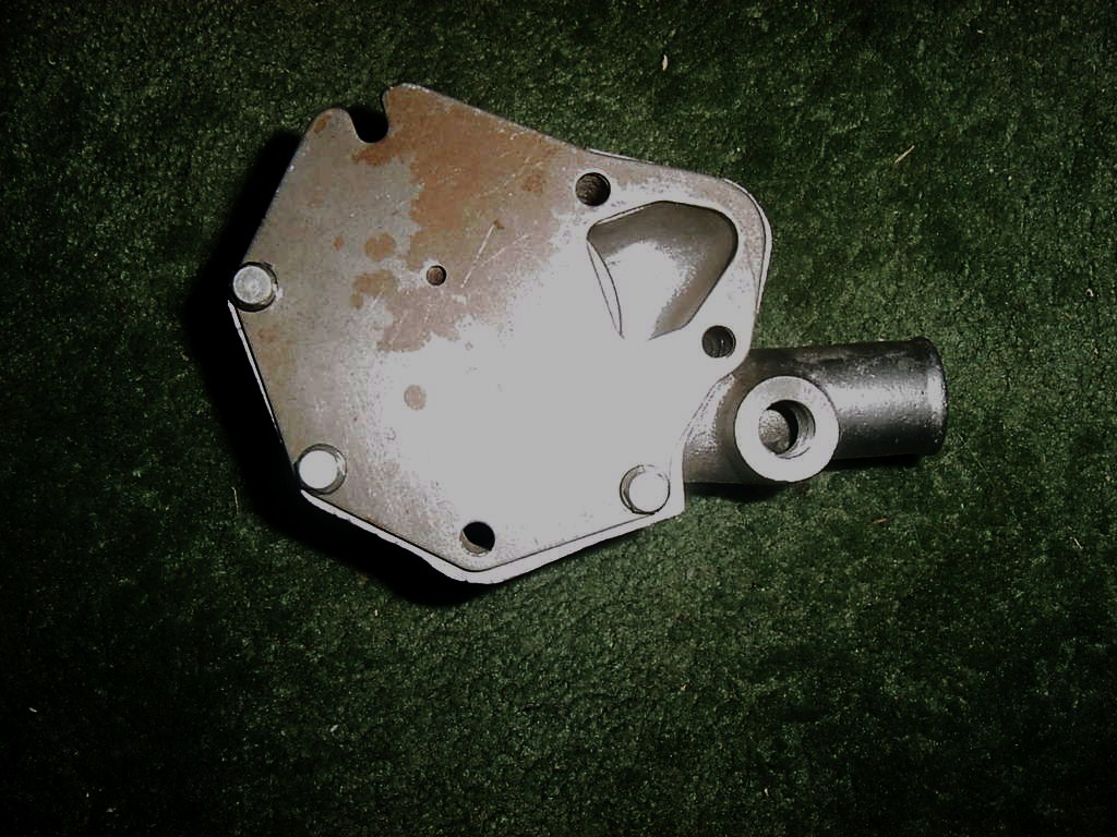

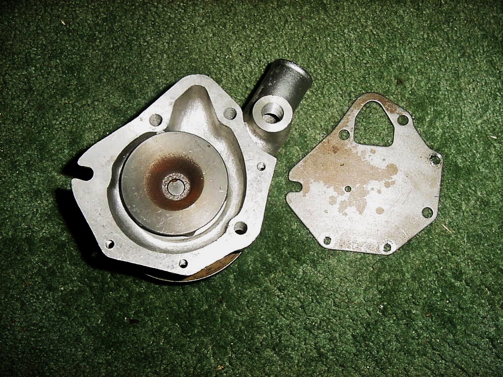

    Here are some pictures of the Toyota Corolla water pumps.
    The first set of pictures is of a 78-82 Toyota Corilla Statlet pump listed on ebay for $29.95 + $10.95 shipping.
    The second smaller one is a 71-74 Corolla pump listed on ebay for $24.99 free shipping.
    I will mount the smaller Corolla pump on a piece of 1/4" aluminum plate drilled for mounting and tapped for a pipe bib outlet.
    Either one will work equally well, I just like the smaller, less expensive one because it looks like it will be easier to mount.

    Mac,
    The 71-74 Toyota Corolla water pump would bolt onto a 4 1/2" by 4 1/2" square plate. The big tube would extend an additional 3 1/2" for a total width of 7" and the small diagonal tube extends about 1 1/2" out from the big tube.
    The pump measures 4 3/8ths" from the back of the original 1/8th" cover plate to the tip of the pulley mount. With a 1/4" aluminum mounting plate installed it would be 4 1/2".
    The larger pump for the 78-82 Toyota Starlet is about 1/2" larger in everu demension.
    I don't have a pulley yet for the smaller pump but I suspect that it will have a setback similar to the larger pump shown in the first photos.
    The pump is small however the internals are of close tolerance and should have enough flow to adequately cool most small engines.
    I always remember that the thermostat when fully open only has a 1" somewhat restricted opening.

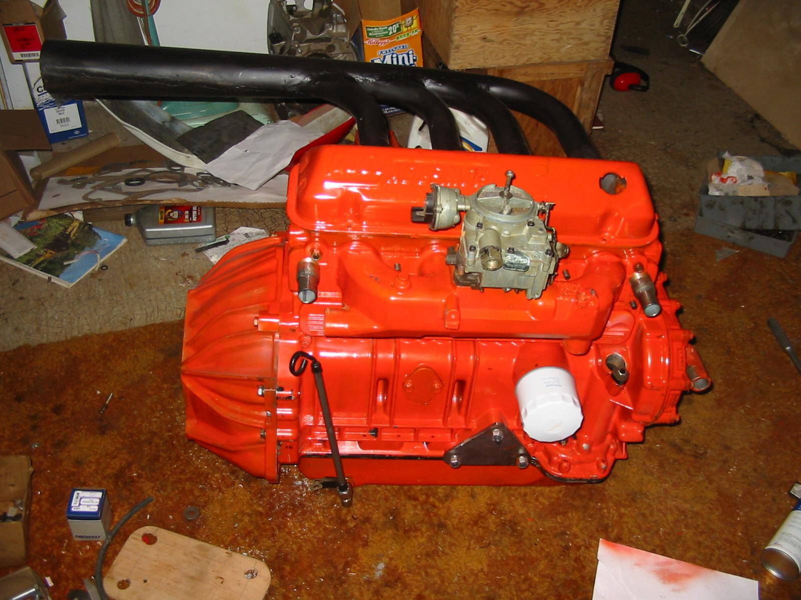

  13. I am ***embling my motor. Here are pictures showing it is close to stock.

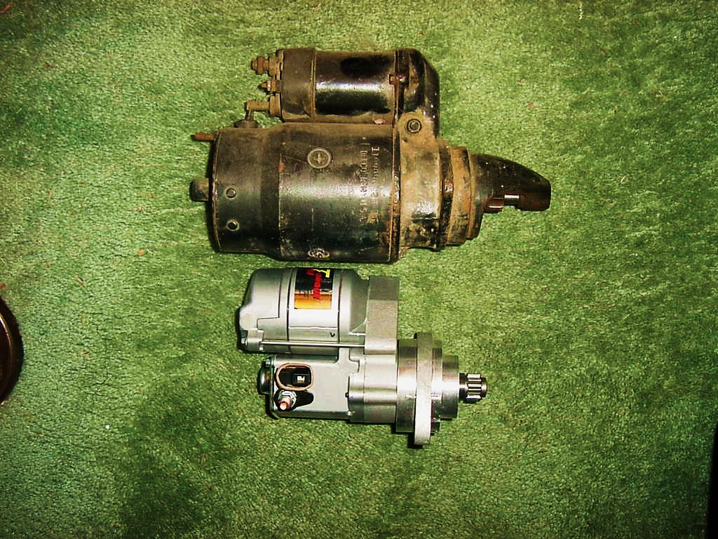

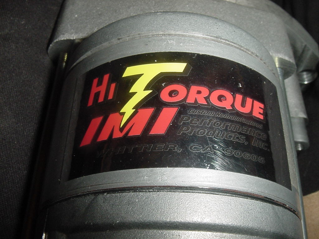

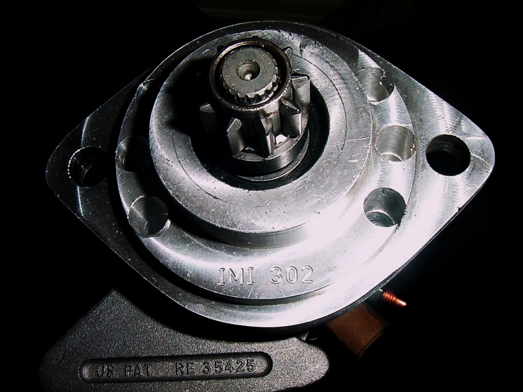

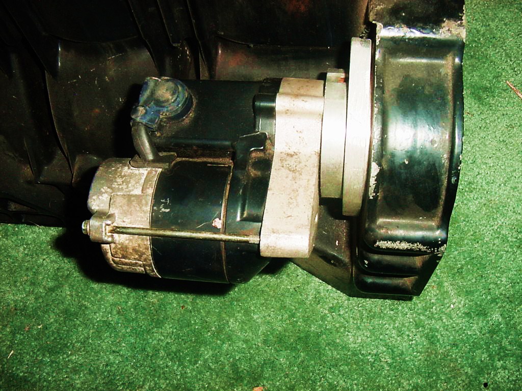

    I have a question about the starter you use. I tried for a while to find the modell, can you read the modellnumber and brand (ordernumber) for me I be happy. I have been on a long hollyday, but I see that you guys have not been lazy.
    / Johan
  16. dawford
    Joined: Apr 25, 2010
    Posts: 498
    dawford
    johan,
    The model number is IMI 302.
    See pictures below.
    I purchased 2 of them from Quality Power in Yucaipa, California about a year ago.
    They are listed on ebay 260402261233 at $235.00 including shipping to USA.
    They will probably charge you extra to ship to Sweeden.
    The one that is positioned on the engine is one that I originally bought on ebay listed as a Mercruiser 470 high torque starter.
    It is marked IMI 302B. They cost more because they are probably certified by the US Coast Guard as Marine starters.
    That first starter is what led me to research it's source and discover that it also fits an International Scout truck.
    They seem identical to the IMI 302 starter and have the same mounting, rotation and number of teeth.
    There are 6 advantages to the these starters. They are smaller, they weigh about 9lbs vs. 21lbs, they provide more torque, draw less amps, they can be rotated on the mount to clear other parts or to reduce exposure to heat and they don't require the extra nose bearing that sticks out so far that an auto bellhousing has to be modified to allow them to fit.
    In the last picture notice the carpet. Not every one has an engine on their living room floor. The only advantage of being a Widower.

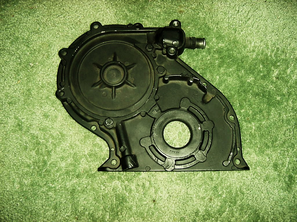

    That problem with the distributor being in line with the water outlet is one problem that I didn't see comming. Glad you brought it up.
    If you need 2 outlets I would use a street ell.
    But after doing a quick mockup setting a head on the block and plugging in a distributor I thought about how the water would actually flow thru the block and head if both the front and rear head water port were used.
    I have cut off the camshaft water pump extension and blocked the hole in the front cover where the extension came thru to drive the water pump.
    I then modified the front cover by machining off the stator mounting bosses to allow the new harmonic balancer fit without possible interference.
    I then epoxied in the 3 bolts that held the waterpump cover on but didn't hold the main cover onto the block because otherwise they would leak oil..
    I then cut the short piece of the water pump cover that is immediatly over the water opening into the block and epoxied (JB Welded) that piece in place and plugged the cut end with epoxie.
    I then drilled and tapped the side of the cover to allow a pipe bib to be installed.
    This allows the Toyota water pump to pump into the block from the side giving me a little more room (about 2" more) between the radiator and the front of the engine for the electric fan.
    See picture below.
    Anyhow with this setup where the water enters the block in the front I thought that most it would follow the path of least resistance and immediately leave the engine out the front of the head.
    Soooo I think that I will only drill and tap the rear of the intake manifold thus forcing the water to flow thru the whole engine from the block and thru the head.
    Later if I decide to heat the intake manifold I might use the front head water port to facilitate that.

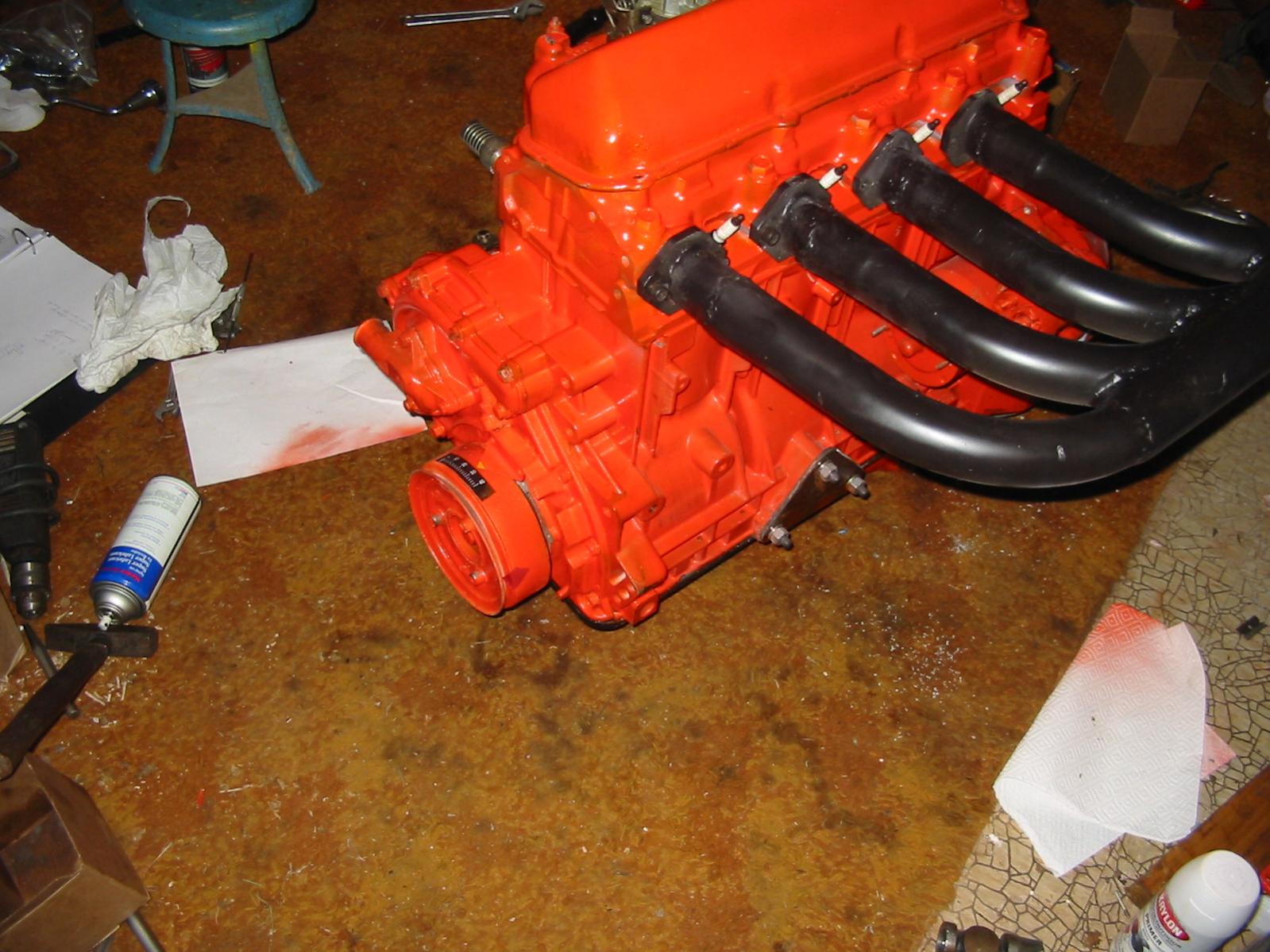

    I see from the pictures of your painted engine that you have installed the harmonic balancer.
    Does it look like the marks on the balancer will line up with the marks on the cover?

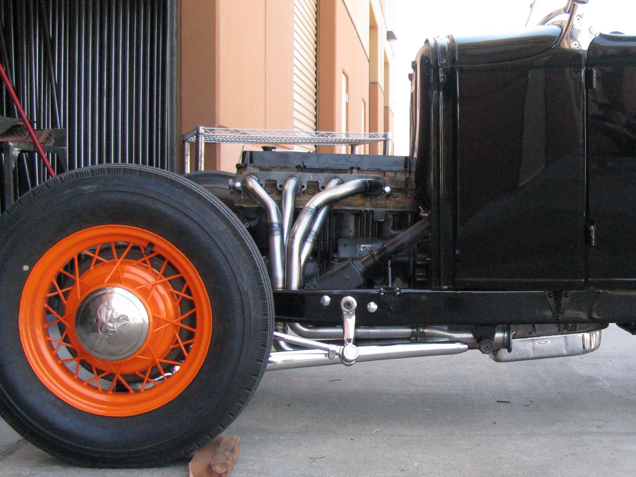

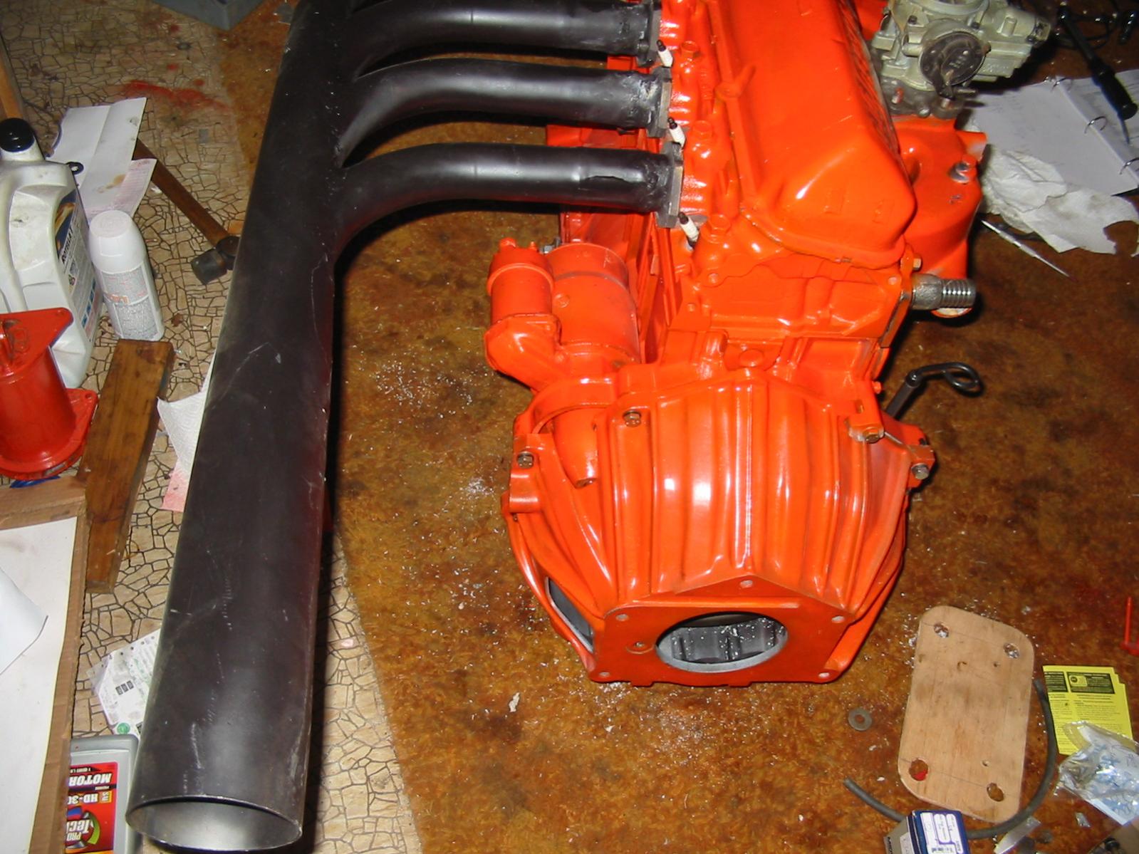

    I was telling a friend of mine, Kim Sparks about your project and how much more difficult it must be for you to build your project in Sweden than it is for me in Southern California.
    Kim was talking about driving to Thousand Palms, California (70 miles) to Red's Headers to get a Header and other things for his Model A Ford flathead.
    Kim must of asked them about my project because he said that Red's had made a header for the 470 Mercruiser.
    This morning I called Red's and talked to Jim who said that he would send me some pictures of the one that they had made and that they had the spec.s for a Model A installation.
    He further stated that headers can provide as much as a 10% increase in performance over a stock maniford.
    If I could get even 1/2 that increase in performance that would be about equal to a 12hp increase or 120lb decrease for a 10 to 1 hp to weight ratio and would be well worth the money.
    Thanks Kim for the heads up on the headers at Red's.
    Thanks Jim for the pictures.

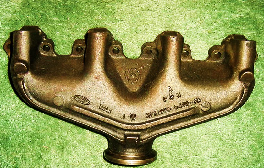

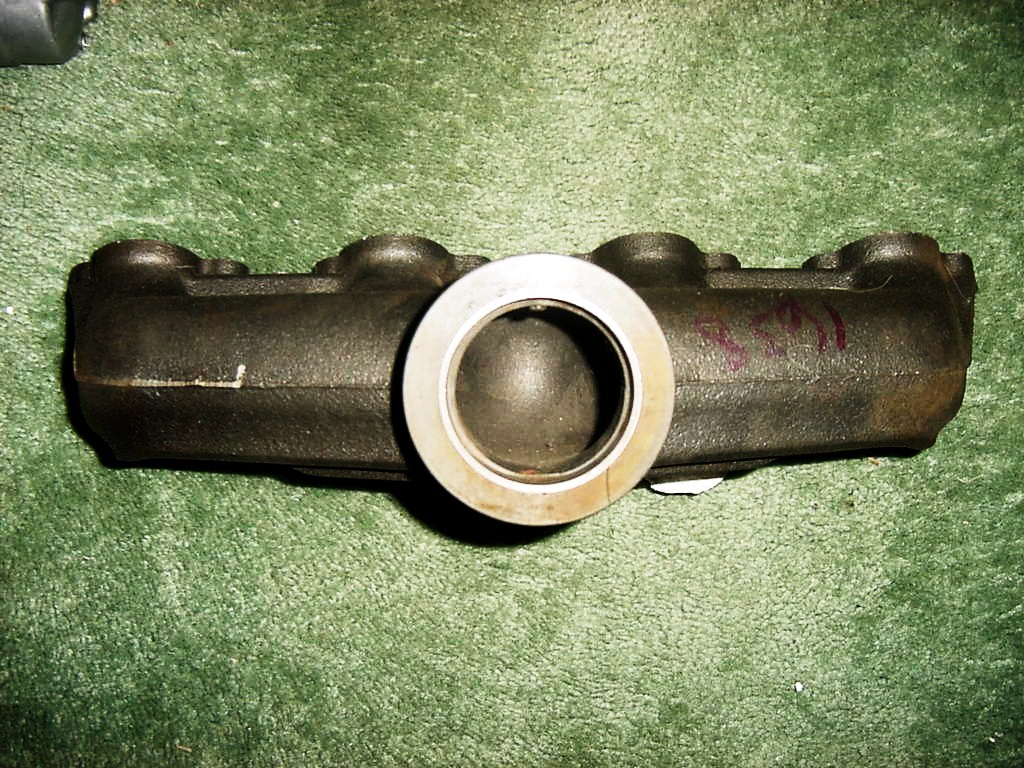

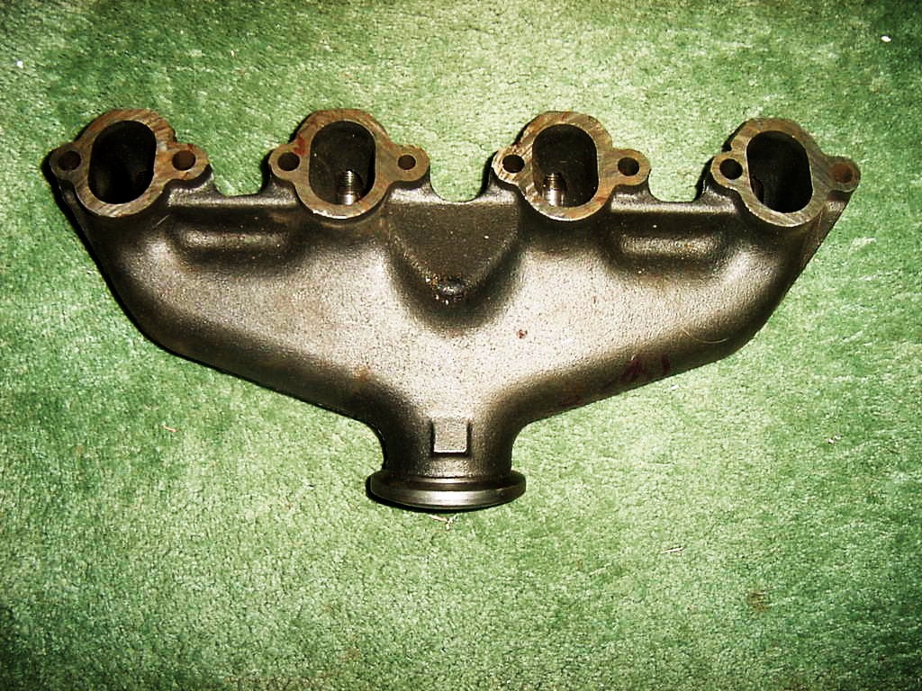

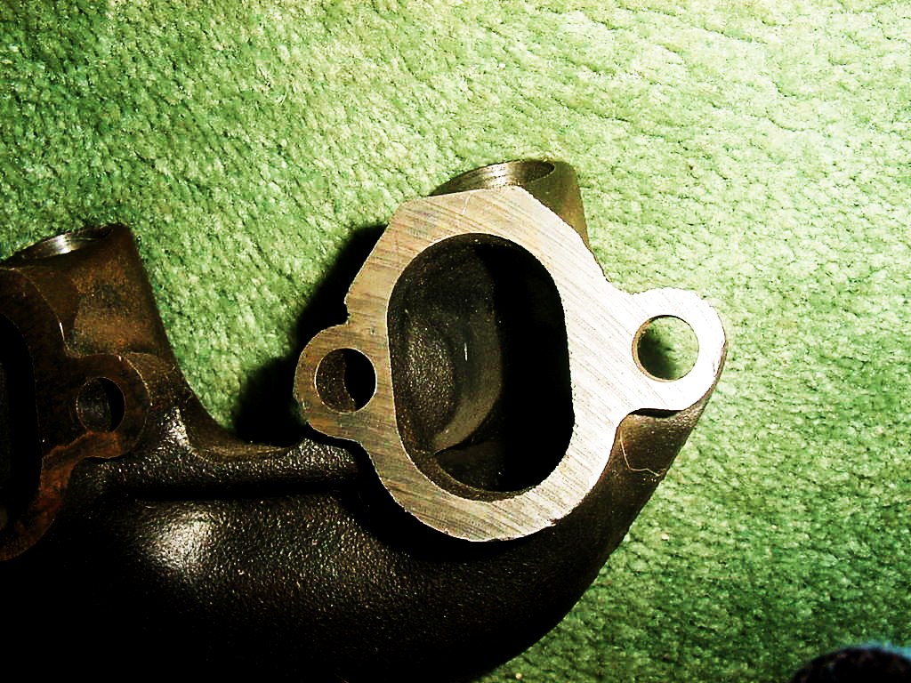

    I wouldn't try to use an aluminum exhaust maniford such as is on the original Mercruiser.
    In the water cooled mode that they use they work fine and I don't know about their efficiency but do know that Mercury Marine Engineers knew about marine exhaust.
    I have a couple of 370/429/460 Ford cast iron side dump exhaust manifolds that would work fine and would flow pretty well but I do think that I will get at least the 5% increase with good headers.
    Note: There are 2 of these manifolds that were aparently used on busses.
    The 2 that I have are the ones with the larger ports. Some 460 manifolds have ports that are about 1.5" by 1.5" while heads with the larger ports are about 1.5" by 2.10"
    The opening to the head pipe is about 2.36".
    These heads will work fine with the Vega steering box and the side motor mounts.
    They might not work so well with a stock Model A steering box but I am not sure about that because I haven't installed one in a car yet.
