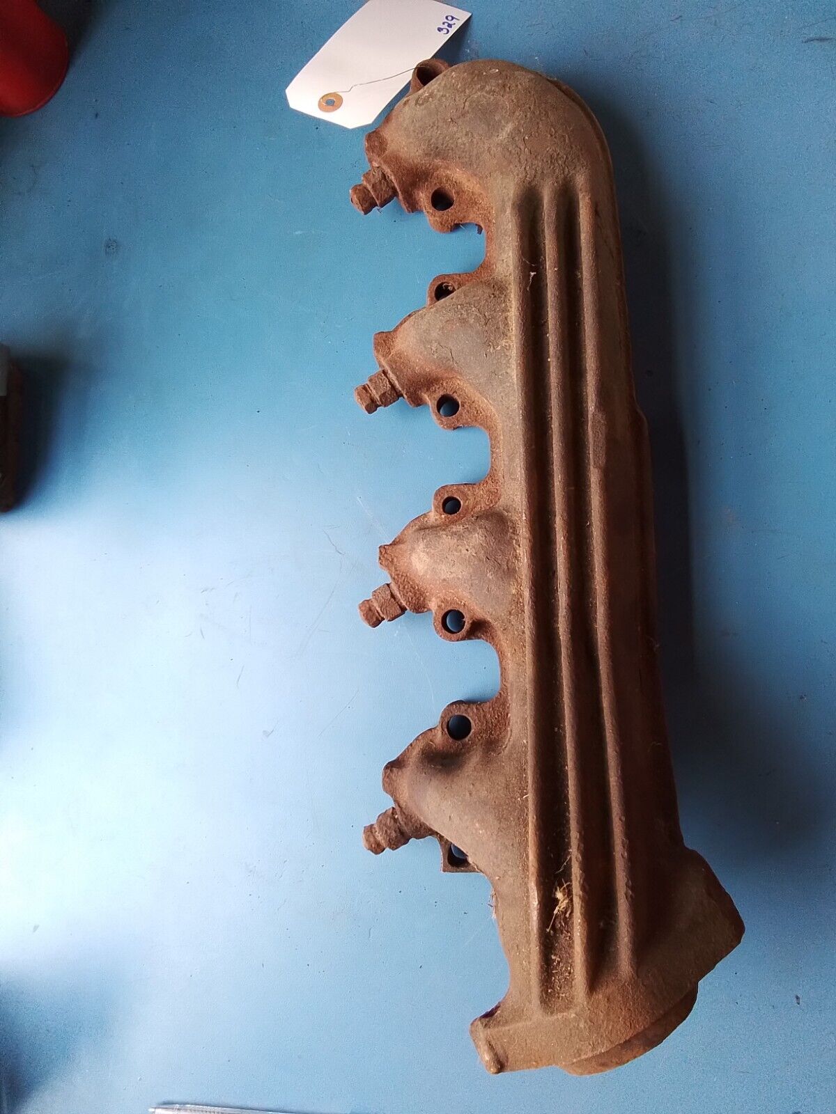

    I will look at the old manifold I have today and report back. I do not know if it is for a car or?
  24. The manifold I have is for a Ford 460's left side. Its dump tube comes out under the third opening and the dump tube is inclined downward and outward. The dump tube is at an angle to the rear at roughly 30 degrees. from horizontal.

    Pics? Sounds like the 70s-80s truck manifolds I'm familiar with.
