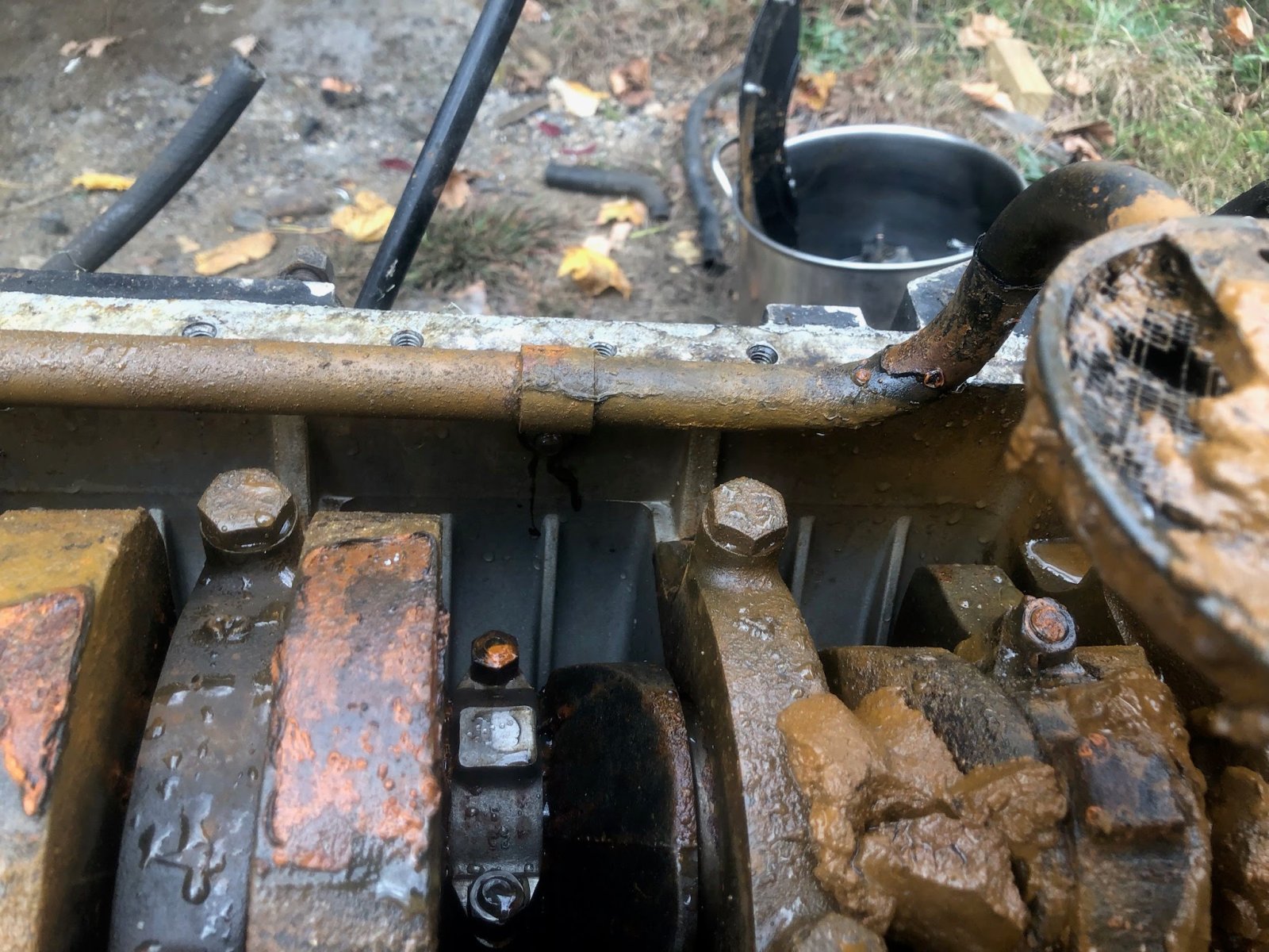

    Nothing to report on my build. Picked up another core because free. Only reason it wasn't a runner was because some yokel left a plug out and water got in that cylinder.
    I think this is an early engine so I'll post pics of the stuff that's different from the other three engines I've dealt with.
    Different starter brakect than I'm used to seeing.
    Not the usual coupler, but also clearly the "later" flywheels
    Different oil pickup. Note how instead of bolting to the main for support it attaches to studs in the side of the block for support.

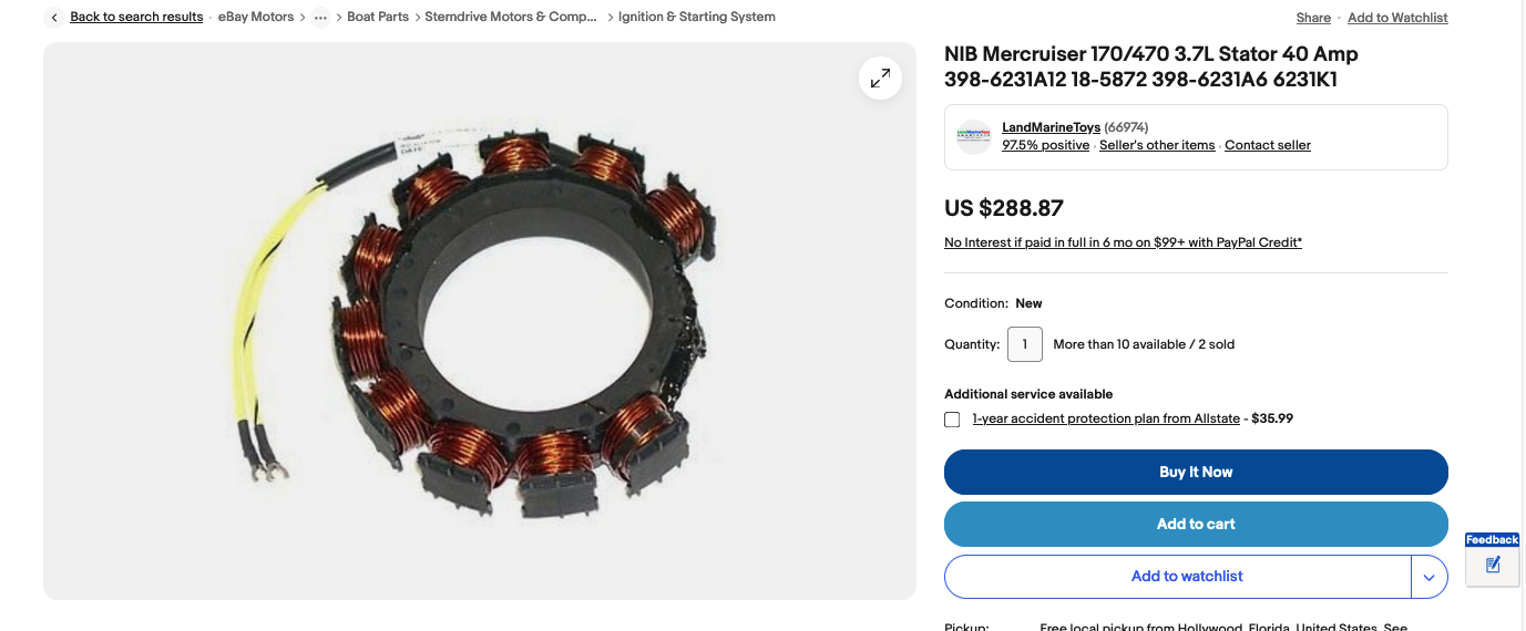

    Anyone know how many amps the stock alt puts out? I'm thinking of just using it with an external regulator because my build is slowing and it's one less thing to fabricate.

    Replacement parts are listed as 40 amp
    Screen Shot 2023-10-30 at 11.29.12 AM.png Screen Shot 2023-10-30 at 11.29.08 AM.png
