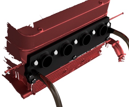

    Starting on a new intake for ITBs. This is the CAD generated image. It is going to be 3D printed. The tubes on the manifold ends are where I discharge cooling water for my setup. I should have a small end piece of it test printed to check fit in a week or two. I'm excited about this. I don't know squat about designing on CAD type software, so I had some MAJOR help yesterday. This guy was good! They used the latest in laser scanning to get a high-definition image of the side of the head/block with studs installed and built off of that. 8 hours later this is what we had. It's designed to use silicone o-ring material around the ports, but there wasn't enough room to insert them around the water p***ages. I decided to just use RTV in those areas and around the bottom. Not real crazy about that due to the difficulty of cleaning it off at a later removal. I imagine RTV will really stick to the printed surface.

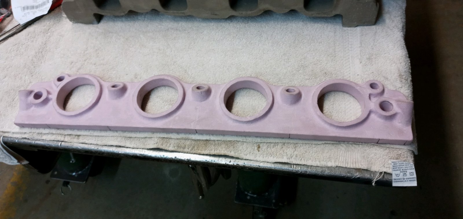

  27. Flatrod17
    Joined: Apr 25, 2017
    Posts: 701
    Flatrod17
    Beck,
    That looks a lot like the start of my new manifold. But mine was done in lost foam casting. Here is my flange that he sent to me for test fitting. It still doesn't have the lower part to seal under the head. But machined up and it fits.
