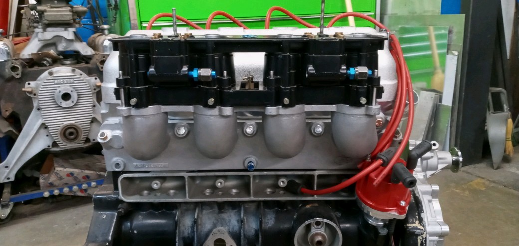

  8. Flatrod17
    Joined: Apr 25, 2017
    Posts: 698
    Flatrod17
    We talked about putting a bump in the port to clear the dist, but then I went of on a off-set dist set up, so it didn't happen. Besides we couldn't agree on where to put it. But the good news is a stock dist will fit if clocked carefully. My VW MSD's will need a bump in the port. And that still may happen!
    The Boss head has 7 bolts, at 3 different angles, my set up only used 5 bolts at 2 angles. In this picture you can see where I have the temp sensor. He didn't want to angle it up like that because there is a bolt that goes in the area between it and the manifold adaptor I made, so that bolt was left out when I made my adaptor. Fan sensor is at the rear port.
