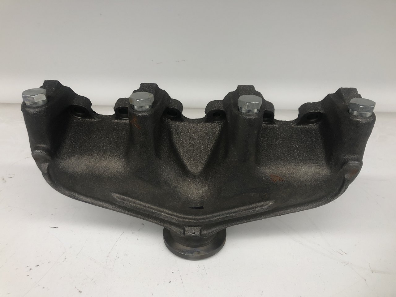

    Truck Manifold for exhaust

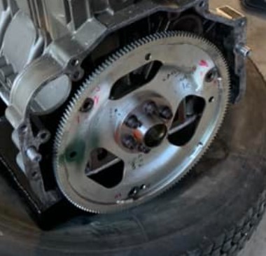

    I have a th350 bolted to the back of my 3.7. After much measuring and playing with flex plates and spacers and not having a solution I was comfortable with I simply made a bushing on a lath to hold the snout of the torque converter, and then drilled the stock flywheel with the correct bolt pattern for the converter.
    So far it has worked well, I was worried about the excess weight of the flywheel and torque converter together, but the engine still revs up well, and on the low rpm it lugs along like a tractor.
    I use this in my off road buggy, so it is not a screaming high performance drag machine, but it scoots along just fine.
    Total cost? = about 10 minutes of machine time from a friend, and a 2" long piece of scrap tubing.
    Having one of the best performing and most unique rigs on the trails...Priceless.
    Also from this site:
    A Flexplate off a 74 Maverick with a straight 6 fits nicely, and would work perfect by milling the block 5/8". You would still need a pilot adapter for the nose of the torque converter.
    However in my case I didn't have the resources to mill the block, so I reused the stock flywheel off the mercruiser and drilled the appropriate pattern in it to bolt up the torque converter. The spacing was perfect, 1/8" between the two.
    Then I just fabricated my own pilot bushing that indexed off the pilot in the flywheel.

    Was this from a Ford truck? I haven't seen one like this. The collector outlet is shaped differently. I expect this is cast iron and heavy? Weight is my enemy.
    The flexplate you have a link to will not work as it is. It has the counterweight welded on. That would have to be removed. I used this one which isn't counterweighted and is about 1/4 the cost. PRW Power 1830213 PRW Platinum Series High-Inertia Flexplates | Summit Racing
    Does anyone have some drawings or dimensions of the required pilot bushing? Or a link to a commercially available one?
    I like the idea of mounting the torque converter to the flywheel however for my usage weight is critical. I pull custom built 4 cylinder powered garden tractors. The total tractor weight has to be under 1150#. By the time the weight of the transmission and automotive rear axle is added it is getting heavy. This eliminates the usage of the stock flywheel. A Powerglide is lighter than a TH350 but 1st gear is too high (1.8 vs 2.52). Either low gear is slightly adjustable with mods (2.75 in the TH350). The torque converter adds considerable weight also. Currently I have a small manual trans mounted using a small dirt track racing clutch. I realize now my clutch isn't going to survive so am looking at the automatic.

    I like your post about putting the torque converter onto the flywheel. If that works, I think it would be the easiest due to no block machining required. That flywheel is about 30# if I recall so it will take some of the vibration out of the big 4 cylinder. If reducing weight wasn't such a high priority for me, I would like to try that setup.

    That exhaust manifold is from a HD truck (ie... dump truck).

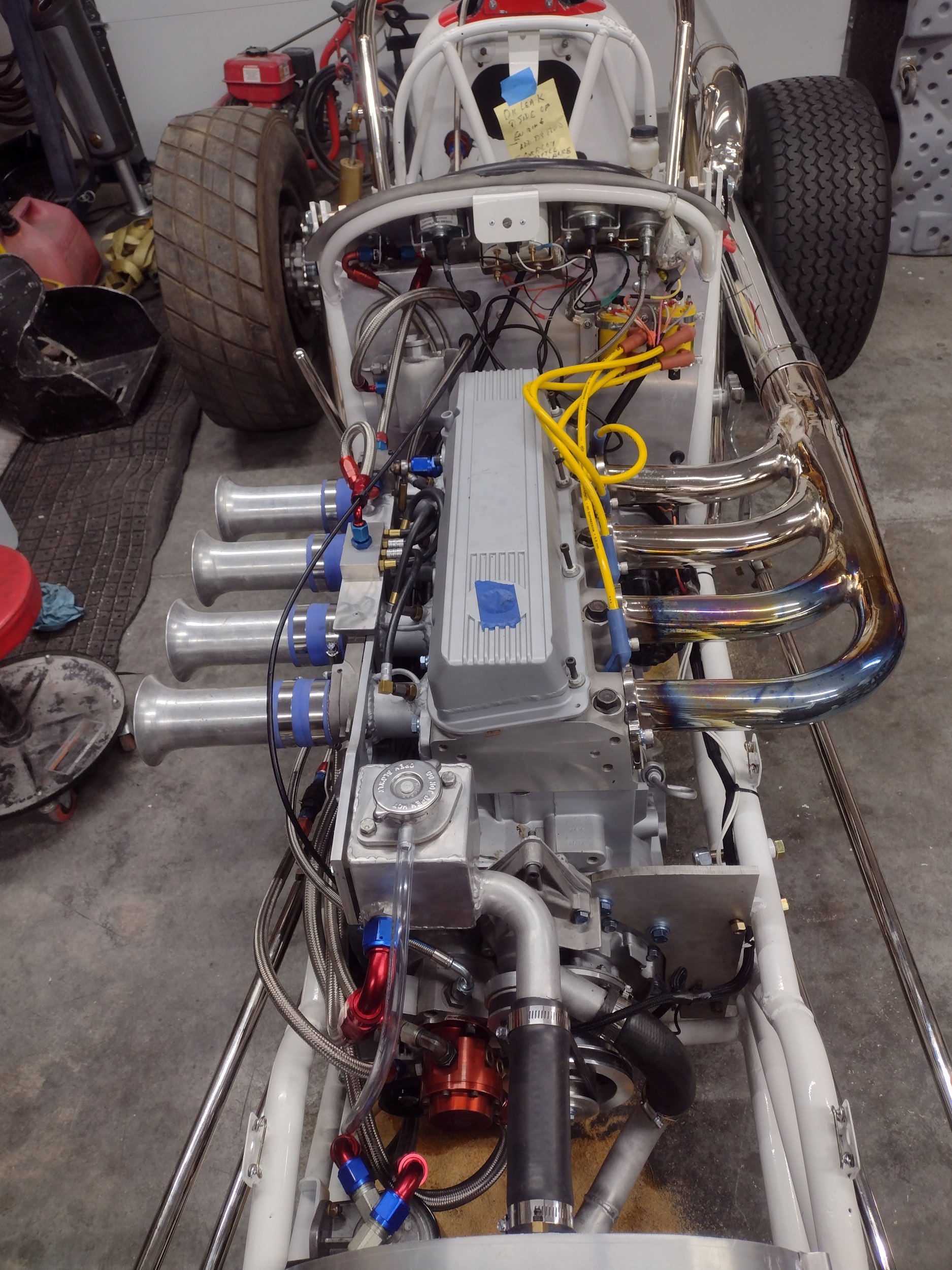

    Anyone have any experience or ideas on building or modifying a Tach drive distributor for this engine?
    I have a really cool old tach that I'd love to use on a project but would need to fab up something and there's not a lot of room to work with.
    Right now I have on original Mercruiser distributor with a vacuum advance from a Corvair.
  24. Flatrod17
    Joined: Apr 25, 2017
    Posts: 688
    Flatrod17
    Are you wanting to keep it in the stock location? ? What do you have for a intake? The height of it all will be the problem. Right now I am working with a short small diameter VW dist to try to clear my new intake. It is promising. The other options are off set drive, or running off the end of the cam either straight out if room or a 90 degree off the end of the cam.
    Any pics of what you want to use?

    I am open to all options at this time. KISS is what I like. I am using a stock 2 barrel manifold modified for side draft carburetors. Height isn't a Big problem but I'll get a better idea and post that up.
    This might work if I can convert it to 4 cyl. the guy that owns it says, "Ford, but not 302. Maybe 460."
    No vacuum advance :(
