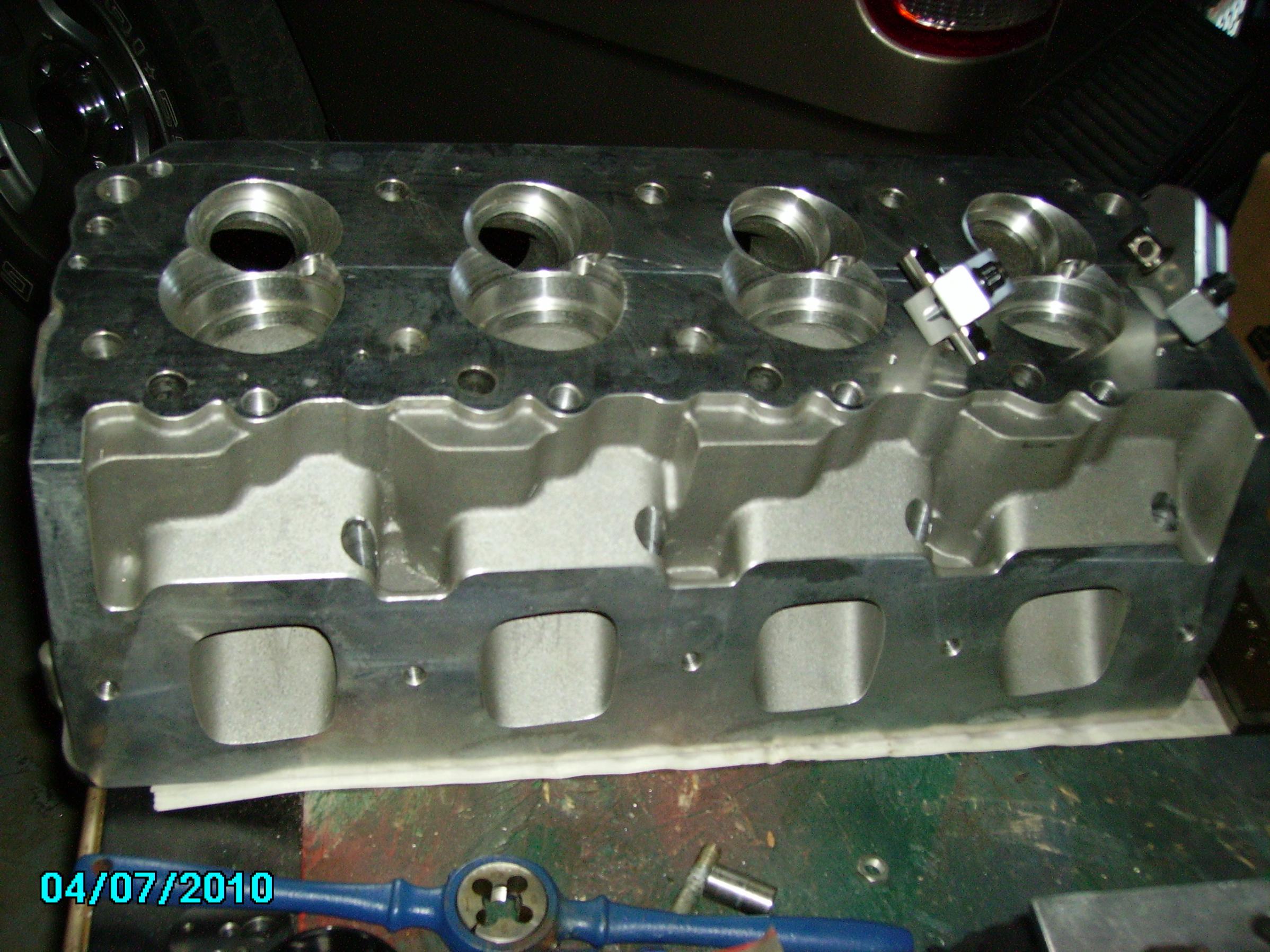

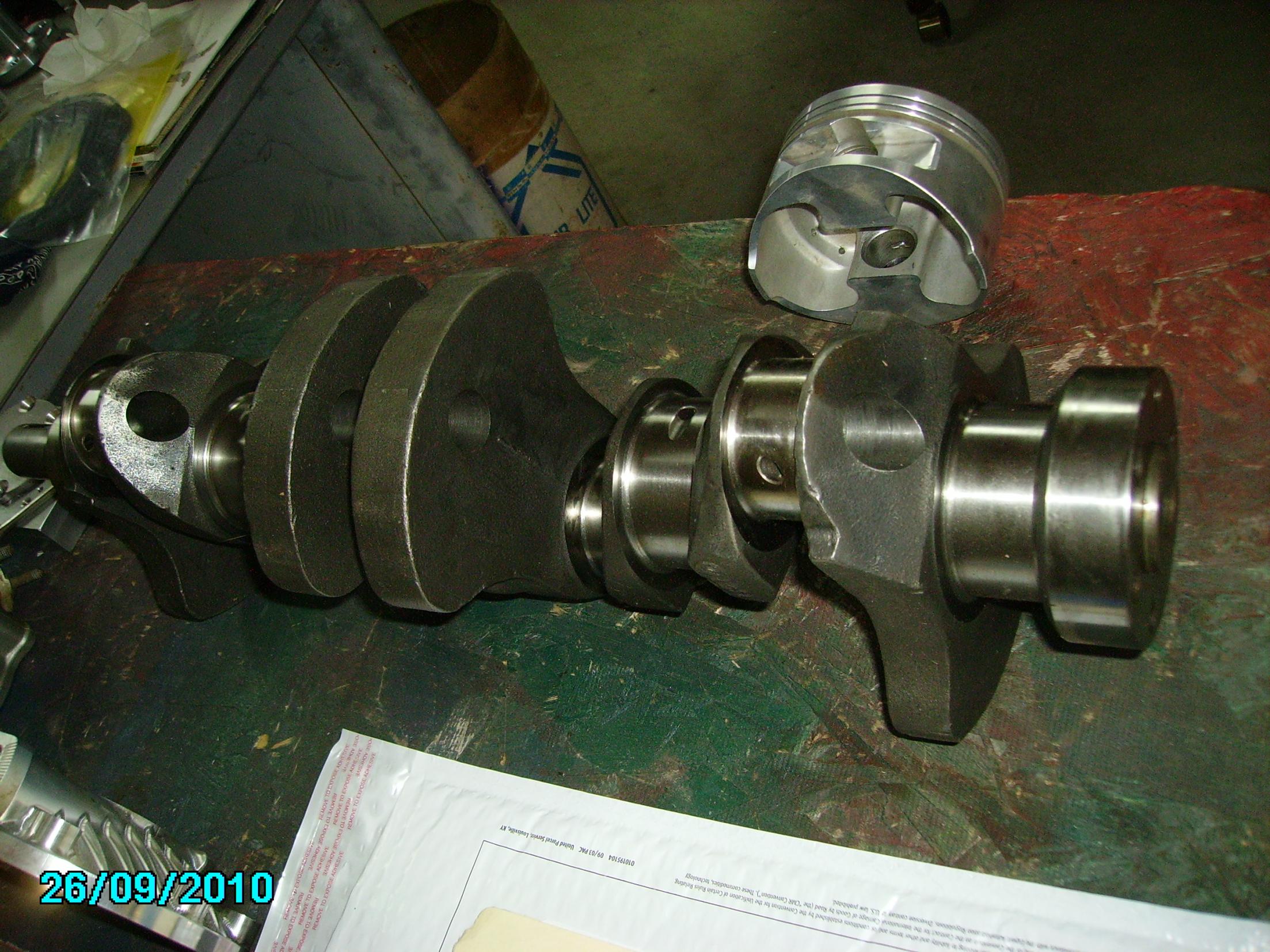

    Here's some pictures of my '34 Plymouth project, currently it has a stock 470 engine with custom 4-2-1 headers, motor mounts use 3.8L V6 Ford rubber parts because they're soft. 5sp. Trans is from a 90's full size Chevy pickup, I used it because the shifter comes thru the same hole in the floor as stock and it bolted to the engine. This trans uses a hydraulic cylinder to disengage the clutch. I used a 10.5" Mustang pressure plate by redrilling the flywheel. The rear end is an 8.8 unit from a Ranger pickup shortened to use another stock short axle, disc brakes are from 80's T bird. The engine pictures are a work in progress, I stroked the crank .300 and the bore is 4.500 to yield 264 cu.in.The cyl head is of Tom Roberts design for a 500 in. pro-stock drag engine. Life's foibles have kept me from working on it but since following this thread I have drug the parts into the light and made a list of tasks to finish it. If this is of interest to anyone I'll post my progress. Pat
    Calkins likes this.

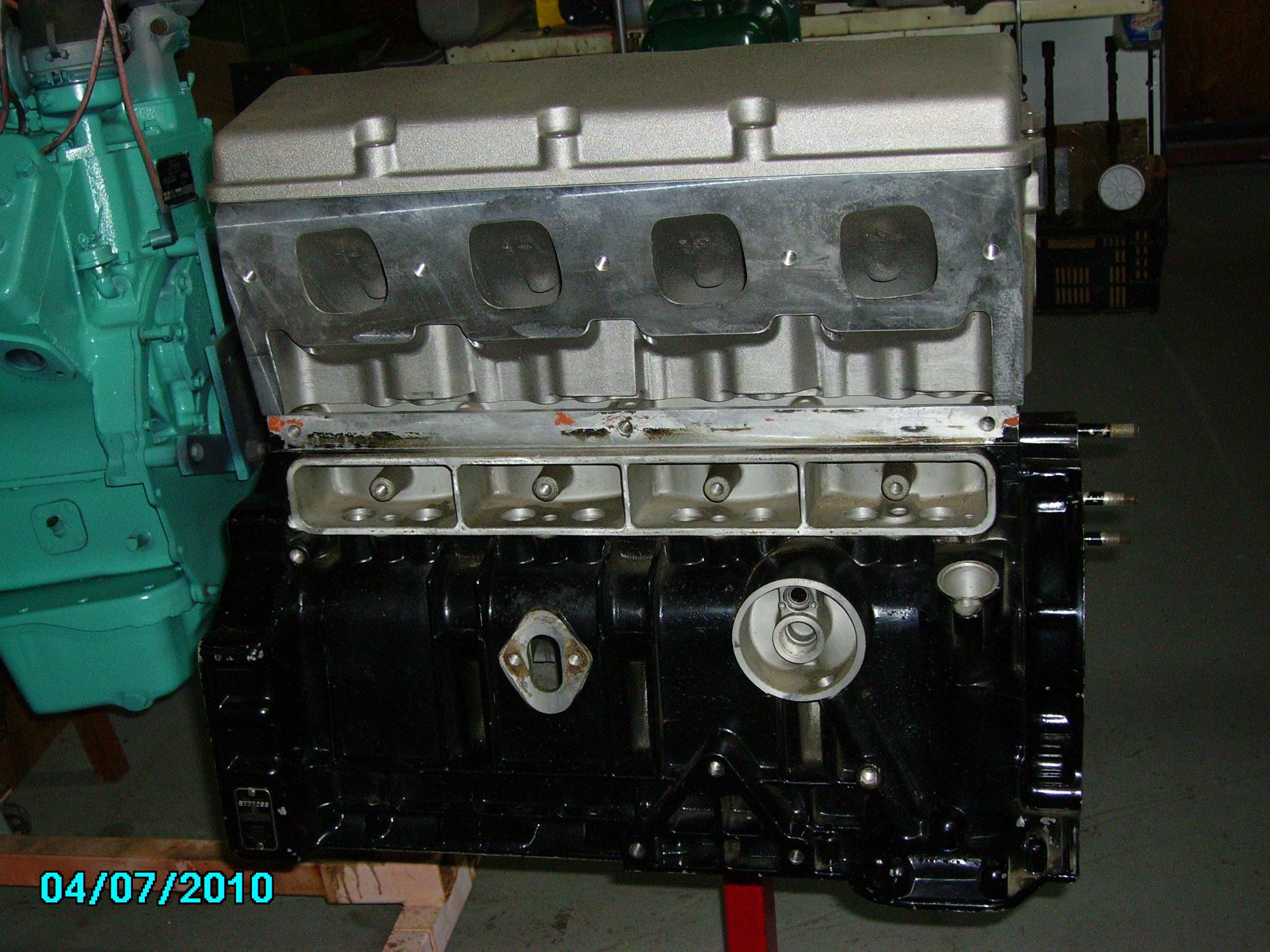

    Had trouble sending pictures so I had to split it up, Pat

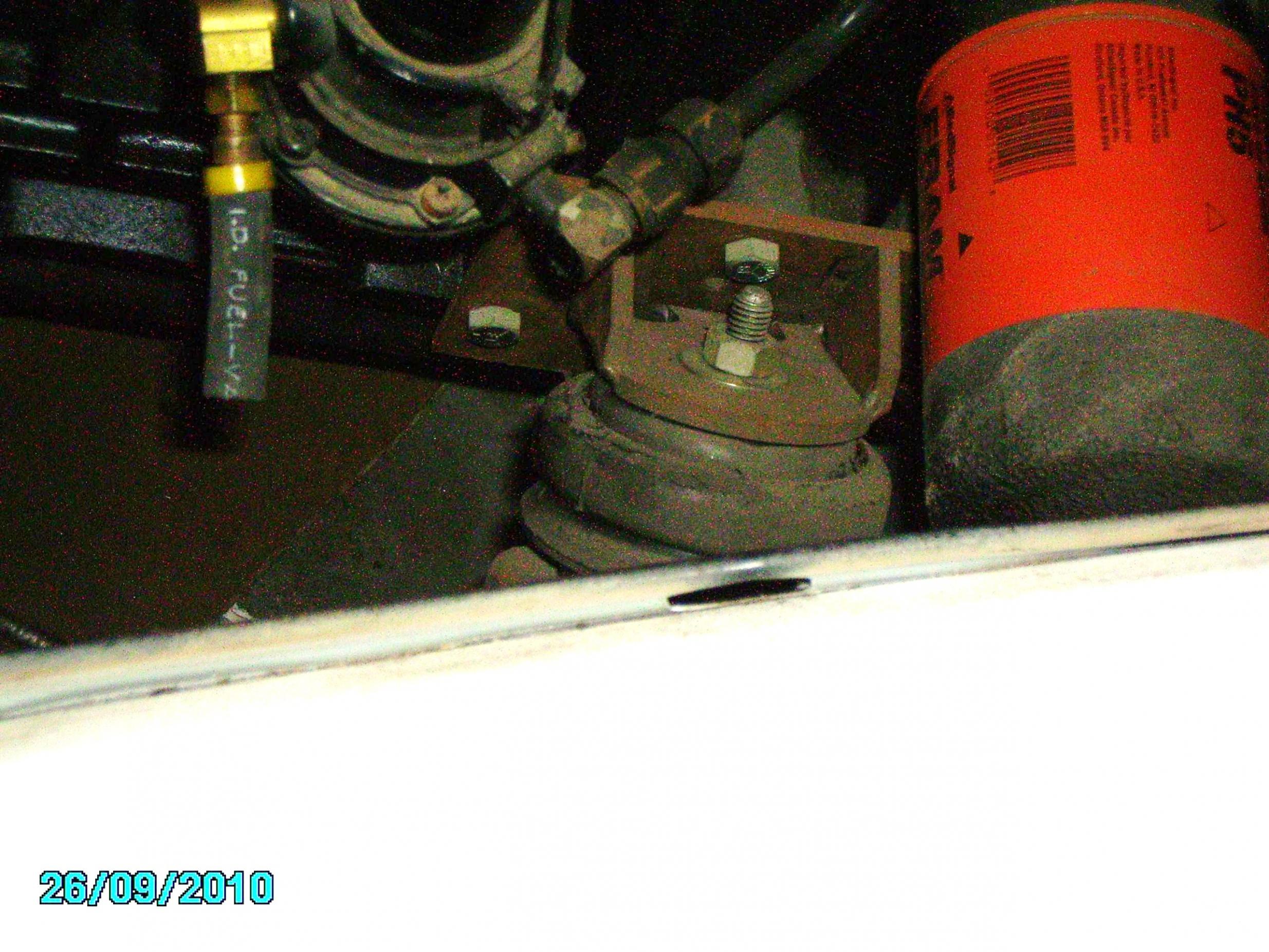

  9. My oh my. Really nice Pat.
    The hydraulic clutch is a good idea, it has some advantages:
    1. easier to set up.
    2. does not transmit vibration to the car frame.
    I chose V6 mounts for the same reason.
    send in a picture of your car in sunlight.
    What is it like with the stock motor?

    Pat,
    Did the transmission input shaft length have to be delt with or was it ok out of the box so to speek?
    What bellhousing did you use of is it part of the transmission?
    How did you handle the throwout bearing?
    And do you have a part number or a year/make on the motor mount?
    Thanks, ****

    I'm thinking to get that bore you must have done new sleeves.
    Did you completely mill out the existing sleeves including all the aluminum around them, or did you put new sleeves inside the remaining aluminum casting?
    Those are heads are size huge by large, aren't they? Do you really feel you'll be able to get the volume of air moving in 'em to do the velocity they are designed around? I'm worried using the K***e street Boss replicas, that I'm killing bottom end for no gain. That said, is this a race car?

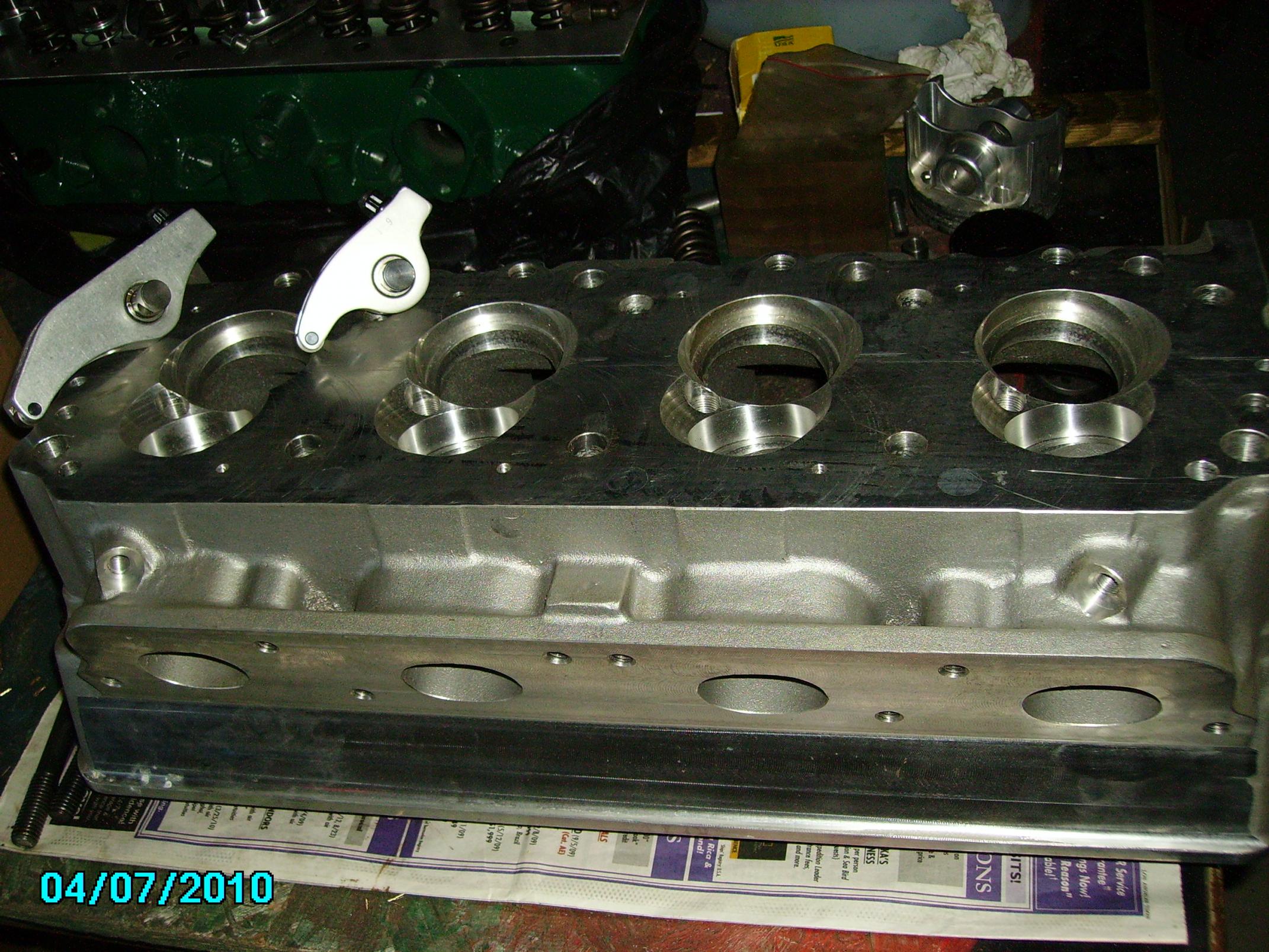

    Nope, the Boss9 by Jon Kaase Racing Engines (JKRE) is a reproduction of the original Ford head. John & his people have cast it with some port reshaping along the lines of his porting jobs already there in the casting, and the exhaust rocker arm is lengthened and moved inward (on a V8) so the pivot is closer to the centerline of the head. The big reason for this is that the pushrod on an original Boss 429 leans out so far that it runs into the valley of the block. On a Ford 460 block you can grind it out to clear (though it gets "really" thin (approx .100")- but for us Mercruiser guys, you'd have to grind out the wall completely in 4 spots and rebuild it with weldment closer to the cylinder. That welded area would have to seal against the headgasket, and would have to separate coolant @ 15+psi from the lifter gallery. I *think* the Kaase pushrod realigment will prevent us from having to do that. As you might guess I'm just waiting for the stars to align and I will be getting a Kaase head for my Mercruiser build.
    As to Pat's engine's heads- where do I start.
    There are two sanctioning bodies for mainstream drag racing- NHRA & the "upstart" IHRA.
    About 10 years ago NHRA gave in to some GM lobbying and created a blatantly anti Ford rule- the Ford 460 has wider spaced bores (4.90") than the BBC (4.84"). So NHRA said "you cannot use an engine with bore spacing larger than 4.84" in ProStock". So, the Ford racers had no choice to to go to IHRA, which has much looser regulations (they permit up to 5.3" bore centers). Under the IHRA rules, engines grew to 815-825cid. That was where the Roberts design Hemi heads like Pats really came into use. They may have been around in other forms, but that's where they are mainly sold & used. These new design heads have no real relationship to Ford, except that they still bolt on the 460 Block and they carry a Ford Oval so Ford can be seen particpating in racing. I'm not sure if or how, or what directon money goes between the design/foundry & Ford advertising.
    Between the above rule and the ubrupt cancellation of Prostock Truck, I think NHRA are about the worst people in racing, not to mention the utterly corrupt game they have with "certification" of racing components through their SFI Foundation.
    Anyway, you can read betweeen the lines of my reply- I'm not sure putting a head designed for 825 cid (call it 412/bank) revving to close to 8,000rpm, on a ~265cid motor most often revving to 6K or under, is going to give the best results. Even if you build the shortblock to very aggressive race specs with plans to rev to the moon, it's still maybe a bit of a mismatch, IMO. The ports on the Roberts head are raised several inches (itself good) and start off around 5.5 square inches in area, unported (compare the intake port to the oil filter pad to see just how big they are!). They're a clean sheet new design for some pretty extreme race engines, and have nothing in common with the Boss429 street/drag/Nascar head of the 69-71 era. For example the Boss street heads including Kaase's & Shotgunhemiparts.com's reproductions, use valves that are not exactly opposite each other, creating significant swirl, whereas the Roberts design are more like a Top Fuel head, where the valves are directly opposite each other. OE's have normally avoided that over the last 25 years, because the intake charge has a tendency to blow through out the exhaust. That maybe OK for racing if the overlap and header and everything are matched, but leaves them a lot less forgiving of bad combinations.

    Some pictures of the chamber side of the head, Pat
    Calkins likes this.

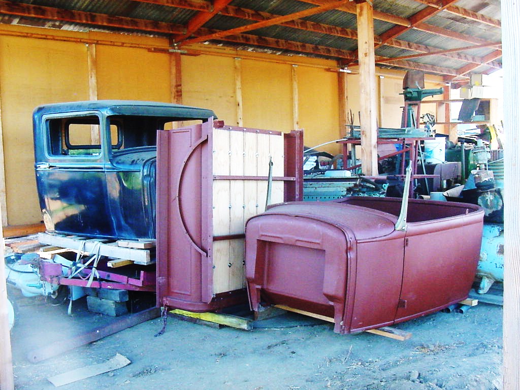

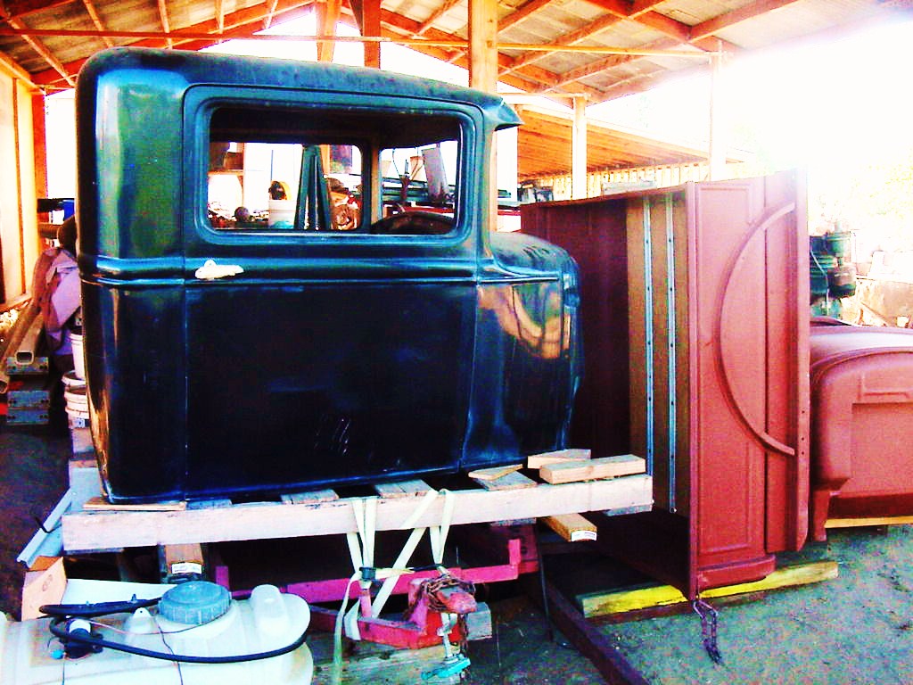

    I am building several 470s for my Model A Fords.
    The 2 below are streached 6" on the Brookville roadster and 8" on the closed cab Independent Technologies.
    I may even put one in the Woodie on my Avatar.
    They will all be Street Rods designed to look as stock as possible and be safe, reliable drivers.
    Early Fords are my favorite cars of all time.
    In my opinion they make the best Hot Rods, after all thats where most of this stuff started. Model Ts to early 30s.
    But any car modified for performance is a hot rod of sorts.
