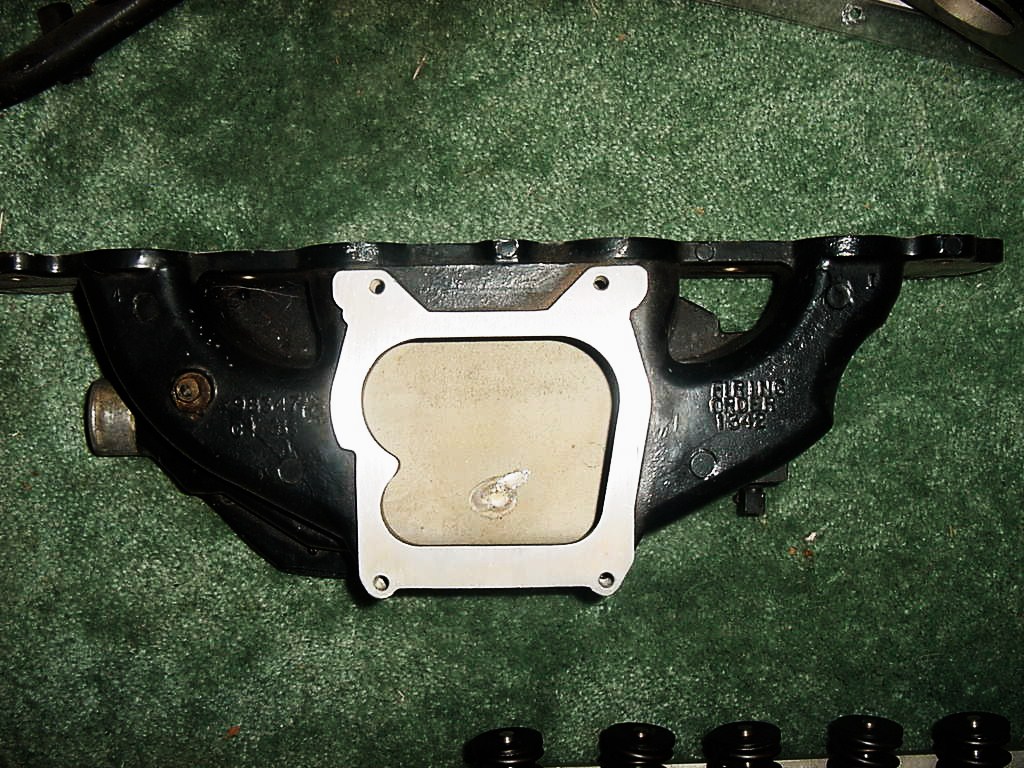

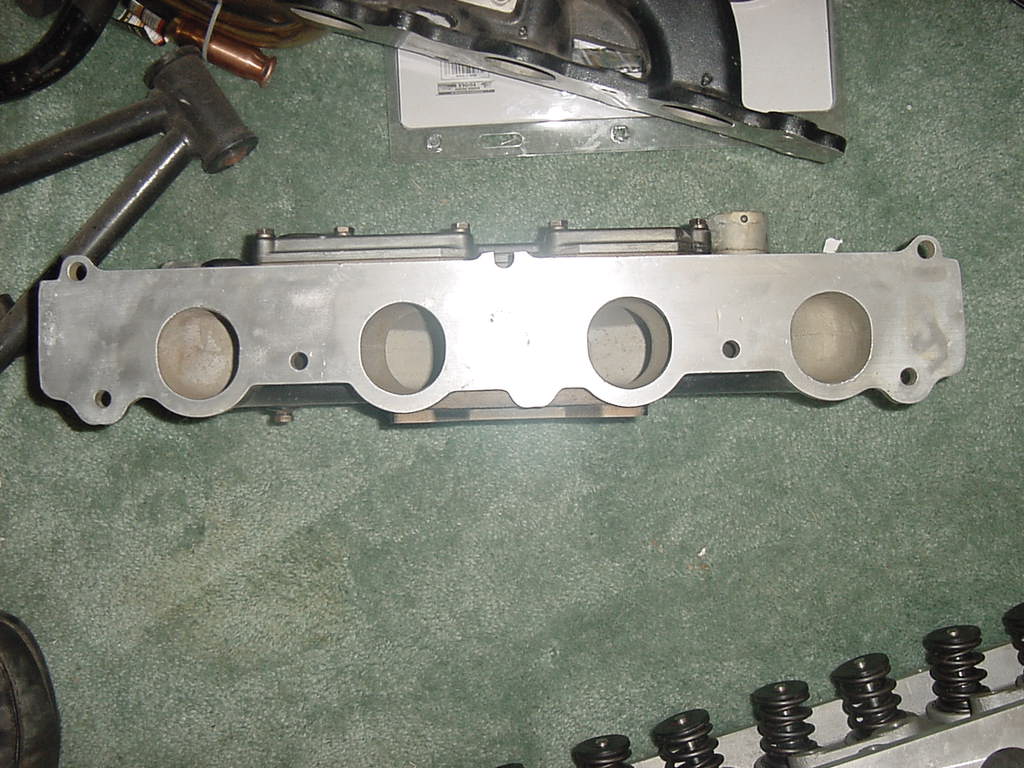

    xtian999,
    The problem with cutting a 460 intake manifold in half and installing it on a 470 Mercruiser is that the heads on a V8 sit on an angle.
    The head on a 470 sits flat. The 460 intake would be sitting at quite an angle.
    I am using the stock 470 Mercruiser 190 hp intake.

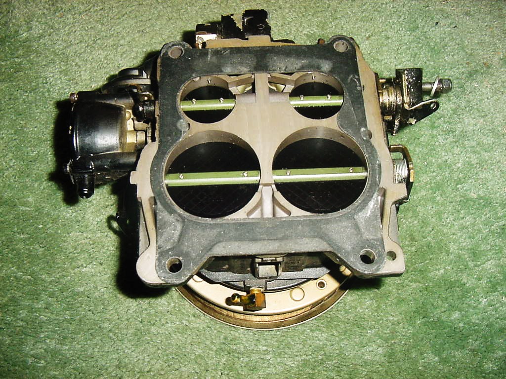

    It is very well designed and uses a 750 QuardaJet 4 barrel carb that is jetted for this engine.
    The second picture is upside down.
    That and the performance aluminum head will give brisk and reliable performance..
    If you read back in this thread you will see a solution for the water pump problem.
    And as sugested a marine alternator will solve the alternator problem in a boat. Coast Guard requirment.
    Any alternator will work in a car.
    They are a great engine when the 2 above weaknesses are addressed.
    Dick :)

    dawford
    The stock Mercruiser 4 barrel manifold uses the stock QuadraJet 750cfm carb with jets right for the engine.
    That carb has 2 small 1.365" primaries and 2 hermongus 2.245" secondaries.
    The advantages of this carb are that while running at slow speeds it gets good mileage on the primaries only.
    As the engine can take the extra carburation the vacuum secondaries slowly open up.
    A regular large 4 barrel carb will over carburate the engine off of the line.
    That is if you wide open the throttle off the line it will bog down from too much flow.
    Figure that the 750 cfm carbs were run on V8s.
    Figure that if you put 2 750s on a V8 and opened the throttle all of the way from idle it would cough and die.
    The QuadraJet is the perfect solution.
    I am betting that the Mercury Marine engineers knew what they were doing when they set up the 190 hp 470s.
    I am changing the head and eliminating the waterpump and alternator problems and leaving the rest alone.
    If it ain't broke don't fix it.
    Dick :)
