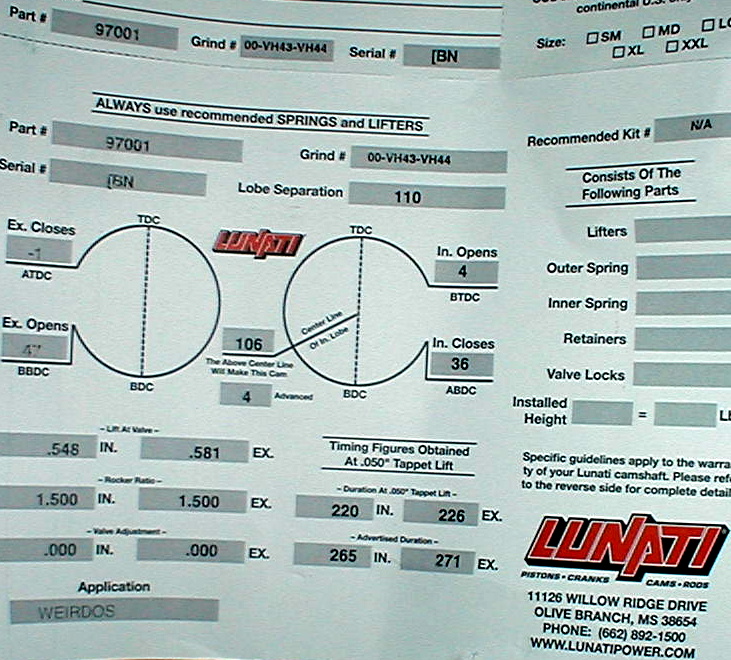

    I got my cam back end of last week.
    I like the application Lunati's guys put down, sounds like they have fun.
    Got the crank stroked to 4.15" by using Ford 5.4L V8 rods, & now waiting on the somewhat rare .020" bearings to arrive for the mains.
    Then pistons.
    I've been trying to get to work an hour early and make the call east to talk with Diamond pistons. Left a message there a month ago, then I took off on a few days holidays, don't know if he ever returned my call.
    Shotgun Hemi parts "no longer has an ETA" for the manifold I wanted. Cross that bridge when I come to it.
    Kaase's got Individual Runner (stacks) manifolds going to the pattern makers and a Tunnel Ram just somewhere twixt foundry and machine shop, supposedly. I want to see a photo before I even consider cutting up either of those V8 Boss manifolds to do a 4cyl EFI. The Shotgun one works best, and I might just wait and see.
    So I guess the displacement is decided at 4.40 bore x 4.15 stroke = 252ci or 4136cc

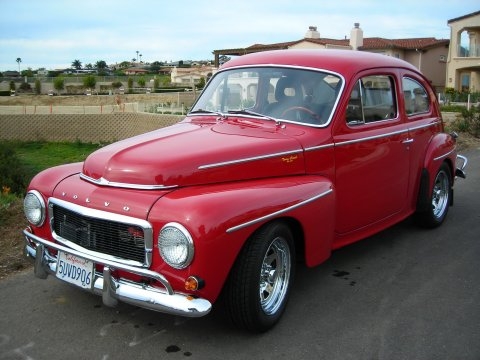

    Are you going to put your engine into your 544.
    I have thought about the 544 as a perfect platform for a real sleeper.
    At 2138 lbs with a mild 470 you get a power to weight ratio of about 9.25 lbs/hp.
    With the engine your building you would get about 6-7 lbs/hp.
    Would the unibody take that without modification ?
    It looks like a subframe could be run under the body and existing front subframe and connected to the rear end mounts.
    All of this is supposing your answer to my first question is YES.
    The 544 looks so much like a 47-48 Ford that I think it would be great fun to build a hot rod out of one.
    They aren't endangered enough not to allow a few to be modified in this manner.

    I see Lunati figured lift at 1.5 rocker ratio. At 1.73 you will be over 0.600"
  25. iadr
    Joined: Apr 14, 2007
    Posts: 147
    iadr
    Phil, nope that's a typo on Lunati's part- the lifts shown are with the 1.75 boss rockers.
    As far as the Volvo 544, the unibodes are decent. The back axle has issues even with a hot OE build up, as does the trans...
    Not what I'd intended, though- initially it will go in a 4dr Sidekick as a daily driver, then if rust or an accident claims the Sidekick, I'm interested in building a tube frame fun car- kind of a cross between a lotus 7, a dune buggy and a IMSA/SCCA vintage race car. I made a clay model 22 years ago...
  26. The fancy wheels on the 544 in the photo, make it look like a hotrod & then we'd anticipate a small block Chevy in it.
    Your point that we'd not miss a few of them is good. It is sad to see surviving rare metal converted to speedsters and hotrods.
    Perhaps a Yugo would be a good stealth vehicle. They've a big trunk that would make an engine compartment for a front wheel engine & drive train placed there.
    Idar's suggested use of a sidekick is good.

    His engine in the Sidekick will make a good sleeper.
    The extra 500 lbs over the 544 will more than be made up for by the extra Hp he is going to get out of his super hot 470.
    My idea of the 544 would include the mild but more reliable and economical 190 Hp 470 with an aluminum head and a couple of other modifications to produce 225-230 Hp.

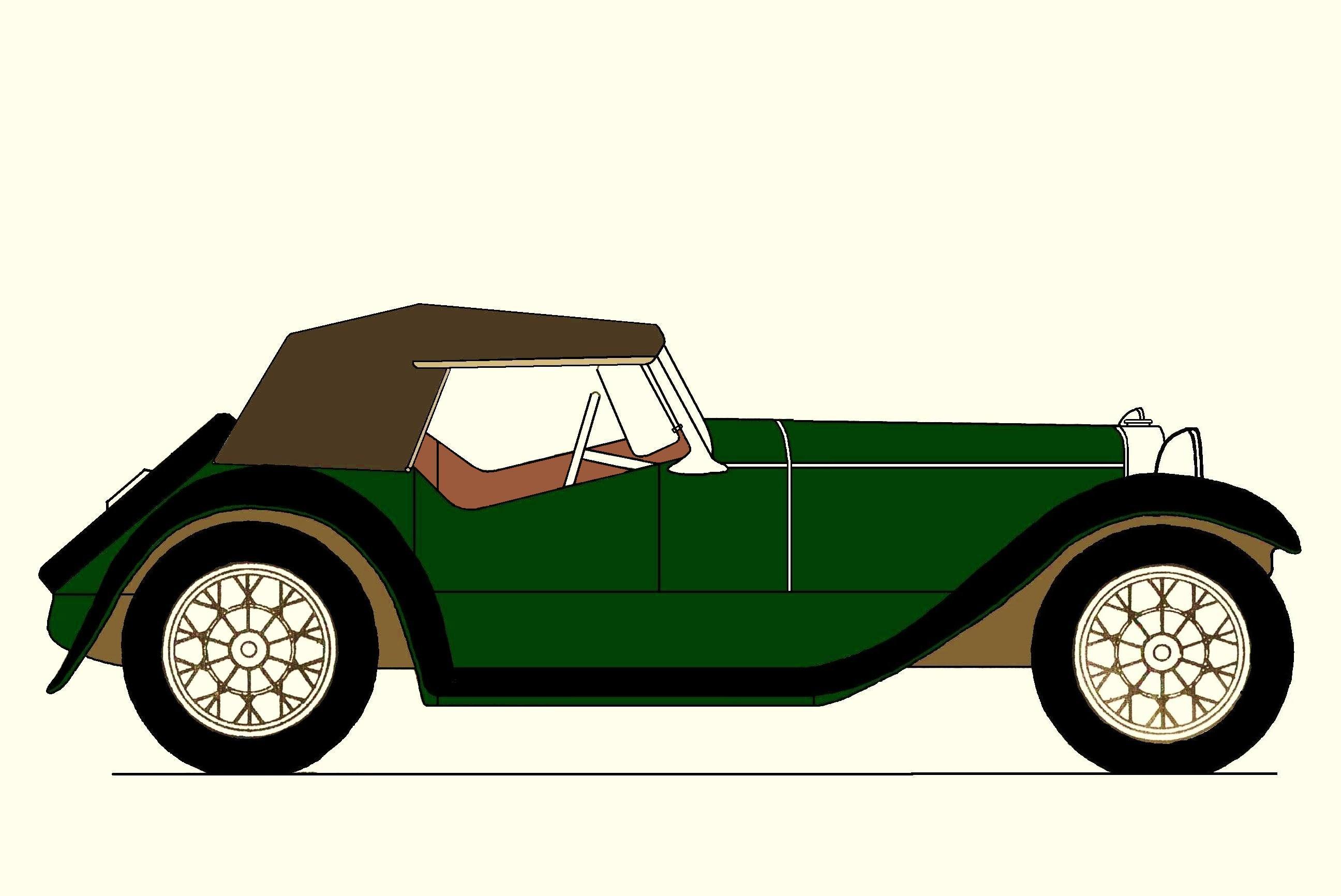

    After I finish my first car and adjust my engineering on ch***is, engine and transmission, I will cookie cutter the others.
    The first one will be my Dawford Special Sports Runabout based on a Model A Ford ch***is.
    See my CAD picture below.

  29. ****, that is beautiful. Much like a MG TC. It is very much to my liking and has design features that would make it a pleasant car.

    Thanks, dennis g
    Drawing the picture and making it are two different things.
    I have the bottom, top and fenders ready.
    But I haven't decided whether to modify and connect some of the spare fibergl*** body parts that I have or just make the body from scratch.
    The best part of this project is that it is going to be different and light weight. About 1600-1700 lbs.
    An added benefit to this design is that I can move the engine back 12-14" thus shifting 350 lbs of engine and 75 lbs of transmission that much more to the rear of the car.
    The 8.8" limited slip 3.08 rear end and the V6 mustang WC T5 will provide traction and speed selection.
    If I find that the gears are too high I also have a 3.55L rear end.
    This is the lowese and lightest car I will make therefore I am using the highest rear end of the 2 on hand.
    The Mustang 10.5" performance clutch will allow me to slip the clutch out of the hole untill I can get into the killer torque range between 2500 and 5500 rpm.
    It remains to be seen how true to the CAD that I can make it.
    I will use my eye for design as best I can to come up with a finished product a little less angular but with similar proportions.
    My original idea was to design something similar to a mix between a 1937 Jaguar SS100 and a 1953 MGTD.
    I've always wanted to hotrod a MGTD but they are too small for me to be comfortable in.
    This one is built on a stock length Model A frame (103").
    My youngest Son is helping on this one and that is what he wanted.
    If I ever do another one it will be on an 8" stretched Model A Frame of 111".
    It is a little hard to see the difference unless you switch back and forth between the 2 pictures below.
    The body would sit in the same position. The stretch would be all in the hood.
    That would make it look more like an early Jag or Mercedes roadster.
    Either way the hood will have to be made special to fit.
    The 64" tread width front and rear and 4 bar suspension should make for stable handling.
